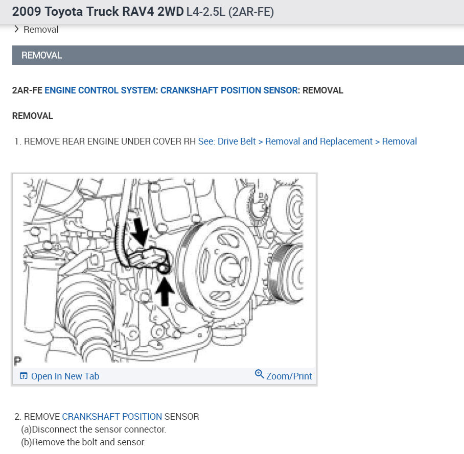

my car stopped I was able to turn it back on in couple of minutes I drove five miles to my mechanic. it turned off again the mechanic said it was the fuel pump. he changed the pump he went to turn it back on it will not start?
Jan 19, 2017 at 4:00 PM
SATURNTECH9
  • 30,869 POSTS

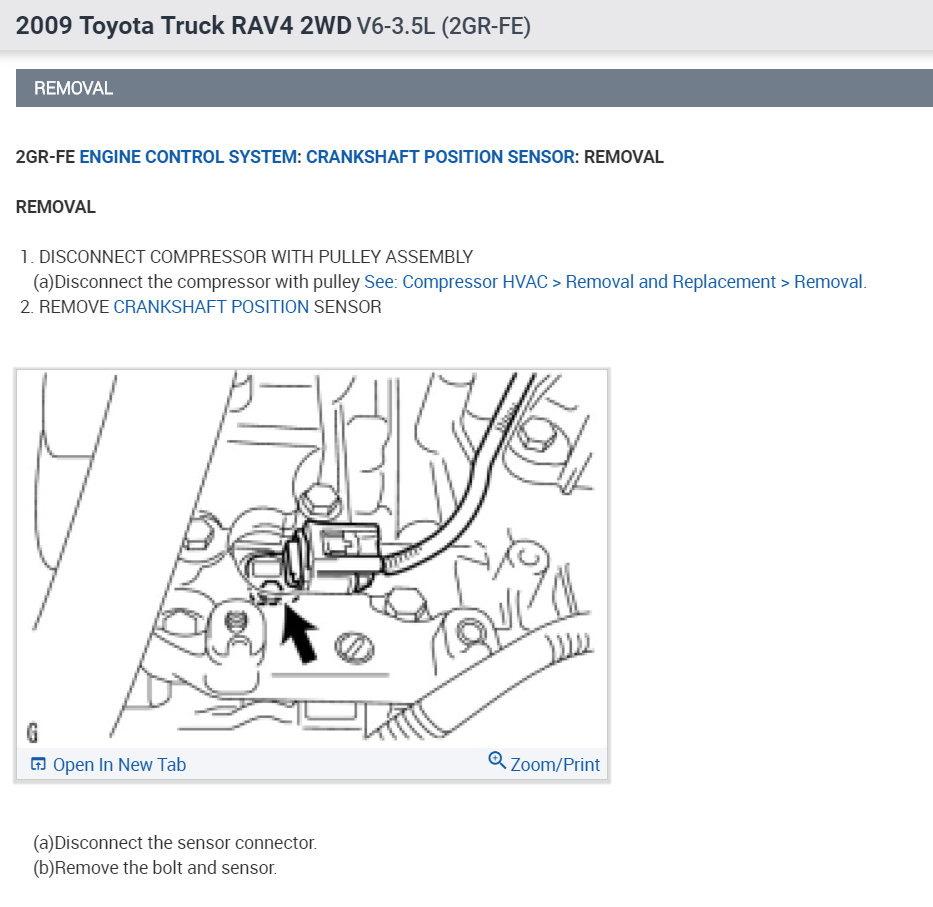

It sounds like the crankshaft angle sensor has gone out which will not allow the fuel pump to turn on here is a guide to help us and the location of the crankshaft angle sensor in the diagrams below.
Check out the diagrams (Below). Please let us know what you find. We are interested to see what it is.
Jan 19, 2017 at 11:04 PM
SHANNON_PRIV
Thanks you for the post I had this issue and had to get a new crankshaft angle sensor cost me $112.00 all fixed I love this site.
