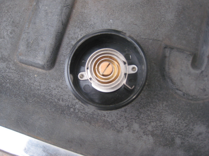

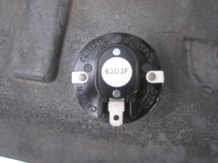

Thanks for the jokes. This device arrived today from NAPA and I will replace the old choke with this.
As you see, it has only one electrical contact, so I will most likely leave the old wiring the way it was.
In the meantime that old CJ is running better than ever before: If you play with the gas the first 5 minutes after it started or even less, when you moving again from a complete stop, there is no problem. After it is warmed up, no problem either. It runs with so much pep, I am amazed.

SINCE NEITHER ONE OF US KNOW HOW TO FIGURE OUT IF YOUR ORIGINAL CHOKE ELECTRICAL STUFF IS STILL THERE. AND YOU ARE AS LOST, AS I AM, IN FINDING IT!
I WOULD DEFINITELY >>>NOT<<< TIE BACK INTO YOUR RESISTANCE WIRE TO THE COIL (WHERE SOME GOOFUS TIED IN BEFORE). IT DOES NOT PROVIDE 12 VOLTS, AS NEEDED BY THE CHOKE HEATER.
ALSO YOU NEED SOMETHING, THAT DIES, WHEN THE KEY IS OFF

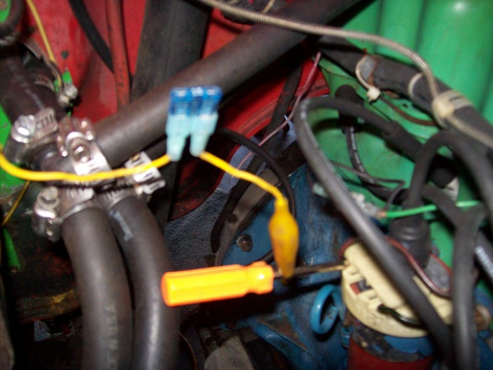

I SELECTED A GOOD 12V FEED, "HOT" ONLY WITH KEY ON, YOU CAN TRACE BACK TO AND TEST WITH YOUR VOLTMETER. THIS THING SHOULD PROBABLY CUT OFF AFTER YOU REACH OPERATING TEMP.I HAVEN'T FIGGERED THAT PART OUT YET, WITHOUT FINDING AND USING THE ORIGINAL GOODIES TO IT!
I WOULD PROTECT THE NEW CIRCUIT WITH MAYBE A 5-10 AMP FUSE (EXPERIMENT, 5 AMP--1ST!). USE 16 GAUGE WIRE TO RUN TO THE CHOKE WIRE (PROBABLY OVERKILL).
I AM SENDING AN EXAMPLE OF HOW TO RIG IN A FUSE, ON THE NEW WIRE, CLOSE TO YOUR SPLICE.
2 INSULATED FEMALE CONNECTORS AND A 1980s STYLE "SQUARE FUSE"DISREGARD THE REST OF THE PIC

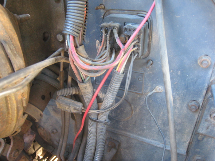

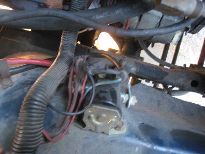

But. I just spent an hour trying to match those diagrams with the vast array of multicolored cables - all hidden away in plastic protectors with a slit.
Still not sure what what is.
It ain't easy.

All right, I have to give up. I can understand all the wiring diagrams, even understand the logic behind them, but for the life of me cannot translate them into this mess of wires bundled nicely into those plastic wrap arounds.
I guess what I am looking for is a big arrow pointed to a photograph of the wires of my jeep saying: here you need to splice etc.
