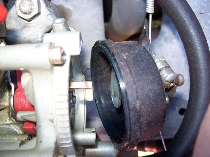

The choke adjustment:
I loosened the screws until the black housing turned
I touched the throttle: choke closed
Touched throttle again: Choke open
While having the choke open with the throttle fully open rotating the black housing did nothing
While having the choke closed while releasing the throttle, rotating the black housing did nothing.
There is a red mark on the black housing and on the body a prominent line with degrees CCW and CW.
I aligned the red marking with the center line.
I will leave the engine cold and uncranked in case we need to repeat the task

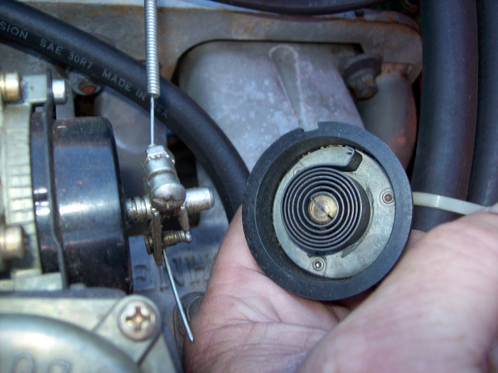

1) Lay out a towel or something under and around it. YOU WILL DROP THE SCREWS MULTIPLE TIMES!
2) Mark the top of the retaining ring with a marker, they usually only line up with the screws, ONE WAY. And it only springs into the black cap, ONE WAY!
3) Take out all 3 screws. The cap should almost fall off.

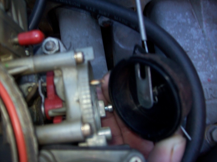

This is what it looks like inside. See the TAB in Pic 1, protruding from the aluminum housing, to the right?
The spring has a hook on it, it GRABS the TAB, if it's installed just before the TAB and slightly rotated
(disregard the cap in pic 1, its my MANUAL CHOKE, it takes the place of the spring)
The cap you have will look like PIC 2
Just put it back on, and rotate to catch the Tab, then re-install your retaining ring and screws. Then attempt the adjustment in the previous pics.

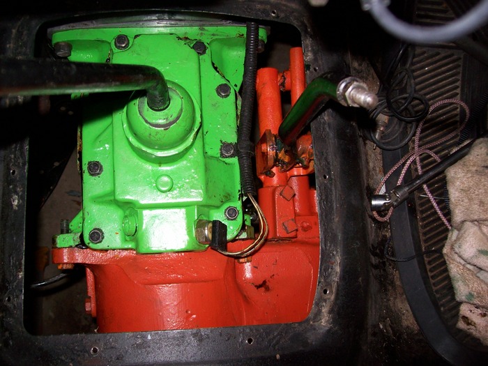

Like I said before, I like being in charge of when the choke is on or off, that's why I like a manual choke, I takes time to get used to it. Pulling it is no problem, it's remembering to Adjust/ or pushing it in, after you get to Op-Temp!
PIC 3 shows the cap provided with the manual choke kit, I had to install the shaft in it to the proper depth ETC (instructions), The TAB Just rides in the Forks (Nothing is permanently modified, so you COULD put it back, if you kept your original parts!)

Took it all off. There was a tab that with a slot where the spring would fit in. I made sure the spring was slotted through that slot.
Now: with the choke closed (everytime I open the throttle the choke stands nearly vertical = open), I turned the black housing CW until the choke barely opened; moved back just a tad. Tightened everything. Now the red marker has moved 3 marks CW.
I hope I did it correctly. If not, I will repeat

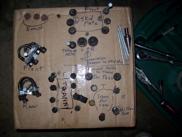

Usually the only "pain" with the Water pump, is Brackets attached to the bolts that hold it on, on some rigs you gotta get into tight spots to get the other bracket bolts loose, in order to move the bracket out of the way to pull the pump. Good pics as you go may help you reassemble if it gets a little complicated.
This is how I put the exact bolt back in it's original spot, label and put in the sequence it was in, this is my tranny and transfer case stuff.

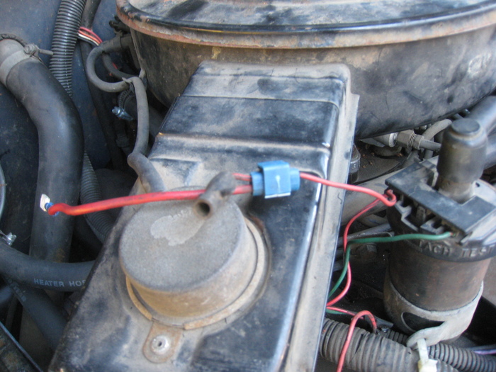

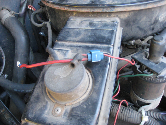

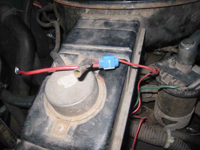

Re. Choke:
Drove it to operating temperature, checked position of choke valve with engine running: straight up or 90 degrees.
Will check in cold uncranked condition tomorrow
Tuesday, January 25th, 2011 AT 1:03 AM
KOEBES
  • 77 POSTS

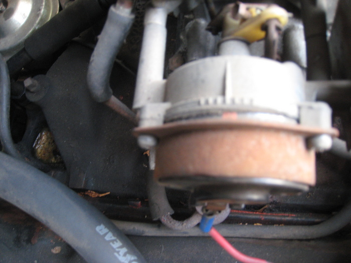

In cold condition: choke immediately fully closed once I touch the throttle. To get the choke to barely open a bit, I have to turn the black housing 45 degrees or more clockwise. Now it wouldn't start.
I think the spring is no longer good.
I also tested the cable. As you can see it's an odd cable: leaves the coil as a 2 mm cable, enters a splitter, and exists as thick 3 mm cable. The voltage at the coil was 12V with the ignition key in the "run" position, and 6 Volt at the connecting clamp for the choke. I am told (youtube) that you must have 8-12 Volts to operate the heating element and the spring.
Here's what I like to do:
- replace the connecting element on the coil: all those cable ends look ragged
- connect the coil to the choke with a 2 mm cable without any splitter or thicker cable in between
- replace the heating element and the spring in the choke.
What do you think?

I'm lookin' at my '71-'90 Chilton 1980 Schematics, The choke wire somehow goes thru a relay and a switch (I just glanced it over quick) IT DOES NOT COME OFF OF THE COIL!
My '77 had no electric choke heater, it used a tube that picked up heat off the exhaust manifold which entered the bottom of the choke housing--yours may still have that PORT on the choke housing. Simple was EZer in my book!
The Coils voltage is Correct, with what you tested. It gets an initial Full Battery Boost off of the Solenoid ("I" Terminal) while the key is in the "Start Position". After it starts, you release the key, "I" dies, and the coil receives REDUCED VOLTAGE, thru a RESISTOR WIRE that comes from the "ON" Position of the Ignition Switch.
For now, Try cracking your Choke open, When it's COLD, see How it does.
When it's not so cold here, many times I will Pump my pedal 3 times, and never pull the choke on (manual choke). It maybe a little cold natured the 1st 3-4 minutes but after it gets warmer, no problem!
I would get yours off of the coil and redo it like it's supposed to be. Or CHANGE TO A MANUAL ONE!
