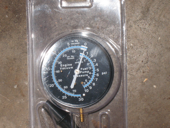

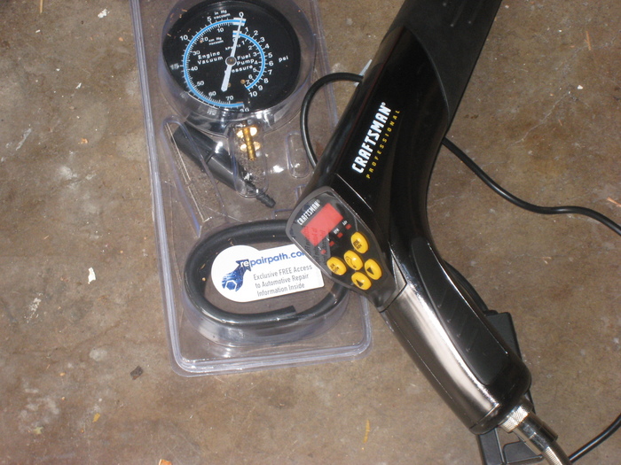

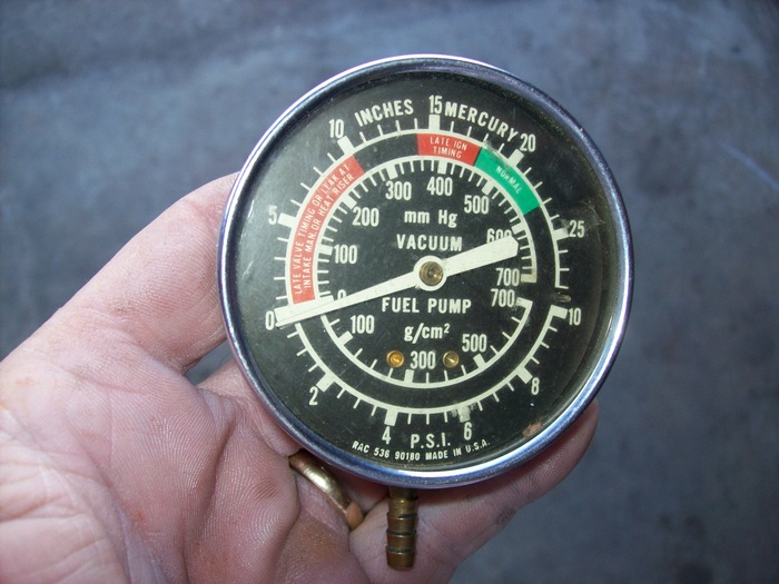

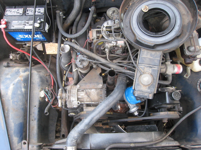

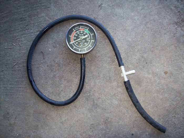

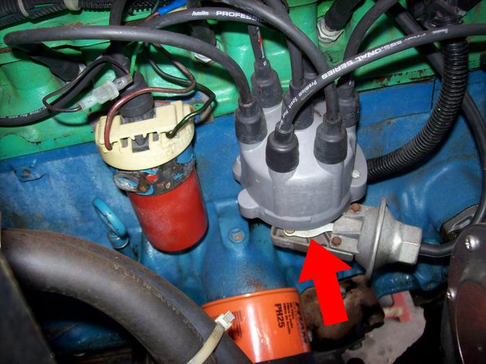

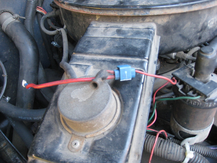

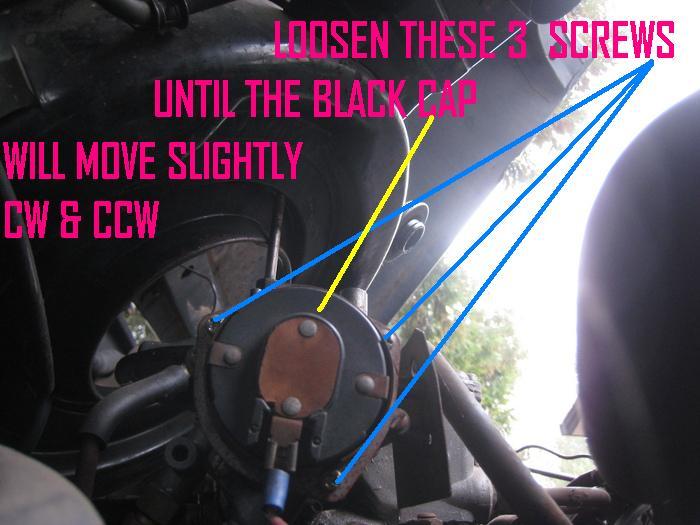

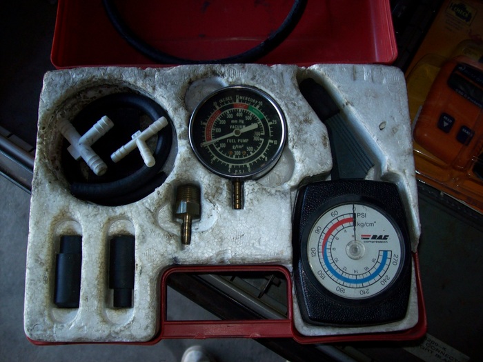

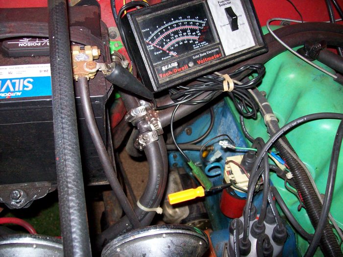

I want you to test Vacuum at idle, engine at operating temp.....See my diagrams above.
Then I want to make sure Vacuum lines look wonderful, ALL UN-USED T.I.T.S ARE CAPPED OR PLUGGED WITH A SHORT HOSE AND A BOLT
And TIMING is confidently right! (CHECK WITH A LIVE LINE (20 Hg?), THEN HOOK YOUR OLD ONE BACK ON.......EVEN A NEW DISTRIBUTOR MIGHT NOT WORK RIGHT, WE JUST WANT TO VERIFY IF DOES GO FULL TRAVEL, WITH THE "LIVE LINE", REGARDLESS WHAT THE "PORTED ORIGINAL" DOES
WE STILL HAVE NOT VERIFIED, VACUUM LINE LOCATIONS, ARE YOU ABLE TO COMPARE YOUR LOCATIONS WITH ONE OF YOUR VACUUM DIAGRAMS IN YOUR MANUALS, TO "MAYBE" VERIFY THEY ARE CORRECTLY HOOKED UP?......REMEMBER TO USE THE DIAGRAM FOR YOUR YEAR AND ANY OTHER SPECIFICS ABOUT YOUR JEEP, SUCH AS: 49 STATE, 304, YEAR, WITH OR WITHOUT CERTAIN ACCESSORIES.

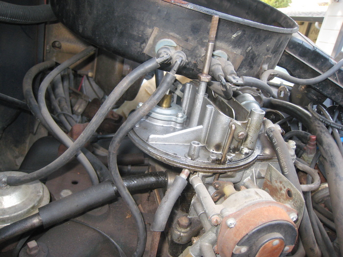

We will move on to carb tuning

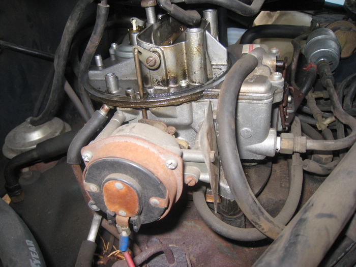

I want good close carb pics, well lit, even using a Shop light if you must! A MIRROR, IF NEED-BE!
You can always come back an Tweak stuff to make it better, that we have already covered
YOU MUST GET USED TO THIS STUFF.
EVERYTHING IS DONE AT OPERATING TEMP!
YOUR CARB LOOKS REALLY CLEAN, IS IT NEW OR REBUILT RECENTLY?

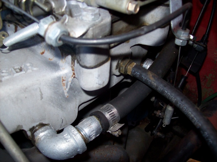

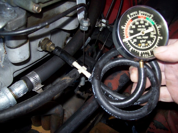

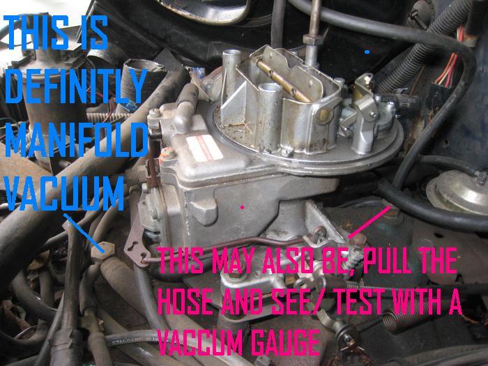

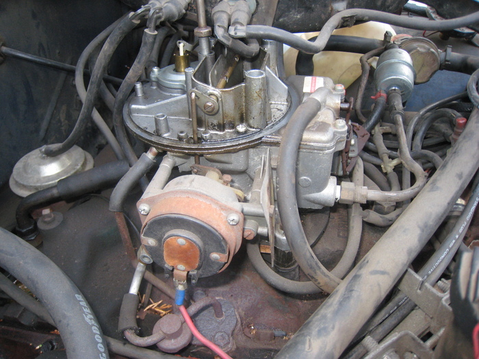

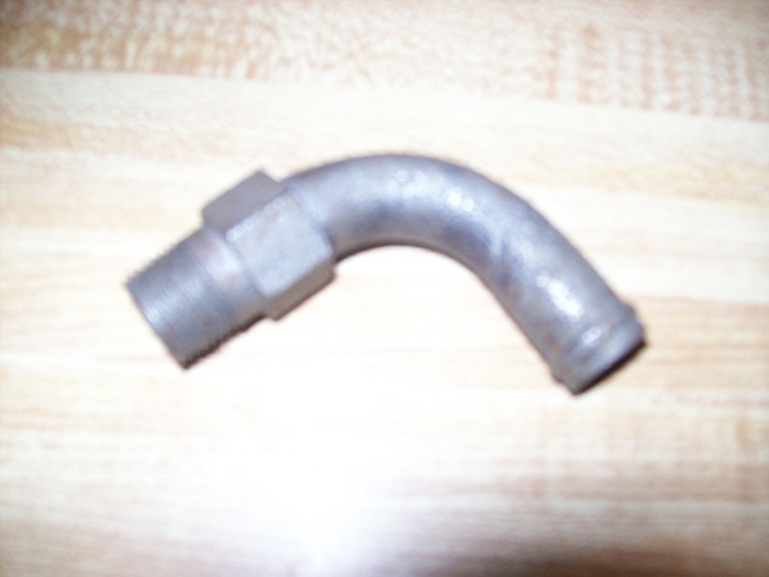

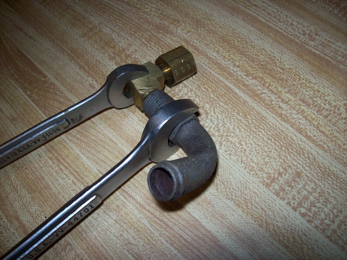

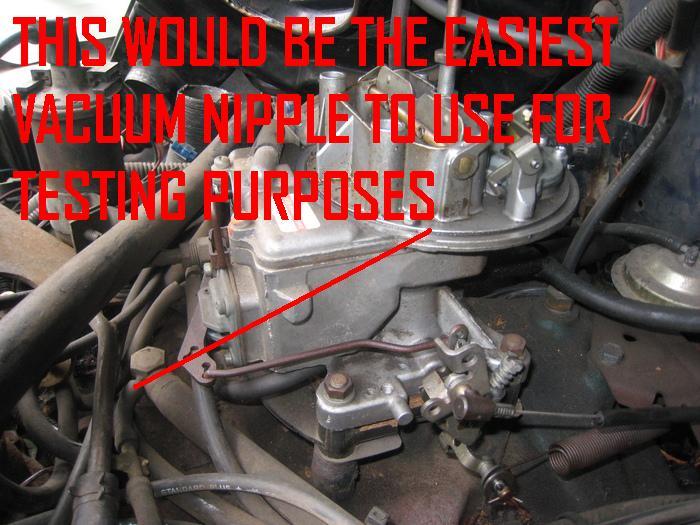

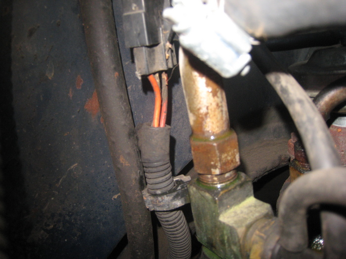

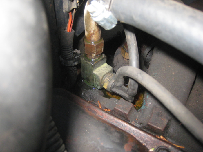

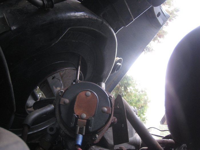

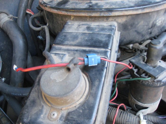

Taking your suggestion from the photograph: the easiest nipple to use for testing purposes, I hooked up the T and with the engine running at idle the vacuum was -19 mm Hg. I guess that's excellent. Then I made sure the engine remained tuned at +8 degrees without vacuum and then hooked up the distributor's vacuum hose to that active line; it advanced to +21 degrees. I guess that's good, too.
Now everything is connected the way it was.
The carburator (pics will follow) is a rebuilt one. I think my son put it in in 1999.
Thanks for the photo with the suggestion where to test the vacuum. Made all the difference
Jan 17, 2011 at 12:19 PM
KOEBES
  • 77 POSTS

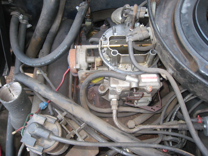

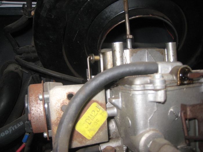

Here are the pics
Jan 17, 2011 at 12:33 PM
KOEBES
  • 77 POSTS
Correction: that were -19 INCHES Mercury or Hg

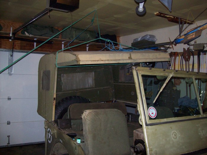

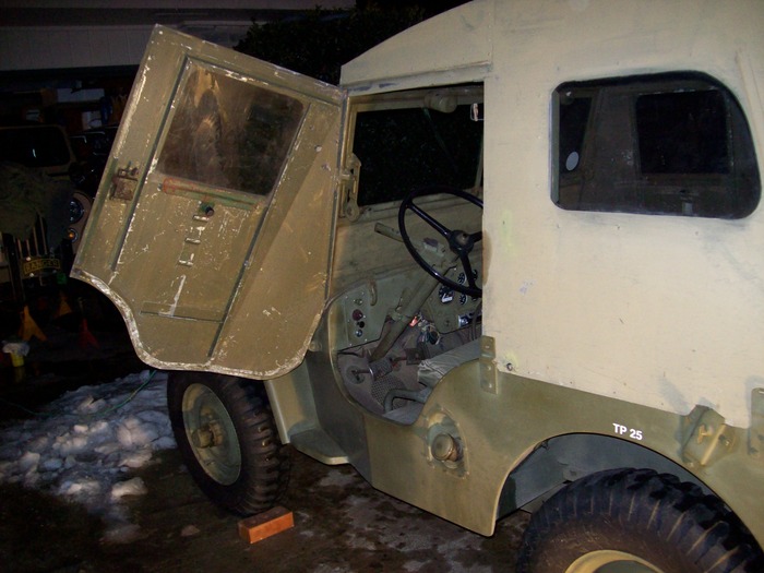

Just got back from a 140 mile round trip with Willy, Went to a 4X4 Sorta Does it all place, way back in the "Sticks", in Pickens, S.C.
It is still snowy, icy and muddy up there, at the base of the mountains!
They were really nice to me and the owner gave me a Super Spectacular deal on a looks to maybe be a Entire Serviceable Used Transfer Case, minus shift linkage.....I may be walkin' in High Cotton really soon............Either he's that nice of a feller, Felt sorry for me, or just wanted rid of me! (Maybe Willy, impressed him!)
I went by the "Home-place" and retrieved my top out of the woods (been there 15 or more years, cause I just don't drive Willy in the Winter!)
It needs painting (not now!), I reworked the sides to fit over my summer top hardware, and I weather stripped the doors. It's a sight! (1953 Sears "Allstate" Aluminum top, made by Grumman Aircraft!) It was New in the box, when the feller sold it to me, in 1992,.......$50!!!
We will "TUNE" your carb as soon as I write it up in "WORD", then copy and paste it in here......REALLY SOON!...Gotta work on Mr. Jeep for a bit, before I play! (a couple or 3 days)........please understand!
The "Happy Now" Medic
Here's My "Vintage 140 mile, at 45 MPH, Trip"!

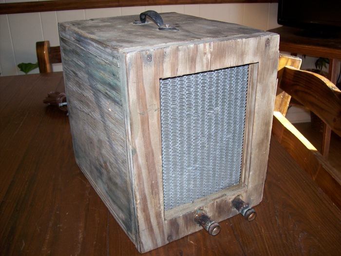

1) Modifying and installing, last resort, with 2 of 4 vehicles down......Warmth!
2) The original 20 year old, homemade "SAHARA BREEZE" (wood edition!)
3) I have one of these, made out of sheet metal in "Mr. Jeep" as backup heat.
4) Ain't that.....Sorta Pretty?......Its, "Take your coat off" Hot in there now!
5) Hatchback
6) "Butterfly Doors" (See, it ain't a new thing, only for "High End" sports cars!-----With "Ratchet Up Windows"! (blow this up, and check 'em out)
7) This is what it looks like to Drive a "REAL JEEP"!
8) This is what it looks like if you are "With"...."Me and Willy"!
9) Tis is what you do when the plastic holding the mirror, Rots out!...GPS "Rubber Banded" above it!
10) This is leaving my NEWLY FOUND, HARD TO FIND, JEEP PARTS SANCTUARY!..........He does it all, and he has a lot of older parts, IT'S EVERYWHERE!, IT'S EVERYWHERE!........Gotta find you, one of these, in your area!!!

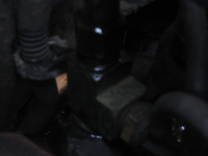

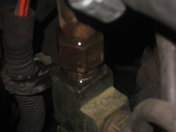

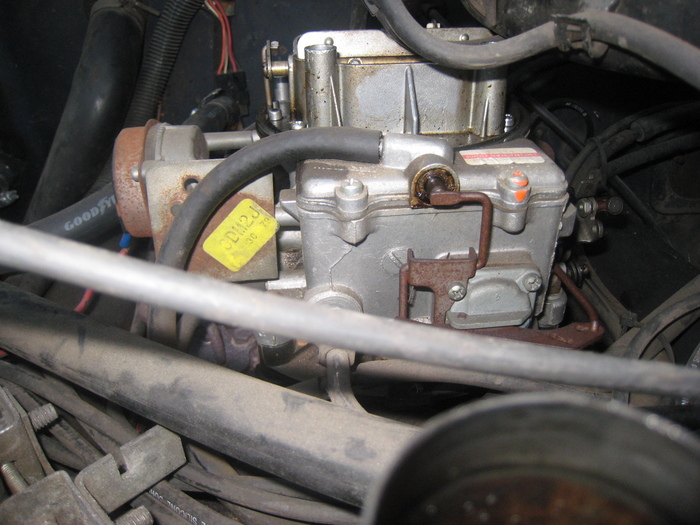

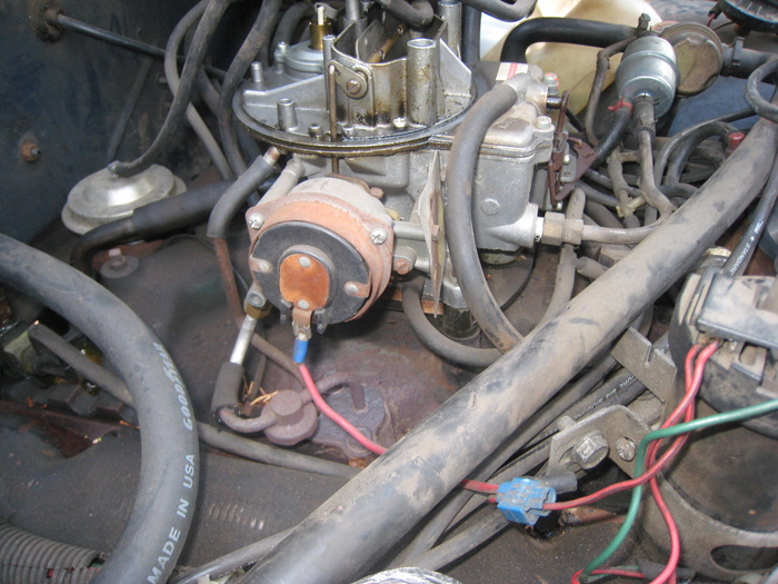

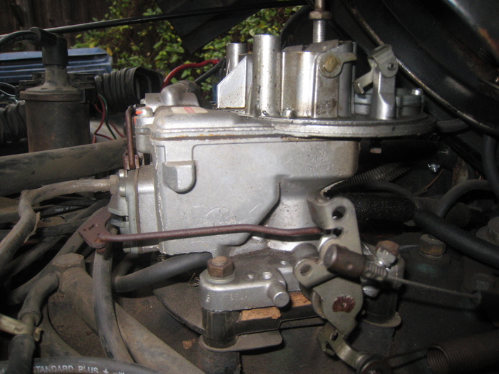

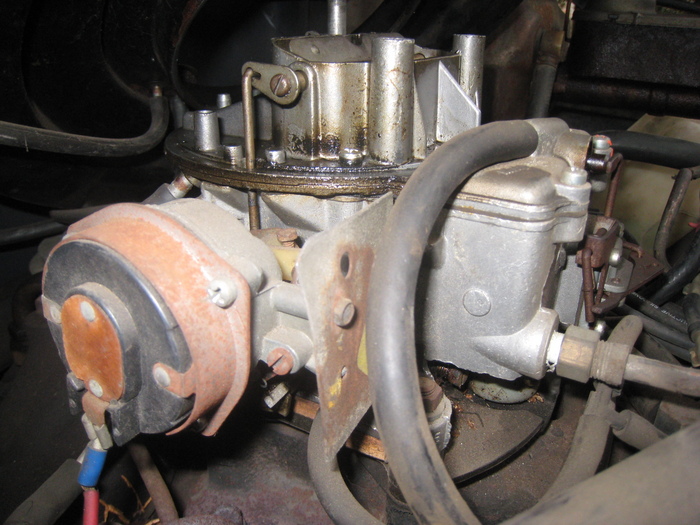

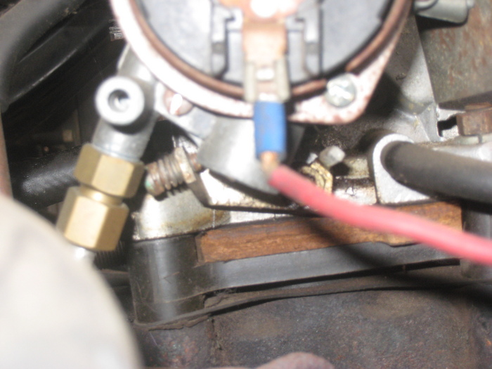

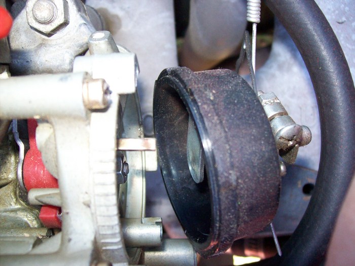

I want a few shots in between the CHOKE SPRING HOUSING, and the CARB BODY-----Close and in FOCUS (above, front, and rear, if possible)

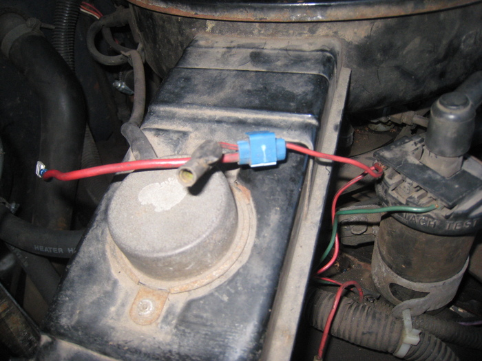

Not ready yet with the carb stuff, I've got a buddy coming over to help me go over, my newly acquired transfer case and check end-play and such on the output shafts, before I put it in.
Before I throw my suggestion on you I want you to Get your Jeep to operating temperature, then take your vacuum line off of the DISTRIBUTOR, then CONNECT your new toy, Mr. Vacuum Gauge to the line. I want to know if vacuum is present and how much? (no need for a tee, just the gauge on the line)
I thought maybe you might want to try something....I have my "6 cylinder" set up this way, and it runs really well!
In the pics before, I showed you how to test MANIFOLD VACUUM, using a "TEE" and some vacuum hose.....Letting everything remain being hooked up, but the GAUGE was connected to the "New Line" that you gained with the tee.
This time do the same hook up, except this time do this:
1) remove and cap off the distributor vacuum line with a bolt
2) It might take a longer hose from the "tee", but instead of installing the gauge on the line, hook that line to the Distributor.
3) Now your distributor will be getting full Manifold Vacuum constantly (at idle, anyway).......This will Vac Advance the distributor fully at idle and at normal High Vacuum Times while running.
4) When you do this, Idle speed will increase (mine smooths out greatly!), Tune it back down to 700 RPM, using your Tach.....A previous pic, showed you the "IDLE SPEED SCREW" (idle screw) in which you will back your speed down with.
5) I know we haven't done the Carb yet, but run this a while, like this, just to see if you get Running/ Driving improvement...........DO NOT JUMP OUT IN TRAFFIC, UNTIL YOU KNOW IT WORKS and PROVES ITSELF!!!....I'D HATE TO HEAR THAT YOU GOT HIT BY A TRUCK, WHEN YOUR JEEP HIC-CUPPED 5-6 TIMES AND STAMMERED, 'CAUSE YOU DID NOT HEED MY WARNING!!!!!!
6) IF IT'S NOT WORKING WELL---PUT IT BACK TO THE WAY IT WAS!!!!
7) If this, in some kinda way will not get you thru an emissions test, put it back (at least till it does) SO WHAT I'M SAYING IS---REMEMBER WHAT YOU DID, AND UP YOUR IDLE SPEED BACK TO 700 RPM, IF YOU DO PUT IT BACK!........Do not forget to plug the "OLD" distributor line.
Let me know how it does.

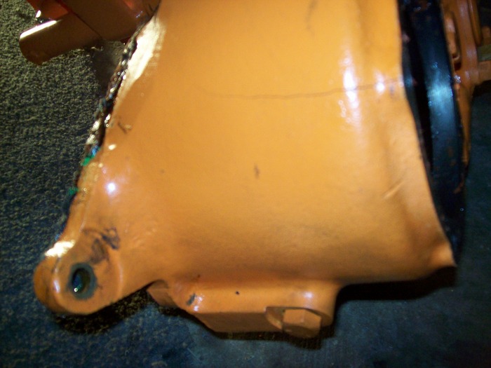

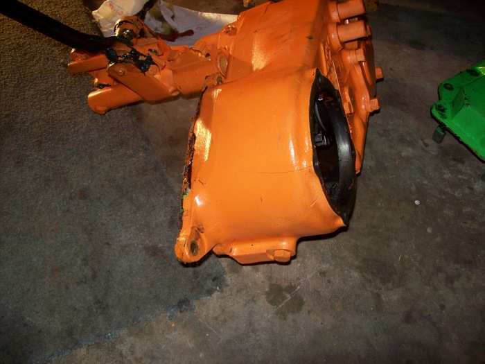

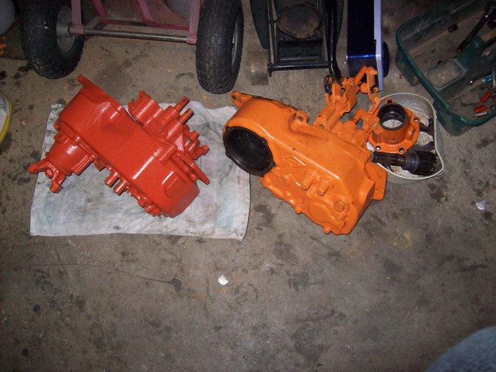

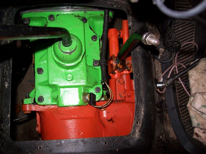

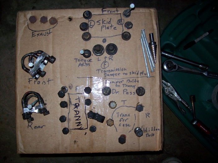

Here's my newly acquired case in the "Rough" The Yoke was a little loose...........Thats it on the left, I figured I'd clean and paint it, before we got oil on it, when we are messing with it! I still have to steal the linkage, plugs, and vent off of the cracked one. I repainted my "Hardtop", with 5 cans of spray paint. I'll get you a pic of that soon.
I KNOW, I KNOW.....We'll get to your carb!!!.....Yours runs, Mine Don't (yet!)

Nice looking and nicely painted transmission. I hope you're on the road soon again.

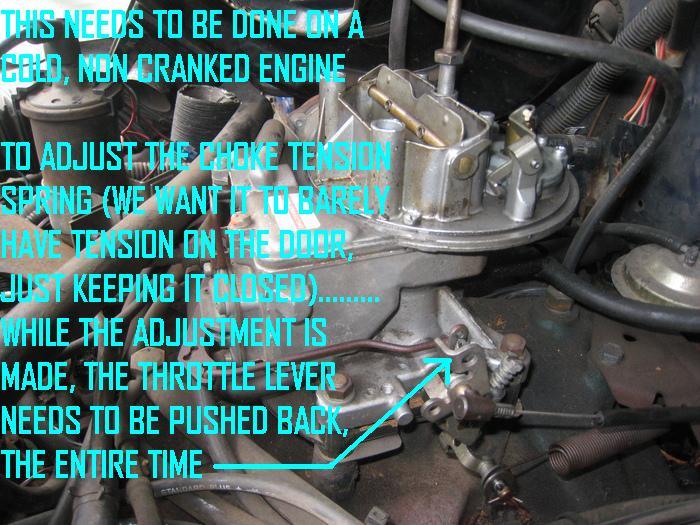

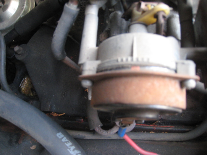

Here in the S. Fr. area is spring like weather: I am tempted to take off the doors and everything short of roof.

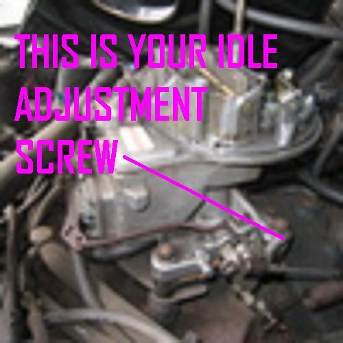

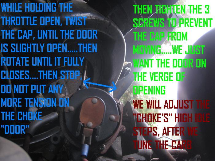

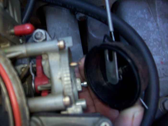

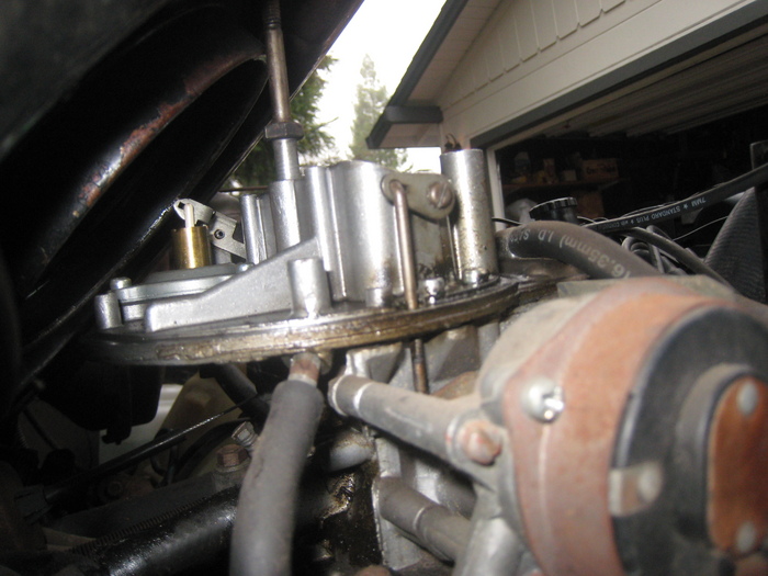

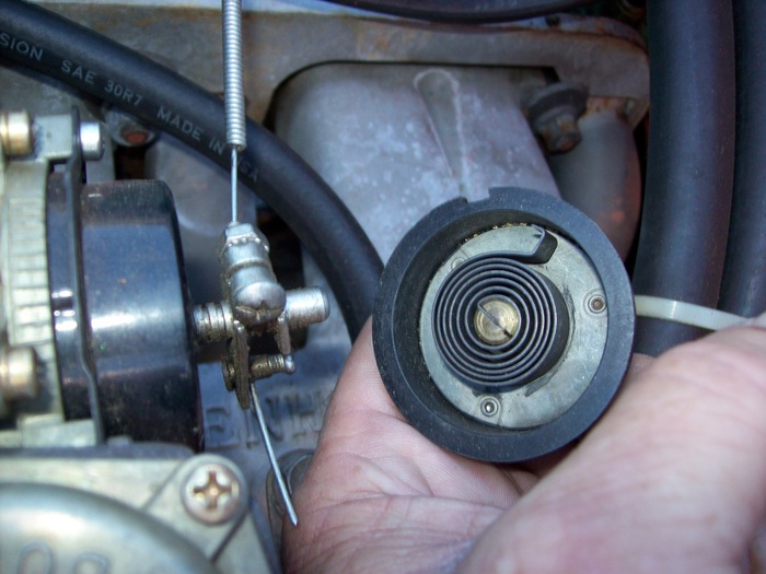

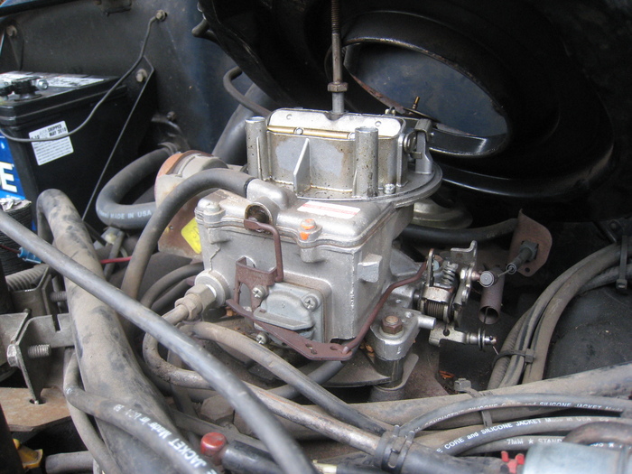

Okay: here's what I did. I ran the jeep on many errands cruising back on the interstate; it was at optimal operating temperature; I disconnected the vacuum hose from the distributor; connected it to the gauge: -21 inches Hg. If I increased the RPMs so did the negative pressure. So that's good!
I then realized that at optimal operating temperature it was running at 860 RPMs. Played with the idle screw until it was 700 RPM, looked at the timing; was off by 2-3 degrees; readjusted. Running fine.
This kind of choke I have I cannot find in any manual. Anyway: I looked at the choke valve in the morning before starting the car: it was standing vertical, straight up. I started the engine and it closed as it should.
I took some pictures but they don't come out that well. The close ups are so blurry that they are useless.
Anyway, here they are.
No hurry; the jeep is running well

ALL RIGHTY THEN!
CARB ADJUSTING IS REALLY CLOSE TO READY!!!
WHEN I SEND IT, IT'S GONNA BE LONG!!! (TOO LONG!), I WILL SEND IT, "A LITTLE, SOME PICS, A LITTLE, SOME PICS" SO DON'T "BUTT IN", TILL I HAVE ALL OF IT TO YOU!.....I WILL SAY, "I AM FINISHED AT THE END"

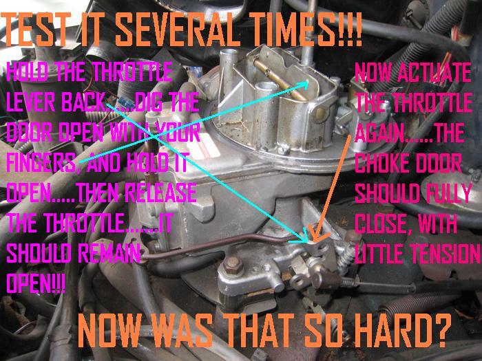

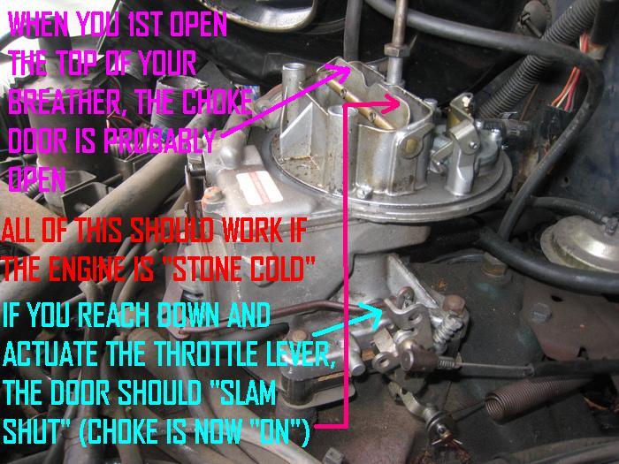

NOW LET'S SEE IF YOU PACIFIC COAST FELLERS CAN PERFORM A TASK, WITH NOTHING BUT PICS???? HERE THEY ARE!!!

Those pics are great!!!!
I will try it first thing tomorrow morning

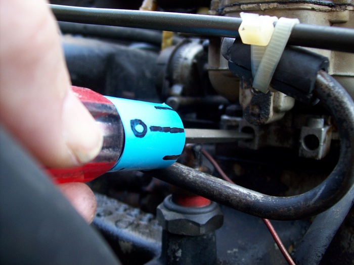

PEAKING OUT YOUR BBD CARBURETOR (and others)
As you know, I am a Knit-Picky, Drill Sergeant Type; Wife says I’m “A.n.a.l” (wonder why, she has to be so mean?)……..At the end of this “NOVEL” I will kinda, Sum it all up, and it will then, sound EZ to do!
I want to verify our “Accelerator Pump” is still providing, A good squirt into both barrels!

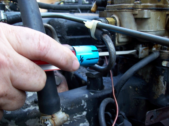

ENGINE IS OFF! Look into Carb.
With a flashlight (NOT a “BIC” lighter!), Slowly pull your throttle back, you should see 2 “PERTTY” squirt gun streams of fuel, shoot, one into each barrel---Equal size, to each other!
This fuel AIDS in your engine, getting a burst of energy, to “GO”, Every time you push the gas pedal, WITHOUT THIS, YOUR JEEP WILL HESITATE and maybe die, EVERY TIME YOU ACCELLERATE! (This could maybe be one reason, for a hesitation)If we do not get 2 even squirts, Carb may/should be repaired (rebuild) or replaced………..This may be the “HOLE”, that you say you are falling into, Lets get the Mix right, then we will play with the Accelerator Pump!
Ready to tune Mr. Carburetor?
Remove your air cleaner assembly………Cap/ Plug off any vacuum lines/ T.i.ts you disconnected (on the engine end) when you remove it!
THIS 1ST PART IS IMPORTANT!!!

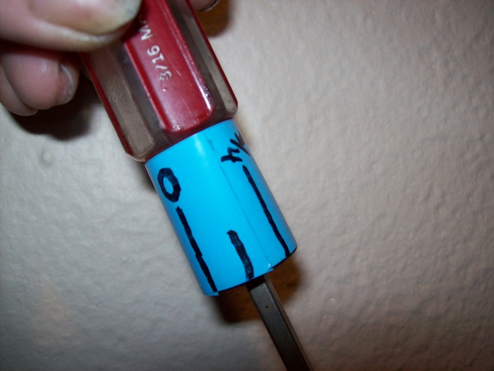

1st thing we are going to do is figure out where we are set now, just in case we have to come back to this point.

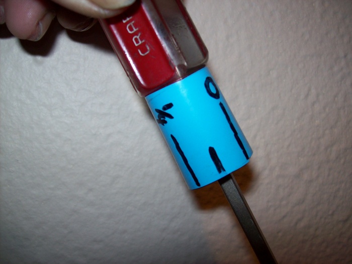

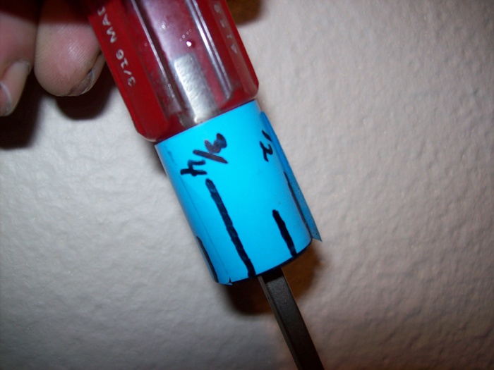

Go to the front of your Carb, there are 2 “Mixture” screws (some carbs the adjustment may be somewhere else), they may be exposed, or they might be inside a little Tunnel.
When we move these screws, we are going to do it slow.
WHEN! We bottom out, we are going to GENTLY TOUCH BOTTOM (NO MORE THAN THAT, NO FORCING!!!, Just an EZ touch)
If someone in the past has “Went Too Tight” our orifices may be “WALLERED OUT” (one orifice may be larger than the other, air flow will be exponentially more than the other) and precise adjustment may not be achieved.

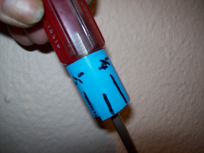

The next thing we need is a screwdriver; it must be LONG/SHORT ENOUGH to get to these screws, in your little “Obstacle Course” in front of the screws (stay away from the FAN!) It must fit the SCREW SLOTS WELL! (Slipping out, without knowing, means you lost your count!)
You may want to mark the Screwdriver handle with Tape ETC. so that you have 4 ------DIFFERENTLY MARKED------ increments (1/4 TURN MARKs for Reference! I PREFER 2, 180 degree marks line up with the screwdriver blade) we will be counting Turns, as you get better with this, you will graduate to 1/8 increments! You will be able to watch the flats of the screwdriver and have no need for marks!
I have whipped up a “Beginner Type” adjustment/counting screwdriver---with a piece of tape and a marker. MINE has 1/8 marks, But ONLY the “¼” increments are labeled with numbers.
As you rotate MINE, COUNTERCLOCKWISE---it reveals “0”, then “¼”, then “½”, then “¾”, then back to “0” (THIS WOULD BE THE COUNT AS YOU ARE BACKING OUT ON A SCREW!) ----“GOING IN”, you just gotta keep up with increments!
MY “0” and “½”, CORROSPOND WITH THE THIN PARTS OF THE SCREWDRIVERS BLADE (NOT THE FLATS, but this really makes no difference)
I MUST REMEMBER, GOING THE OTHER WAY (CW), I MUST TRANSLATE THE INCREMENTS “BACKWARDS”!
YOU CAN MARK IT ANYWAY YOU WANT! ! ! (RED MARKER “IN”---BLACK MARKER “OUT”---(in this optional scenario, My BLACK “1/4”; would also be my RED “¾”, My BLACK “¾” would also be my RED “1/4”.
AS LONG AS YOU AND YOUR ASSISTANT UNDERSTAND………DO AS YOU WISH!!!

I AM SHOWING A 2 BARREL 6 CYLINDER “CARTER BBD CARBERATOR” IN MY PICS
We are going to call the screw ON THE DRIVERS SIDE-----NUMBER 1 SCREW (1st PIC).
The other will be NUMBER 2 SCREW (2nd PIC).
NUMBER 1 is the most important, because #2 is just going to be “ALONG FOR THE RIDE”, during every adjustment. (Whatever you do to #1, ……..You will do to #2 Also!)

To see where we are now, Install screwdriver in #1 watching your reference marks, turn it CLOCKWISE IN, till it touches bottom, EVER SO GENTLY!....YOU WILL BE COUNTING, I LIKE COUNTING ½ TURNS…….EXAMPLE, I MAY HAVE “6”—1/2 TURNS AND “1”--1/4 TURN ( IN REALITY THIS IS 3-1/4 FULL TURNS)
Insure Your “Too Wide” Screwdriver, scraping the sides, is not FOOLING YOU! [Get one that fits easily into the “Tunnel”], you will be counting the turns, ACCURATLY down to the 1/8th (yours will vary DRASTICALLY, from mine!) Throwing “STUPID” Numbers, mine is: 4-1/8 “Full Turns” or 8-1/8 “1/2” Turns----RECORD THIS NOW, before you forget!..............Then Do #2………..4-1/4 Turns (or 8-1/4 “1/2” Turns-----RECORD IT TOO!

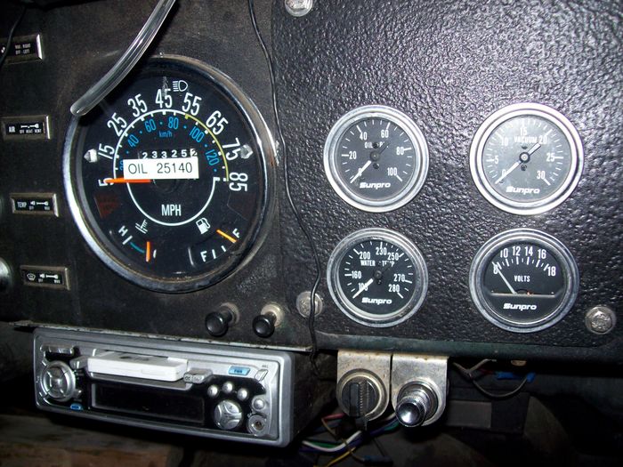

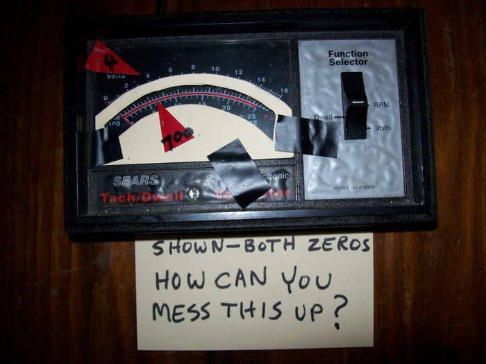

We have 2 ways to set the Carb, Vacuum Gauge or Dwell/Tach meter (Either way will work). For now we will use the DWELL/TACH METER. I like this method for several reasons: You can see “MICRO” movements of the needle, you can adjust Idle, up or down to RE-ZERO where you are at, and it’s a tool you already need! (no need for both, vacuum gauge and tach)
Peak Vacuum should = Peak RPM
After you get good with the 6 cylinder scale, you can just watch the tip of the needle (more precise) on the “GENERIC” outer scale (on my meter, it’s the voltmeter scale) to MAXIMIZE Precise, minute adjustments……….the tip of the needle would be observed for improvement, but the “4” or “6” or “8” cylinder scale is used to “REZERO” back to correct Idle speed, or a Good reference mark that is close to idle speed
I have sorta rigged my meter so ONLY the 6 cylinder scale shows ”AND” the top scale (voltmeter) shows. Basically: to find 700 RPM quickly, and maybe “Just a Tweak off of 700 SLIGHTLY” to line up on a really CLOSE-BY voltmeter line [the up-most scale on my meter] (the most sensitive end of the needle)
Pic 1) You can use a vacuum gauge to adjust, Pic 2) You can use a Tach/ Dwell Meter to adjust, Pic 3) You can cover the scales that do not pertain to your engine, and mark reference points (so you do not get confused)

I’m a plumber, I wanted to see if this Tach Method was as good as using the vacuum gauge, we had a Job Going at work, that had this real expensive vacuum gauge going in. The gauge was very sensitive, and was about a foot in diameter, lots of increments, compared to my automotive vacuum gauge, which is about 3 inches. Minute changes are FAINT and Hard to detect, on it.
I sorta borrowed it, for a day, before it was installed. We hooked it to my Jeep, along with the Dwell/Tach, I adjusted my Carb., using the Giant Vacuum Gauge. Then we maxed it out with my Dwell/Tach meter. I came up with nearly the same settings. So I’m pretty much sold with the TACH method!............Another use the one you want to, its all about improving the needle on either one!

Its decision time, we must pick our meter ZERO POINT. (I’m using the 6 cylinder scale for my RPMs, this is a 258, I’m using as an example)
On my meter, at this speed (700 RPM), I am really close to a mark on the upper scale [tip end, sensitive part of the needle), If your meter is like mine, the mark I chose, is at the tip of the needle (4 VOLTS, Since I am referencing off of the Voltmeter scale) this is ever so slightly DOWN, from this original idle mark.( In other words, I’m not quite at 700 RPM, using the 4 Volt mark, slightly off is OK!)
Every time you re-zero your IDLE SPEED, for now, Will be “4” on voltmeter scale (700 on the RPM scale). You already know, it is really slightly under 700 RPMs

These instructions are AWESOME; I have to digest them first. But I identified screw #1 and #2. I think I have to read your instructions 4 times, and probably print them out, before I attempt to tune this carburator. But your idea with a tape around the screwdriver and marking it in 1/2, then 1/4s and then 1/8s is great.
In the meantime the CJ is dripping cooling fluid like crazy: the fluid drips off the harmonic balancer and seems to come from the passenger's side, just above the timing marks. I have no way to lift the car to see what's going on; if I can't find what it is I might have a shop take a look at it. from above it looks dry, from below it is wet, can't pinpoint the leak
Jan 22, 2011 at 2:08 PM
CJ MEDEVAC
  • 11,000 POSTS
Sounds like the Water pump
Use a bright light and a small mirror to look for it!
Many times, they drip from a small hole on the bottom of the pump, when they start going bad.

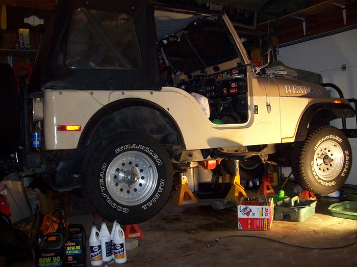

Today I ventured again in changing oil and oil filters, both on the Jeep and the 1986 VW Vanagon I bought 2 months ago. I gave it up because to deal with the used oil became a problem. Now I found out that the garbage collection picks up used oil in the proper containers (they are gallon milk containers with a green top) every week; just place the container and the old oil filter next to your recyling stuff garbage can - gone. No extra charge.

Carburator still listed as a work project; how do you cap those vacuum intakes of the engine; can you buy little round wedges or other kind of stoppers or is it "improvise the best you can"?

I like Vinyl Vacuum caps----Rubber ones rot---Next best is "Fuel Line" with a bolt crammed in it!
Most parts stores have them, you might call around to find one with "Vinyl Caps"......Many have a "HELP!" section, the caps there are usually Rubber.

I'm gonna throw in a Carb Pic with some on it (most were installed on it, to keep the Dirt Daubers out, while it is stored) The Screw being turned is is the idle on a Carter BBD 2 BBL (this is my old carb, I have a 4 bbl on my 258 6 cylinder now).....On this carb is the other screw is for the high idle steps (choke related) Your steps are BETWEEN the CHOKE and CARB......There are 2 adjusting screws there, DO NOT MESS WITH THEM, TILL CARB IS TUNED, I WILL INSTRUCT YOU ON HOW THAT WORKS TOO!

The choke adjustment:
I loosened the screws until the black housing turned
I touched the throttle: choke closed
Touched throttle again: Choke open
While having the choke open with the throttle fully open rotating the black housing did nothing
While having the choke closed while releasing the throttle, rotating the black housing did nothing.
There is a red mark on the black housing and on the body a prominent line with degrees CCW and CW.
I aligned the red marking with the center line.
I will leave the engine cold and uncranked in case we need to repeat the task
Jan 23, 2011 at 10:06 AM
CJ MEDEVAC
  • 11,000 POSTS
ROG,
The adjustment needs to be made with the throttle held back (open) and engine cold----then tighten the screws......Then Test!
Have you taken the thing apart before?
Your spring may be broke, or just not grabbing the Tab.
It's EZily checked
1) Lay out a towel or something under and around it..........YOU WILL DROP THE SCREWS MULTIPLE TIMES!
2) Mark the top of the retaining ring with a marker, they usually only line up with the screws, ONE WAY!......and it only springs into the black cap, ONE WAY!
3) Take out all 3 screws....the cap should almost fall off.
This is what it looks like inside....See the TAB in Pic 1, protruding from the aluminum housing, to the right?
The spring has a hook on it, it GRABS the TAB, if it's installed just before the TAB and slightly rotated
(disregard the cap in pic 1, its my MANUAL CHOKE, it takes the place of the spring)
The cap you have will look like PIC 2
Just put it back on, and rotate to catch the Tab, then re-install your retaining ring and screws.......Then attempt the adjustment in the previous pics.
Like I said before, I like being in charge of when the choke is on or off, that's why I like a manual choke, I takes time to get used to it. Pulling it is no problem, it's remembering to Adjust/ or pushing it in, after you get to Op-Temp!
PIC 3 shows the cap provided with the manual choke kit, I had to install the shaft in it to the proper depth ETC (instructions), The TAB Just rides in the Forks (Nothing is permanently modified, so you COULD put it back, if you kept your original parts!)
You know, I have a Walmart Album, all about this....Did you see it, still have it, or do I need to re-send it to you?

Took it all off. There was a tab that with a slot where the spring would fit in. I made sure the spring was slotted through that slot.
Now: with the choke closed (everytime I open the throttle the choke stands nearly vertical = open), I turned the black housing CW until the choke barely opened; moved back just a tad. Tightened everything. Now the red marker has moved 3 marks CW.
I hope I did it correctly. If not, I will repeat

The wire into the cap is nothing more than a little heater, to help the spring warm up faster and the choke come off faster.
Now you sorta know the technique of how it works, you might want to tension it shut a little more than I told you at 1st.
I'd say maybe after 2 miles of driving (from stone cold), it should be standing vertical.....Your Jeep is probably at operating temp in that amount of time, and the choke should not still be closed (or even partially closed)
If you are at operating temp and the Door is not Vertical,
Kill your engine, loosen the screws slightly---hold the Throttle arm open, twist the black cap a little, until the "Door" is "just" standing Vertical (w/ just a little spring tension) ----Then release the throttle
Next morning (Do not touch the accelerator) while its cold, open the top (it should be vertical), move the throttle and the Choke should close completely up (full choke, for a cold start).......again get to operating temp and see if it got pulled completely "Off", while it is running (it should be full vertical)
I'm not sure if the wire to the choke, remains "Hot" Constantly, it probably will be as soon as you start up, that would be the time to check it.......if not check it after a little warming up.
What about that water pump?....You game?......Is it the water pump leaking?
The Medic
Jan 23, 2011 at 7:50 PM
KOEBES
  • 77 POSTS
Let me do all that tomorrow. I'm not sure whether the choke is vertical at operating temperature. Will report back tomorrow.
Bought myself at Autozone one of those mirrors with a telescope handle. Still couldn't see anything. Maybe I need a light under the motor.
But - let's assume for a moment - it is the water pump. I have the tools you said I needed, for $55 or so I can get a new waterpump. If you help me putting it in, and I still have the manuals to make sure we're singing off the same page, I'd be happy to try it.
But - to reemphasize it - the jeep is running better than before. Maybe it's just because I want it that way, but there's more pick up in it.

Usually the only "pain" with the Water pump, is Brackets attached to the bolts that hold it on, on some rigs you gotta get into tight spots to get the other bracket bolts loose, in order to move the bracket out of the way to pull the pump. Good pics as you go may help you reassemble if it gets a little complicated.
This is how I put the exact bolt back in it's original spot, label and put in the sequence it was in, this is my tranny and transfer case stuff.

Re. choke:
Drove it to operating temperature, checked position of choke valve with engine running: straight up or 90 degrees.
Will check in cold uncranked condition tomorrow

In cold condition: choke immediately fully closed once I touch the throttle. To get the choke to barely open a bit, I have to turn the black housing 45 degrees or more clockwise. Now it wouldn't start.
I think the spring is no longer good.
I also tested the cable. As you can see it's an odd cable: leaves the coil as a 2 mm cable, enters a splitter, and exists as thick 3 mm cable. The voltage at the coil was 12V with the ignition key in the "run" position, and 6 Volt at the connecting clamp for the choke. I am told (youtube) that you must have 8-12 Volts to operate the heating element and the spring.
Here's what I like to do:
- replace the connecting element on the coil: all those cable ends look ragged
- connect the coil to the choke with a 2 mm cable without any splitter or thicker cable in between
- replace the heating element and the spring in the choke.
What do you think?

I'm lookin' at my '71-'90 Chilton 1980 Schematics, The choke wire somehow goes thru a relay and a switch (I just glanced it over quick) IT DOES NOT COME OFF OF THE COIL!!!
My '77 had no electric choke heater, it used a tube that picked up heat off the exhaust manifold which entered the bottom of the choke housing--yours may still have that PORT on the choke housing.....Simple was EZer in my book!
The Coils voltage is Correct, with what you tested........It gets an initial Full Battery Boost off of the Solenoid ("I" Terminal) while the key is in the "Start Position" ...........After it starts, you release the key, "I" dies, and the coil receives REDUCED VOLTAGE, thru a RESISTOR WIRE that comes from the "ON" Position of the Ignition Switch.
------------For now, Try cracking your Choke open, When it's COLD, see How it does.
When it's not so cold here, many times I will Pump my pedal 3 times, and never pull the choke on (manual choke)......It maybe a little cold natured the 1st 3-4 minutes but after it gets warmer, no problem!
I would get yours off of the coil and redo it like it's supposed to be.....or CHANGE TO A MANUAL ONE!!!!

Looking at those Chilton wiring diagrams for a 1980 jeep I can't find anything that leads from somewhere to the choke thermostat.
anyway, I am having a hard time finding a replacement for that choke thermostat; one in NAPA parts on line for $37.50 looked exactly like mine; so when I wanted to pick it up at the local NAPA affiliate, the owner couldn't find it; when I called him from home later and gave him the part number, he stated it was for 6-cylinder jeep. I really don't think it makes any difference whether the choke thermostat is for a straight 6 or a V8.
No; haven't touched the carburator yet. Have to get up my courage and first of all get some screwdrivers of the right length that will allow me to work there.
So unless there is a contraindication, I will try to get the choke thermostat for a 6 cylinder from NAPA, install it, apparently the manual should tell you how many degrees it should be advanced or retarded (which I can't find anywhere), then connect it with a 2 mm wire to the coil (wouldn't know where else to,) and then see how that works

I looked at the Chilton Wiring diagrams: they start with a 1971 jeep and end with a 1986 jeep. There are 3 diagrams for a 1980 jeep, 2 of which are duplicates. The distributor is at the bottom, not center here, and at the bottom left there is blower motor and switch etc.
The coil has a red cable coming in from the ignition switch, and a red cable leaving going to an unmarked device. I can't figure out what the symbol stands for: it's a box with a central line to midline that looks like an inverted T, then space, then a downward curved short line, on top of another vertical line ending in a dark triangle, which outside the box has a triangle on its head, not solid but in lines.
I think this means it a capacitor. Could that be the thermostat??
I know a manual choke would solve my problems; your Wal Mart instructions are well done. Let's see.

"IT'S ALIVE"---MR. JEEP IS ALIVE AGAIN!!!
I HAVE 15 MILES ON IT, I'M STILL A LITTLE GUN-SHY, I'M WORRIED STILL, IT HAD NO REASON TO LACK OIL IN THE TRANSFER CASE AND SHOULD HAVE LUBRICATED THE OUTPUT SHAFT, IN FACT, I DRAINED OUT THE ENTIRE AMOUNT OF OIL NEEDED TO CORRECTLY FILL IT,BEFORE I DROPPED IT THIS TIME. I HAVE A FRIEND WHO SAYS HE SAW SOMETHING SIMILAR WITH A TRUCK, WHERE A PIECE OF GASKET FLAKED OFF AND COVERED THE HOLE THAT OIL CIRCULATED IN....I'M STILL WORRIED, I PULLED OVER TWICE AND FELT THE OUTPUT HOUSING, TO SEE IF IT WAS HOT.
NO NOISES ALL SEEMS OK
WHAT ABOUT YOUR CHOKE ISSUES, MADE A DECISION YET?
IT WAS 26 DEGREES, WHEN I CRANKED UP THIS MORNING. I DID NOT USE THE CHOKE, 1ST PATTED THE GAS 3 TIMES AND HE CRANKED RIGHT UP.......WITHIN A MILE IT WAS RUNNING WELL, WITH NO SYMPTOMS OF BEING COLD (HALF CHOKE WOULD HAVE MADE IT BETTER, FOR THE 1ST MILE), BUT I WAS LAZY, AND I DO NOT "JUMP OUT" INTO TRAFFIC, UNTIL HE'S 100% OPER.TEMP.
THE MEDIC
LOOK, "WILLY" IS BACK IN THE GARAGE!!!---NOW WE GOT TO GET THE NEON I GAVE $250 FOR, 4 YEARS AGO, BACK OUTSIDE, AND GET WIFE'S ESCAPE'S TRANNY REBUILT (WAY BEYOND MY CAPABILITIES)AND GET IT BACK IN THE GARAGE!!!.........WHEN SHE GETS HAPPY, I WILL BE THAT WAY TOO (THATS HOW IT'S EXPLAINED TO ME!)THE NEON IS TOUGH, WE DROVE IT 3 MONTHS OFF AND ON, AND THE 23 YEAR OLD STEP-DAUGHTER, ABUSED IT FOR 4 YEARS, "WHILE SHE WAS GETTING ON HER FEET", AND WOULD NOT FIX HER OWN RIG.

IT SAYS IT'S A GROUND....I IMAGINE JUST BY LOOKING AT THE CONNECTOR, IT LOOKS LIKE WHATS ON THE OIL SENDER AND TEMP SENDER WIRE.....SO MY GUESS ITS THE SAME BUT, PUSHED DOWN OVER A "BOLT STUD" THAT IS A ON THE GROUNDED BODY OR ENGINE.
YES, I'D SAY YOU "NEED" A CHOKE, YOU NEVER KNOW WHERE YOU MIGHT WIND UP IN A JEEP.
THE CHOKE KIT COMES WITH A ANGLE BRACKET, THAT CAN BE SCREWED TO THE BOTTOM OF YOUR DASH (YOU DO NOT HAVE TO GO THRU THE DASH LIKE I DID)

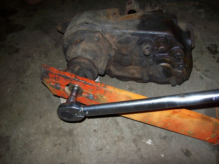

SORRY I THOUGHT YOU WERE TALKING GREEN ON THE WIRING DIAGRAM!!!---THE GREEN IS MY T-150 3 SPEED TRANSMISSION, THE RED-ORANGE IS THE DANA MODEL 20 TRANSFER CASE----DUMMY!!!.........YOURS ARE SIMILAR, JUST NOT AS PRETTY!!!
THATS 100 FLUTTER KICKS.......I WILL GET YOU JEEP KNOWLEDGEABLE YET!!!
