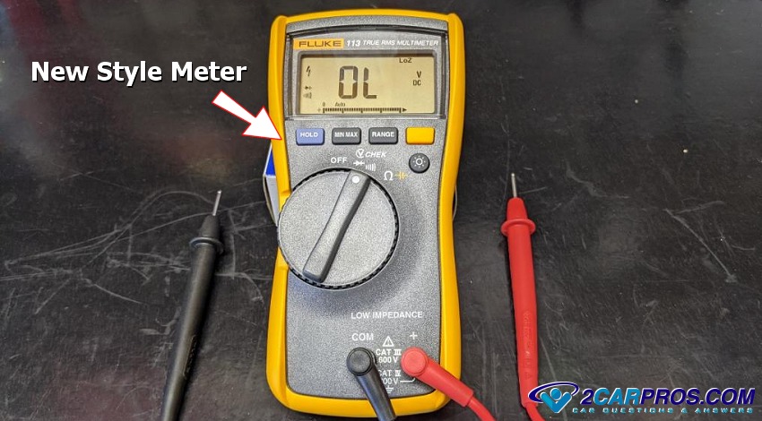

Checking supply voltage, this is used when a system voltage needs to be tested, let's say the fuel pump is not working and you want to see if you are getting 12 volts at the pump before you try removing the pump from the tank. After finding the feed wire color using a wiring diagram, set the voltmeter on DC voltage. Connect the ground lead of the voltmeter and use the positive probe to pierce the wire, turn the key to the on position and the voltmeter will display the system voltage. If wiring diagrams are needed you can ask the 2CarPros community to supply you with the information (free), or consult an online resource such as AllData DIY (pay). After testing seal the pierced wire with silicone rubber and electrical tape. Advanced voltmeters will "self detect" AC or DC voltage which we show in the images below.
new voltmeter

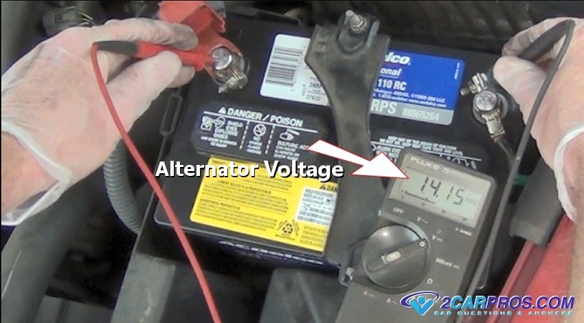

When a battery warning light comes on while driving it means there is a problem with the charging system. In this case the alternator output will need to be tested, this is done by starting the engine and allowing it to idle. With the voltmeter set to DC voltage, connect the leads to their respective terminals, the voltage should be between 13.7 and 14.2 telling you the alternator is working. If battery surface voltage is observed the alternator is probably bad or there is a blown fuse or wiring problems.
alternator voltage

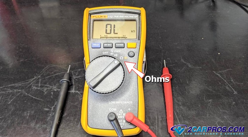

The ohms setting is handy when testing sensors such as an engine coolant, oxygen, crankshaft and camshaft sensors. Switch the voltmeter selector to Ohms to start testing.
voltmeter ohms

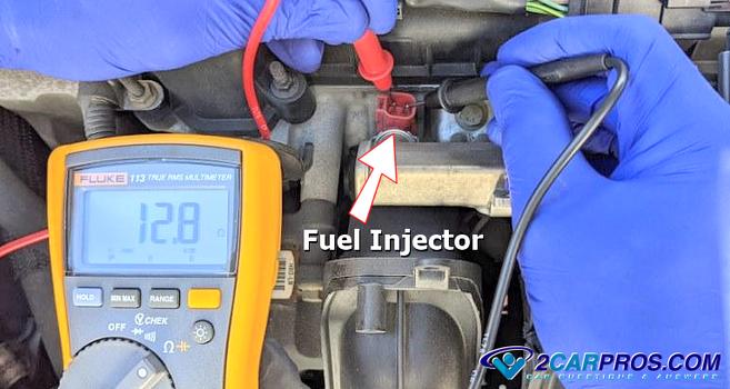

When testing coil based items such as a fuel injector or ignition coil a voltmeter comes in handy. With the meter set on Ohms, attach the meter leads to either side of the terminals, the meter will display the resistance reading of the coil windings. If the reading is too low it means the internal coil windings are shorting out. If the readings are too high the coil has an open circuit, again a new part works well for comparison.
fuel injector testing
