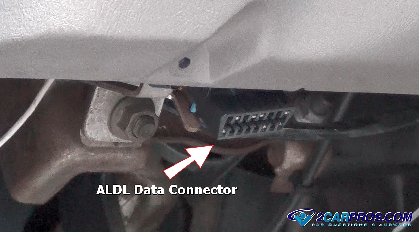

With the vehicle's engine off, have your code reader in hand. Locate the ALDL "D" shaped 16 pin connector located under the dashboard on the driver’s side in plain sight, in most cases. If you cannot find your car's connector it can be behind a small plastic trap door or have a cover over the connector. Can't find it? You can ask one of our experts to help for free.
aldl connector

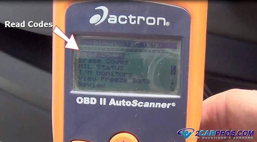

After the welcome screen appears, follow the prompt which will include: Read Codes, Clear Codes, MIL Status, I/M Data, Freeze Frame Data and Code Review. While using the up and down arrows select the "Read Codes" option. This will allow the reader to configure a connection to the automobiles computer and display the error codes, this can take up to 15 seconds. If the reader or scanner "hangs" on the working screen for over two minutes, turn the ignition key off and restart the process.

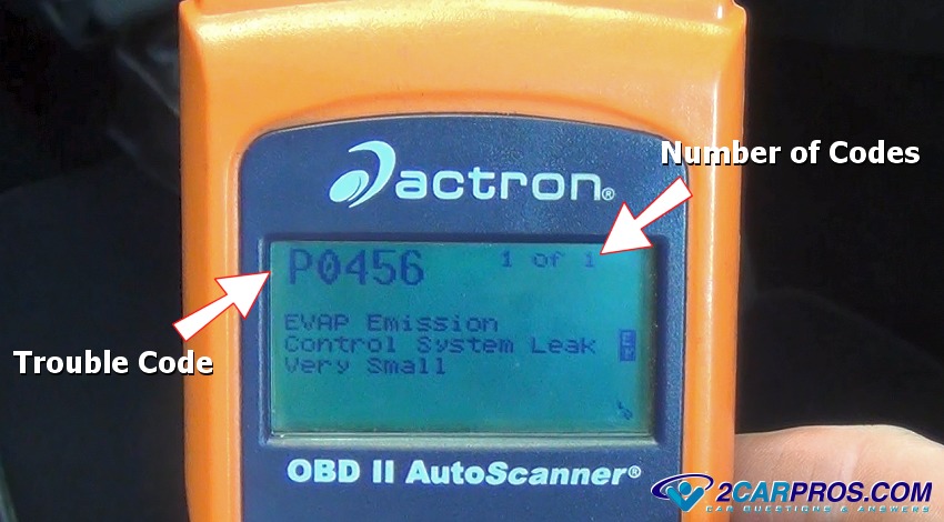

 If there are multiple codes stored it will say 1 of 2 or 1 of 3 which is an indication that more than one code is present. In this case there is one code number, P0456 which is for a small EVAP leak which can be a loose gas cap or a broken vacuum line in the EVAP system. Use the up and down arrow buttons to toggle between the codes so you can identify each code and start the repair or have an idea of what the problem is, turn the ignition key off and perform the repairs. If multiple codes are present, start with the lowest code number which can cause additional codes to be triggered.
codes displayed

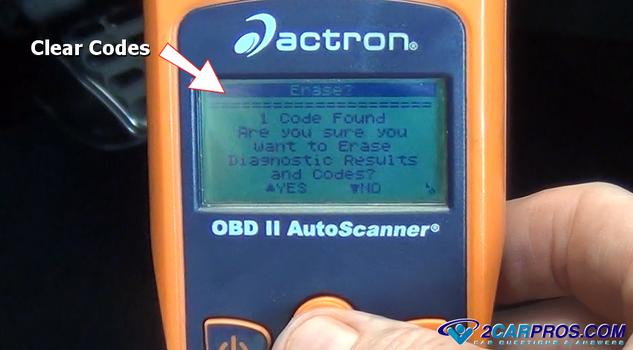

Once the repairs have been made you must clear the codes to reset the system and turn the check engine warning light off. Navigate to prompt the scanner to clear all trouble codes and then hit enter, the code reader will then display a pass message if no problems are detected. This pass state might be temporary if a problem still exists which will only show up after a while of driving. The check engine light will come back on immediately if a hard code problem is detected. Watch the Video
clear codes
