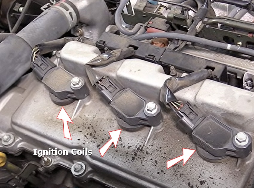

In the example below the engine is designed with a plastic cover for aesthetics, this may pull straight off with clips or small screws or bolts which will facilitate the removal. Here you can see the ignition coils exposed, in this example we are showing three cylinders of a Toyota V6 engine designed with a COS system (coil over spark plug) which uses no spark plug wires.

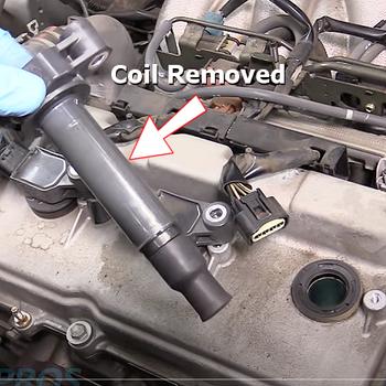

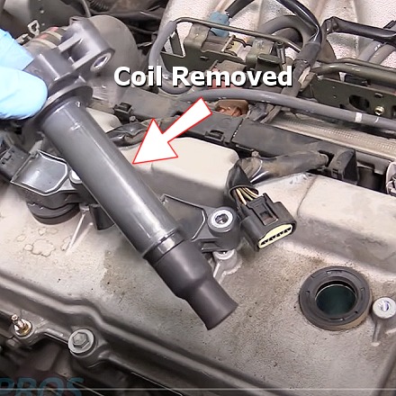

Although you may be able to remove the coils without disconnecting the wiring, it makes for a cleaner job if you unclick the wiring connector safety and remove the wiring connectors from each coil. Remove the coil mounting bolts which is usually a 10mm as in this case, then remove the ignition coils and inspect for corrosion or signs of arcing, replace as needed.
ignition coil removed

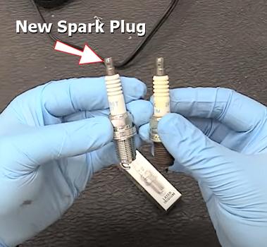

Compare the new spark plugs to the old ones to ensure the correct plug is being installed.
new spark plug
In most cases spark plugs do not need to be re-gaped as they are manufactured to the correct measurement for each application, but this gap should be rechecked and corrected in case it was altered during shipping, the video below will show you how. The gap is important because it determines the amount of resistance used to "time" the ignition system. An incorrect gap can cause low power and poor mileage.
