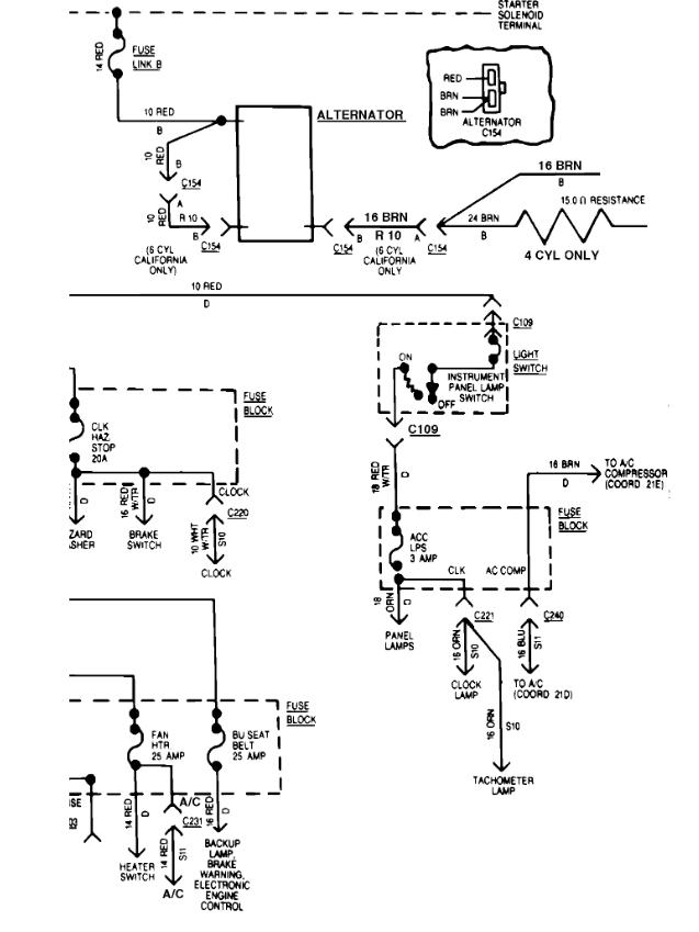

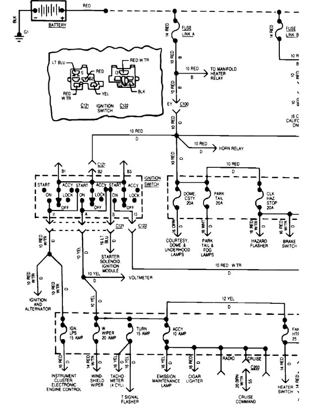

So, the battery is new, correct? Because it sounds like it has a low voltage battery. Also, does the engine turn over by hand? I would try that first, here is a video to help you:
https://youtu.be/oN42gZN6gOE?si=tMpp0g6IKMjsiUgE
If the engine turns over by hand and the battery is good let's see if you are getting 12 volts to the trigger wire of the starter when the key is in the crank position.
This guide can help:

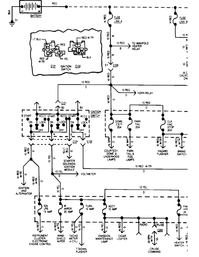

Here are the wiring diagrams for the starter in case you need them. Check out the images (below). Please upload pictures or videos in your response of any problems so we can see what to help you with.

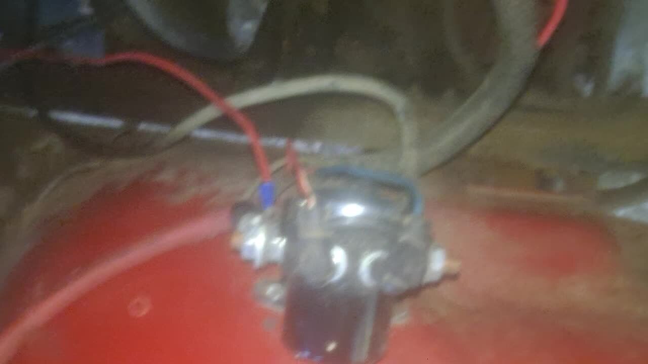

also, the solenoid is on the fender inside the engine compartment not next to the starter so the starter has a wire coming from the solenoid to the starter and the solenoid has 3 wires on the hot side and the starter wire goes on the other side and i watched a video of how it's done when i put it on and i watched many of them and the ones i watched said the same thing and i picked the one i could understand best.

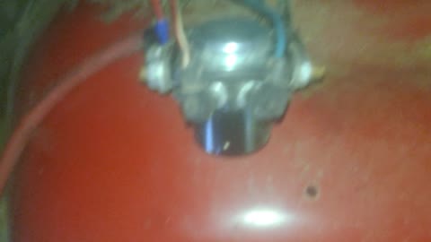

I can get a video of the engine bay I can't use a battery in it right now like I have said above I use a battery from another car and that car is having issues staying reliable since it has 200k miles on it and I don't want to mess with it when it's running fine right now. i can get a video tomorrow it's been raining for me, and I don't want to open the engine bay when it's raining.

Also, the loose wires were never connected at any time from 1985 until now and it clicks right around the coil/starter solenoid area, and I know about the bad video quality it's the best I can get.
Sep 20, 2024 at 1:02 AM
  • 55,399 POSTS
Thanks for the video, so the small wires at the solenoid, does one of them get power when the key is in the crank position?

but can you please send me a complete wire diagram of the wire harnesses on the fire wall as a reference if anything happens to the wires i know if they are important to starting it or not.
Sep 26, 2024 at 4:54 AM
  • 55,399 POSTS
Check out the first post, these are the main starter wiring diagrams.
