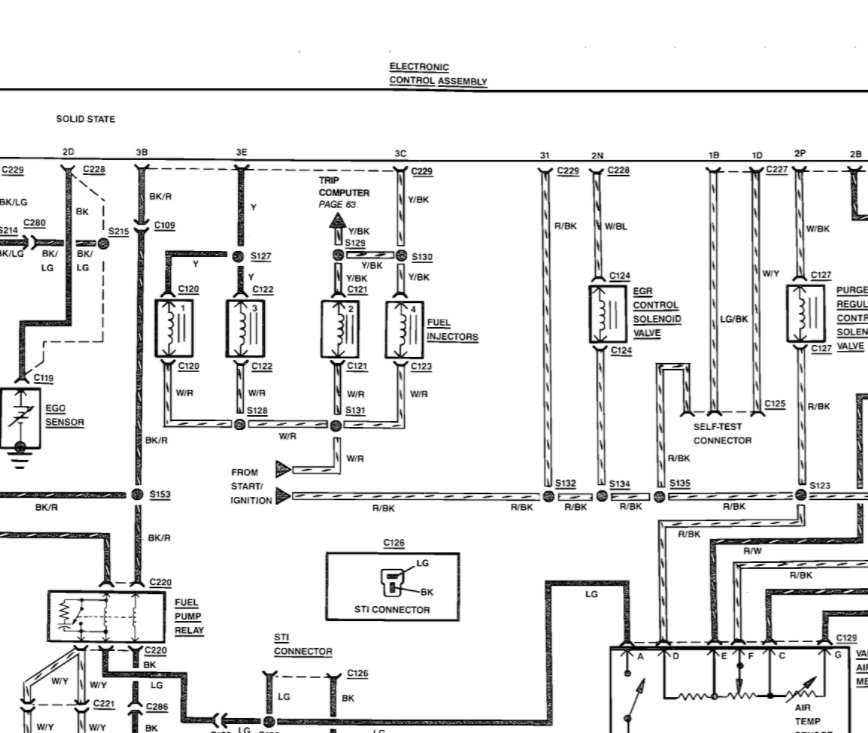

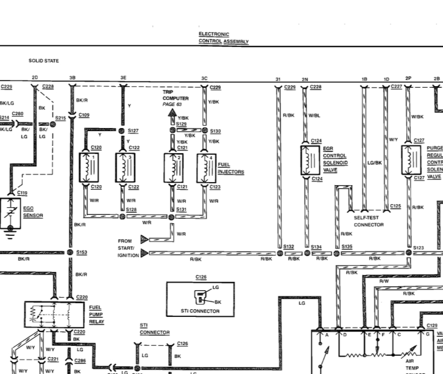

Thank you. How I tested the injectors first I unplugged 1 took my test light 1 end ground put the key in turned on ignition both thermals had power then I took the ground off put on the positive side battery tested the control wire had my friend crank and the light tester blinked or flashed or pulsed. My Chilton book said I am supposed to have 64 to 80 PSI fuel mine is 2.2l turbo on the 3.0l engines is 30 to 40, but i'm not getting 60. Will the injectors release fuel if the pressure is too low? Then is that the fault of the pressure regulator? Please and thank you for helping me.

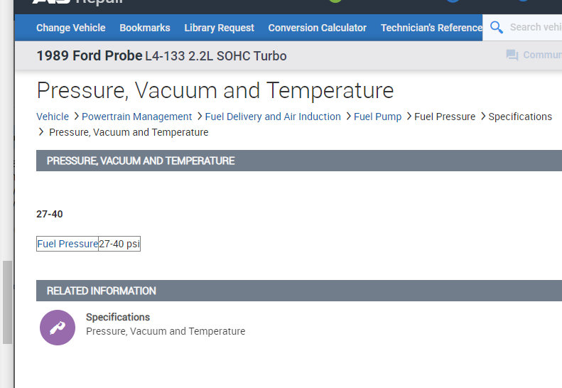

I think we are at a stalemate because we keep covering the same info over and over.
We show that the 2.2L SOHC turbo engine has a pressure spec of 27-40 PSI.
I understand your manual shows something different and I can't explain why that is. Below is a screen shot from AllData and Mitchell says the same thing.
So the facts remain that you are able to start the engine on starter fluid so you have a fuel delivery issue.
I asked you to do a couple of things and Roy has asked things as well but not seeming to get that info back. If we are not going to make progress on these things then I am not sure we are going to be of any help to you.

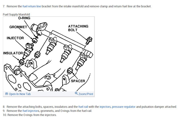

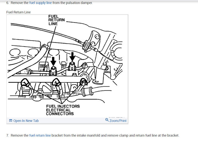

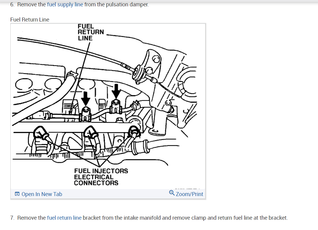

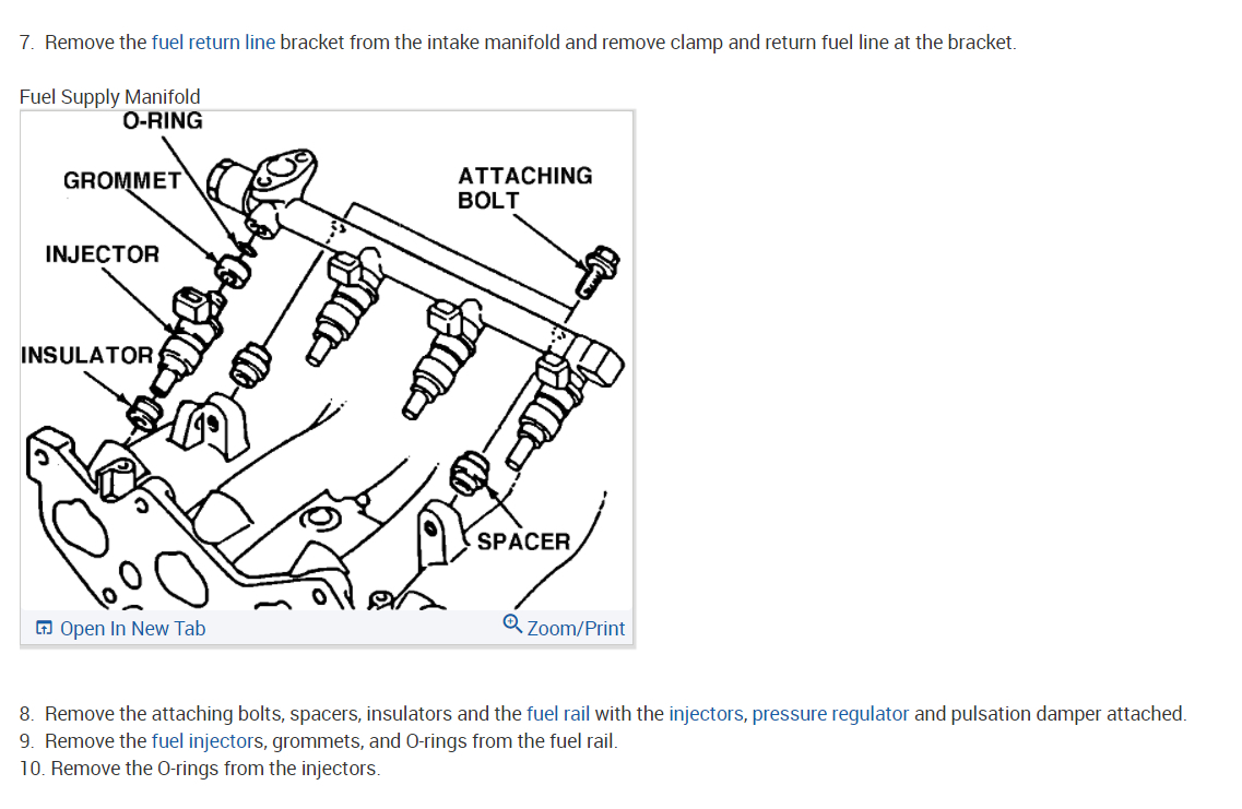

https://www.2carpros.com/articles/how-to-replace-a-fuel-injector
https://www.2carpros.com/articles/how-to-test-a-fuel-injector
