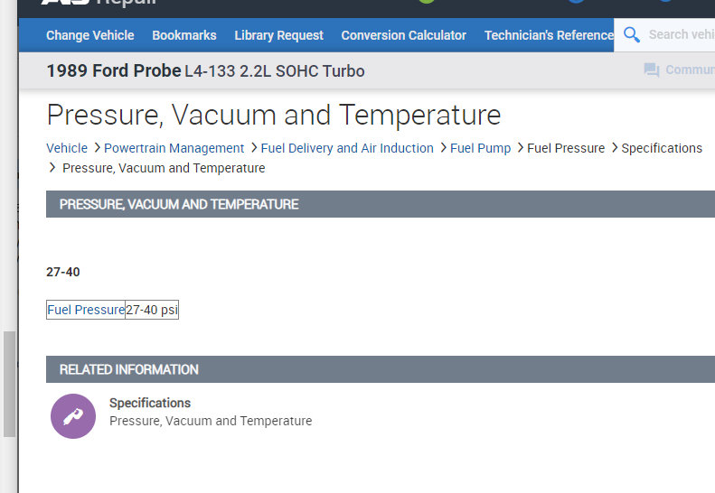

Your fuel pressure is too high. I posted the spec below.
You may have pressure but no volume. You need to allow some pressure from the fuel rail into a container to see if there is actual fuel in the rail.
27-40
Fuel Pressure 27-40 PSI

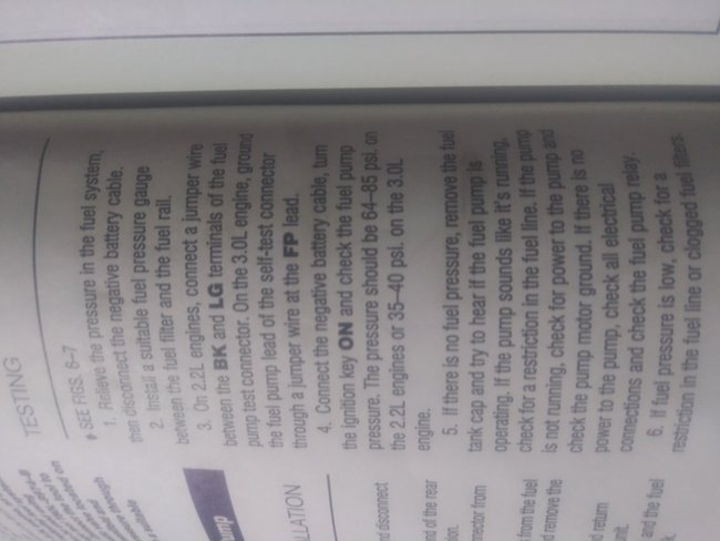

Well, now my Chilton repair manual say the 2.2l is supposed to have 64 to 85 PSI. so I'm low at 47 PSI. so does that mean because it's too low the injectors wont release the fuel? it's a new fuel pump. how do i increase the pressure please?
Aug 20, 2021 at 2:03 AM
I don't know where they came up with that figure. The correct pressure for both engines listed is what I posted in my first response.
We get our information from Alldata.
There is no way to increase pressure. If it is incorrect, the pump needs to be replaced.
Can you upload a snapshot of that spec for me?

Sure Chilton repair manual, but if you say it's too high how can i reduce it? and it's a new pump.

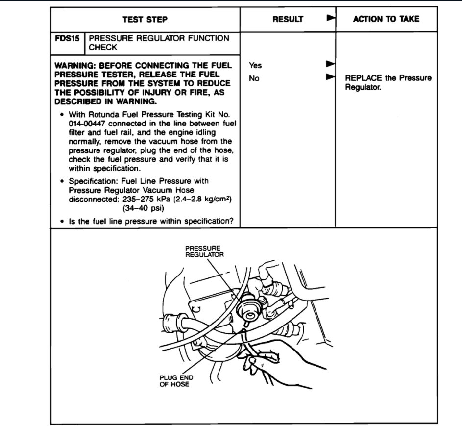

The pump pressure is controlled by the pressure regulator on the fuel rail on the motor.
I attached a picture for you below of the location and how to test it.

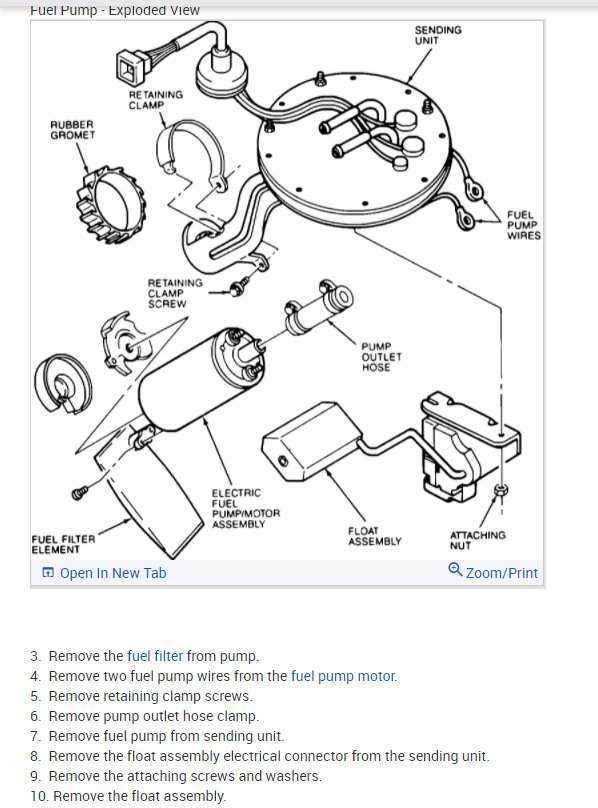

Oh, and that's not my fuel pump. mine has 4pin plug on top not separate wires. Coming out of the lid plate.

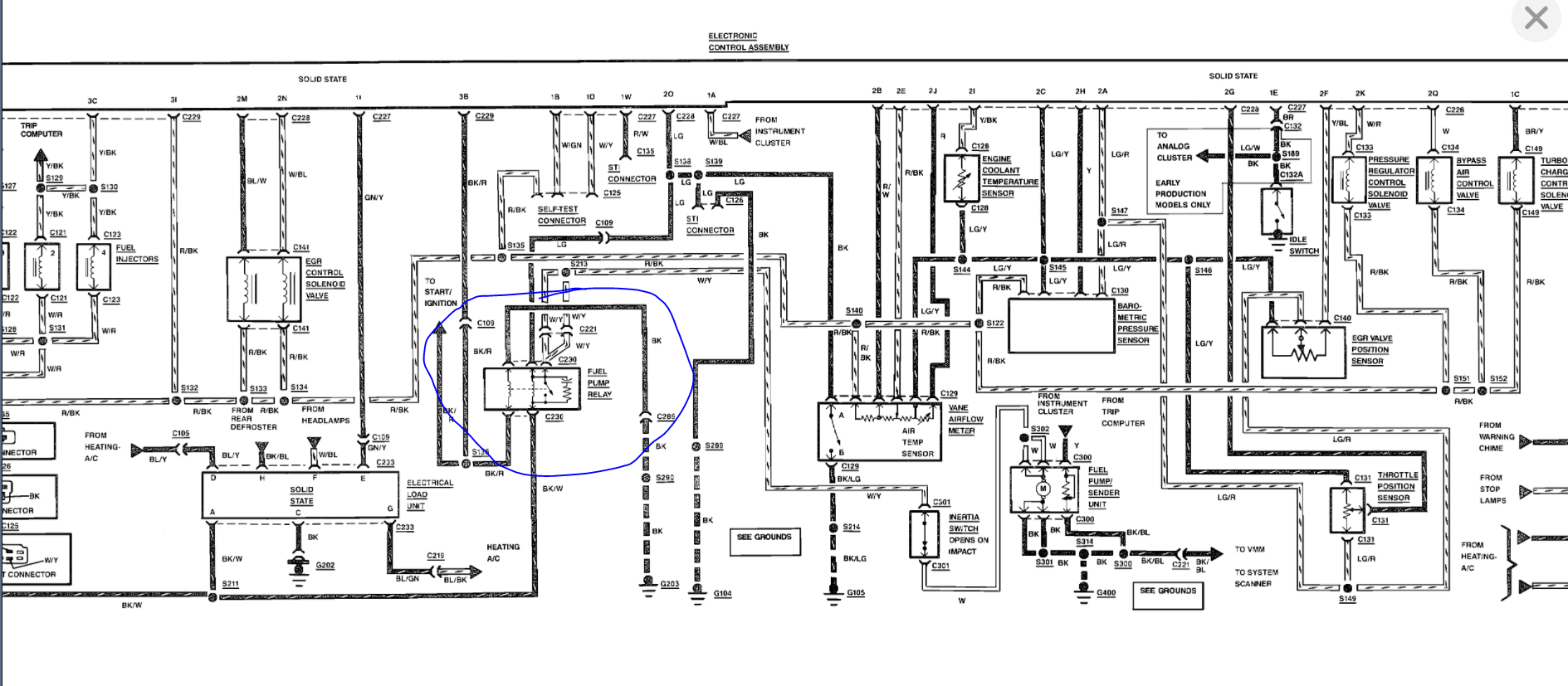

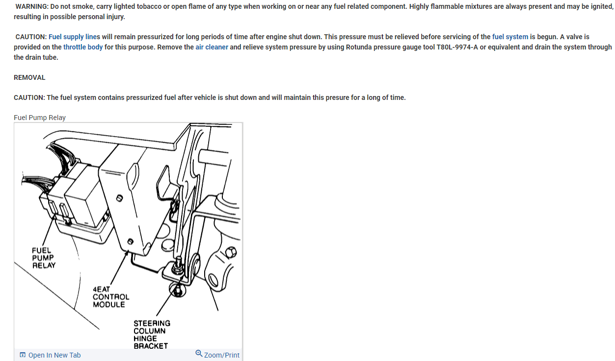

Also, I wasn't getting power to the fuel pump. i put a 4pin relay to power the pump. yes, i replaced the fuel pump relay before i bypassed the relay.

I put a 4 pin relay. I explained that in my last message wired it up to my battery and a keyed power using 10 gauge wire.
Aug 21, 2021 at 12:24 AM
Why did you do that?
That may be the reason for the not starting.
How did you verify no power? What wires did you test?

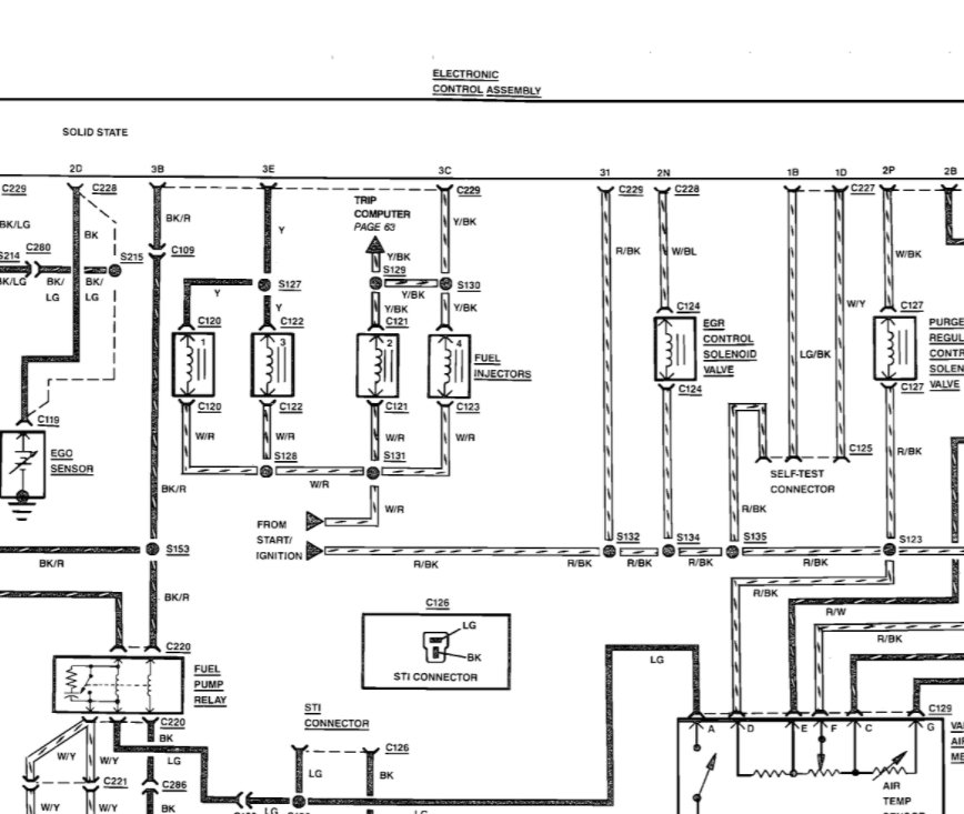

I attached the wiring diagram for you. Both powers for the relay come from the ECM.

I don't believe the ECM is grounding the injectors and allowing them to pass fuel.

Not on the positive side. The negative side is what pulses. One wire has constant 12 volts. The other wire goes to the ECM for grounding.

I think we are at a stalemate because we keep covering the same info over and over.
We show that the 2.2L SOHC turbo engine has a pressure spec of 27-40 PSI.
I understand your manual shows something different and I can't explain why that is. Below is a screen shot from AllData and Mitchell says the same thing.
So the facts remain that you are able to start the engine on starter fluid so you have a fuel delivery issue.

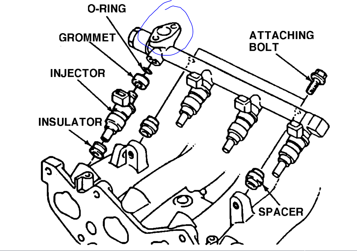

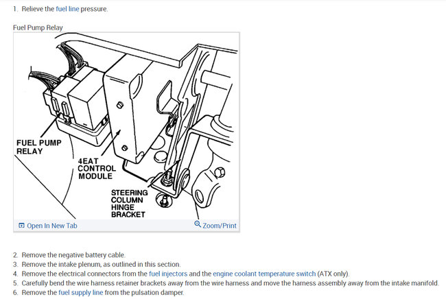

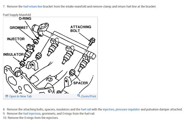

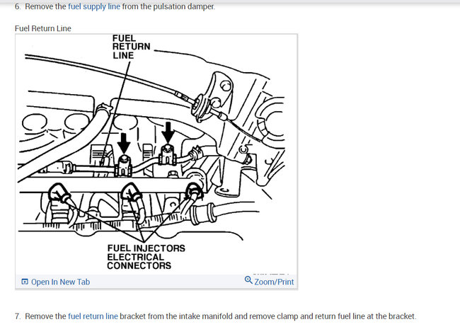

You cannot reduce the pressure. It is not adjustable at all. We already talked about the regulator controlling that.
If you have injector pulse, as you say, and pressure but no fuel in the cylinders, it only leaves the injectors. It is hard to believe that all of them are clogged. Usually only one is an issue.
https://www.2carpros.com/articles/how-to-replace-a-fuel-injector
https://www.2carpros.com/articles/how-to-test-a-fuel-injector
