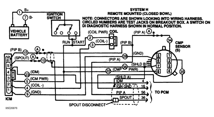

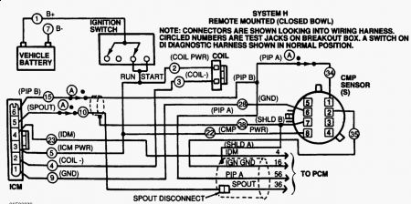

Fig. 5: Distributor Ignition System Wiring Diagram (5.0L)

Check For ICM Power Turn ignition off. Connect EEC-IV Diagnostic Cable (007-00097) to EEC-IV Breakout Box (T83L-50-EECIV), negative battery terminal and ICM. See Fig. 6 . Ensure PIP OPEN/NORMAL/SPOUT OPEN switch is in NORMAL position. Put DI overlay on breakout box.
WARNING:DO NOT connect EEC-IV Diagnostic Cable and PCM to EEC-IV Breakout Box simultaneously.
Turn ignition on. Put DVOM on DC voltage scale. Measure voltage between J5 (ICM PWR) and J7 (B -) at breakout box. If voltage is 10 volts or less, repair open in ICM PWR circuit to ICM. See Fig. 5 . If voltage is more than 10 volts, go to next step.
Fig. 6: Connecting EEC-IV Diagnostic Cable
Check PIP Signal Put DVOM on AC voltage scale. Measure voltage between J7 (B -) and J15 (PIP) while cranking engine. If AC voltage is not 3.0-8.5 volts, go to step 11). If AC voltage is 3.0-8.5 volts, go to next step.
Check SPOUT Signal Measure voltage between J7 (B -) and J10 (SPOUT) while cranking engine. If AC voltage is not 3.0-8.5 volts, go to step 18). If AC voltage is 3.0-8.5 volts, go to next step.
Check COIL PWR At Coil Turn ignition off. Connect diagnostic cable to ignition coil wiring harness connector. Leave ignition coil disconnected. Put DVOM on DC voltage scale. Turn ignition on. Measure voltage between J2 (COIL PWR) and J7 (B -). If voltage is 10 volts or less, repair open in ignition coil circuit. If voltage is more than 10 volts, go to next step.
Check COIL- Signal Turn ignition off. Connect B+ lead of diagnostic cable to positive battery terminal. Connect test light between J1 (B +) and J3 (COIL-). Crank engine. If test light does not flash brightly, go to step 27). If test light flashes brightly, replace ignition coil.
Check For Spark Using Neon Bulb Spark Tester (D89P-6666-A), check for spark at each spark plug wire while cranking. If spark is consistent at all spark plug wires, go to next step. If spark is not consistent, service distributor cap, rotor, plugs or plug wires.
Check Spark Plugs Remove and inspect spark plugs. Replace plugs as necessary. If spark plugs are okay, no-start condition is not ignition related. See appropriate H - TROUBLE SHOOTING (EEC-IV) - NO CODES article.

I have done all these steps, no signal from PIP with spout conected, pull spout and you have signal and engine starts, have replaced ICM and eec or Pcm 3 times no effect, connect spout you have no spark and fuel pump runs without timing out it also runs with spout in??????? all voltages are correct and have Ohmed to check for wire breaks all check good conections.

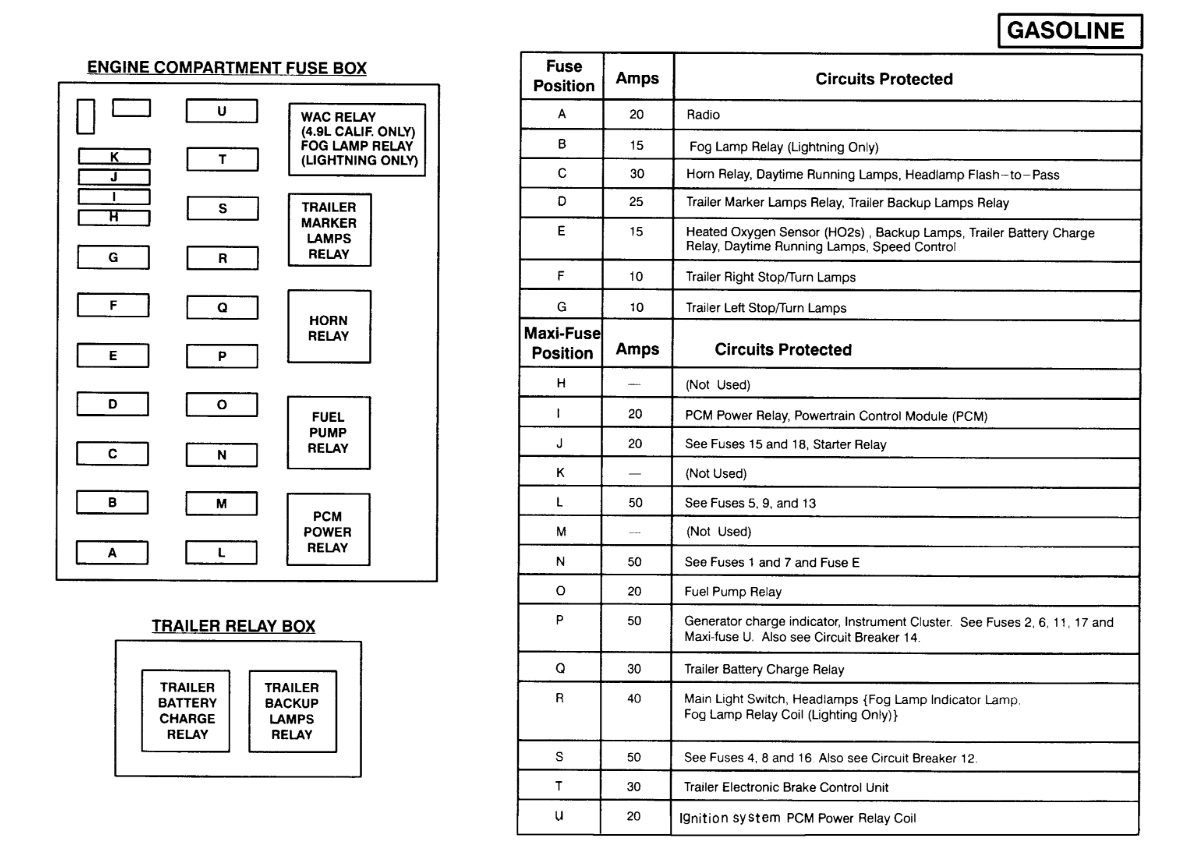

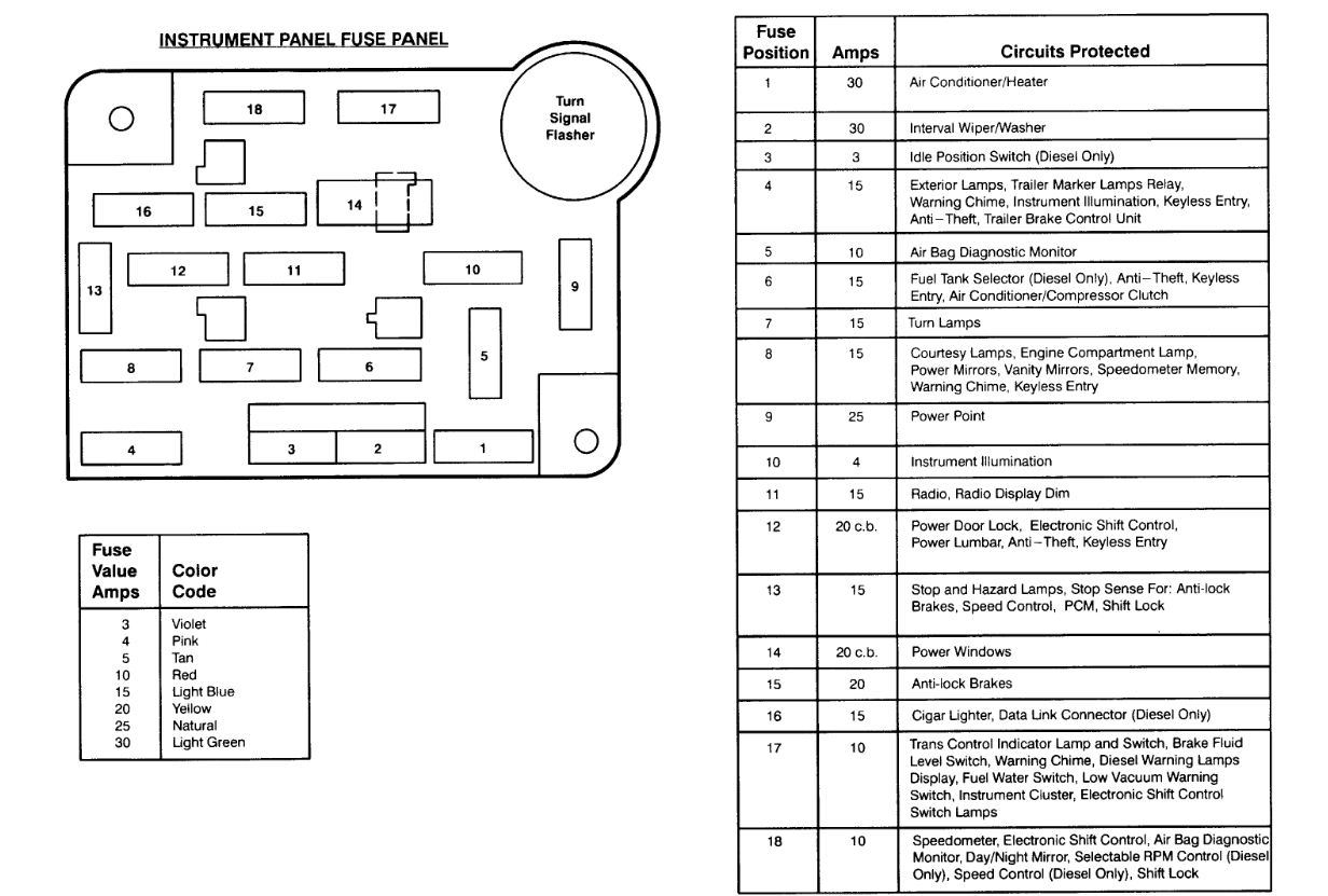

If your ignition module is on the fender, it's duraspark, not TFI...and either the the duraspark module is the problem, or cam sensor. Here's a wiring digram to help with testin, check for power at coil and at the module... also check PCM power relay in the under hood fuse block.
https://images.2carpros.com/forum/automotive_pictures/62217_igna_1.jpg

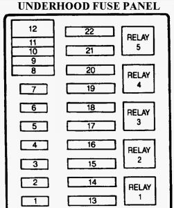

Check relay #1 And fuse #22
https://images.2carpros.com/forum/automotive_pictures/62217_relaya_1.jpg

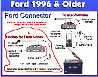

Or the ignition switch and fuses. Also read the codes, like this: Jump the two termnals shown together and turn key to "ON" and count the flashes... a 22 will flash as 2 flashes then a short pause, then 2 flashes, if more than one code is stored, the pause will be longer. The codes will display three times and end with 11 or 111. Write them down and post here. First do this with the key on engine off, then again with it running.
https://images.2carpros.com/forum/automotive_pictures/62217_Pre_95_FordJump_4.jpg

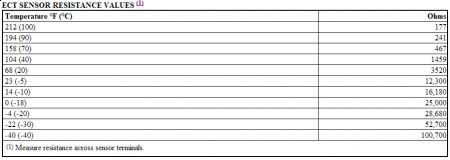

https://images.2carpros.com/forum/automotive_pictures/62217_ECTGM_3.jpg
Test ECT with your ohm meter, If the battery neg cable has been disconnected for several minutes, the KAM should have cleared these codes..also it could be the distributor with a no spark. Or ignition switch.

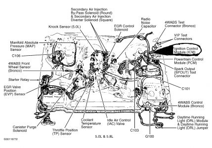

Ignition Control Module (ICM)On left rear side of inner fender panel. See Fig. 1 .
https://images.2carpros.com/forum/automotive_pictures/266999_icm_1.jpg
1) Continuous Memory Code 211 Code 211 indicates 2 successive erratic Profile Ignition Pick-Up (PIP) pulses occurred, resulting in a possible engine miss or stall. Check for the following possible causes of fault: Loose wires or connectors. Secondary ignition short to ground. On-board transmitter equipment (2-way radio). Repair if necessary and repeat QUICK TEST. If problem is not found, go to next step. If vehicle does not start, go to CIRCUIT TEST AA. 2) Continuous Memory Code 212: Check IDM Circuit Continuity -Continuous Memory Code 212 indicates loss of IDM input to PCM. Possible causes for this fault are: Open or shorted circuit in wiring harness. Faulty ICM. Faulty PCM. If vehicle does not start, go to CIRCUIT TEST AA. If vehicle starts, go to next step. 3) Check IDM Circuit Continuity Turn ignition off. Disconnect 60-pin PCM connector. Inspect terminals and repair if damaged. Install EEC-IV Breakout Box (T83L-50-EEC-IV), leaving PCM disconnected. Disconnect ICM. Measure resistance between test pin No. 4 at breakout box and IDM terminal at ICM wiring harness connector. If resistance is 5 ohms or less, go to step 5). If resistance is more than 5 ohms, repair open circuit, and repeat QUICK TEST. NOTE:A break in step numbering sequence occurs at this point. Procedure skips from step 3) to step 5). No test procedures have been omitted. 5) Check IDM Circuit For Short To Power (Except VREF) Turn ignition off. Leave ICM and PCM disconnected. Measure voltage between breakout box test pin No. 4 and negative battery terminal. Turn ignition on. Measure voltage between test pin No. 4 and test pins No. 40 and 60 at breakout box. If voltage is more than 10.5 volts, repair short circuit. Clear codes, and repeat QUICK TEST. If voltage is 10.5 volts or less, go to next step. 6) Check IDM Circuit For Short To PIP & VREF Turn ignition off. Leave PCM and ICM disconnected. Disconnect ignition coil wiring harness connector (non-CCD). Remove scan tester (if applicable). For short to PIP, measure resistance between test pins No. 4 and 56 at breakout box. For short to VREF, measure resistance between test pins No. 4 and 26 at breakout box. If any resistance is 10,000 ohms or less, repair short circuit and repeat QUICK TEST. If each resistance is more than 10,000 ohms, go to next step. 7) Check IDM Circuit For Short To Ground Turn ignition off. Remove scan tester (if applicable). Leave ignition coil, ICM and PCM disconnected. Measure resistance between test pin No. 4 and test pins No. 20, 40, 46 and 60 at breakout box. If each resistance is more than 10,000 ohms, reconnect scan tester and go to next step. If any resistance is 10,000 ohms or less, repair short to ground in IDM circuit. Clear codes, and repeat QUICK TEST. 8) Check ICM Turn ignition off. Connect PCM to breakout box. Reconnect ICM and ignition coil to wiring harness connectors. Connect DVOM between test pins No. 4 and 16 at breakout box. Start engine. Observe DVOM for voltage surge while lightly tapping on ICM and Camshaft Position (CMP) sensor to simulate road shock. Wiggle all ICM and CMP sensor wiring and harness connectors. If fault (voltage surge) is indicated, disconnect and inspect wiring harness connectors and terminals for damage. If fault is not indicated, go to next step. 9) Check PCM & Harness Connectors Ensure engine is still running and DVOM is still connected between test pins No. 4 and 16 at breakout box. While observing DVOM, wiggle and bend wiring harness, a small section at a time, from ICM and CMP sensor (if equipped) to cowl. Also check harness from cowl to PCM. If fault is indicated, isolate fault and repair as necessary. Remove breakout box, reconnect all components, and repeat QUICK TEST. If no fault is found, go to next step. 10) Check PCM & Harness Connectors Turn ignition off. Disconnect PCM 60-pin connector. Inspect connector for damaged pins, corrosion and loose wires. If connector is damaged, repair as necessary. Clear codes, and repeat QUICK TEST. If connector is okay, go to next step. 11) Check PCM For Short To Power Turn ignition off. Connect PCM to breakout box. Disconnect CMP wiring harness connector. Measure voltage between test pin No. 4 at breakout box and chassis ground. Turn ignition on. Measure voltage between test pin No. 4 and test pins No. 40 and 60 at breakout box. If either voltage reading is more than 10.5 volts, replace PCM and repeat QUICK TEST. If both voltage readings are 10.5 volts or less, go to next step. 12) Check PCM For Short To Ground Turn ignition off. Leave PCM connected to breakout box. Measure resistance between test pin No. 4 and test pins No. 40, 46 and 60 at breakout box. If resistance is more than 10,000 ohms, check ignition system. See SYSTEM/COMPONENT TESTS - EEC-IV (5.0L) article. If resistance is 10,000 ohms or less, replace PCM and repeat QUICK TEST. ****CODE 452.....Insufficient Input From Vehicle Speed Sensor To Powertrain Control Module***
