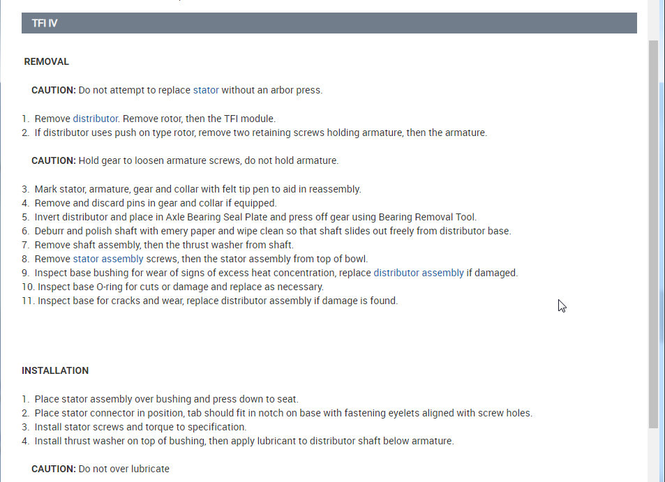

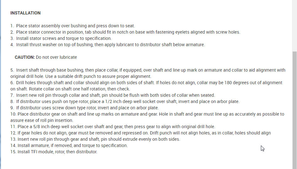

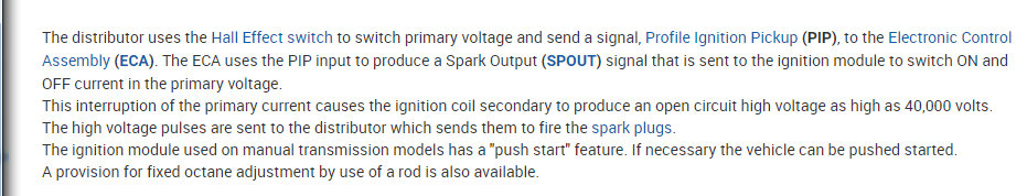

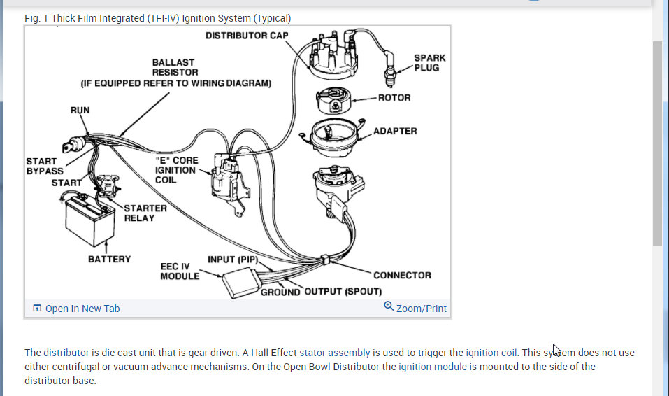

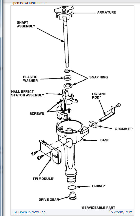

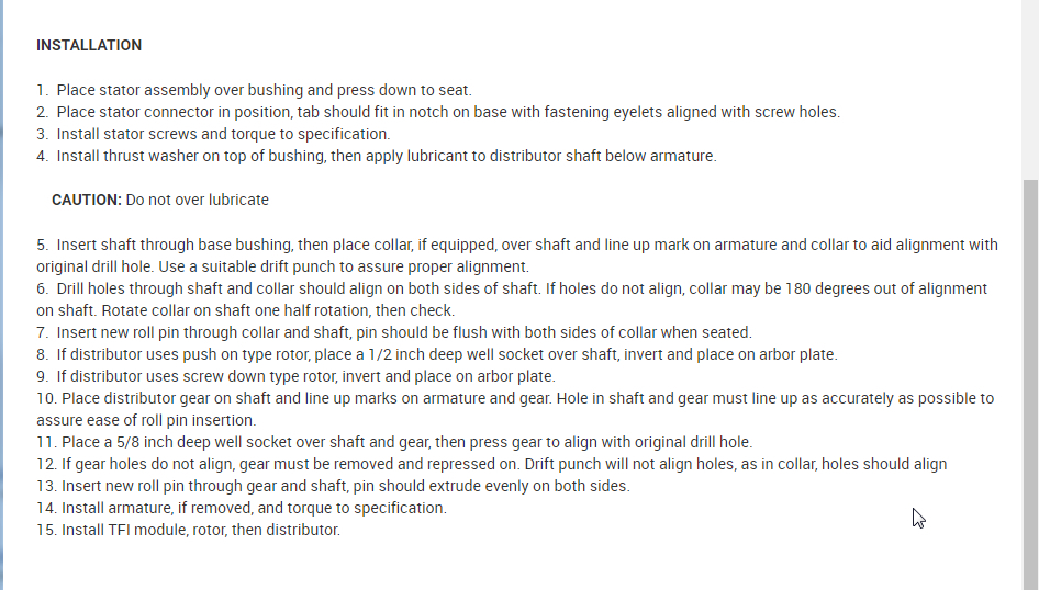

More then likely you have an issue with the hall effect stator assembly. This is used to trigger the coil so if you are not getting spark then this is where we need to start.
Here is a guide that will tell you how to test the ignition system:
Below I attached the information on this system. Basically we need to go through the system shown and check for where we have voltage and where we do not. That will tell us the issue but I suspect the stator is the issue so I included the process on how to replace that.
Let us know what you find and we can go from there. Thanks
