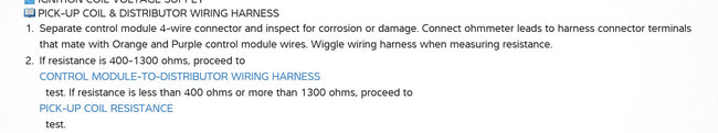

I diagnosed the truck with a no start problem originally with no spark. after a few test I found that the vehicle would run if I took the in-line spout connector at the distributor out.I determined the PCM to be at fault. I replaced the PCM, now the vehicle wont start and I tried the old PCM and it still won't start. I am wondering if I have a different problem or is it created by the new PCM. I hate to think that my first diagnosis wasn't correct. I don't think I was originally wrong.

there are two different systems on this truck try this one if module is on fender and you have a pick up coil. resistance in p/u coil shold be 400-1000 ohms if out of range replace it. also check to see if coil gets power and works if it doesn't then it is either a wire, rotor or distributor cap.
