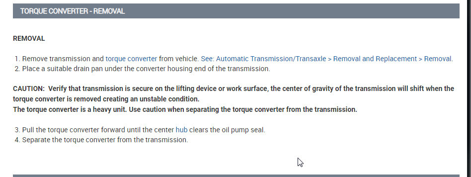

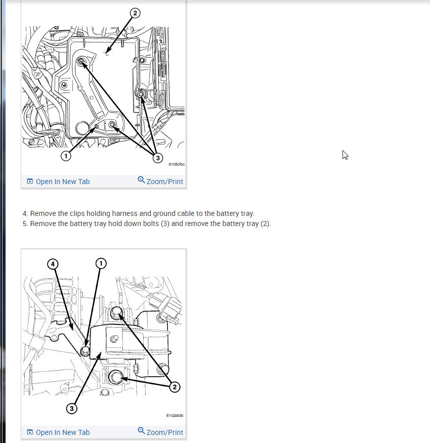

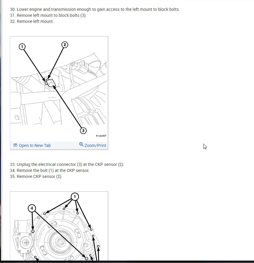

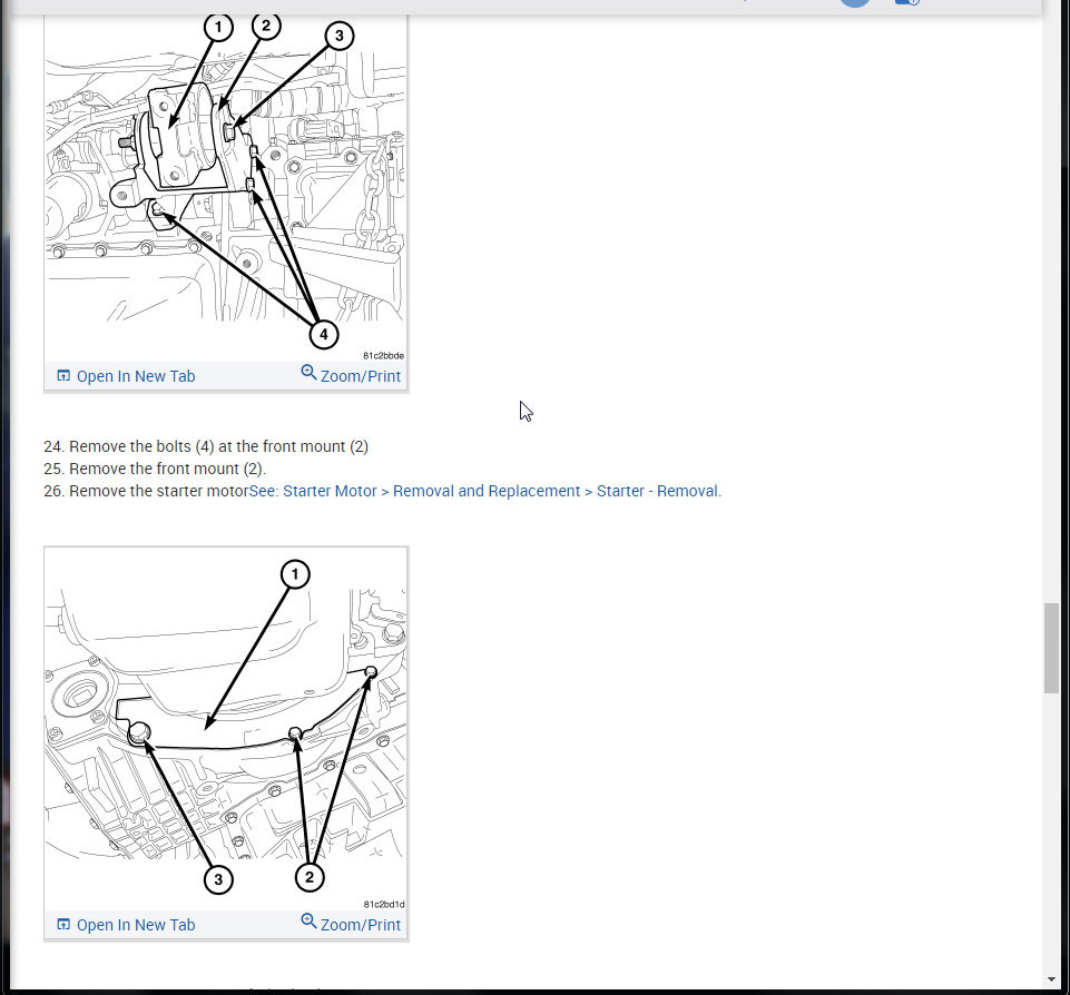

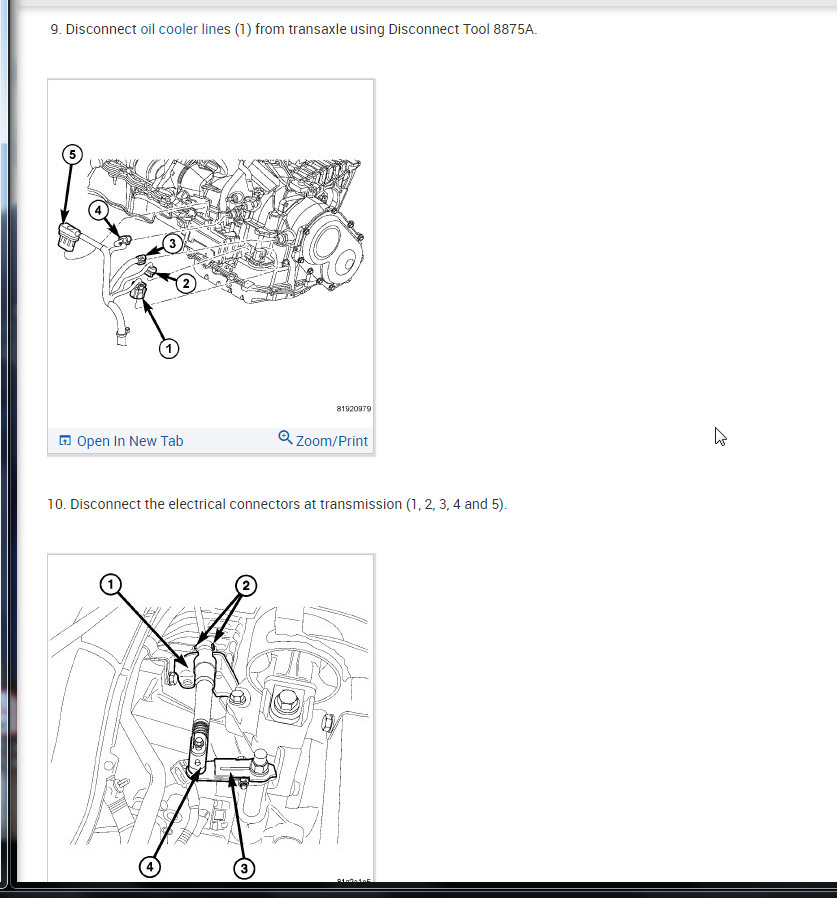

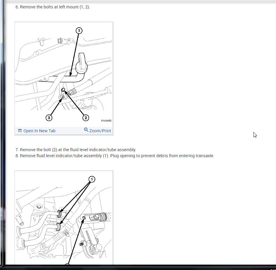

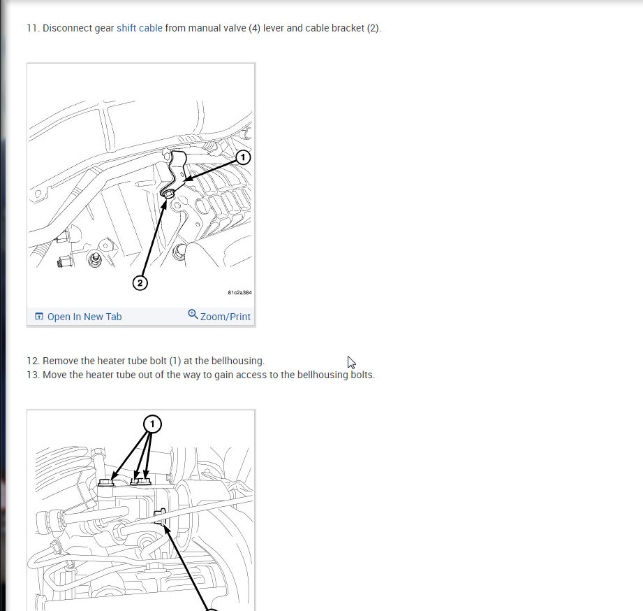

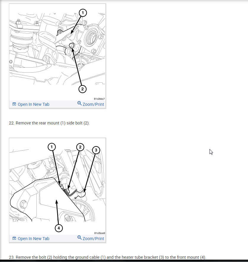

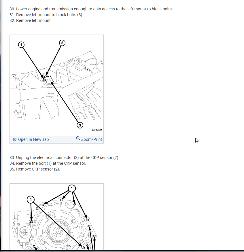

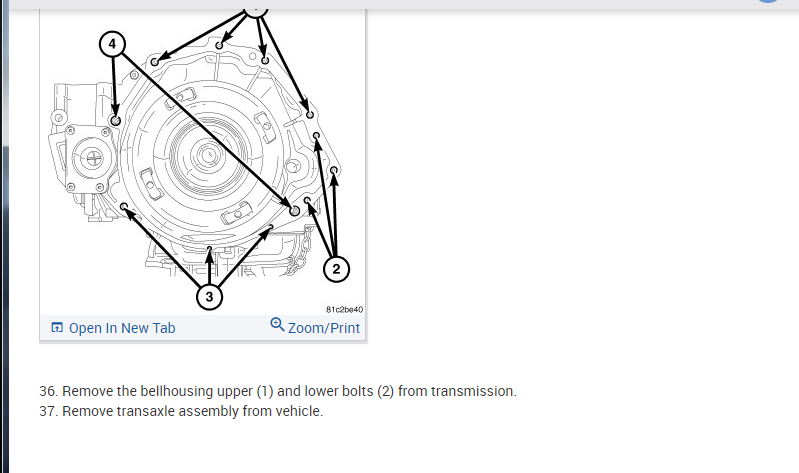

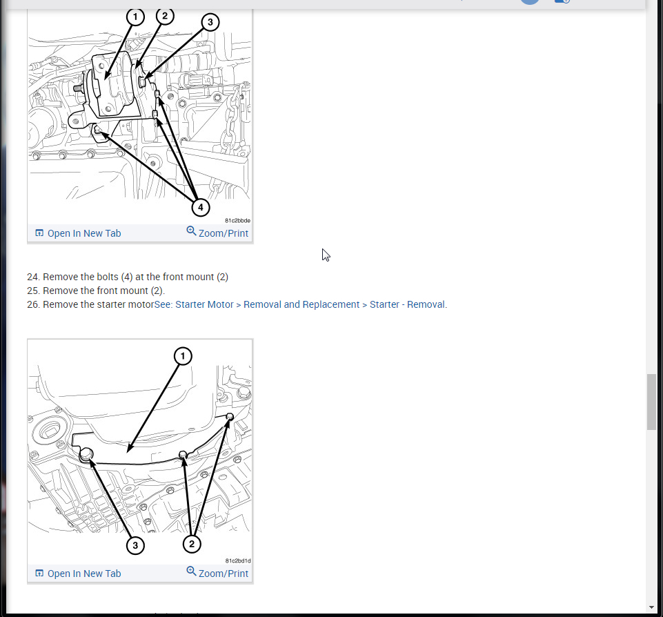

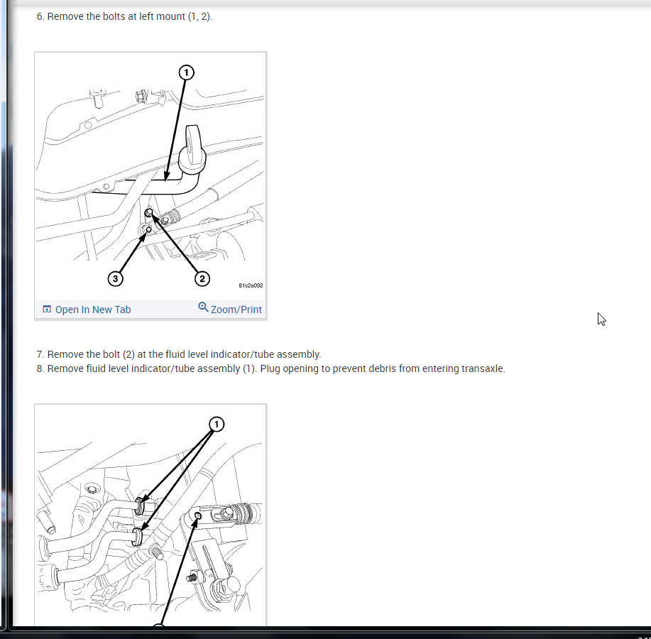

it wont go forward while in drive it would only go in reverse can we fix it?
Mar 4, 2020 at 5:49 PM

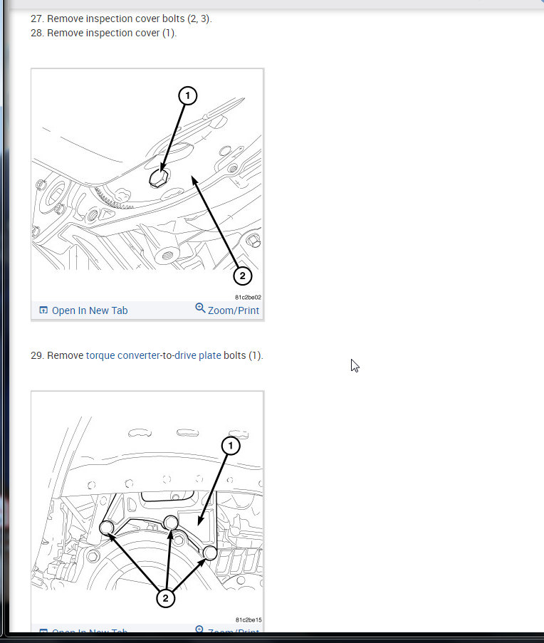

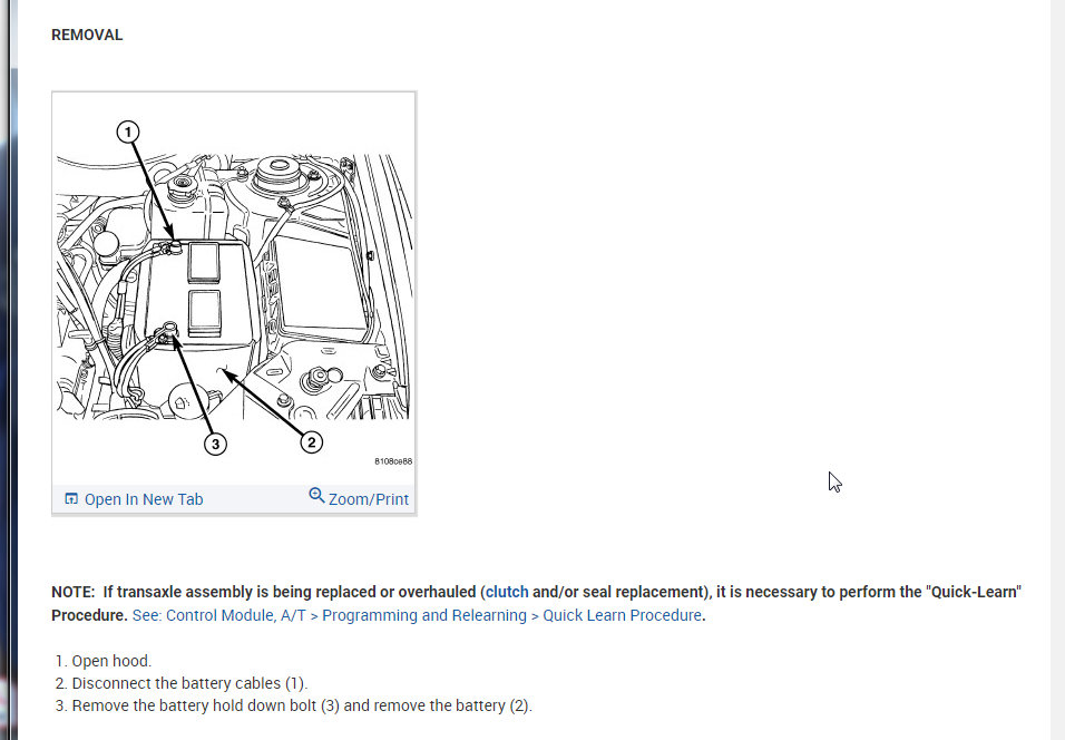

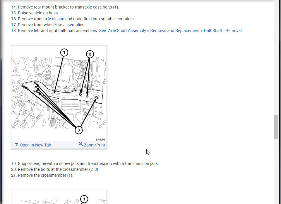

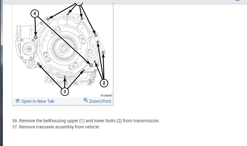

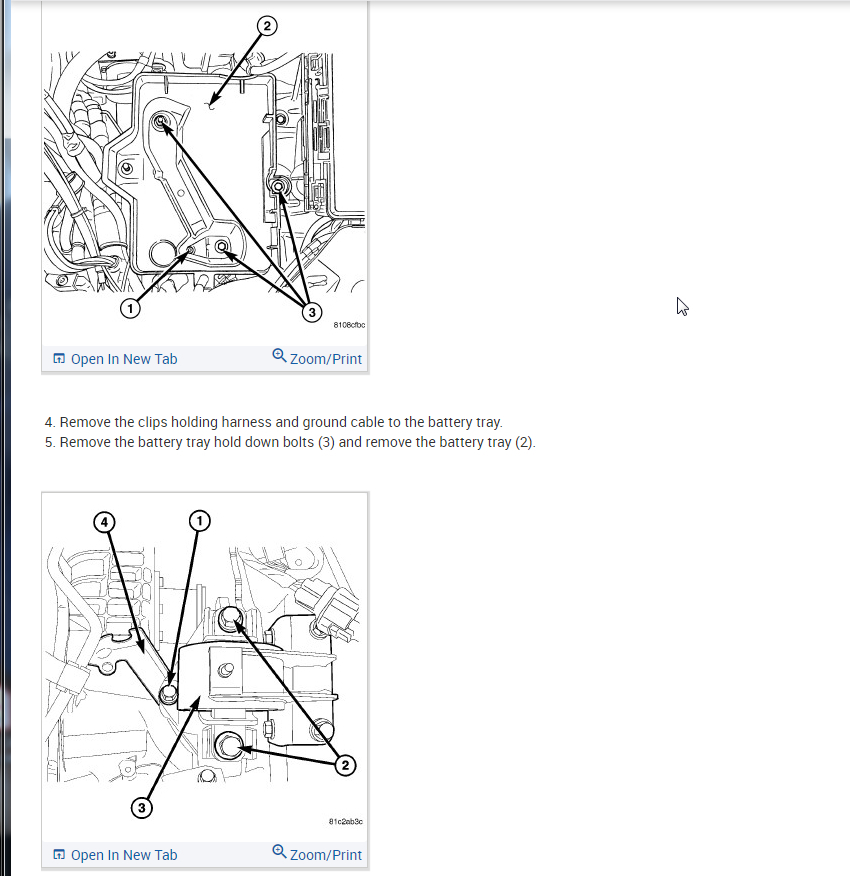

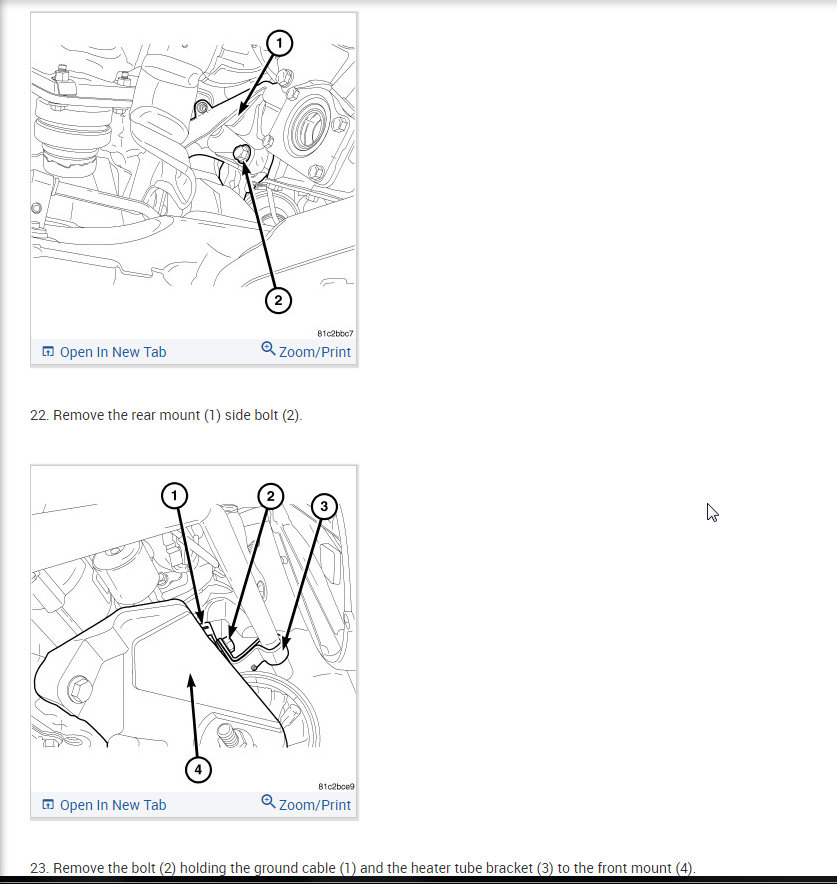

Most likely this is a failed pump and possibly a torque converter as well.
This is not uncommon on these units when they fail so I am attaching the process on how to remove and replace the transmission and converter.
Here is a video that will help with this:
https://www.youtube.com/watch?v=ZC7xHVMKLRw
https://www.youtube.com/watch?v=3vJAojsrfuU
Please review the material below and let us know if you have questions. Thanks

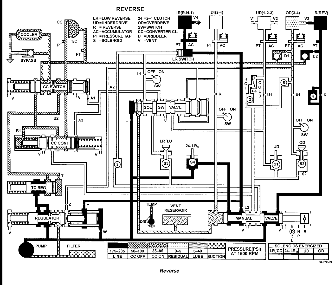

I have a Grand Caravan. At around sixty five mph the transmission completely disengaged. Pulled over, shut the ignition off and reset the computer and it would drive and then disengage again. Before it would disengage, it seems to be shifting. Also, no reverse.
After doing some line pressure tests and code scan I have a P0882 and P0732. It failed the following test as per service manual. But being there is no reverse at all, I am not sold on a solenoid or TCM fault, because based upon pressure gauge responses when shifting. However, In limp mode as per the manual, I should have park, neutral, reverse and second gear.No reverse I am stumped.
Test two a-selector in overdrive (fourth gear):
1. Attach gauge to the underdrive clutch tap.
2. Move selector lever
to the (overdrive) position.
3. Allow wheels to rotate freely and increase throttle
opening to achieve an indicated speed of forty mph.
4. Underdrive clutch pressure shoul
d read below 5 psi. If not, then either the solenoid assembly or
PCM/TCM is at fault.
May 21, 2021 at 5:11 AM (Merged)
STEVE W.
  • 15,418 POSTS
Reverse is not solenoid controlled, it is mechanical through the manual valve. In reverse the L/R clutch and the reverse clutch applies. Its loss suggests that some splines stripped on the shaft or the drum cracked.
Either way the transmission would need to come apart to repair it.
CHUCK SINCLAIR
Thank you... I was pretty sure of that, but with the combination of the distracting signals and the manual not stating exactly what you stated (mechanical through the manual valve). I did not want to condemn the transmission immediately. One last question, if it is not solenoid controlled, would it not have loss of forward in the L position as well as the R position for the L/R clutch?
I removed the EATX relay to induce a limp mode and do not have any forward or reverse. When I put the relay back in, I have forward gears. I appreciate your response very much!
STEVE W.
  • 15,418 POSTS
Sounds like you have two failures. Both a bad L/R solenoid and failed reverse clutch. When power is removed all the solenoids should go to default position. That should give you Park, Neutral, Reverse, and Second gear on the manual selector. If the L/R solenoid is stuck partly open you would lose reverse with the power cut. The flow diagram is reverse S4 is the L/R solenoid.
CHUCK SINCLAIR
I appreciate all your help..., thank you! Looks like I need a Tranny! Thanks again!

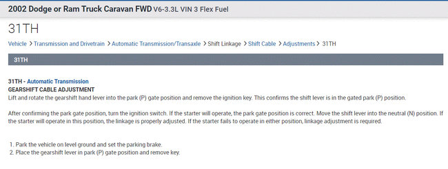

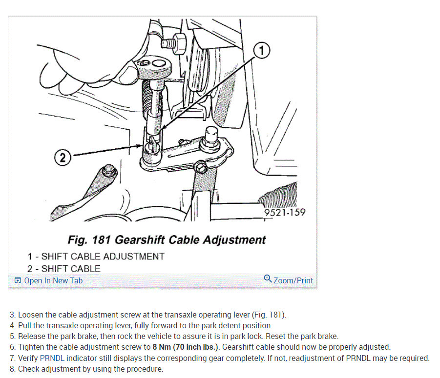

My van won't go forward or in reverse unless there's a click, you have to wait for it and the it will move. All the warning lights are on and it shows reverse when it's in park. I changed the filter and put new tranny fluid in it and it moves but I don't know what this all means. Thank you for any help you can give me.
May 21, 2021 at 5:12 AM (Merged)
  • 110,248 POSTS
Can you tell approx where the click is coming from? Also, the idea that it shows reverse when it is in park may indicate the shift linkage needs to be adjusted. That is where I would recommend starting.
If you look at the two pics below, they include the directions and pic for adjusting the shift cable. Try this first.
Next, when you say all lights are on, are you referring to the warning lights such as the check engine light? If so, have you had the computer scanned for diagnostic trouble codes?
If you haven't, that will need to be done as well. Here is a video showing how it's done:
https://youtu.be/InIlnsjOVFA
I realize most people don't own a scanner, but oftentimes a parts store will lend you one.
Try the adjustment first and let me know what you find.

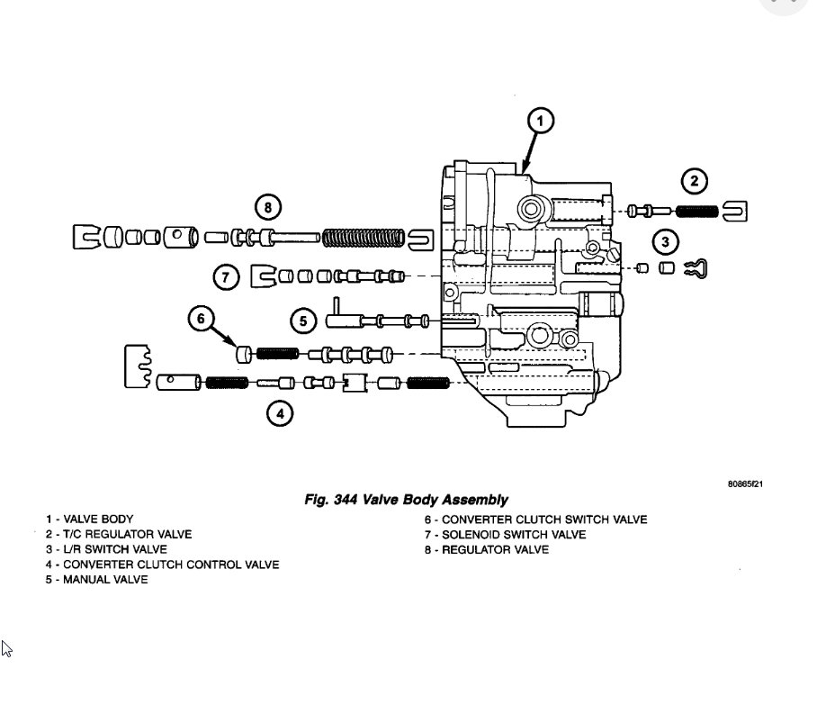

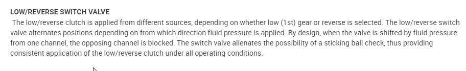

We need to start with checking fluid. If it is low it could cause issues but it is unlikely that this would only effect reverse.
The most likely cause is the valve body has a leak in the L/R solenoid which is allowing fluid to leak past a point that is supposed to be blocked off which would create the needed pressure. Unfortunately the only way to repair this is to replace it or rebuild it.
Let me know if you have questions and we can go from there. Thanks

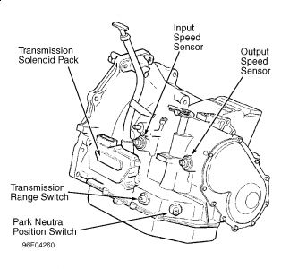

https://images.2carpros.com/forum/automotive_pictures/99387_Graphic9_11.jpg
Suspect speed sensor and or coil solenoid pack need to have the codes you can have it scanned or cycle the ignition key on off on off on read P0000 codes in the odometer area

my codes are po700 po715 po720 p1899....I have put in new input speed and output speed sensors.I was told it was my neutral safety switch,but my van doesn't start in any other gear except park and neutral could the transmission control solenoid be what is causing all my problems
May 21, 2021 at 5:13 AM (Merged)
CARADIODOC
  • 34,415 POSTS
P0715 - Input/Turbine Speed Sensor Circuit Malfunction
P0720 - Output Speed Sensor Circuit Malfunction
P1899 - Park/Neutral Position Switch Stuck In Park or In Gear
You have fault codes directing you to the circuits that need to be diagnosed. Don't go looking for other unrelated stuff. The first concern is it is very unlikely you have three sensors that failed at the same time. Instead, look for what they have in common. In this case that is the wiring harness. The second thing to be aware of is the neutral safety switch is no longer the inexpensive, reliable switch that worked fine for many decades. It is a "range sensor". This one has five separate switches in it that turn on and off at different times. Those must agree with the short list of acceptable combinations. When any one of them does not go to the correct state, code P1899 will set.
Any one of these three codes will send the system into limp mode. Inspect the wiring harnesses first for signs of wires rubbed through, then for corrosion on connector terminals. The next step would be to use a scanner to view live data and see if either speed sensor is generating a signal. Also look at the Transmission Range Sensor to see how it is listed. I have a Chrysler DRB3 scanner for all of my vehicles. That shows the gear that is selected as interpreted by the Transmission Computer. You may be able to get an idea as to the cause of the problem by watching how it acts while moving the shift lever. If an incorrect gear reading only occurs when shifting between forward and reverse, with the engine running, for example, a good suspect is something related to a wiring harness that is flexing when the engine rocks. If the problem shows up when the engine is not running, an intermittent contact inside the range sensor becomes a better suspect. A problem in the range sensor could act up every time you shift to a certain gear, but it is usually the only suspect when the incorrect readings show up intermittently as you shift back and forth.
