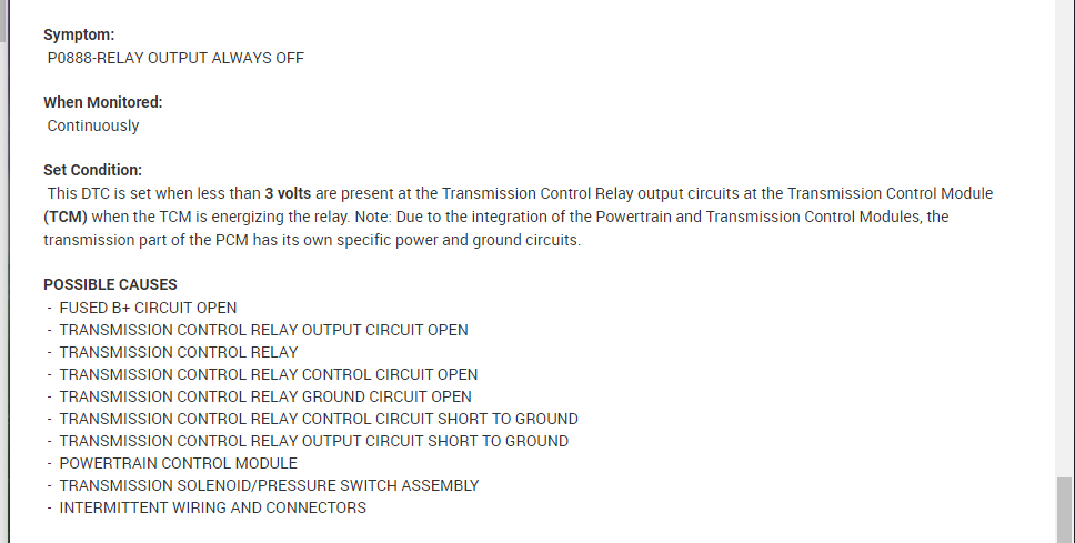

I have problem with automatic transmission it is not shifting.
And I have the fault code p0888.

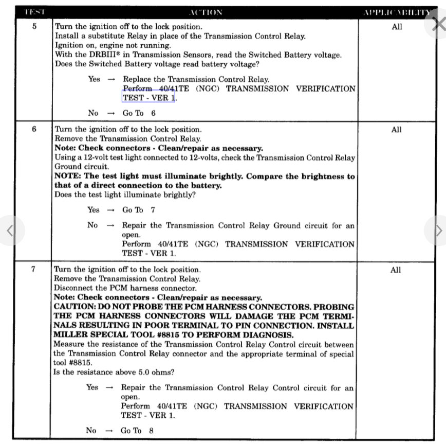

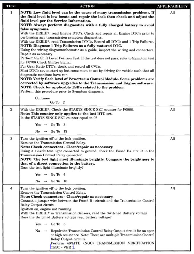

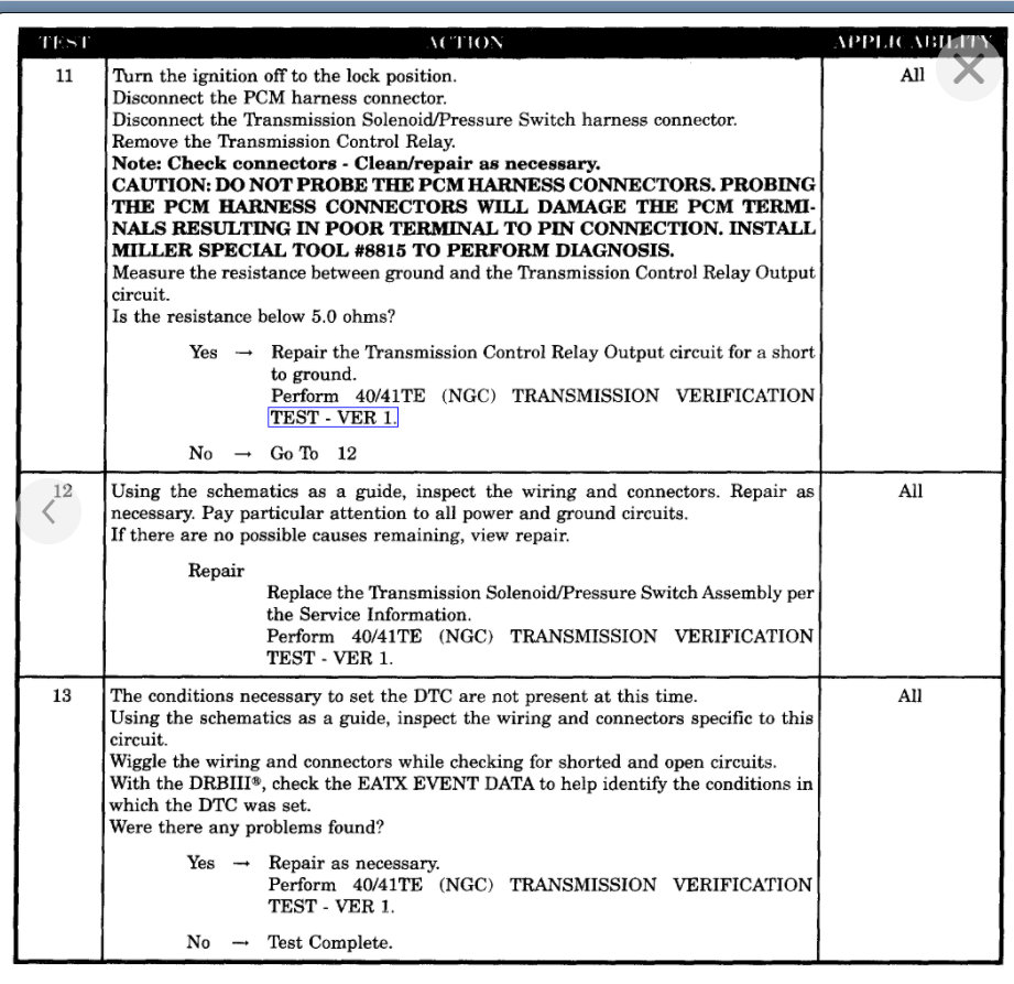

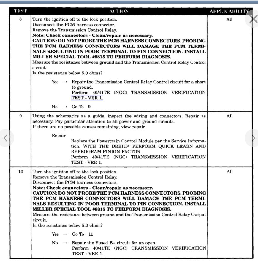

I have resolved this fault code:P0888 on my 2004 Dodge Caravan, when I check resistance from the transmission control relay control on the PCM to IPM connector of the relay terminal 85 the power side of the relay, there was an open circuit on the IPM connector of the relay and ground side of relay, so I fly wire from C3(1) ground to the relay terminal 86 and C3(6) power side to terminal 85 of the relay. The problem solved.

Again, I am going to post the specific info on this code as that and your info will surely help others in the future.
