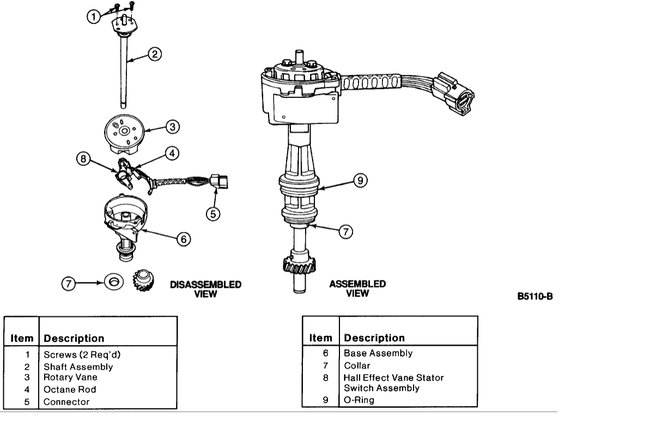

Wondering where the crankshaft position sensor is located on my 1992 Fordf150, I have had problems with it starting. It cranks but will not start, check engine light on, read code, it stated EEC module, replaced and still same thing. Was told to check crankshaft sensor.

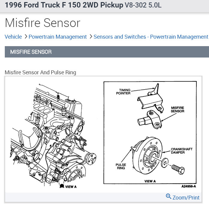

This is a mid year shift some crankshaft sensors are called hall effect sensor located in the distributor. Check the diagrams below.
Other sensors are located at the crankshaft front. Disconnect sensor connector and measure resistance across sensor terminals. Resistance should be 300-750 ohms. If resistance is not as specified, replace sensor.
