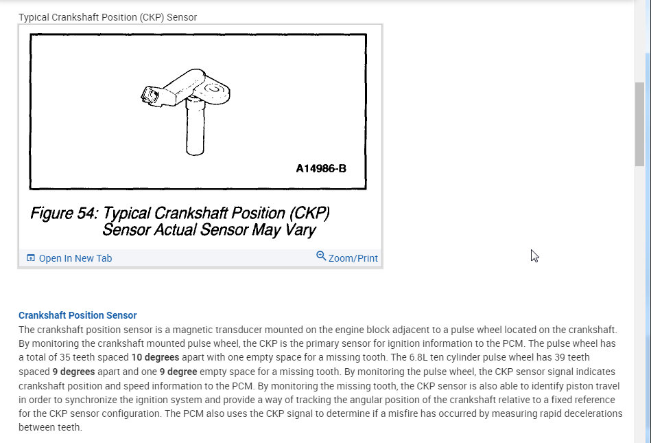

Don't know what normal is because that's a test we rarely do. This is a simple two-wire magnetic sensor so there's just a real long piece of wire wrapped around a magnet. Failures are typically going to consist of a broken wire, meaning infinite resistance, or corrosion between the connector terminals. It isn't likely one of these will short internally because the wire would have to get hot enough long enough to melt the insulation, and that's not going to happen.
If you want to know what a typical reading is, measure a new one or a used one in a salvage yard. The online service manuals don't even give a spec. Basically you're looking for something or nothing. The exact value isn't that important.
Also, you weren't clear in your reading. If that was 34 ohms, I could believe that. If that was 34kohms, that would be too high. Some ABS wheel speed sensor with a similar design can be in the area of 500 to 900 ohms. What's much more important is the voltage of the signal the sensor is putting out. If that is present but too low, look for something causing the air gap to be too big.

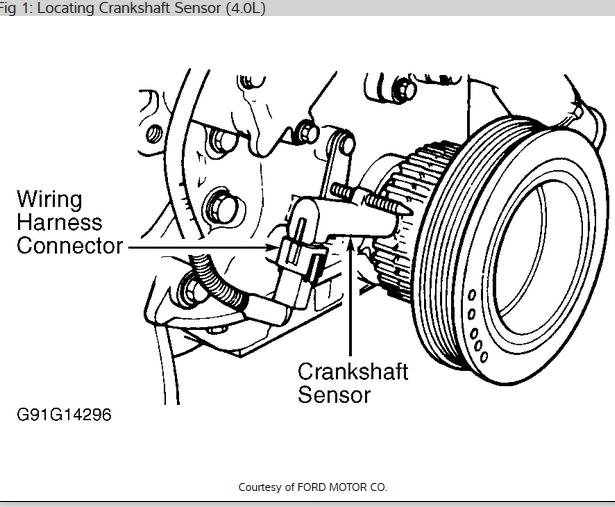

location is at front of engine behind front pulley. Should take about 20 minutes to change out. This video show what to do its on a different car but you get the idea.

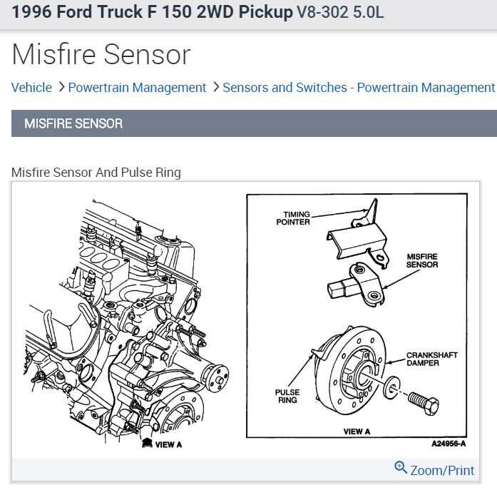

where is the crankshaft sensor and does a 1995 ford F1 50 have a sensor it's a 302 5.0 L automatic
Aug 3, 2020 at 5:19 AM (Merged)
since your truck has a distributor it does not have a crank sensor.

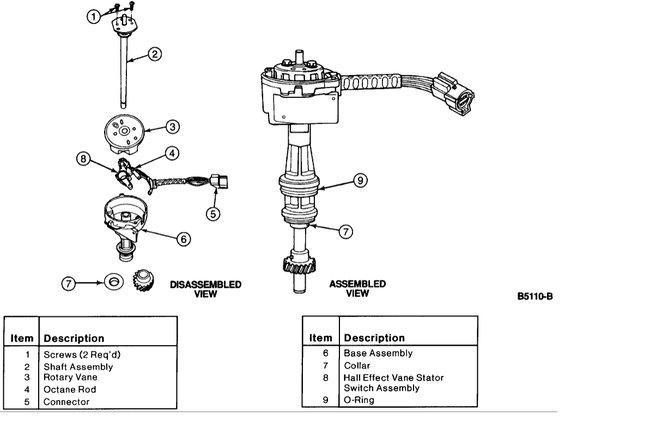

Wondering where the crankshaft position sensor is located on my 1992 Fordf150, I have had problems with it starting. It cranks but will not start, check engine light on, read code, it stated EEC module, replaced and still same thing. Was told to check crankshaft sensor.
  • 55,333 POSTS
This is a mid year shift some crankshaft sensors are called hall effect sensor located in the distributor. Check the diagrams below.
Other sensors are located at the crankshaft front. Disconnect sensor connector and measure resistance across sensor terminals. Resistance should be 300-750 ohms. If resistance is not as specified, replace sensor.
