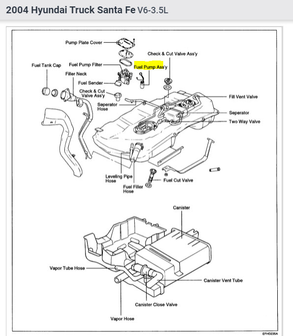

Okay, tomorrow I will start with troubleshooting and use the starter spray. Can I have a diagram of the fuel pump and location so I can start looking at it? Then I will let you know what's the outcome of the starter spray tomorrow and another thing, if the fuel pump or fuel system is out then how will I tell what do? I need to look for hear see or feel to notice that one or of them is the issue is there a link for that or is it in the link I have now?

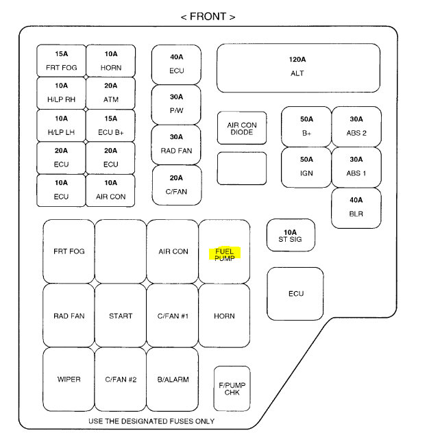

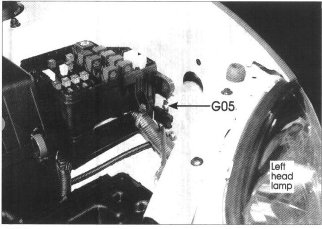

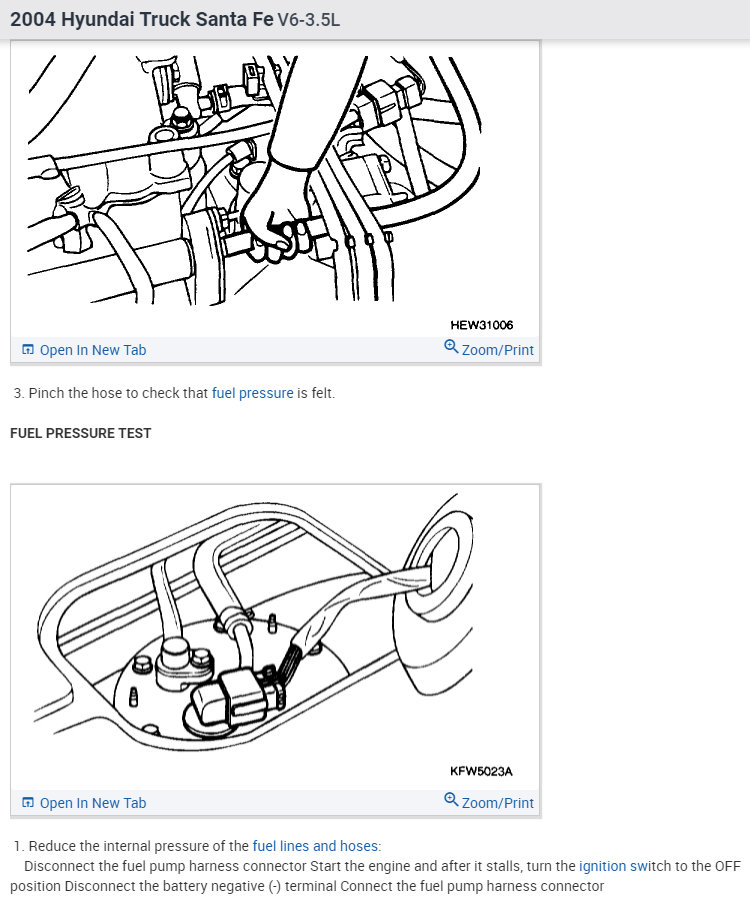

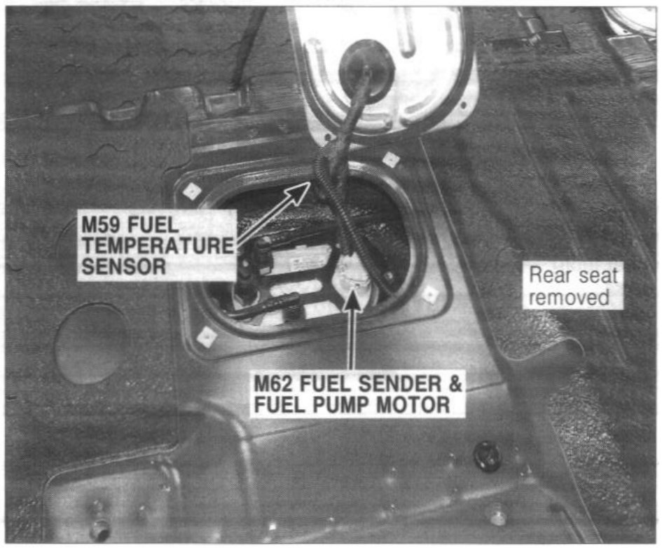

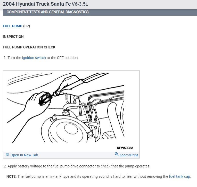

An inoperative fuel pump can be due to a bad relay, faulty wiring or a bad pump.
It is always a good idea to check the relay first.
The relay is located in the under-hood fuse box (see diagram below).
Check for any burn pins or corrosion on the relay.
Here is a guide on how to test the relay:
The fuel pump is located inside the fuel tank. There should be an access port under the rear seat.
I have also included the fuel pump and components diagnostics procedure below as well. It can help you narrow down the issue.
Let me know if you have any questions.

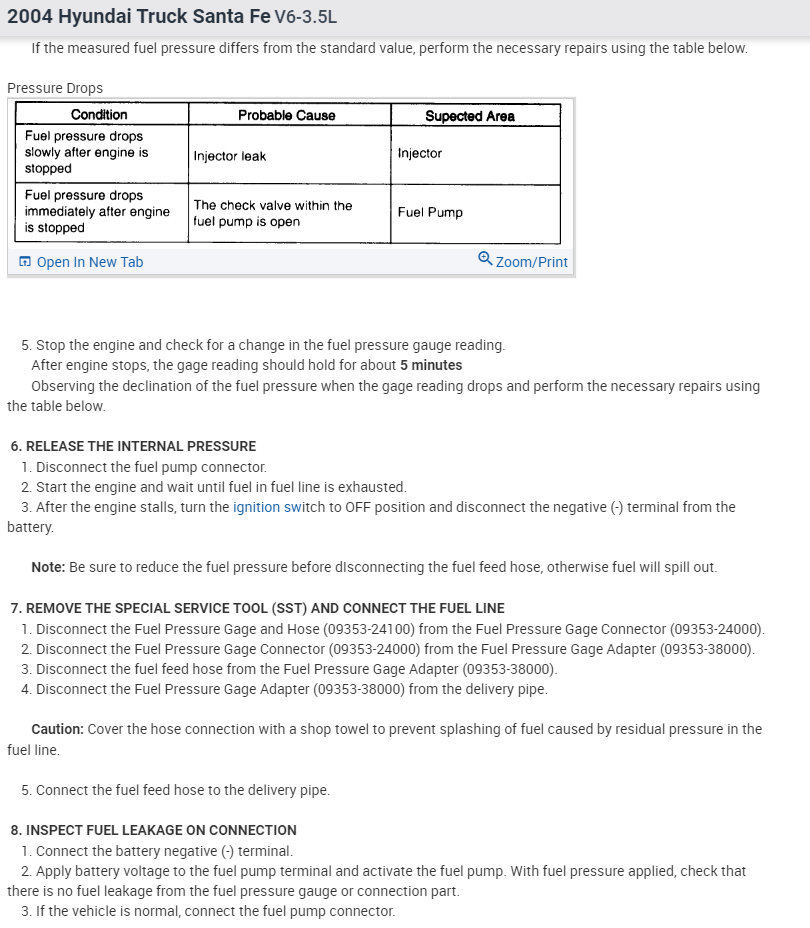

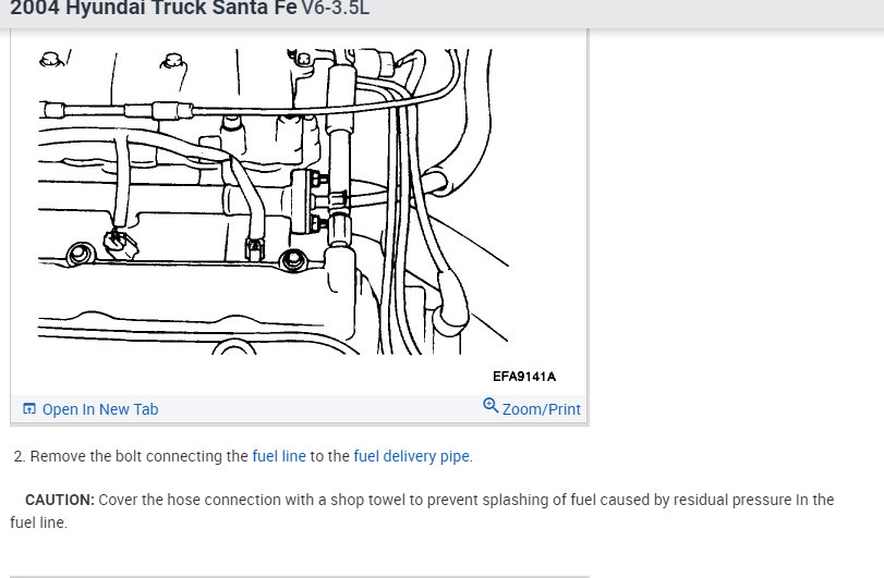

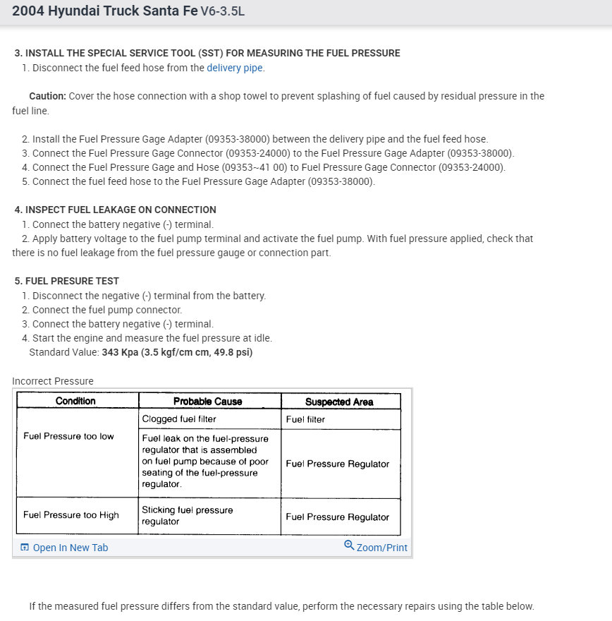

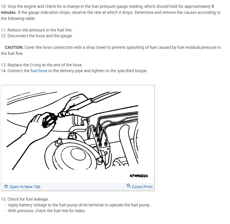

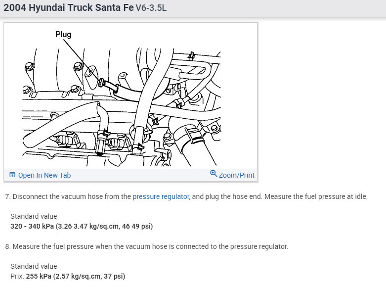

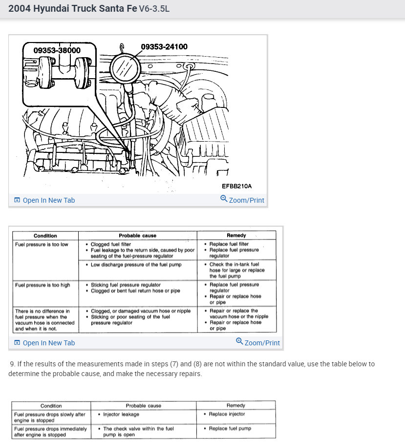

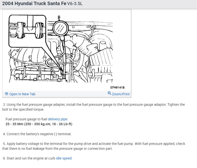

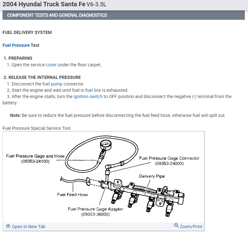

If you are unable to hear the fuel pump it might not be turning on. So might want to check the relay first to make sure it is good or replace it as needed.
You can also test the fuel pressure on the fuel rail by using a pressure gauge.
Here is the guide:
Also included the diagrams below.
