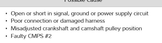

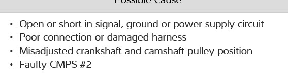

the first codeand 2106 may be related it may have one of the things wrong in pic or you have a cam problem like timing chain and noise so have that looked at it may have jumped time. the 365 may be from same thing or the gas pedal/ or throttle body are bad. try cleaning throttle plate on both sides and iac hole with choke cleaner it may fix it but will still show until it is erased with a scanner. with the compression on #2 it's not with in 20% so it may have a bent valve especially if timing chain/belt jumped or slipped.

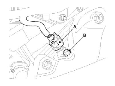

Hi and thanks for using 2carpros.com
Cranking and not starting can be caused by several things. However, the idea that it is not showing any trouble codes leads me to believe it could be related to the crankshaft position sensor. The sensor is based on engine speed. Therefore, if the engine isn't running, it may not set a trouble code. Take a look through this link:
Here is a link that shows in general how one is replaced.

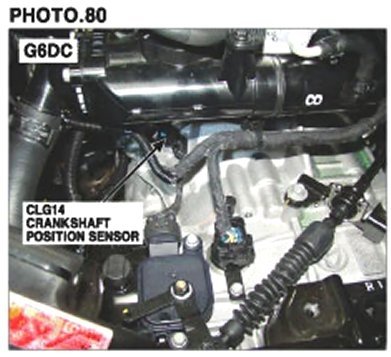

The technician you mentioned is basically right. Without the symptom, it becomes a guessing game. However, as I said, this is my first suspect. Here is another link that discusses crank but no start conditions.
If you suspect the crankshaft position sensor is the problem, here are the specific directions for replacement.
Removal
1. Turn the ignition switch OFF and disconnect the battery negative (-) cable.
2. Remove the air cleaner assembly .
3. Disconnect the crankshaft position sensor connector (A).
4. Remove the installation bolt (B), and then vertically remove the sensor from the transaxle housing.
See Pic 1

Picture 2 shows its location.
Let me know if this helps. Also, if you have other questions, feel free to ask.
