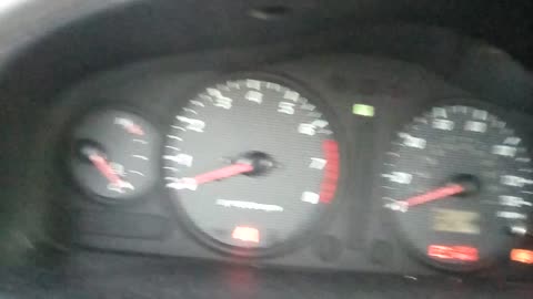

I have the vehicle listed above GLS model, and I have been troubleshooting an Issue of the car not starting. I have changed the battery. I have service invoices for spark plugs, Ignition Coil, and Cables Intake Manifold Gasket, this service has been done twice on this car at the same shop in 2018. does anyone have any helpful information or ideas for what I can do to get the car running? also, the alternator hasn't been serviced at any point and the car has 245,270 miles on it.

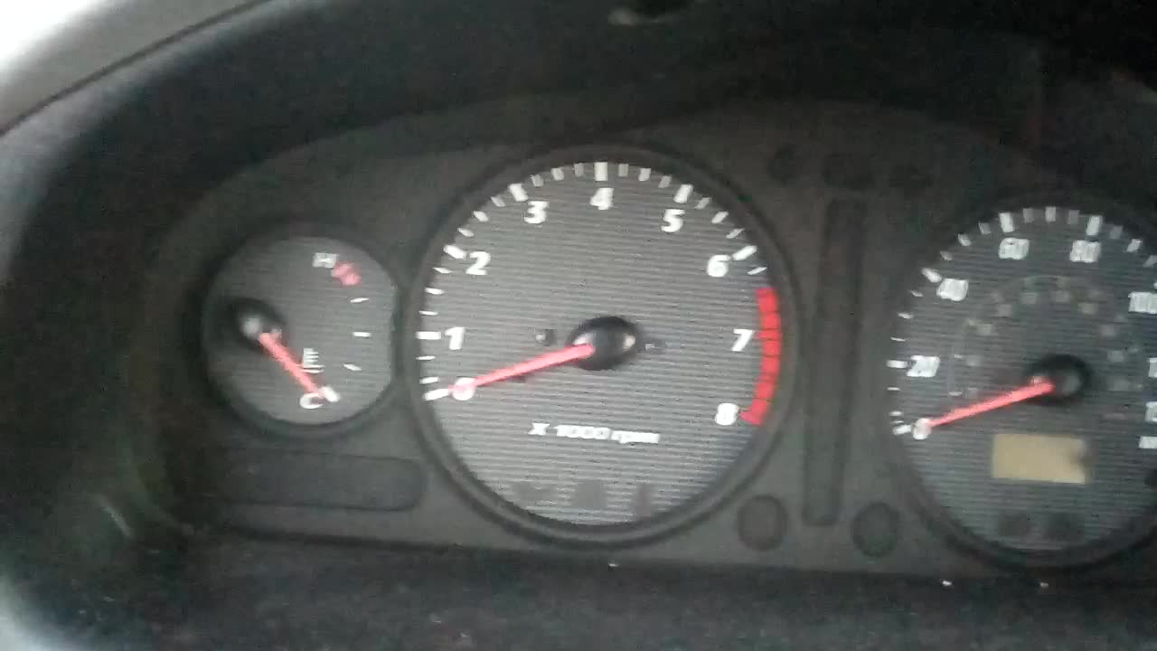

JUDIE_SIMMONS
  • 57 POSTS
I will make a video and send it to you so you can tell me your thoughts.
Feb 4, 2022 at 2:27 AM

SQM
  • 6,383 POSTS
So, have you already confirmed that it has spark, and good compression and the timing belt is good?
From the video it sounds like it might not have proper compression. As the cranking sound was kind of 'flat'.
Can you hear the fuel pump when the key gets turned to the on position? The fuel pump should turn on for a few seconds when the key is at the position, then it will stop. You will hear a hummin noise from the pump.
One thing you can try is to spray starting fluid into the throttle body, then try to start it. If it starts, then the issue is the engine is not getting fuel. Typically, with starring fluid the engine will start and run for a little bit then stall as soon as the fluid runs out.
Feb 4, 2022 at 10:21 AM

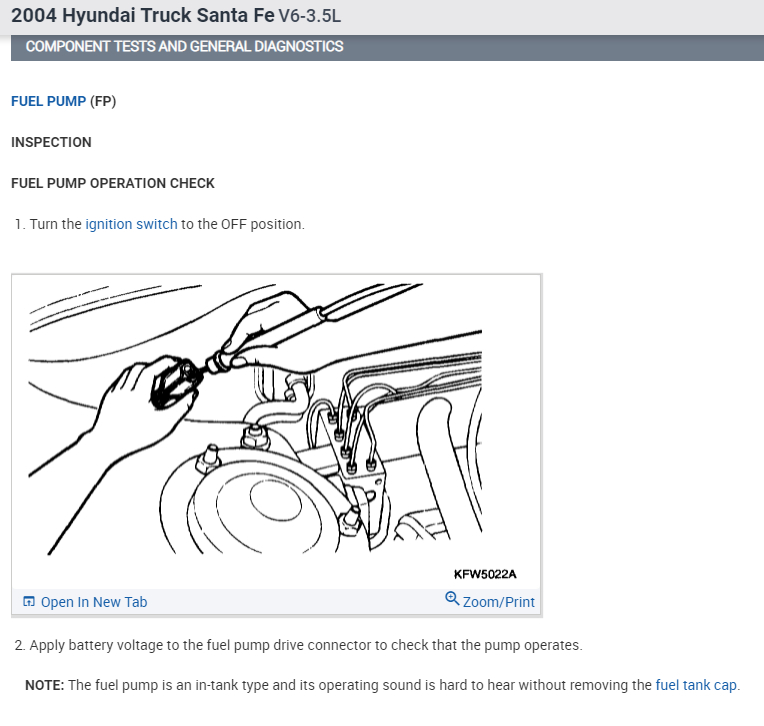

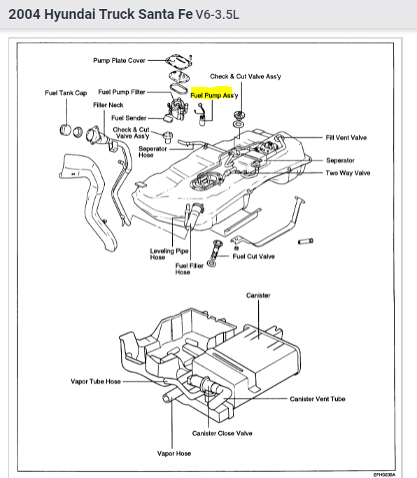

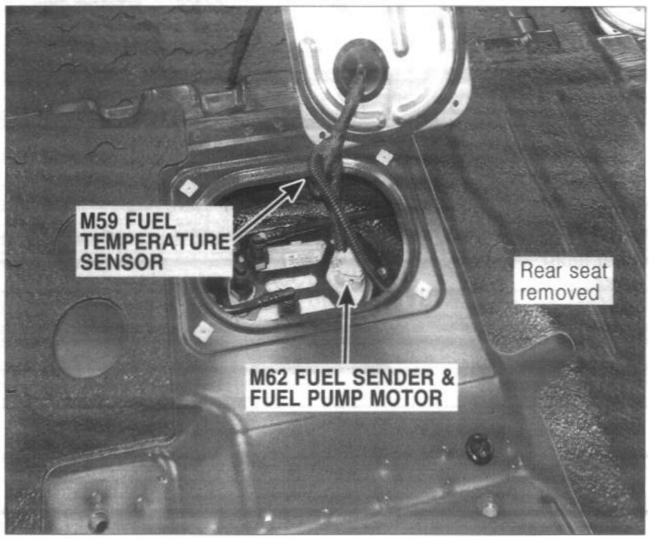

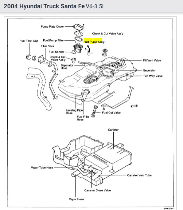

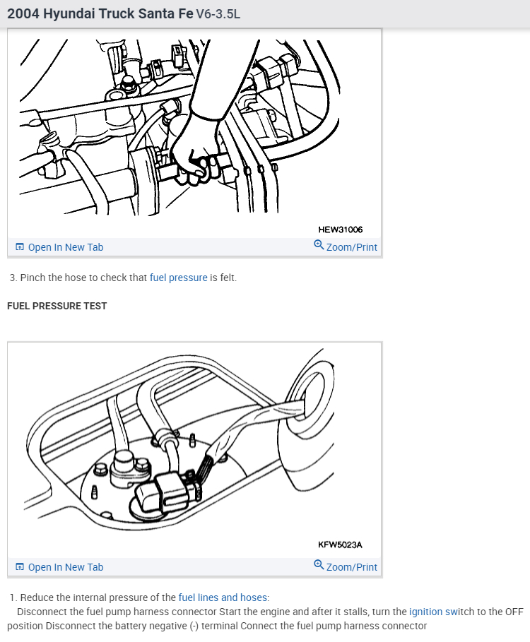

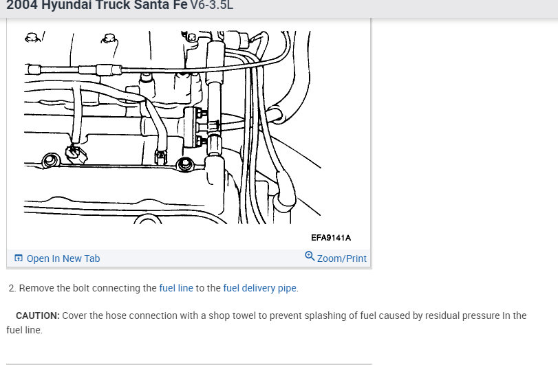

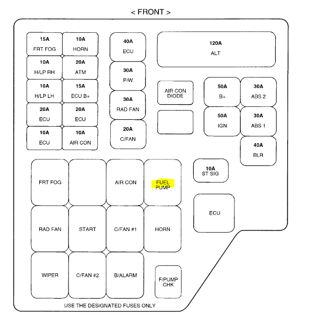

Okay, tomorrow I will start with troubleshooting and use the starter spray. Can I have a diagram of the fuel pump and location so I can start looking at it? then I will let you know what's the outcome of the starter spray tomorrow and another thing, if the fuel pump or fuel system is out then how will I tell what do? I need to look for hear see or feel to notice that one or of them is the issue is there a link for that or is it in the link I have now?
Feb 5, 2022 at 10:40 AM
SQM
  • 6,383 POSTS

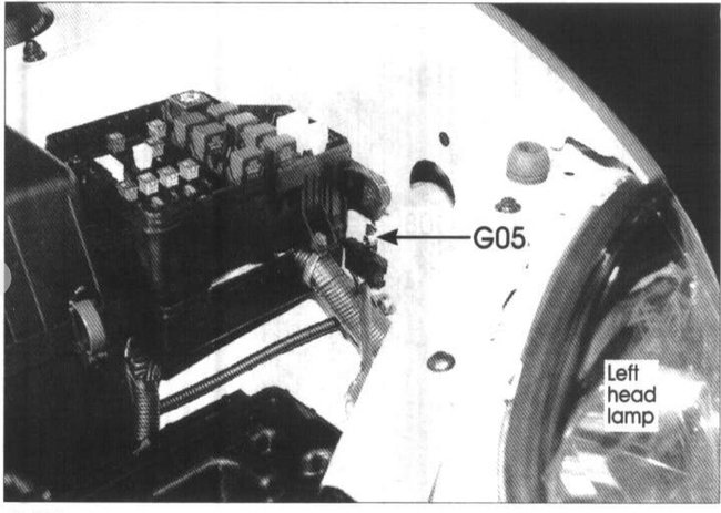

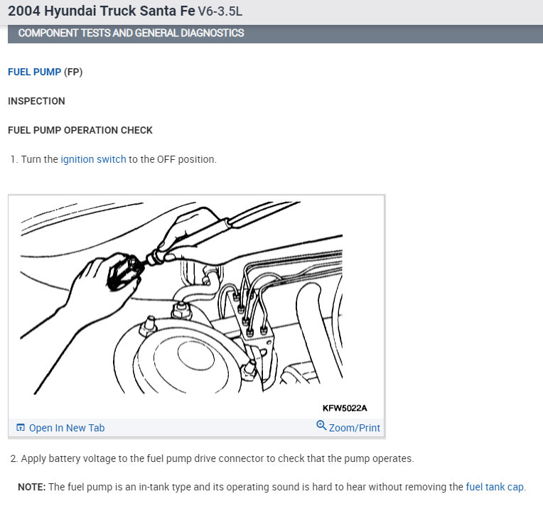

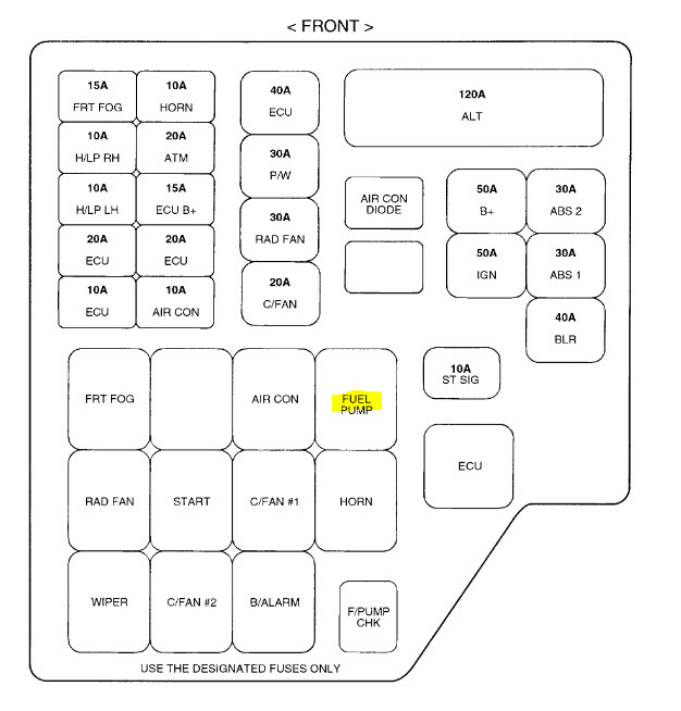

An inoperative fuel pump can be due to a bad relay, faulty wiring or a bad pump.
It is always a good idea to check the relay first.
The relay is located in the under-hood fuse box (see diagram below).
Check for any burn pins or corrosion on the relay.
Here is a guide on how to test the relay:
The fuel pump is located inside the fuel tank. There should be an access port under the rear seat.
I have also included the fuel pump and components diagnostics procedure below as well. It can help you narrow down the issue.
Let me know if you have any questions.

I'm going to go start troubleshooting the ideas with the starter spray and the heat can I get the diagram for removing the fuel pump.
Feb 6, 2022 at 1:58 AM
SQM
  • 6,383 POSTS
Sounds good. If you look on one of the earlier responses you will see I have attached the fuel pump diagram as well as diagnostics procedure.
Feb 6, 2022 at 2:18 AM

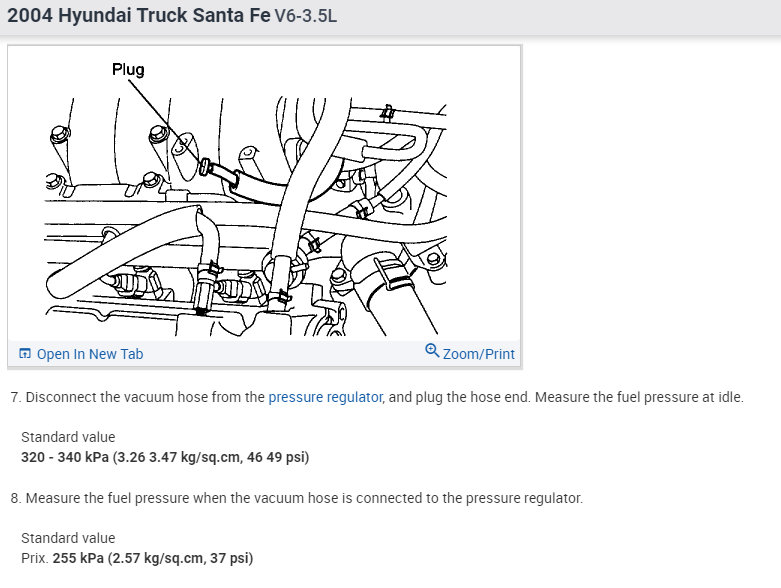

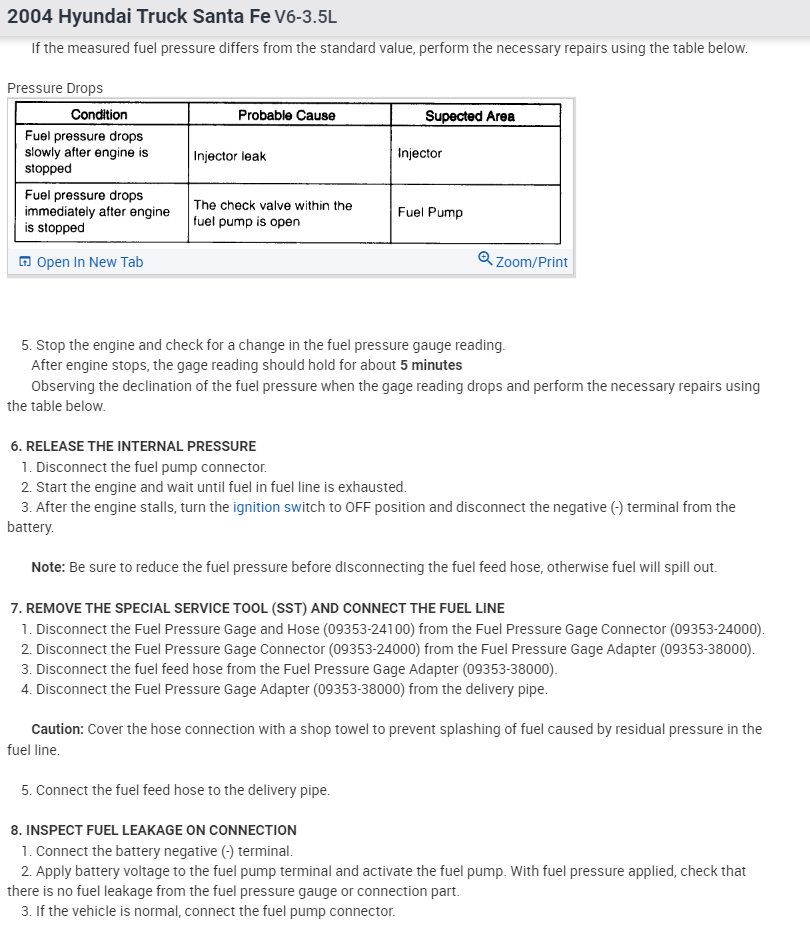

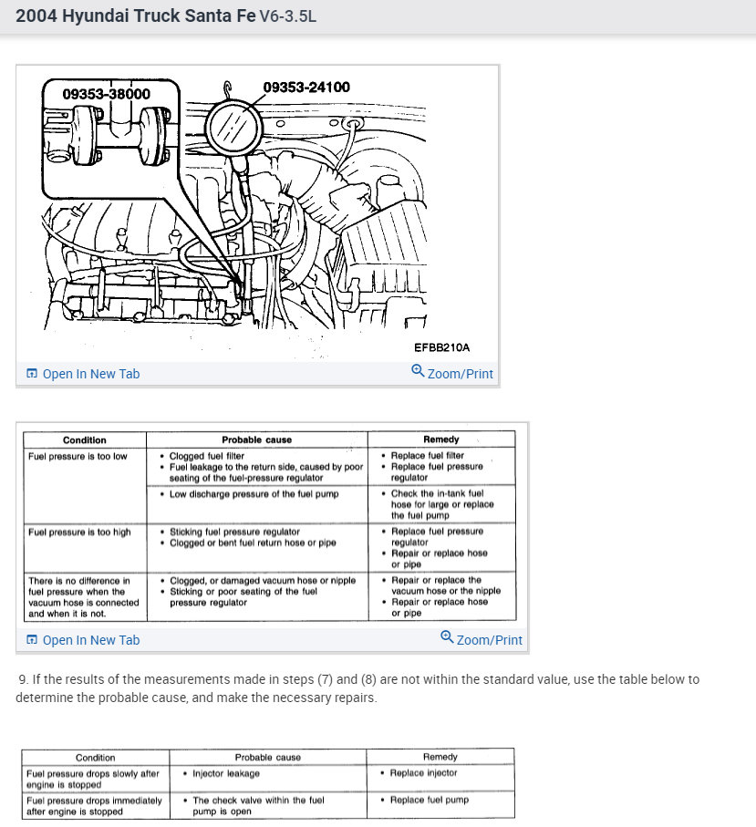

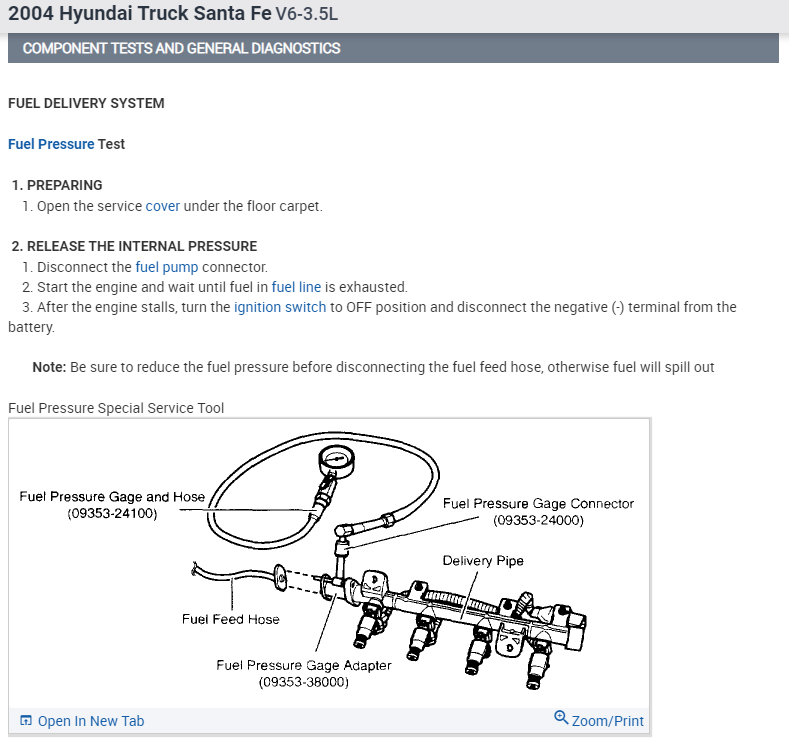

Yes, I did the starter spray, and it didn't do anything, but the spark plugs were tested with a flat head, and they have spark. the only thing I don't know if it's getting is fuel.
Feb 6, 2022 at 9:25 AM

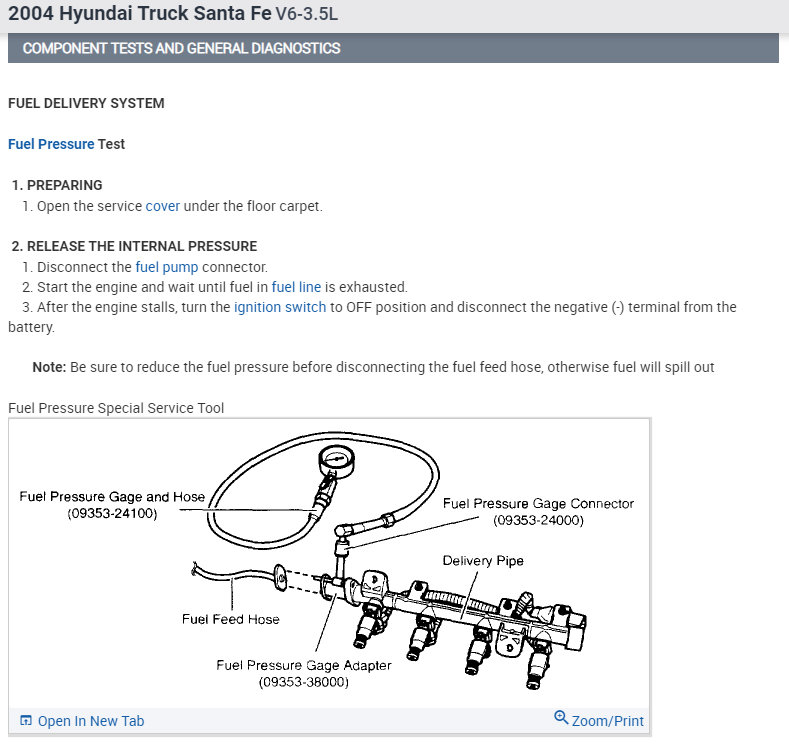

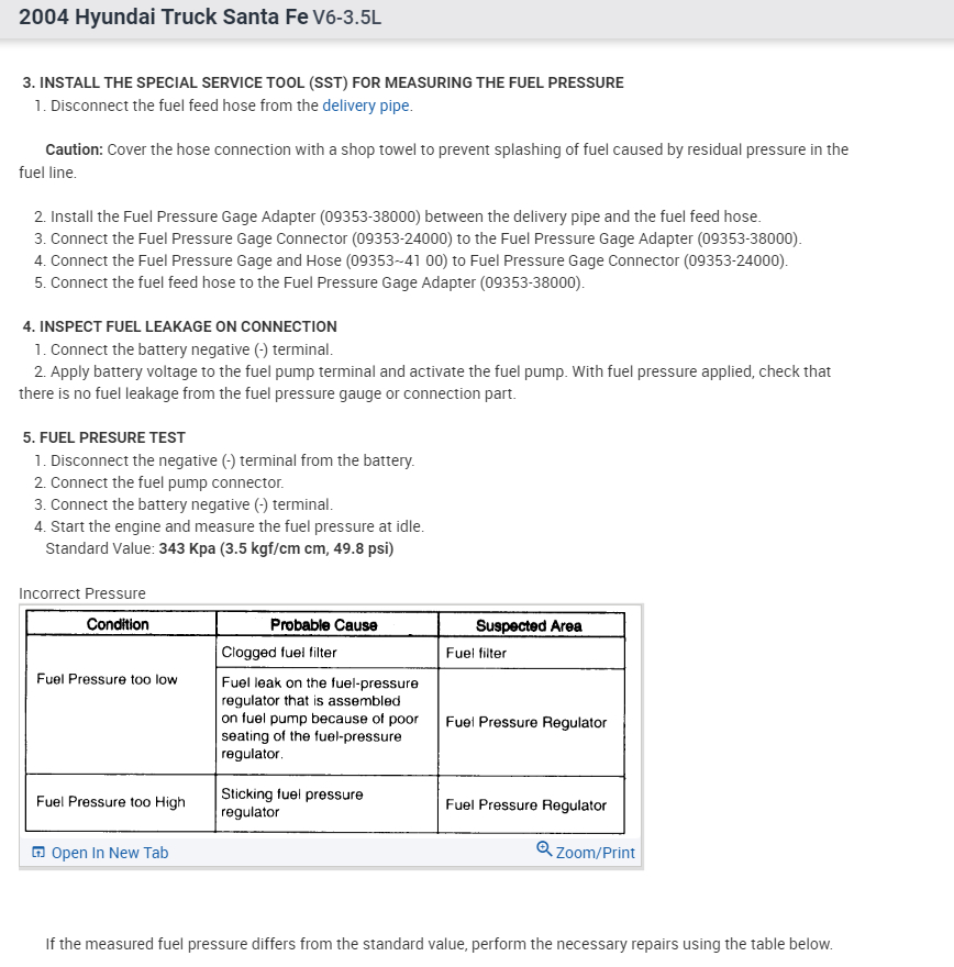

SQM
  • 6,383 POSTS

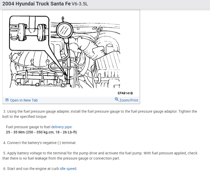

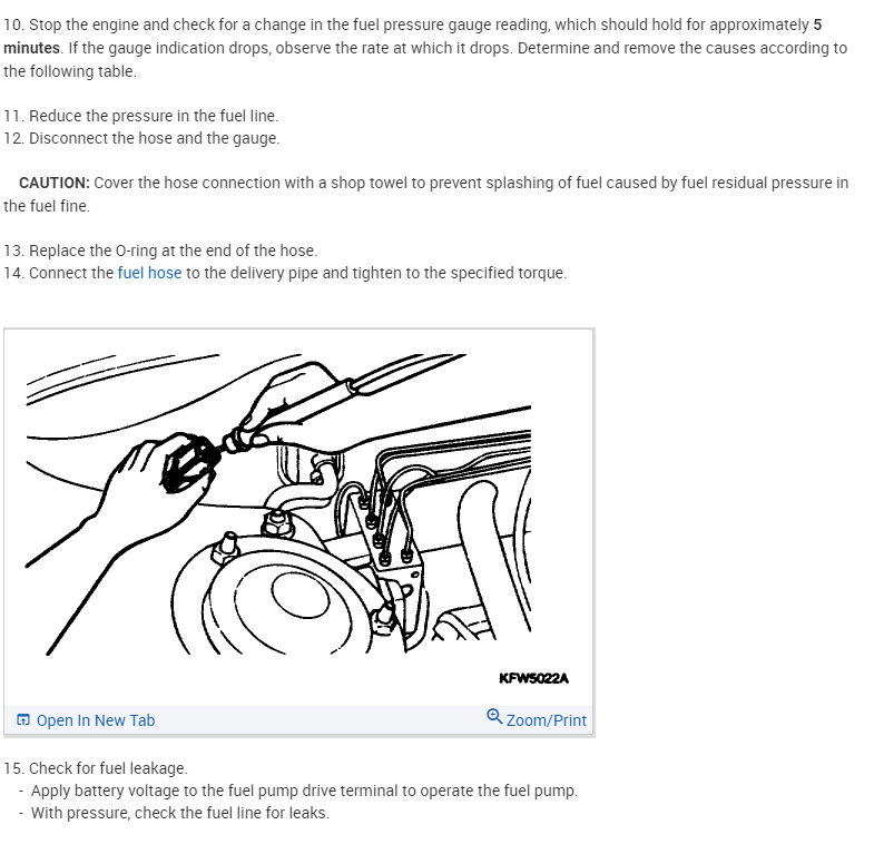

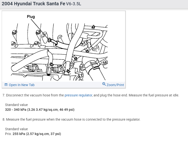

If you are unable to hear the fuel pump it might not be turning on. So might want to check the relay first to make sure it is good or replace it as needed.
You can also test the fuel pressure on the fuel rail by using a pressure gauge.
Here is the guide:
Also included the diagrams below.
