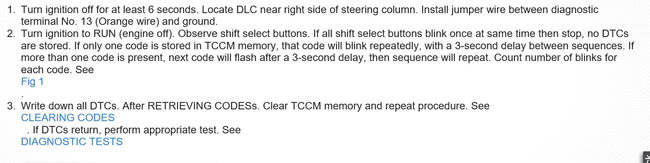

This kind of sounds like the transmission is working but tcase is stuck in neutral. See picture and scan for codes see if any come up. This must be a New venture 243 t case to do this however. Then get back with codes also check connections at tcase encoder as it may not be getting voltage.

Hi Bobby,
Here is a link to an article that features written step by step instructions and pictures explaining how to do the scan yourself, also I have included a link to our YouTube channel with a how to video on code scanning. Most scanners are inexpensive to purchase, you can purchase one online from sites like Amazon.com. Once you have the codes please get back to us so that we can further assist you. We are always happy to help.
https://youtu.be/YV3TRZwer8k

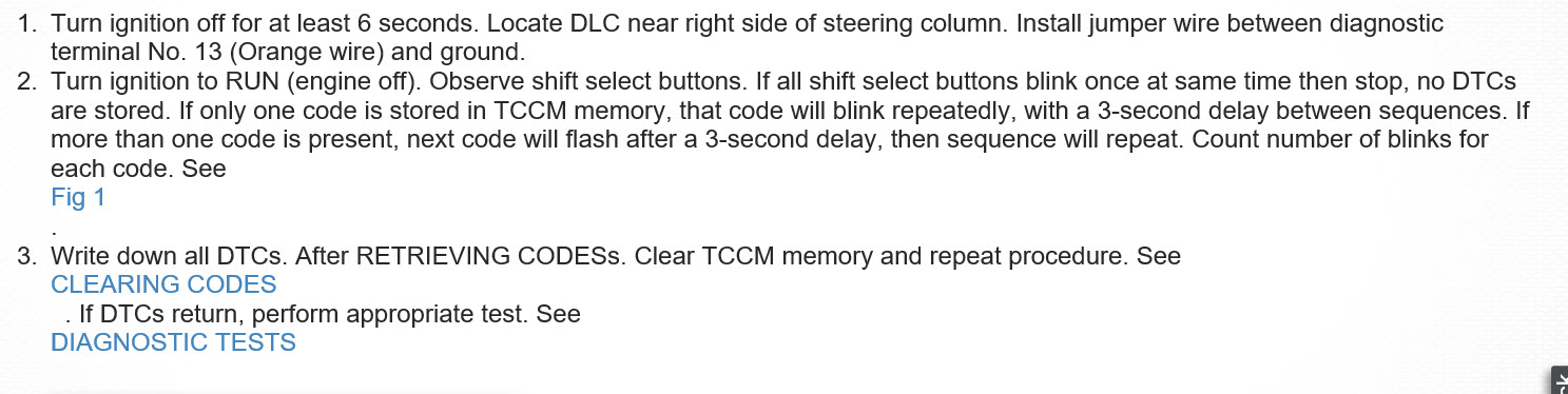

  • MASTER CERTIFIED MECHANIC
  • 48,363 POSTS
It sounds like you have a broken input shaft or other component inside the transmission. But it also could be the transfer case. I would start by scanning for codes to see if something comes up we can use to find the problem.
Here is a guide to get us started:
Thursday, May 6th, 2021 AT 10:14 AM (Merged)

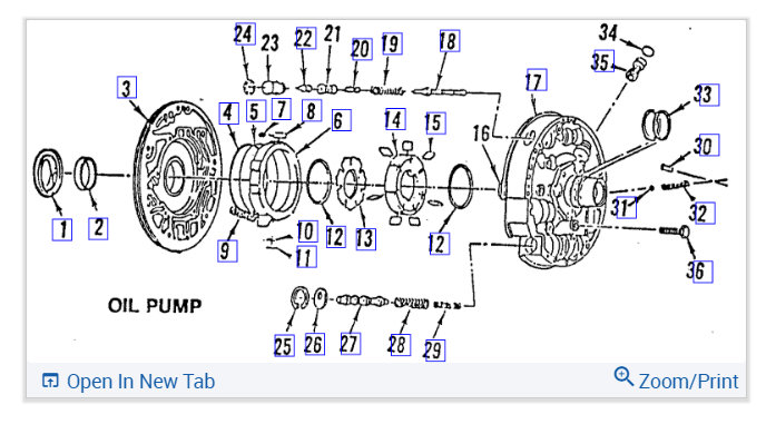

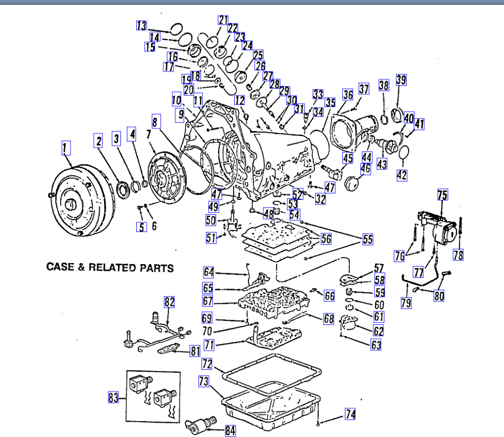

KEN L
  • 48,363 POSTS
Hi Joe,
It sounds like something let go inside the transmission like a broken input shaft. I would remove the transmission and pull the converter to inspect. Here is a video showing the job being done. Not the same car but the process is the same. Also check out the diagrams below.
https://youtu.be/3vJAojsrfuU
+1

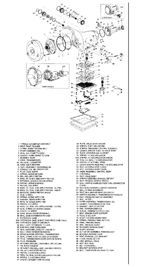

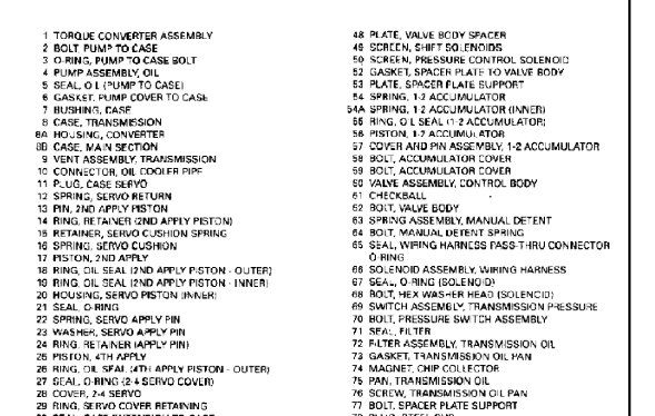

JOEYK_8899
Hi Ken and thanks for the information. Could you possibly attach the parts name list, associated with the diagrams you provided? Just wondering about your answer. Would such a cause as you suggest, would that trigger a fault code? Also, what would you think is the continual reason I keep going through TPS's? I will try to upload pictures as soon as I take some. Thanks again!
KEN L
  • 48,363 POSTS
I do not think it will cause a codes, but it does not hurt to try. Here is a guide to help and I found parts lists below:
https://www.2carpros.com/articles/buick-cadillac-chevy-gmc-oldsmobile-pontiac-gm-1983-1995-obd1-code-definitions-and-retrieval-method
