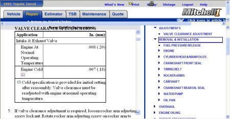

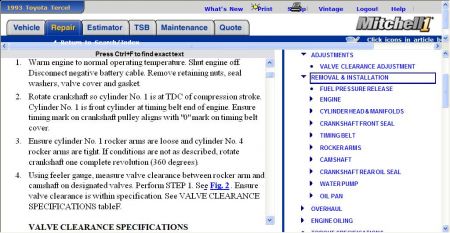

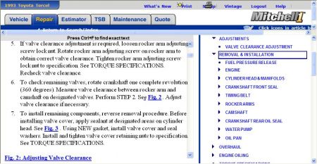

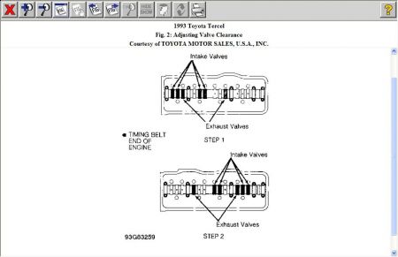

1993 Toyota Tercel 4 cyl Two Wheel Drive Manual
how do I adjust valves
Saturday, May 2nd, 2009 AT 3:51 PM
MECHANIC
75,992 POSTS
Here you go and thanks fo using 2carpros
