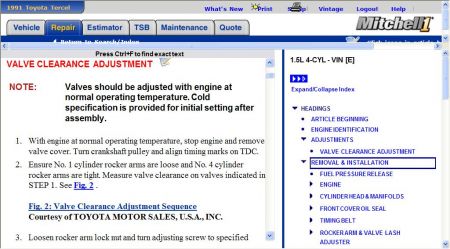

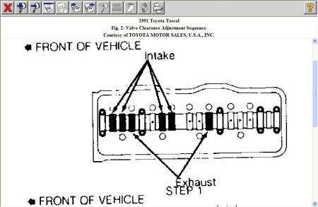

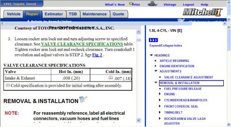

can anyone tell me how to adjust the valves on my 1991 toyota tercel 1.5L auto fuel injected

Here you go Sir -Good Luck
