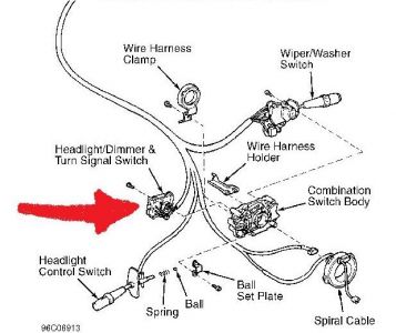

High beams issue!
1995 TOYOTA CAMRY
MBENCO
  • 184 POSTS

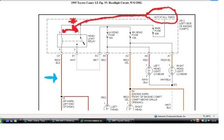

I've got that wiring diagram and even tho it says red/black , There is no red/black wire in the wiring harness going up to the switch on the steering column. The #14 pin in the connecter(where the 2 bundles of wires come together on the steering column)is a red/white wire .
Mar 9, 2009 at 3:04 PM
DAVE H
  • 13,384 POSTS
check the voltage of the wire .. then jumper it to the #4 on the relay ..then does the switch work correctly ??

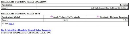

DAVE H
  • 13,384 POSTS
Hey Mike You now have a HOT going to #1 and #3 @ relay because you jumped them ...(see red arrows on diagram) so the fault you now have MUST be on the wire from #4 going (see blue arrow on diagram) to #'s 13 and 14 on the switch or the switch itself is still faulty !!! If you ground out #4 on the relay to the chassis your lights will work all the time ?? they won't be switched !!! you have a permanent live and a permanent ground to the relay !!! let me know
https://images.2carpros.com/forum/automotive_pictures/266999_cam3_1.jpg
https://images.2carpros.com/forum/automotive_pictures/266999_AAA2_145.png

The lights come on when I hooked up #4 to ground with #1&3 connected. When I was checking my pins on the old switch I found the 3rd one over from the end ( I believe it's #12 wire) of the connecter burned as if it had been shorted. So I went out to the car and disconnected the new switch and there was also a burned area on the opposing pin in the connecter going out to the relay box. The color of the wire is red/black. It doesn't appear to have hurt the wire except the plastic around the pin was melted. I never noticed it when I installed the new switch. This may have been the original problem as to why the hi beams weren't working properly. Now I have to decide on a plan to fix the problem. Question- when the HL relay is engaged shouldn't all 4 legs have 12volts on them?

He Mike ... good morning I'm getting a little confused now (ha) .. you stated 3/4 post's back that there was NO red/black wire going to the switch ? you are now saying you have a burn't red/black wire/pin on switch ?? am I correct in saying we NOW have 12 volts to #1 and #3 and you have a burn't plastic surround on the red/black wire/pin on the SWITCH pin #12 is for ground from HL switch high/flash to pass direct to HL bulbs and could well be the problem !! When you grounded #4 relay pin direct to chassis .. the switch did not work but the lights came on ... am I correct ?? Also #4 should never be HOT (12 volts) it is the ground from the switch it energizes the relay #1 = HOT all times (12 volts) #3 = HOT all times (12 volts) #4 = 0 volts @ all time's #2 = 0 volts with light's switched OFF @ switch #2 = HOT when relay is energized (12 volts) when light are SWITCHED ON at switch The HOT from #3 and the GROUND from #4 energize the relay when the light switch grounds out #4 sending the power to #2 on the relay The #12 on the switch GROUNDS the HIGH/FLASH TO PASS bulbs .. hope this helps and iv'e not confused you .. as I said I'm getting a little confused and have to keep going back over the prior post's ..(ha ha) .. let me know

To ground, YES. Terminal 4 may not be a full 12 volts, but you should have + voltage at all 4 terminals.
Mar 10, 2009 at 3:41 AM
DAVE H
  • 13,384 POSTS
ooppsss .. sorry James is quite correct you will get some voltage showing on #4 ... I think I need to go back to bed ...LOL ..

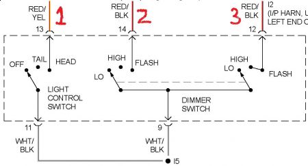

DAVE H
  • 13,384 POSTS
Hey Mike. good morning OK heres the deal mike, I had a chat with James and we discussed your problem and we looked back over the post's .. and we also re-checked both wiring diagrams, I have even looked the wiring diagram's for the years below 93/94 and above 96/97 and they are all identical ... there are no RED or RED/WHITE wires .. unless you are actually working on the DRL MODULE (see diagrams)and NOT the H/L SWITCH ... Also the DRL module sends the GROUND through a Dimmer Relay ...this would explain the voltage drop you are getting ... Could you possibly supply us with a photo of the switch and connector you keep mentioning .. I do not understand what connector you are talking about ? the #13 wire (red/yellow)should go from switch to intergration relay then change to a red/black wire from relay to relay ..the #14 (red/black) should go directly to #4 on HL relay there should be no connector in between ? let me know your thought's ?? without DRL
https://images.2carpros.com/forum/automotive_pictures/266999_cam_9.jpg
with DRL
https://images.2carpros.com/forum/automotive_pictures/266999_cam2_6.jpg
DRL module
https://images.2carpros.com/forum/automotive_pictures/266999_cam3_2.jpg
https://images.2carpros.com/forum/automotive_pictures/266999_AAA2_185.png

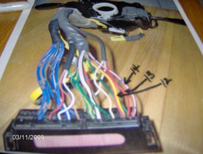

MBENCO
  • 184 POSTS
This is a picture of the switch and connecter I marked #'s 12,13,&14.the red/white is the 1st wire#14, the red wire is the 2nd, #13, the 3rd from the right Red/yellow is #12. There are eleven wires in the HL bundle.
https://images.2carpros.com/forum/automotive_pictures/326684_Picture_or_Video_712_1.jpg

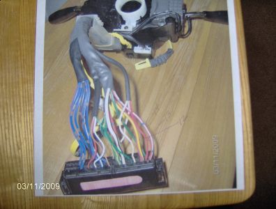

MBENCO
  • 184 POSTS
Maybe this might be a little clearer.
https://images.2carpros.com/forum/automotive_pictures/326684_Picture_or_Video_713_1.jpg

DAVE H
  • 13,384 POSTS
Hey mike.
I'm not showing a connector on my wiring diagram as you know ... so heres what i need to know !!
on your photo you have a blu/white wire marked as #14 what color wire goes to this on the other part of the connector also the same for the other 2 .. what color goes tor the red #13 and what color goes to the yellow # 12 .. what are the color of the wires coming from the car to this connector ?? I also need you to locate the actual H/L switch connector past this junction block up on the arm and tell me how many wires you have going to just this switch !! remove the big grey plug on the arm and see if the connectors are numbered ...let me know

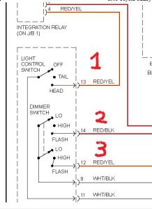

MBENCO
  • 184 POSTS
The wire #14 is red/white there are little blue dots on the wire so that's why it may seem blue. the other side of the connecter is red/black. The #13 red wire has a red/yellow on the other side of the connecter.the #12 red/yellow wire has a red/black on the other side of the connecter. When you say switch up on the arm, are you refering to the actual combination switch under the steering wheel? If so then the on/off switch has 3 wires a red and 2 whites, the wires on the dimmer part of the switch are red/white,red/yellow,black/white,blue/red. I didn't see any #'s on the wires. I hope I understood you right. If not let me know.
Mar 11, 2009 at 6:01 AM
DAVE H
  • 13,384 POSTS
Hey Mike. Sorry not replied sooner .. work/family commitments !! .. well I have looked at the pictures and your last post .. and I have to say i'm even more confused ..LOL .. none of the wires we have on our diagrams are matching up with your wires ... are you sure this is a 1995 toyota camry .. LOL .. could you supply the VIN # of the vehicle while I have a think about where to go/do next and study the post's again !!! Thanks
https://images.2carpros.com/forum/automotive_pictures/266999_AAA2_190.png

DAVE H
  • 13,384 POSTS
I need to know how many and what colors the wires are here !!
https://images.2carpros.com/forum/automotive_pictures/266999_camswitch_2.jpg
Thanks
https://images.2carpros.com/forum/automotive_pictures/266999_AAA2_191.png
Mar 11, 2009 at 2:35 PM
MBENCO
  • 184 POSTS
the wires are red/yellow , red/white , black/white , blue/red ,and then there are 3 green wires for the turn signals ( 2 green/white & 1 green/black) Vin# 4t1sk12c3su496838 the title says 95 camry
