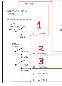

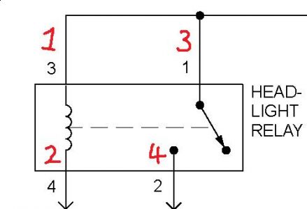

Dave: I know where I got my numbers for the relay. I got them from the Mitchill schematic that James sent me at the beginning of our discussions. Are you saying the schematic is wrong?
Mar 12, 2009 at 3:05 AM
DAVE H
  • 13,383 POSTS

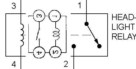

I am using Mitchell the same as James ..so we are both giving you the same diagrams !! These are the correct terminal number's ... is this what your relay looks like ?? the diagram is not an exact replica of the fusebox or how it is sat .. this could be causing the confusion !!.. on the wiring diagram the relay may be turned around and plugged in a different way ?? Use this diagram to check your PIN voltages please ?
https://images.2carpros.com/forum/automotive_pictures/266999_cam5_2.jpg
https://images.2carpros.com/forum/automotive_pictures/266999_AAA2_205.png
Mar 12, 2009 at 3:19 AM
MBENCO
  • 184 POSTS

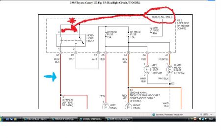

Jumped #1&3 with H/L switch off #1 is 12 volts , #2 is 12 volts , #3 is 12 volts ,#4 is 0 volts . Jumped #1&3 with H/L switch on #1 is 12 volts , #2 is 10 volts , #3 is 12 volts , #4 is 0 volts. Not jumped H/L switch off #'s 1,2,3, are 12 volts , #4 is 0 volts . Not jumped H/L switch on #'s 1&2 are 8 volts , #3 is 12 volts , #4 is 0 volts.
Mar 12, 2009 at 3:42 AM
DAVE H
  • 13,383 POSTS
OK and do the light's work in any ... especially the last test ?? Jumped #1&3 with H/L switch off #1 is 12 volts , #2 is 12 volts , #3 is 12 volts ,#4 is 0 volts . Jumped #1&3 with H/L switch on #1 is 12 volts , #2 is 10 volts , #3 is 12 volts , #4 is 0 volts. Not jumped H/L switch off #'s 1,2,3, are 12 volts , #4 is 0 volts . Not jumped H/L switch on #'s 1&2 are 8 volts , #3 is 12 volts , #4 is 0 volts.
https://images.2carpros.com/forum/automotive_pictures/266999_AAA2_206.png

OK ground out #4 to chassis or a good ground point !..does anything work now, the light's should come on .. but with no switch control ??

You are saying "Not jumped H/L switch off #'s 1,2,3, are 12 volts , #4 is 0 volts" ... we should not have voltage @ #2 with switch off .. unless our diagram of the relay is also wrong like the wiring diagram ? This is what we should have (not jumped) switch off #1 12 volts #2 0 volts #3 12 volts #4 0 volts not jumpered switch on (if it is working) #1 12 volts #2 12 volts #3 12 volts #4 slight voltage increase How are we getting power @ #2 with the switch off ?? OK jumper #3 to #2 with the light's switched ON Take out the relay and check what voltage we have coming from battery to J/B .. 2 of the pins should have 12 volts and 2 should have 0 volts with relay removed !! Also try jumpering #3 to #2 with the light's switched ON the light should work but not be able to be switched off !! let me know

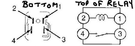

Dave: I'm still wondering if I'm understanding correctly the picture you sent of the relay posted thur. mar 12 2009 at 7:19 a.m. Am I looking at the bottom of the relay on the left view or am I looking down on the J/B socket? If I were to put that left view on top of the relay on the wiring diagram you sent on monday mar. 9 at 6:45 a.m. how would it fit?
Mar 13, 2009 at 1:26 AM
DAVE H
  • 13,383 POSTS
Hey Mike. I think James had family commitments yesterday, so let's try this .. the diagrams are showing the relay terminals but I want you to use the corresponding terminals on the JUNCTION BOX for the test's OK. First check the R/H and L/H headlight fuse's and bulbs to make sure we have not blown them ! Do you have a test light ? if not, can you make one like this .. get a bulb from the car(flasher bulb) connect (solder)a red wire to the bottom pin of the bulb and (solder)a black wire to the metal surround at the bottom of the glass .. like this
https://images.2carpros.com/forum/automotive_pictures/266999_bulb_2.jpg
OK ... remove the relay from J/B .. put the RED wire from test bulb into #1 JB terminal and the black wire from test bulb to battery or chassis ground .. the bulb should light up ! OK leave the RED wire in #1 and put the black test bulb wire to #4 JB terminal, the bulb should be OUT when you turn ON the light's at the switch the test bulb should come ON and go OFF when you turn the switch off ..if this is not happening we have a break in the RED/YELLOW wire from the H/L switch ..
https://images.2carpros.com/forum/automotive_pictures/266999_bulb2_2.jpg
Exactly the same results should happen if you move the RED test bulb wire to #3 terminal on JB and leave the black to #4 terminal on the JB ..
https://images.2carpros.com/forum/automotive_pictures/266999_bulb3_2.jpg
If the test bulb is working correctly... we have a break in the wire from #2 terminal on J/B to the headlight bulbs or the fuse's or headlight bulbs have blown !! We can test this by checking the fuse's and bulbs .. are good ...the put the RED test bulb wire into the #2 terminal on J/B and putting the relay back in place (RED test bulb wire AND relay in the #2 terminal at the same time) put the black test bulb wire to battery or chassis ground and NO light should come on, untill you put the H/L switch to the ON position .. then the test bulb should LIGHT up and go off when you turn the H/L swith to the OFF position ... Let me know
https://images.2carpros.com/forum/automotive_pictures/266999_AAA2_220.png

In answer to your question to James !!
https://images.2carpros.com/forum/automotive_pictures/266999_top_1.jpg

Dave :I know your gonna think I'm a real dummy but help me understand please. Can you transpose the top view of the relay on the right to the relay on the wiring diagram dated mon. Mar. 9 at 6:45 a.m. this would help me considerably. When I get that I think I can perform the tests better. Thanks Mike

I can see where your confusion is coming from ??
https://images.2carpros.com/forum/automotive_pictures/266999_relay2_2.jpg
But does your relay BOTTOM look like this and are the terminals numbered on the relay ?? notice that the #1 and #2 pins are smaller and offset ??
https://images.2carpros.com/forum/automotive_pictures/266999_bottom_1.jpg
Mar 13, 2009 at 4:21 AM
MBENCO
  • 184 POSTS
There aren't any #'s on my relay and there are 2 large and 2 smaller legs and they are also offset just like your picture. So which #'s are we gonna use?

OK we should have 2 hot's @ all time, one large terminal and one small !! using the test light I asked you to make ... put the black wire to battery or chassis ground point .. use the red wire to probe which 2 are HOT with the relay removed from the vehicle ... we should get one of the smaller terminals hot making the other smaller terminal #2 and we should get one of the large terminals hot making the other large terminal #4 do you agree !! even if we are not correct we can figure out which is #2 and #4 by putting in the relay after we know for sure which are the hot @ all times... remember remove the relay and test on the cars J/B, find me the 2 hots please mike and we will take it from there, once you have located 2 hots we will use the diagram on the last post marked with the 2 red crosses as both our references for terminal numbers OK .. sound good !! Let me know
https://images.2carpros.com/forum/automotive_pictures/266999_AAA2_222.png
Mar 13, 2009 at 5:32 AM
MBENCO
  • 184 POSTS
I have a small hot and a large hot. #'s 1 and 3.
Mar 13, 2009 at 6:08 AM
DAVE H
  • 13,383 POSTS
OK ...leave the relay out... using the test bulb ... put red wire to # 1 small terminal female connector on J/B .... and put test bulb black wire to the large female connector #4 on J/B ... turn onthe H/L switch ...this should light up the bulb .. if it does turn off the H/L switch ... the bulb should be out with H/L switch OFF If you then swap RED test bulb wire to large female connector # 3 on J/B ...and leave the black test bulb wire to #4 female connector on J/B ... you should get the same result's ... test bulb on with H/L switch ON and test bulb OFF with H/L switch OFF ... let me know
https://images.2carpros.com/forum/automotive_pictures/266999_AAA2_224.png

OK try the same test's but instead of the black test bulb wire going to #4 put it to #2 ... let me know
https://images.2carpros.com/forum/automotive_pictures/266999_AAA2_225.png

Dave: On the wiring diagram how about lets change #1 to #3 and #2 to #4. Is that ok with you?
Mar 13, 2009 at 7:26 AM
DAVE H
  • 13,383 POSTS
I do not understand why !! but yes !! do you mean like this ... we are going to use this diagram as a reference point for both of us ???
https://images.2carpros.com/forum/automotive_pictures/266999_relay3_1.jpg

I can call you later .. just not at the moment .. can we carry on with these test's this way for now !! .. So we are upto... black test bulb wire in new #4 and red test bulb wire to new # 3 first and then new # 1 next .. and testing if the H/L switch works with these test's .... also did you check the H/L bulbs and fuse's ?? Let me know
https://images.2carpros.com/forum/automotive_pictures/266999_AAA2_226.png

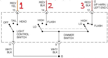

Dave: I got the H/L's to work with the switch. Here's what I did-- with the relay installed , I wired #1 & #3 together so both were hot , then I took #2 wire and jumpered it into one of the white wires coming out of the H/L switch. When I did this the H/L's worked perfect and functioned in Hi , Lo , and flash. But I don't know what to do to make it permanant and I don't know where the malfunction is in the circuit.
Mar 13, 2009 at 12:21 PM
DAVE H
  • 13,383 POSTS
hey hey Mike !! Well done ... but my questions are this .. there was no white wire on the H/L switch .. there was a white and black .. which is the switch to ground .. why did you have to jumper #1 and #3 they both were HOT last time you posted ..?? Anyway no matter .. if you did use the white/black at the H/L switch and jumped it to #2 then you grounded terminal #2 so the break is between the switch and the relay ground ..?? terminal #2 is the old terminal # 4 which we stated all along was the ground !! Is the switch working correctly now in all positions and lights going off when switch turned OFF .. let me know
https://images.2carpros.com/forum/automotive_pictures/266999_AAA2_232.png

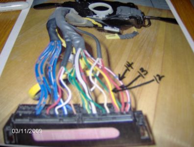

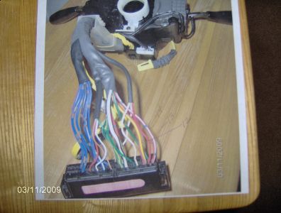

Dave: On page 7 of the posts dated wed. Mar. 11 10:01 A.M. I mentioned there were 3 wires coming from the H/L on off switch , a red and 2 whites , also 7 other wires coming from the dimmer switch and turn signals , it's one of these white only wires coming from the on off switch that I am jumpered to. Now the reason I have to jump 1 & 3 together is because when the relay is out 1 & 3 show 12 volts each but when I put the relay in 3 continues to show 12 volts but #1 only shows 8 volts ( why , I don't know ). Now as to the voltage of the white wire that I'm jumping to , With the relay out H/L switch on I get 0 volts. With relay out H/L switch off I get 8 volts. With relay in H/L switch on I get 0 volts , With relay in H/L switch off I get 12 volts ( I think the reason for the increase in voltage is due to my jumping 1 & 3 ). Now as to the switch working when it's jumped , the answer is yes , it works in all positions. Now where do we go from here?
Mar 14, 2009 at 1:27 AM
DAVE H
  • 13,383 POSTS
Good Morning Mike.
OK .... I'm still not getting these white wires .. I have been through all my wiring diagrams that relate to the H/L switch and the flashers and other systems going up to the multifunction switch ...I cannot find any refernce to "white" wires ... but the diagrams seem to be wrong somewhere ? ..
OK humour me here ...the jumper the from #4 take off the white wire and put to the RED/YELLOW wire on the SWITCH itself and let me know what happens ..does the switch work ? leave your other #1 and #3 jumper in place ??
Dave H
Mar 14, 2009 at 2:20 AM
MBENCO
  • 184 POSTS
I don't have a jumper on #4 , I have it on #2 . I took the jumper off #2 and put it on red/black nothing happened but when I put it on red/yellow , it worked perfect.

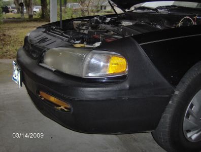

MBENCO
  • 184 POSTS
Dave reread my previous post. Something I just noticed is that my front parking lights aren't working when the lights are on or off.This is the light next to the headlight.I wonder if that could be tied into my problem.
https://images.2carpros.com/forum/automotive_pictures/326684_Picture_or_Video_719_1.jpg
