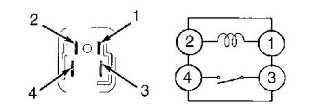

sorry I took so long to reply ..the new #2 is the old #4 ..ha ha ..so now If we ground the new #2 to the red/yelllow at the H/L switch everything works .. the fault is possibly the intergration relay... do you think you can find it !! and tell me what wires you can see going to it .. there should be your original red/black coming from the #2 .. if so we could loop around the INT relay direct to the red/yellow wire !! your thouhgt's on this ??
https://images.2carpros.com/forum/automotive_pictures/266999_int_1.jpg
let me know

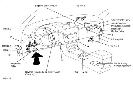

I know where the integretion relay is and I'll check and let you know what I find

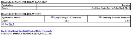

Hey Mike.. OK ..I'm thinking if you can find the red/black that goes into the INT relay and jumper it from the relay side (before INT relay)to the red/yellow on switch (bypass the INT relay) ..the light's should work without a big rewiring jobbie .. let me know ! I have to pop out for an hour ... I will be back ..LOL .. Speak soon

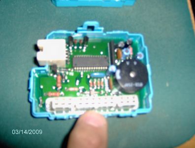

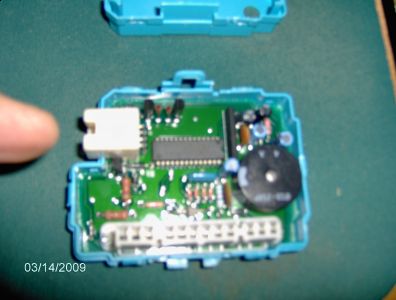

I took the relay out and it had 1 plug with 4 wires in it . The colors of the wires are , red/yellow , red/black , green/red , green.I'm sending a picture. There's also a long white connecter with 10 posts that connects with a wire bundle behind the relay and I couldn' get a look at the back where they go in. There are some #'s on the front of the relay and they are-- 82641-06010 ,

went back and hooked red/yellow on switch to the red/black on the integration relay and the switch worked turning on Hi , Lo beams and flash worked ,and on off , but no tailights and also still no parking lights. Could it be this relay? If so,Can this rely be checked?

where is the tailight relay located?

5- With your OHM meter, check terms 3 & 4 on the relay for continuity to make sure the coil is good. If they're not numbered on the relay, it's the pins that the little wires for the coil attach. If YES. go to six. If NO, you need another relay.
6- Re-install the relay.
7- Ground term #4 on the relay block. When #4 is grounded, the relay should close and high/low headlights and flash should work. YES?
8-If answer to 7 is yes, remove the ground on #4 relay term and run a wire from relay term #4 on the relay block(the same one you just grounded) to term #13, (red/blk wire) on the headlight switch. With this wire in place, the headlight functions should all work normally. We're just talking headlights here, nothing else. Headlights WORK, YES????

Can I just interject here !!! I want to make sure you are BOTH using the same terminal #'s .... remember earlier MIKE swapped his terminal numbers around ??? .... Dave H (I'm still here ..LOL)

Mike .. has the #2 terminal as our #4 and the #4 terminal as the #2 !! Anyway .. mike .. you have 12 volts at #1and #3 ...irrespective of which way round they are numbered !!! mikes #4 is going directly to light bulbs now mikes #2 the red and black wire from mikes #2 needs to be taken out of the INT relay .. and spliced/jumped to the RED/YELLOW ( we don't want the red/black wire going into the INT relay) we want it going straight to the H/L switch RED/YELLOW wire ... and then we need the INT relay wiring connector plugging back into the INT relay to let side light's and tail light's to work again !!! We have already had them working this way !!! just the side light's were not working .. because the INT relay connectors were unplugged from the INT relay !! Am I right or wrong Mike ??

The only thing is I didn't install the plug back into the integration relay after I jumped the wires ,and I disd have a jumper on 1 & 3.

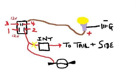

Forgive the drawing .. this is why I never went to design school and am a greasemonkey ..LOL .. WE want it like this !!

YES you didn't install the plug so the side and tail would not work !!!
Mar 14, 2009 at 11:14 AM
MBENCO
  • 184 POSTS
The way you drew isn't the way I had it set up I had a jumper between 1 & 3 because when I installed the relay the voltage dropped on #1 to 8 volts. Without the jumper the lights wouldn't work. And I didn't need a ground on #4 because it is already grounded
