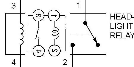

12 volts on RD/blk #3 and RD/YEL on # 13 is just what we want. That tells the integration relay is good.
Now we get to plan "B". We need to run 2 "permanent" jumpers.
1- From the RD/BLK wire connected to term #3 on the integ relay to the RD/BLK wire attached to term 14 on the HL switch. Keeping in mind, this new jumper is in ADDITION TO, NOT IN PLACE OF, the wires that are already there. We don't want to CUT or TERMINATE any wires, just splice into them.
2-On terms #1 and #3 in the HL relay block. You already have these jumpered. We need to splice in a pernanent jumper in place of the one you have now. Again, we don't want to cut any wires. The permanent jumper is in addition to the existing. Once this is done, everything should work like it's supposed to.
Any questions or problems, I'll be watching the post.

Jump #2 will work OK but Jumping from red/black on the integration relay to the red/black on the H/L switch doesn't work. But when I jump to red/yellow on the H/L relay the lights work.

Ok, that means your integration relay is bad. You need to replace it. Dave said this may be the case and he's right. Once you replace the IR. try the lights with the jumper OFF the rRD/Yel wire. If the lights still don't work, hook the wire up on the RD/BLK by Int relay term #3.

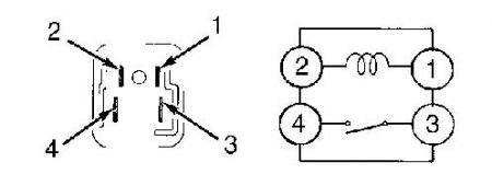

To check the INT relay is BAD .. JUMP a wire from RED/YELLOW terminal #13 @ H/L switch to RED/YELLOW terminal # 4 @ INT relay ... basically you are checking if the existing red/yellow on the car has a break in it ???
Dave H
If the light's work with #13 @switch jumped to #4 on the INT relay then the INT relay is good after all and the problem is the RED/YELLOW wire .. if the light's don't work .. the INT relay is bad !!!

dave: You said to check the integration relay, jump the red/yellow #13 on switch to #4 red/yellow on integration relay plug . Are you sure you don't mean the #3 red/black wire on the integration relay? Because when I jump the red/yellow on the relay, I get nothing , but when I jump the red/black , the lights work fine.

I want you to check if the INT relay is working .. so leave the red/black connected to INT relay and connected to the H/L relay ... jumper the red/yellow on INT relay to the red/yellow on the H/L switch ... basically you are replacing the red/yellow wire with your own wire ...leave the red/black wire from INT going to #3 on H/L relay ... If the light's work with the RED/YELOW replaced by your own color wire and going through the INT relay then the INT relay is GOOD ..and the red/yellow wire is BAD ... if the light's do not work with your wire from switch to INT relay then the RELAY is BAD .. Let me know

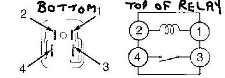

Mike, I can answer Dave's question for you if it's ok. Dave and I had discussed this on another post and I'm sure he won't mind.
Dave's thought, which is valid, was maybe the open was between HL switch term #13 and integ relay term #4. This is a circuit you and I hadn't tested and it's possible there may had been a problem here, so it was worth testing. Apparently now, after your test, the circuit between HLS 13 and Int. R 4 is good.
Have you completed the 2 jumpers yet? Let me know.

Thank's James .. yes, that is exactly what i was asking .. Mike .. if you have jumped red/yellow #13 on switch to red/yellow #4 on INT relay and the light's do not work .. then INT relay is bad ... complete the jumpers as James has requested and let us know !!

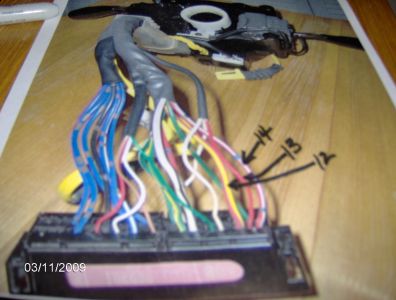

Mike. Every system you are having a problem with goes through the connecter (junction block) under the steering column .. remember the one (page 7 of these post's) you you had a photo for me .. and said some if the plastic was melted .. you need to check this again for me ..are your side and tail light's working now ??

OK .. it seems we have discrepency in the wire colors again ..while I am checking the wiring diagrams .. could you go out and start the car .. and waggle/jiggle/play around with by hand the connector (the one in the photo) see if this makes the car stop ?
Also do the wires from the ignition go through this connector (on photo) before going to the fusebox ??
On the ignition switch what color are the wires on # 4 pin and # 7 pin
Thanks, let me know

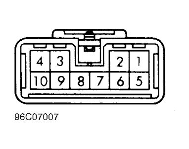

Mike. Sorry i should have included this for you
https://images.2carpros.com/forum/automotive_pictures/266999_iggy_4.jpg
Also do these wire go through the connector you have just wiggled ... ?? Also .. I am not showing anywhere a factory fit alarm/immobolizer ..for the camry models in this year or year before and after .. I think it may be an aftermarket system .. it should be showing on my diagrams !! ... can you see under the hood the alarm unit/siren ?? I realise it is getting late .. so if you want to carry this on tommorrow ... that's fine ... let me know

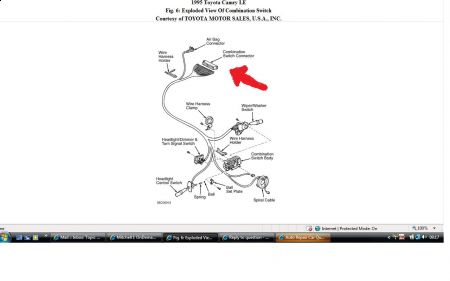

Mike. Can I start out by saying, It bugs me and James as well .. but it must be a break in a wire somewhere .. James and I discussed this and we do not like altering OEM fittings .. but I think in this case we had no other option !! The Factory Fit Alarm .. would actually show on our wiring diagrams .. so Either it was only an optional addition, which usually shows on our wiring diagrams also .. or it is an aftermarket fit ? they could still fit an alarm warning light !! now that said the only way to really check if it is factory fit is to contact a dealer and ask them to check if they fitted alarms to models in that year ?? Firstly .. have you tried the car this morning and is it acting the same .. or is it running correctly and is the battery fully charged ? OK. I need to know DO the wires FROM this plug/connector on the IGN SWITCH
https://images.2carpros.com/forum/automotive_pictures/266999_iggy_5.jpg
Go through this connector/junction block ?
https://images.2carpros.com/forum/automotive_pictures/266999_iggy2_1.jpg
Or do they go straight to the fuse box ? Let me know ? Dave H
