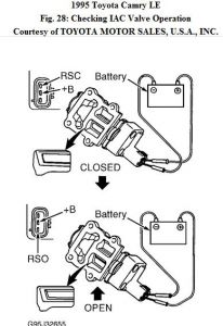

you know anything about the IAC valve? I was reading a tech report article and it seemed to indicate that a lot of 95's and 96's camry's were having a problem. Have you seen any problems.
Mar 19, 2009 at 2:18 AM
DAVE H
  • 13,383 POSTS
I still think the IAT is faulty !! it should read between 0.2 and 0.3 @212 degrees ..yours is below 0.2 ? do you happen to remeber the OHMS and temperature when you first started the test ??...this signal controls air/fuel ratio on cold start up !! Intake Air Temperature (IAT) Sensor Intake air temperature sensor is mounted in either airflow meter or air filter housing. Intake air temperature sensor measures incoming intake air temperature and delivers an input signal to THA terminal of Engine Control Module (ECM) for controlling fuel injection system, fuel pressure control (if equipped) and heated oxygen sensor systems (if equipped). There are no TSB's regarding the IAC valve .. but you can test it !! To check IAC valve operation, remove IAC valve from throttle body. Connect battery voltage and ground to proper terminals and ensure valve opens and closes. See Fig. 23. Replace IAC valve if defective.
https://images.2carpros.com/forum/automotive_pictures/266999_iac_6.jpg
Let me know
https://images.2carpros.com/forum/automotive_pictures/266999_AAA2_306.png

I had done the test on the IAC and it checked out allright. Thanks for the diagram.

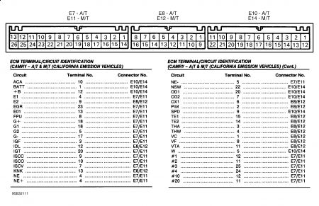

I checked the voltage coming to the IAT from the ECM and my Haynes manual says it should read 5 volts and I can't get any reading on my meter.
Mar 19, 2009 at 4:26 AM
DAVE H
  • 13,383 POSTS
Hey Mike. How was the car when you started without IAT hooked up !! was it cold/warm and did it start/run OK ?
https://images.2carpros.com/forum/automotive_pictures/266999_5_10.jpg
CODE 24 - INTAKE AIR TEMPERATURE (IAT) SENSOR CIRCUIT CAUTION:If ECM replacement is instructed in following testing, always ensure ECM harness connector and ground circuit are okay. If either are suspect, repair and repeat testing to confirm ECM malfunction. Circuit Description The IAT sensor is a thermistor mounted in the air cleaner housing to monitor air temperature flowing to intake manifold. Code is set when ECM detects a open or short circuit. ECM will operate in fail-safe mode if Code 24 is set. Possible causes are: IAT sensor open or short circuit. IAT sensor malfunction. ECM malfunction. NOTE:If Codes 22, 24, 31 and 41 are output together, inspect ECM terminal E2 (ground) circuit. Repair as needed. See wiring diagram in the WIRING DIAGRAMS - 2.2L article. Diagnosis & Repair Access ECM. ECM is located behind glove box. Turn ignition on. Using DVOM, backprobe ECM harness connector. Measure voltage between terminals THA and E2. See Fig. 5 (M/T Except Calif.) or Fig. 6 (A/T & M/T Calif.). Voltage should be 0.5-3.4 volts for cool intake air temperature and 0.2-1.0 volt for hot intake air temperature. If voltages measured are within specification, inspect connections, problem may be intermittent. If voltages are NOT within specification, go to next step. Inspect IAT. See the SYSTEM/COMPONENT TESTS - 2.2L article. Replace as needed. If IAT is okay, inspect circuits between IAT and ECM for opens or shorts. See appropriate wiring diagram in the WIRING DIAGRAMS - 2.2L article. Repair as needed. If circuits are okay, replace ECM and retest. Let me know
https://images.2carpros.com/forum/automotive_pictures/266999_AAA2_309.png

My manual is telling me you should be getting 3.4 volts MAXIMUM @ cool engine condition .. of course this all depends on outside ambient air temp and what reading the IAT sensor is sending to the PCM .. regarding ambient air temp !!

What manual are you using? I'm wondering if my Haynes manual is giving me the right info. I got 5 volts from chapter 6 page 15,it says approx. 5 volts. So if the voltage is too high what should I do?
Mar 20, 2009 at 3:21 AM
DAVE H
  • 13,383 POSTS
Mike.
We are using MITCHELL1 ..generally percieved to be the best on the market !! of course nothing is infallable .. and ours coud be wrong ..as we saw with the wiring diagrams earlier .. by the way while we are on the subject .. are your haynes wiring diagrams correct ?? ...
This manual is stating that if the voltage is wrong then check the IAT .. if this is found to be working correctly .. check wiring or replace PCM/ECM .. my option is, I would rather swap the IAT than replace the ECM/PCM
