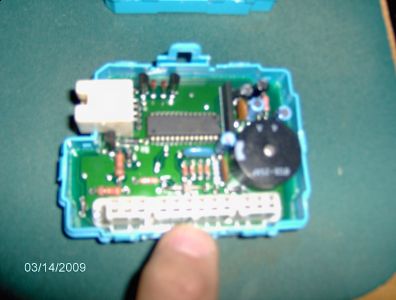

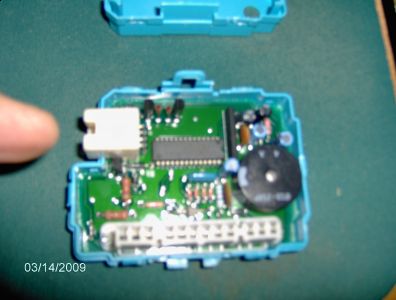

Mike. You already swapped the ECT .. you now need to swap the IAT ... the MAP be reading bad signals because of the IAT ?? Replace the IAT first ..after checking the ground .. this is the sensor that controls cold starting operation with air/fuel mixture

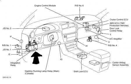

Hey Mike. If you are sure the computer may be the fault .. the only way to test this is to let toyota plug it into their diagnostic equipment .. I would first ask the tech who replaced the computer last time where he purchased the ECM and was it new or used or reconditioned !! hope this helps

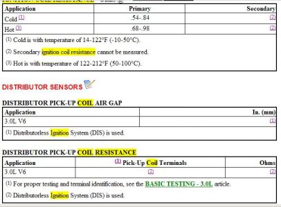

Hi Dave & James : I've been busy building my grandsons a playhouse and haven't been doing much on the Camry but it's time to get back to trying to find out why it won't start. I bought a new coil and put it in and then I checked it for resistance across the + and - poles ( the primary circuit) and it showed no resistance. The secondary circuit showed 13.2 olms resistance. What resistance reading should it have? Will it work with zero resistance across the primary circuit?

Mike, this should help.
https://images.2carpros.com/forum/automotive_pictures/248092_95_toyota_camry_1.jpg
Apr 13, 2009 at 3:59 AM
MBENCO
  • 184 POSTS
Thanks James : the resistance was 8.0. so the coils good.
Apr 13, 2009 at 10:24 AM
JAMES W.
  • 2,394 POSTS
Do you mean- .80 or 8.0?
Apr 13, 2009 at 10:36 AM
MBENCO
  • 184 POSTS
yes it's .80 sorry about that.
