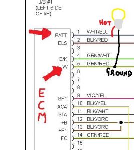

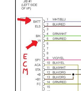

Morning Mike. You need to check you are getting power to ECM very first pin #1 (white/blue wire)and check the ECM is grounding the CEL pin #5 (green/red wire) .. obviously check the #5 with ECM plugged in and someone turning on ignition for you because it will only ground it for a few seconds unless there are codes stored !!

Dave:The #1 pin has 12 volts going to it . The #5 pin also shows 12 volts when ignition is turned on.

Dave: I can't figure out what's going on with the readings I get. When I hooked up a test light to the #5 pin it wouldn't light up and yet the meter (new one I just bought) shows 12volts. I swapped out ECM and same thing. The test light was purchased at autozone and I also tried it on the #1 pin and it worked. So it's not the meter or the light. What amI doing wrong???

What white/red wire and what did you jump it too ??? Put the live from your tester to the #1 hot feed and the ground from tester to the #5 ... when you start off the flash sequence it should flash the codes on your tester !!! I have to go out .. will be back a little later !!

Sorry I got my colors mixed up. I jumped the #1 pin(white/blue wire) to the #5 pin(green/red) and the check engine light came on but no codes will come up. The self diagnostic system isn't working.

NO jumper's ... a bulb or tester setup like this diagram... when you start off the flash code sequence .. to get the CEL to flash ... your bulb or tester will flash instead !! NOTE .. setup the bulb/tester and turn on the ignition and the bulb/tester should light up and be on constantly if there are codes stored ... just like the CEL would ...If nothing happens, the damage may already be done and you will need to swap out the ECM again ... you could have already blown it with the jumper wire ... it's late ... so I expect to hear from you tommorrow

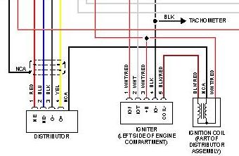

Hey Mike. I'm still around ...LOL .. just very busy at work so not been around the forum much ... ECM uses pick-up coil input signals to switch primary ignition circuit on and off. Primary circuit is turned off when ECM delivers a signal to ignitor on the IGT wire, causing ignition coil to fire the spark plug. After delivering a command to turn off primary circuit on the IGT wire, the ECM monitors IGF circuit to ignitor to ensure primary switching occurred. See appropriate wiring diagram in the WIRING DIAGRAMS - 2.2L article for wire color and application.

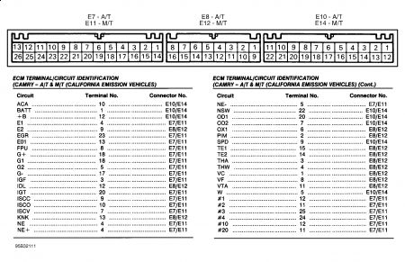

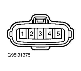

Hey Mike. No that is not my car ..I just put it there to fly the flag so to speak .... my car is better .. LOL .. And yes I'm English but I live in the USA ... I need to go back over some of your recent post's to check where we are upto ... in the meantime do these check's ... I'm thinkin at the minute the ECM may be faulty ... speak later ... Check ignition IGT signal from Engine Control Module (ECM). If ignition IGT signal from ECM is defective a diagnostic trouble code will be set in the ECM memory to indicate a ignitor circuit malfunction. See the TESTS W/CODES article for diagnostic trouble code. If IGT signal is okay, substitute another ignitor and recheck system operation. The ECM uses pick-up coil input signals to switch primary ignition circuit on and off. Primary circuit is turned off when ECM delivers a signal to igniter on the IGT wire, causing ignition coil to fire spark plug. After delivering a command to turn off primary circuit on IGT wire, the ECM monitors IGF circuit to ensure primary switching occurred. Code is set when no IGF signal to ECM for 4 consecutive IGT signals during engine operation. Possible causes are: IGF or IGT open or short circuit. Igniter. ECM. Diagnosis & Repair Inspect for spark at plugs. Remove wire from individual spark plug. Remove spark plug and insert into wire. Disconnect appropriate injector harness connector. Ground spark plug and crank engine. Ensure spark is present. If spark does not exist, go to step 5). If spark does exist, inspect IGF circuit between distributor and ECM for short or open. See wiring diagram in the WIRING DIAGRAMS - 2.2L article. Repair as needed. If circuit is okay, disconnect igniter connector. Igniter is behind air cleaner housing. Access ECM behind glove box. Turn ignition on. Using DVOM, backprobe ECM connector. Measure voltage between terminal IGF and ground. See Fig. 5 (M/T Except Calif.) or 6 (A/T & M/T Calif.). If voltage is 4.5-5.5 volts, replace igniter and retest. If voltage is NOT 4.5-5.5 volts, replace ECM and retest. Access ECM behind glove box. Turn ignition on. Using DVOM, backprobe ECM connector. Measure voltage between terminal IGT of ECM connector and ground, while cranking engine. Voltage should be .5-1.0 volt. If voltage is within specification, go to next step. If voltage is NOT within specification, go to step 11). Disconnect igniter connector. Igniter is located behind air cleaner housing. Measure voltage between harness connector terminal No. 3 and ground. See Fig. 7 . Turn ignition switch to ON posit ion. Voltage should be 9-14 volts. Turn ignition switch to START position. Voltage should be 9-14 volts. If voltage is NOT within specification, inspect igniter power supply circuit. See wiring diagram in WIRING DIAGRAMS - 2.2L article. Repair as needed. If voltage is within specification, inspect circuit between ignition switch and ignition coil, ignition coil and igniter for open or short. See wiring diagram in WIRING DIAGRAMS - 2.2L article. Repair as needed. If circuit is okay, go to next step. Inspect ignition coil. See the BASIC TESTING - 2.2L article. Replace ignition coil as needed. If ignition coil is okay, replace igniter and retest. Access ECM behind glove box. Turn ignition on. Using DVOM, backprobe ECM connector. Ensure igniter connector is disconnected. Measure voltage between terminal IGT of ECM connector and ground, while cranking engine. See Fig. 5 (M/T Except Calif.) or Fig. 6 (A/T & M/T Calif.). Voltage should be .5-1.0 volt. If voltage is within specification, replace igniter and retest. If voltage is NOT within specification, inspect IGT circuit between igniter and ECM for open or short. Repair as needed. If circuit is okay, replace ECM and retest. Fig. 6: Identifying ECM Connector Terminals (A/T & M/T Calif.)
https://images.2carpros.com/forum/automotive_pictures/266999_6_6.jpg
Fig. 7: Identifying Igniter Harness Connector Terminals

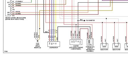

I'm putting this diagram in for you to see the wire colors !!

Dave: Are the connectors in Fig.6 for my camry ? The reason I ask is because in parenthesis above the picture it says for calif. emission vehicles. If the connecters are for my car then it looks like the ECM isn't sending out any signals to the igniter because when I disconnect the igniter then turn the key on, I don't get any reading from the IGF wire (white/red) coming out of the ECM at terminal #3 on the E-7 connecter. Also I don't get any voltage from IGT wire while cranking the engine. I am getting 12 volts to the igniter connecter terminal #3 with ignition on and connecter disconnected.
