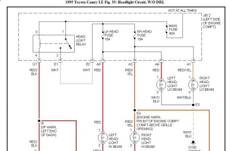

The hi beams will not come on when I turn the headlights on only low beams come on.

If all fuses are good, check the headlight control relay. It is located under the hood on the left fender well in relay block #2. Hope this helps.

James: The fuses are good and so is the relay.Also the headlight switch works fine. Is there any other relay that is dedicated only to the high beams?

Do you have DRL (daytime running lights) on your Toyota? This makes a big difference on the wiring diagram. Please advise.
Mar 4, 2009 at 7:01 AM
MBENCO
  • 184 POSTS
yes I do
Mar 4, 2009 at 7:33 AM
JAMES W.
  • 2,394 POSTS
OK, with DLR, there is another relay under the hood (#5) for the high beams. This relay is controlled by the DLR relay/module behind the instrument panel. If #5 relay is good, then it must be a problem with the DLR module. If you have, or have access to, a fax # I can ship you a copy of the diagram. I can attach it to this post, but they don't come through very well.

Mbenco said :- I checked each socket before putting in the relay.With switch off 1&3 showed 12 volts 2&4 showed 0 volts. with switch on 1&3 showed 12 volts 2 showed 0 volts and 4 showed 8 volts. After putting in the relay with switch off leg 1 showed 12 volts legs 2,3&4 showed 0 volts. With switch on leg 1 showed 12 volts leg 2 showed 0 volts legs 3&4 each showed 8 volts. Then with switch on and relay installed I grounded #4 leg and nothing happened so I put 12 volts to #3 with #4 still grounded and the relay worked and the lights came on. Hope you're good at puzzles (ha ha) Hope you don't mind me adding 2 pence worth !! If you are getting HOT @ #1 & #3 before you install the relay into JB .. but no HOT to #3 after relay is installed ... the problem must be under the JB on the wiring connector to #3 ?? especially when you then added 12 volts to #3 and everything worked !! #3 should be a HOT 12volts at all times as james has previuosy stated ... so i do not understand where the 8volts is coming from @ relay IN and switch ON ...also how did #4 show 8volts with switch on but no relay installed ?? hope this helps
https://images.2carpros.com/forum/automotive_pictures/266999_AAA2_58.png

Hey Mike. Put the relay in and with the top off check #3 it should have 12volts ... if it does not, add 12 volts to it and test the switch ..it should work correctly .. if it does then the problem must be below the JB ...on the 12volts supply terminal or wire ? let me know
https://images.2carpros.com/forum/automotive_pictures/266999_AAA2_72.png

You have stated time and again that you have no power (0 volts)to terminal #3 on the relay ... terminal #3 connects to terminal #4 when the switch is used ..by jumping between term 13 on the switch and term #4 on relay .. you are just bypassing the intergration relay !!! what happens if you just jumper the #1 and #3 terminal on the relay .. take off the ground between #13 or #5 on switch !! just jump the #1 hot terminal to #3 hot terminal ? let me know
https://images.2carpros.com/forum/automotive_pictures/266999_AAA2_132.png

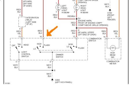

ok .. jump the #4 with the #14 (red/black wire) terminal on the switch and let me know waht happens now .. leave #1 and #3 jumped !!

Dave: I'm kind of lost because I can't find a red/black wire coming from the HL switch. I'm looking at the old switch I took out and there is no red/black wire.
Mar 9, 2009 at 2:23 PM
DAVE H
  • 13,384 POSTS
These 2 diagrams overlap a little ..the wire at the arrow ?
https://images.2carpros.com/forum/automotive_pictures/266999_cam_8.jpg
https://images.2carpros.com/forum/automotive_pictures/266999_cam2_5.jpg
