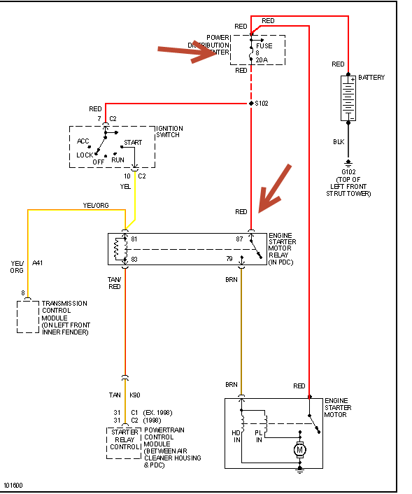

CARADIODOC
  • 33,916 POSTS
Suspect the neutral safety switch. Try starting it in neutral instead of park. If that doesn't work, be sure it's in park, then you can bypass the starter relay to see if it cranks. If it does, the engine should start if you do that with the ignition switch turned on.
To bypass the relay, remove it, then use a stretched out paper clip or piece of wire to jump terminals 30 and 87 or the two with arrows. We can do all the testing right at that socket. You'll need a digital voltmeter or test light.

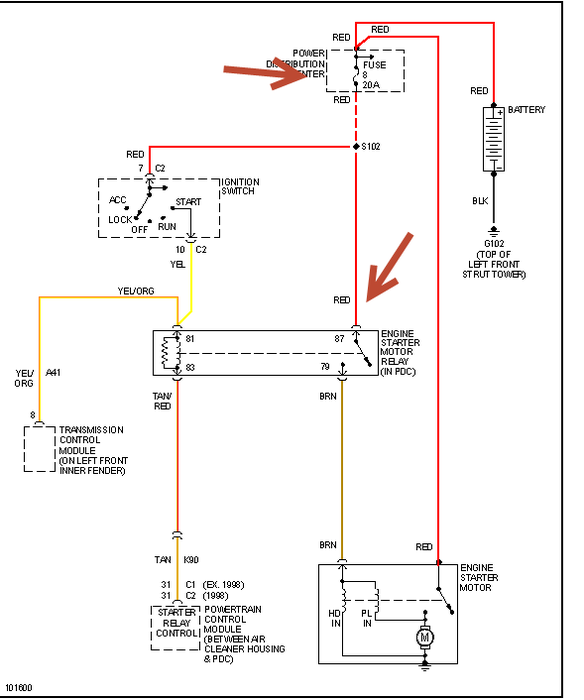

HMAC300
  • 48,601 POSTS
Recheck your install for loose/disconnected wires first. Then follow this chart to find problem but check fuse as it mayhave blown
Friday, October 18th, 2019 AT 1:47 PM (Merged)

Car was fine until I went threw alot of water and the starter and battery was checked and they are fine. Car will not start could it be a fuse. Thank you for your time and services
Friday, October 18th, 2019 AT 1:48 PM (Merged)
JDL
  • 16,098 POSTS
If your saying the starter won't crank, I'd pull the starter relay, use a testlite on the terminals. The load side of relay is hot all the time. The voltage to the coil side of relay goes hot with the key in the crank position.
HARLEY13
Yeah I figured it out it was a FUSE. Thankyou I hope this coulf help someone else.
