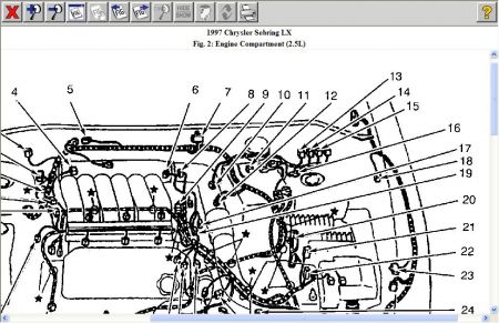

Ok, seriously need help here. He did the spark plug test and we had no spark at all, also after trying to turn it over he pulled the spark plugs and they didn't smell like fuel which he believes they should have, so he did the ignition test where you turn the key on and off to get the codes. It gave us 11, 12, 54, 55, so based on that we put a new crank sensor and a new cam sensor. The code 12 was from us disconnecting the battery cables the previous day. After replacing both sensors there was no change (still wouldn't crank), so he did the ignition thing again and it gave a new code which was 42. Code 42 in the Haynes book says Fuel pump relay or Auto shutdown relay(asd) control circuit indicates and open or shorted circuit condition, fuel level sending unit circuit problem detected. Based on that code, what would be the next logical step. Also, we need to know where both of those relays are located since we don't have the owner's manual to the car, we are pretty sure they are the relays attached to the firewall of the car, but we are not certain. Thank you in advance for you time and input, it is greatly appreciated.

Item 13 is the fuel pump relay Item 14 the ASD relay-see below
https://www.2carpros.com/forum/automotive_pictures/12900_asd_4.jpg
