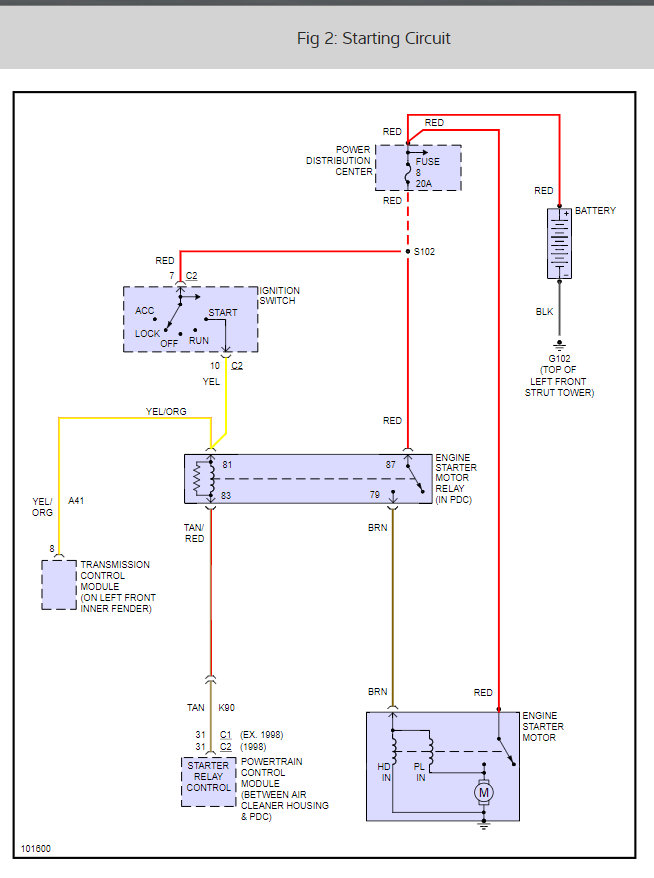

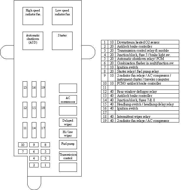

The starter circuit can be broken down into three parts. Look under the hood in the fuse box for the starter relay. Pull it out, then you can pop the cover off and reinstall it that way, then squeeze the movable contact to activate the starter, or you can use a jumper wire between terminals 30 and 87 in the socket. Be sure the car is in park, but the engine won't start unless the ignition switch is in "run".
If using that jumper wire makes the starter crank the engine, we'll know two parts of the system are working.

There isn't a starter relay under the fuse box. The choices r Tcm, wiper, interm wiper, air cond, and power top

CARADIODOC
  • 33,916 POSTS
It won't start without a starter relay. The starter relay is one of the larger ones at the top of my drawing.

No. You just bypassed it. If the relay was bad, the starter would have cranked the engine when you used the jumper wire. Doing that eliminated the most complicated part of the system. You should have at least heard a loud clunk from the starter solenoid. Since you did not, the possible causes are few. Do you have a test light or voltmeter and know how to use them?
To verify your findings, which I always like to do when I'm testing something, there are four measurements to take in the relay socket. One terminal, either 30 or 87 must have 12 volts all the time.

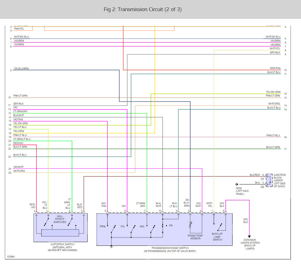

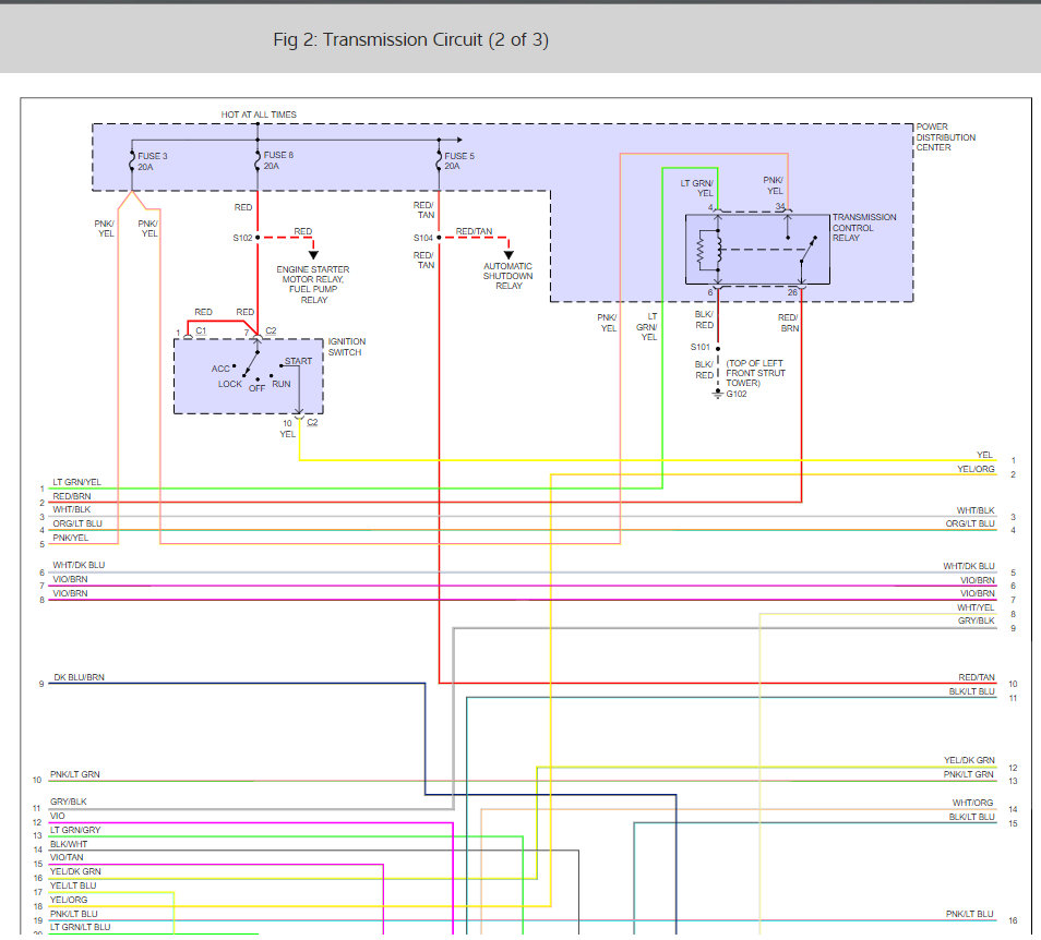

KEN L
  • MASTER CERTIFIED MECHANIC
  • 48,363 POSTS
It sounds like you have a neutral safety switch that is out and needs to be replaced. To be sure here is wiring diagram that will help you test to confirm.
https://www.2carpros.com/articles/how-a-neutral-safety-switch-works
and
I included the starter wiring too in case you need to test that as well.
