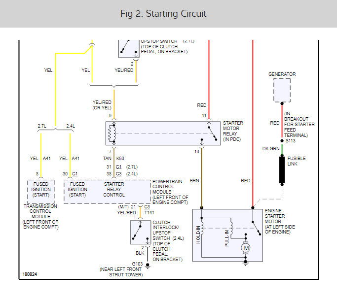

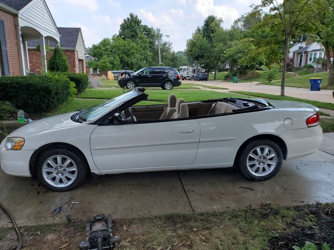

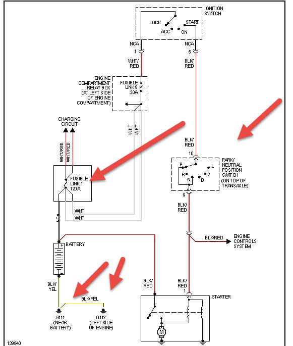

I had a neighbor come over last week and tell me "I know you like to work on cars. My wife wants this car out of the driveway. I'll sell it to you for $200.00. It runs fine but the brakes are a mess". So, okay, a $200. Car listed above convertible that runs. Never wrecked. He promises he did regular oil changes. I'm in.
So first we spent 8 hours detailing it. Turned out pretty nice. (see pictures)
So I went to work on the brakes and threw in a new battery. Brakes were the worst I've ever seen. But did hoses/rotors/calipers/pads all around.
I was having trouble getting them to firm up so i went ahead and replaced the master cylinder yesterday. Then bled the heck out of them and went to start the car to test. then car won't start.
So now here's where I'm at. Nothing happens when I turn the key to start. No luck jump starting. Turning the key to accessory works - bells, lights, and dash lights up. Besides not starting, I have no radio, windshield wipers, power windows, or gas gauge and convertible top button does nothing. Headlights/tail lights work, AC works, windows work, power mirrors work, odometer and display seem normal. No codes are reporting.
I'm assuming that in reconnecting the master cylinder level sensor, I fried the ECM? I went through all the fuses today and swapped some relays around but no love. Found no blown fuses. Battery is sitting at 12.4 volts.

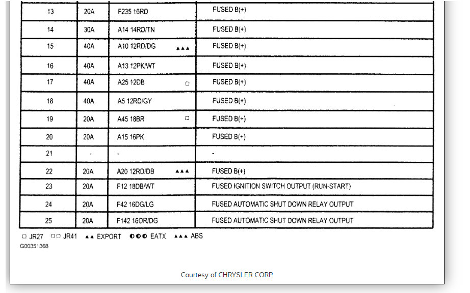

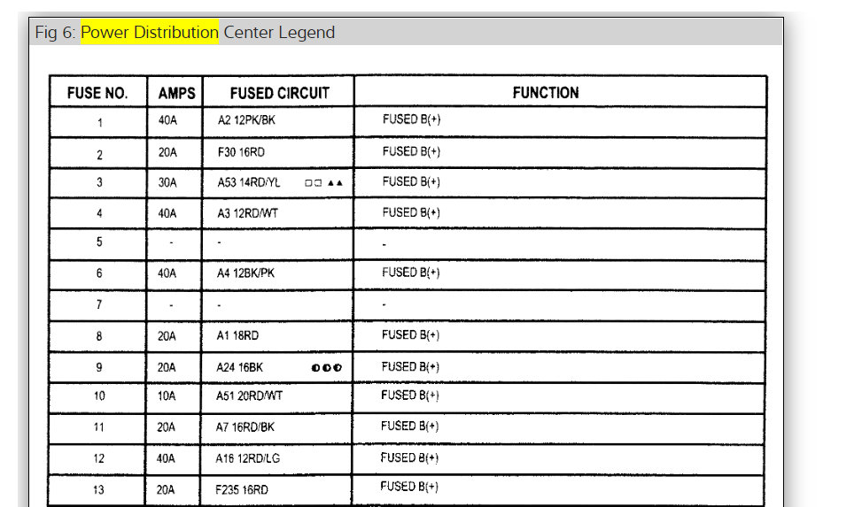

I did test the EATX relay. I get no power at fuse 25 when the wife turns the key for me.
I appreciate any advice. I see where I can buy an ECM out of a wreck for about $40.00 to $50.00.

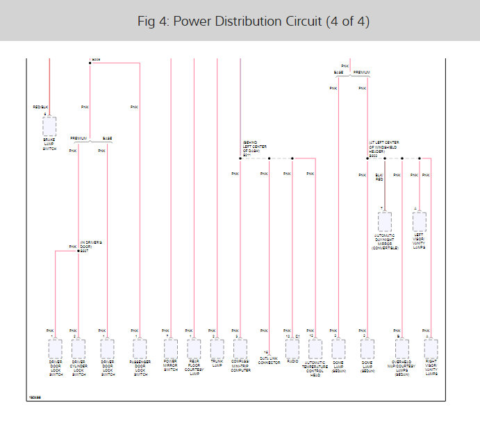

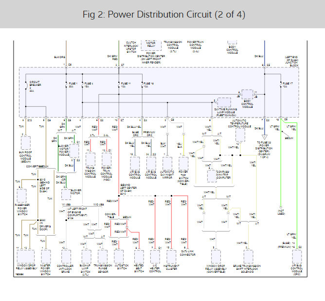

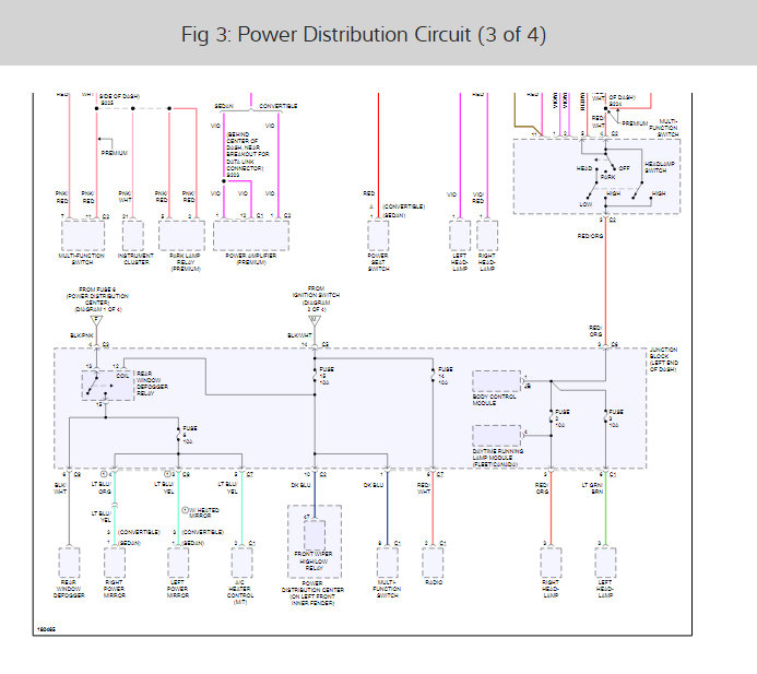

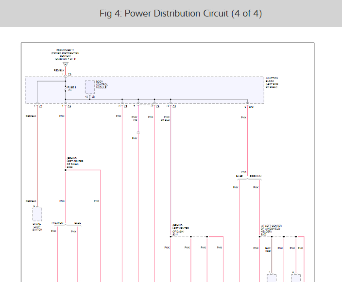

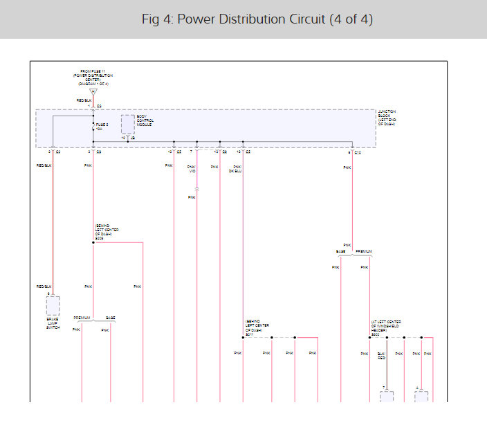

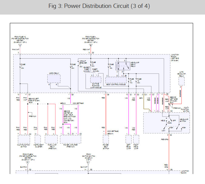

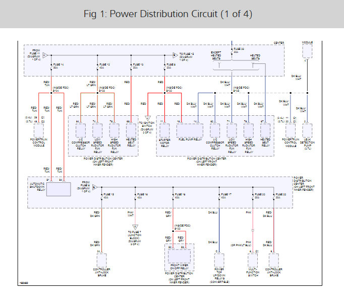

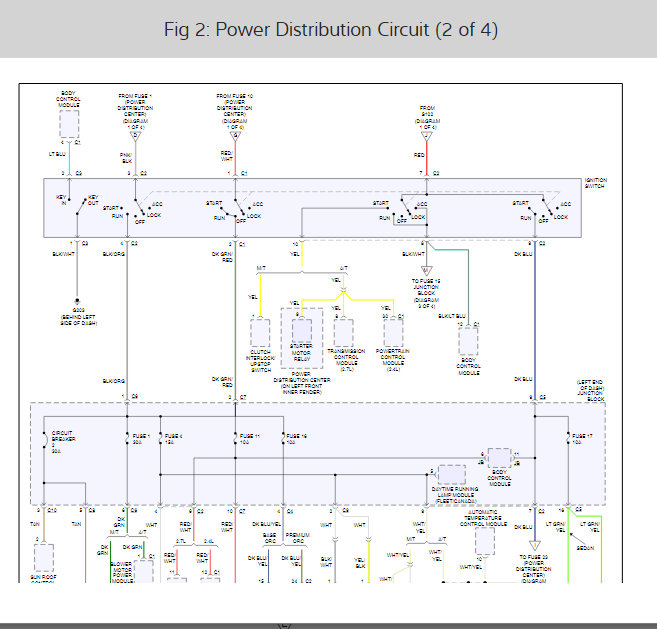

In the diagrams down below I have included the wiring diagrams for your vehicle starting circuit as well as the power distribution of your vehicles electrical system. Please check Fuse #8 in the Power Distribution Center of your vehicle. I have also included the location, diagram, and callout for it in the diagrams down below as well. Please get back to us with what you find and we can go from there.
Thanks,
Alex
2CarPros
Oct 1, 2019 at 4:39 AM
DAAAVEMAN
I can't thank you enough. I would have sworn I checked all the fuses but you were right. #8 was blown. Replaced and back in business. Everything works as it should.

HMAC300
  • 48,601 POSTS

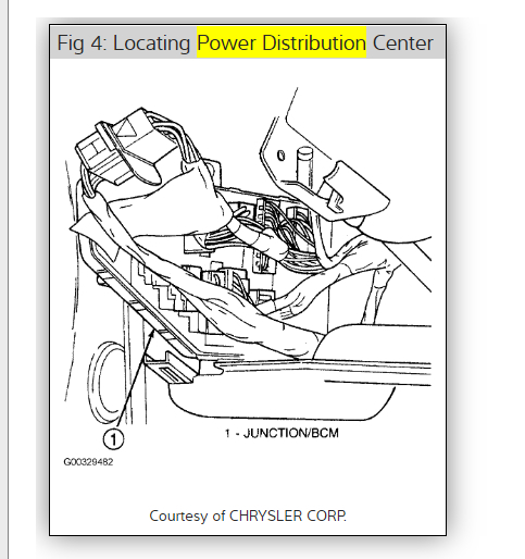

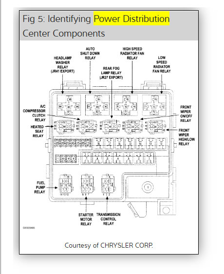

check items in pic fusible link may ony have a few strands causing problem or fuse not making good contact with fuse box.

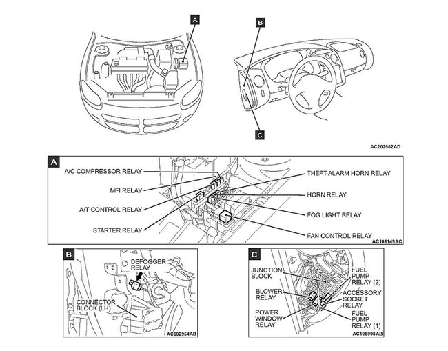

Now I checked fuse 8 (20a), it looks fine. but to be sure I swap it with several surrounding 20a fuses, no change.
I checked the ASD relay and Starter relay. Swapped them around with the fan relays (identical part number) many times with no change.

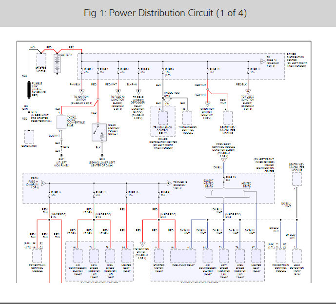

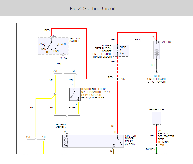

Hi Bralden, Getting a scanner to check for trouble codes would be a good idea before we continue further. If any codes are present, it may tell us what has gone wrong but it sounds liker the instrument cluster has gone bad which is common. (starter relay location below) We shall start with the starting circuit first From the schematic, check if power is available at the starter relay terminal # 87, hot at all times and terminal # 82, hot in START position.
https://images.2carpros.com/forum/automotive_pictures/192750_Starting00SebringFig35a_1.jpg
https://images.2carpros.com/forum/automotive_pictures/192750_Starting00SebringFig35b_1.jpg
https://www.2carpros.com/articles/how-to-check-an-electrical-relay-and-wiring-control-circuit Check out the diagrams (Below). Please let us know what happens.

The starter test indicates the engine computer (PCM) is not grounding the circuit for the starter relay to work.
The tester not communicating indicates the PCM is not sending any signals to it and it could be a faulty PCM or its wiring circuit.
SES indicator turning on could be due to above fault so we need to check why it is not communicating.
Does the CHECK ENGINE indicator light turn on for 2 seconds and goes off when ignition is turned on?
Seems this problem ia quite common for Chrysler vehicles. The security system could be the cause. I have sent some diagnostic files to you, let me know what you find.

I could not find any information pertaining to diagnostics of the starting system and the vehicle do have an immobiliizer system.
The PCM has a ground that is bolted onto the top of left front strut tower. For the starter to be grounded, it has to go through some components inside the PCM after all conditions for it to work are true.
Try grounding the Tan wire at the PCM terminal 31 to see if the starter cranks with the key. If it does not, you have an open in the circuit between the atarter relay.

Have a helper crank it, while you check for spark at the plugs.

i dont think the rpms are cranking....it is making that kind of clicking noise ...imma check the feul first....thank you.....
