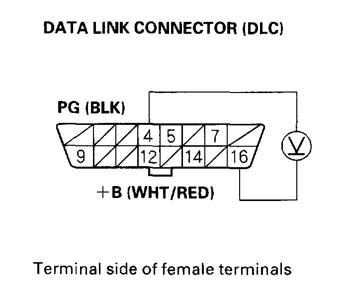

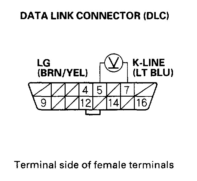

Driving about 45 to 50 mph when I noticed my tachometer dropping and the car losing acceleration. I also pulled over once I was pulled over I noticed my D light near my odometer to show what gear you're in would not appear either. I went through the other gears and it showed Park, Reverse, and Neutral but not drive. At this point I drove it home just another mile or so at a very slow rate of maybe 20 to 25 mph. I hooked up my OBD 2 scanner it repeatedly came with an error linkage message. Two days before the obd port was working because I pulled up a code for a check engine light which was an evap code. (Did not replace part for evap leakage). I am stumped. Confused if it could be a bad grounding or if the ECU is done for. Can anyone help?
Tachometer shut off, temperature gauge shut off.
Saturday, August 8th, 2020 AT 11:11 AM (Merged)
  • 110,037 POSTS
Welcome to 2CarPros.
There could be an issue at the data link connector. Since you are getting an error code, then I suggest checking the DLC for power and ground. I am going to attach a flow chart for checking all the terminals on the DLC. You will need to use a multi meter on some tests and a simple test light will work when checking for power. The attached pics correlate with the directions.

pic 1

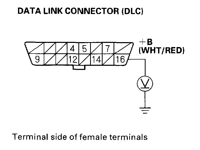

1. Measure voltage between DLC terminal No.16 and body ground.
Is there battery voltage?
YES - Go to step 2.
NO - Repair open in the wire between DLC terminal No.16 and the No.9 BACK UP (7.5A) fuse in the under-hood fuse/relay box.

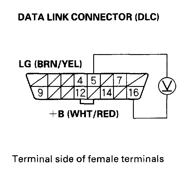

pic 3
3. Measure voltage between DLC terminals No.5 and No.16.
YES - Go to step 4.
NO - Repair open in the wire between DLC terminal No.5 and ECM/PCM (E3).

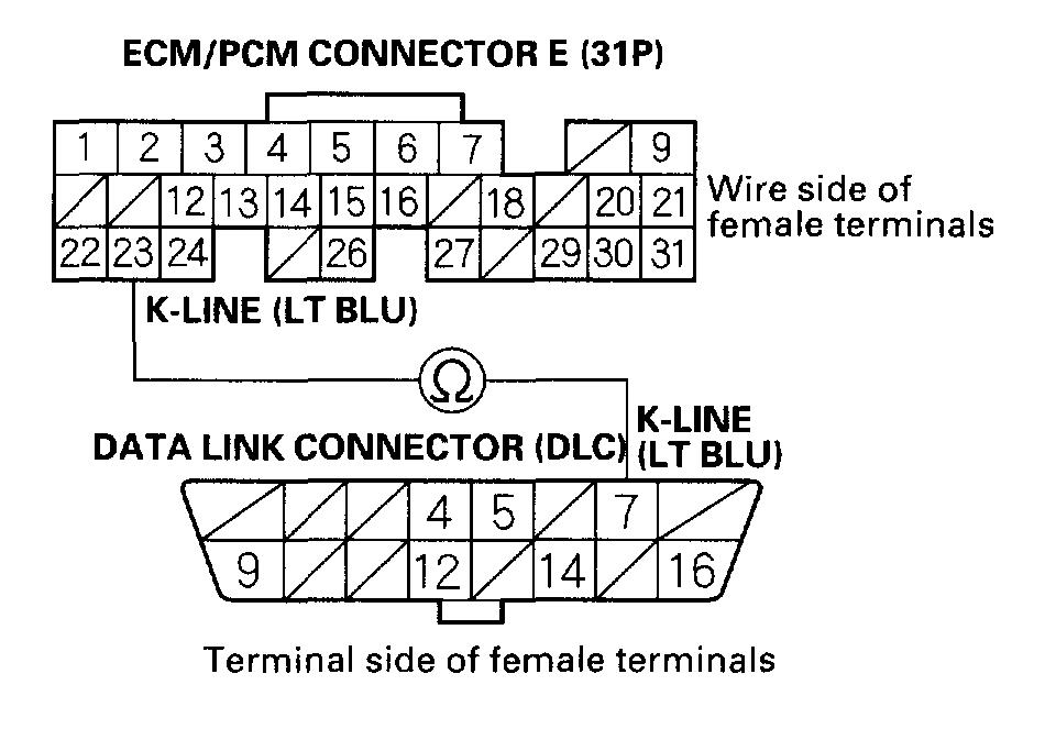

4. Turn the ignition switch ON (II).
pic 4
5. Measure voltage between DLC terminals No.5 and No.7.
Is there 8.5 V or more?
YES - Go to step 10.
NO - Go to step 6.

pic 5

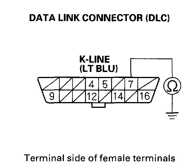

8. Check for continuity between DLC terminal No.7 and body ground.
Is there continuity?
YES - Repair short to ground in the wire between DLC terminal No.7 and the ECM/PCM (E23). After repairing the wire, check the DTC with the OBD II scan tool/Honda PGM Tester and go to the DTC Troubleshooting index. See: A L L Diagnostic Trouble Codes ( DTC ) > Diagnostic Trouble Code Descriptions
NO - Go to step 9.
pic 6
9. Check for continuity between DLC terminal No.7 and ECM/PCM terminal E23.
YES - Update the ECM/PCM if it does not have the latest software, or substitute a known-good ECM/PCM, then recheck. If the symptom/indication goes away with a known-good ECM/PCM, replace the original ECM/PCM.
NO - Repair open in the wire between DLC terminal No.7 and the ECM/PCM (E23). After repairing the wire, check the DTC with the OBD II scan tool/Honda PGM Tester and go to the DTC Troubleshooting index. See: A L L Diagnostic Trouble Codes ( DTC ) > Diagnostic Trouble Code Descriptions

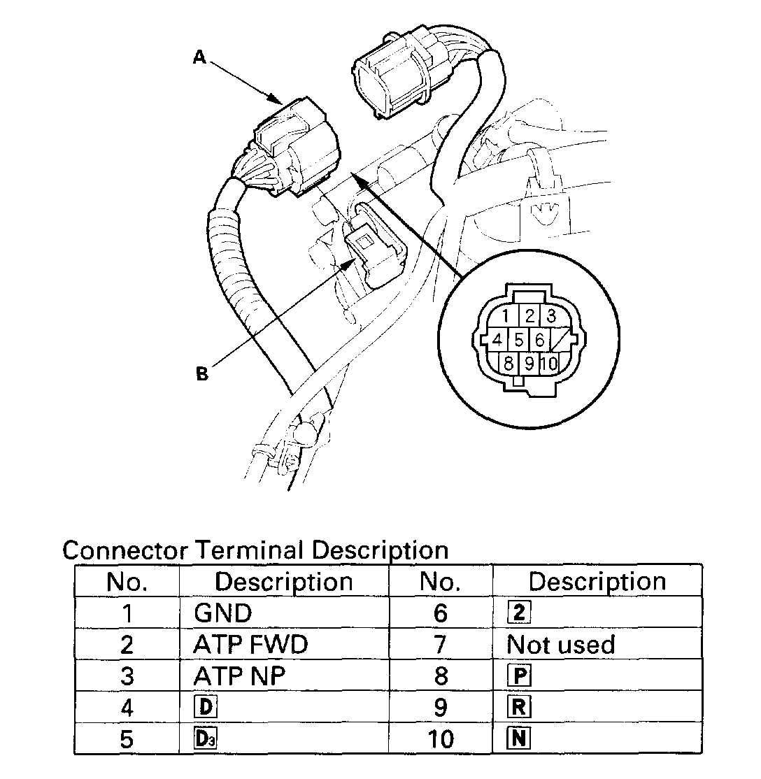

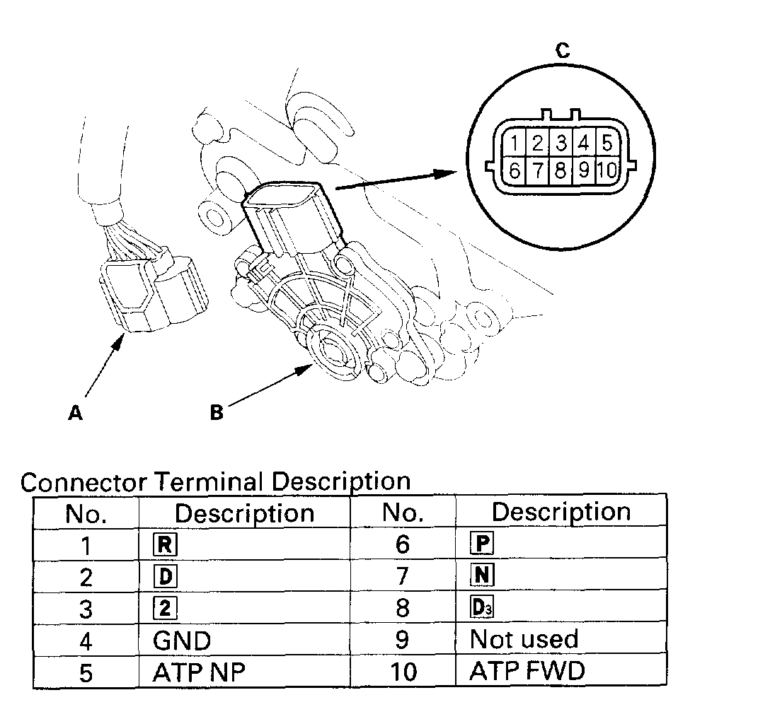

Next is the gear indicator not lighting up when it is in drive. The vehicle has what is called a transmission range sensor which identifies the selected gear. It may be going bad, have a damaged or loose connector, or corrosion may be an issue. Here are the directions for checking it. The last two pics correlate with this test.
________________________
2002 Honda Civic DX Sedan L4-1668cc 1.7L SOHC MFI
Transmission Range Switch Test
Vehicle Powertrain Management Sensors and Switches - Powertrain Management Sensors and Switches - Computers and Control Systems Transmission Position Sensor/Switch Testing and Inspection Component Tests and General Diagnostics Transmission Range Switch Test
TRANSMISSION RANGE SWITCH TEST
Pic 8
1. Remove the transmission range switch harness connector (A) from the connector bracket (B), then disconnect the connector.
2. Check for continuity between terminals at the harness connector. There should be continuity between the terminals listed for each switch position.

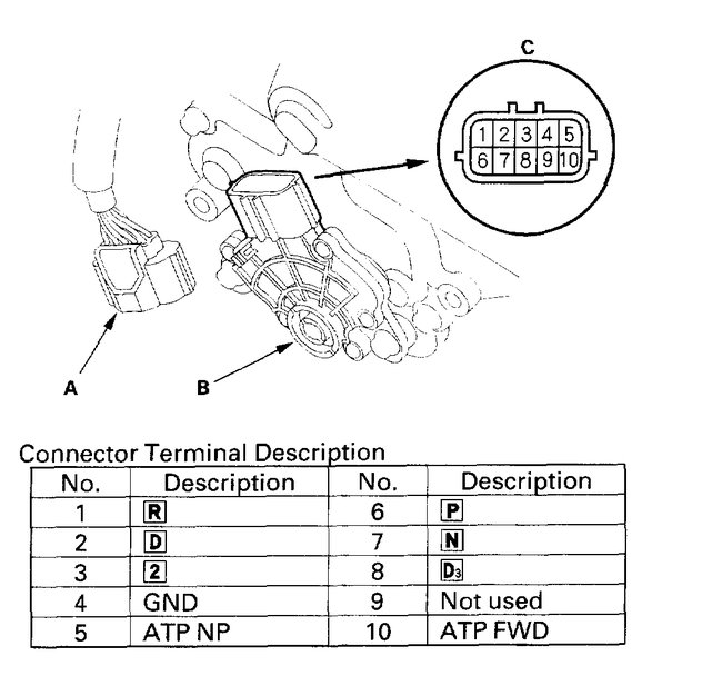

pic 9
3. If there is no continuity between any terminal, remove the transmission range switch cover, and disconnect the connector (A) at the switch (B).
4. Check for continuity between terminals at the switch connector (c). There should be continuity between the terminals listed for each position.

Thank you. Right now I am in school, but last night when I got home after work I decided to start going through some wiring and I started messing with my relays by my ECM and it was very strange, I would try t turn the engine over and it would turn over but then shut off immediately and my relay was clicking twice. Well as I started to tweak with the relays (blue one 4 prong) the car started and ran. It wasn't running great but it was running.
  • 110,037 POSTS
Welcome back:
Did the DLC work then too?
EBARGER
No, the data link connector is still giving me a link error as well as tachometer and temperature gauge still wont work.
  • 110,037 POSTS
Welcome back:
Were you able to confirm both power and ground at the DLC?
