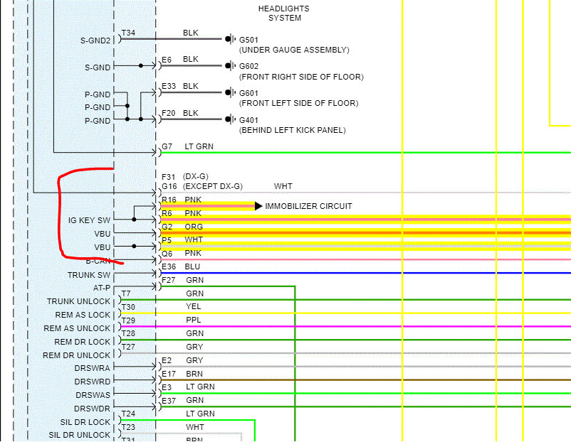

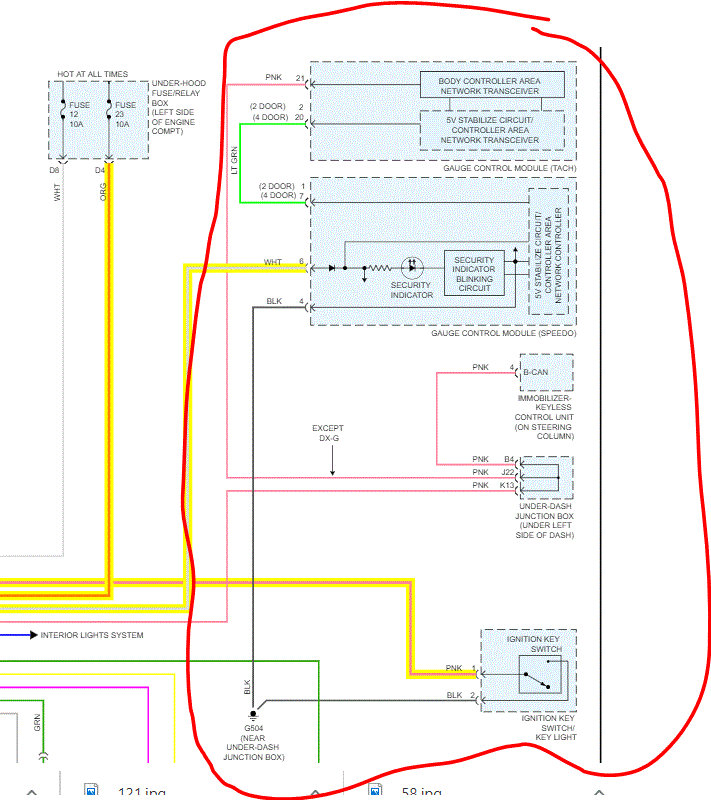

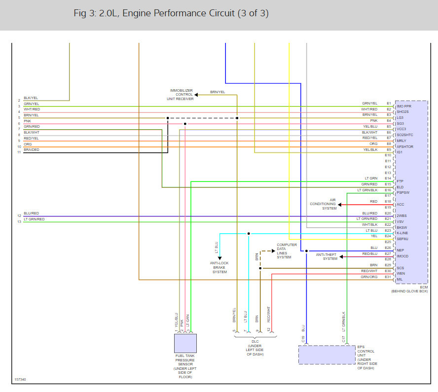

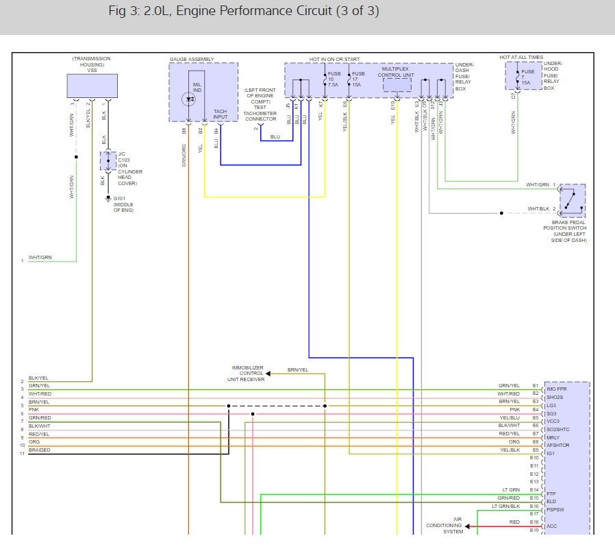

HBSB2CARPROS
  • 19 POSTS
I have the car listed above EX model, four door sedan.
The check engine light is on, the immobilizer light is flashing, there is no communication with the scan tool. The tachometer is inoperative, the temperature gauge is inoperative.The car runs sluggishly, no acceleration, engine cuts out (bogs down) at higher rpm's greater than 3,400 (when tachomdeter was working).
DLC test:
With the key on or off and ECM's p31 unplugged from the ECM, and measuring voltage from dlc pin 5 (logic ground for ECM) to chassis ground, I get a nine volt reading. With ECM's p31 plugged into the ECM, (key on or off) and measuring voltage from dlc pin 5 to ground, the reading is zero volts. Why does this happen? Is this normal? How does the logic ground function in relationship to the ECM?
Aug 8, 2020 at 11:10 AM (Merged)
MMPRINCE4000
  • 8,548 POSTS

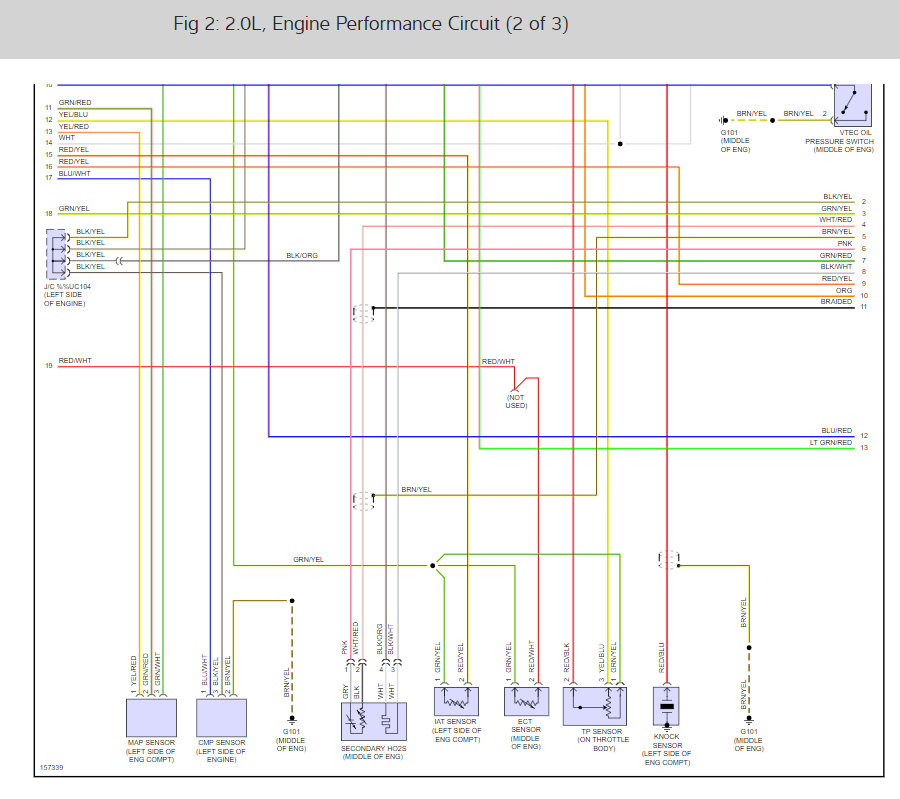

It sounds like you have a bad ground I would check them all by using this guide and the engine PCM wiring diagrams below.
Cheers

HBSB2CARPROS
  • 19 POSTS
I am stuck having to fix this problem myself because neither the Honda dealership and two other shops were unable to fix this. Definitely appears to be some kind of wire (electrical) problem.

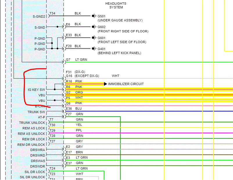

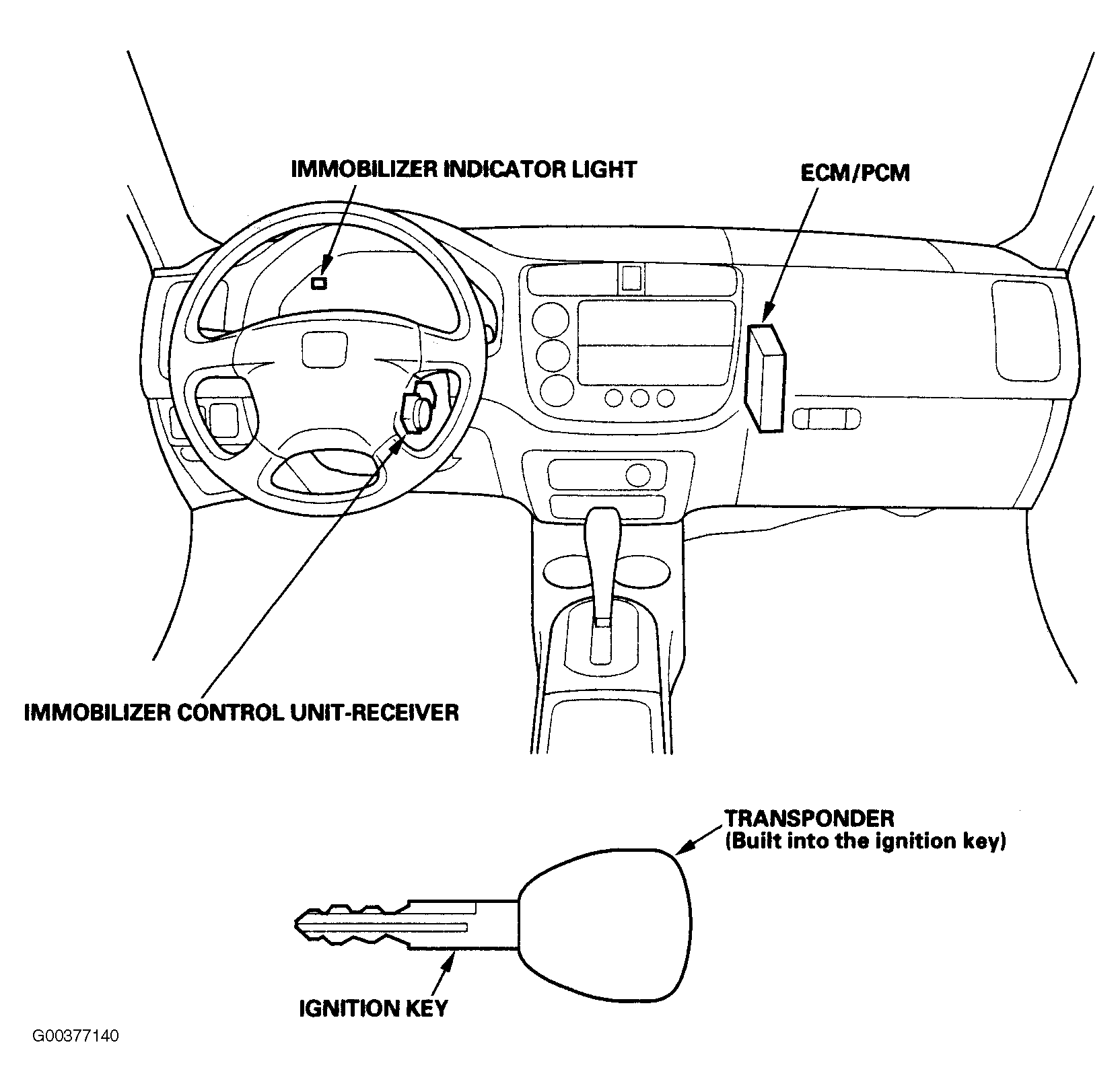

MMPRINCE4000
  • 8,548 POSTS
Troubleshooting:
Turn the ignition switch ON (II) with a programmed key.
Check to see if the immobilizer indicator comes on.
Does the indicator come on?
YES - Go to step 3.
NO - Go to step 12 .
Check the immobilizer indicator operation.
Does the indicator come on for 2 seconds, then go off?
YES - Go to step 4.
NO - Go to step 6 .
Try to crank the engine.
Does the starter motor operate?
YES - Go to step 5.
NO - Check the starter motor.
Try to start the engine.
Does the engine start?
YES - If available, check the Status Log in the Immobilizer info with the HDS (see STATUS LOG ). If the Status Log is not available, the Immobilizer system is OK at this time.
Check the diagram below.

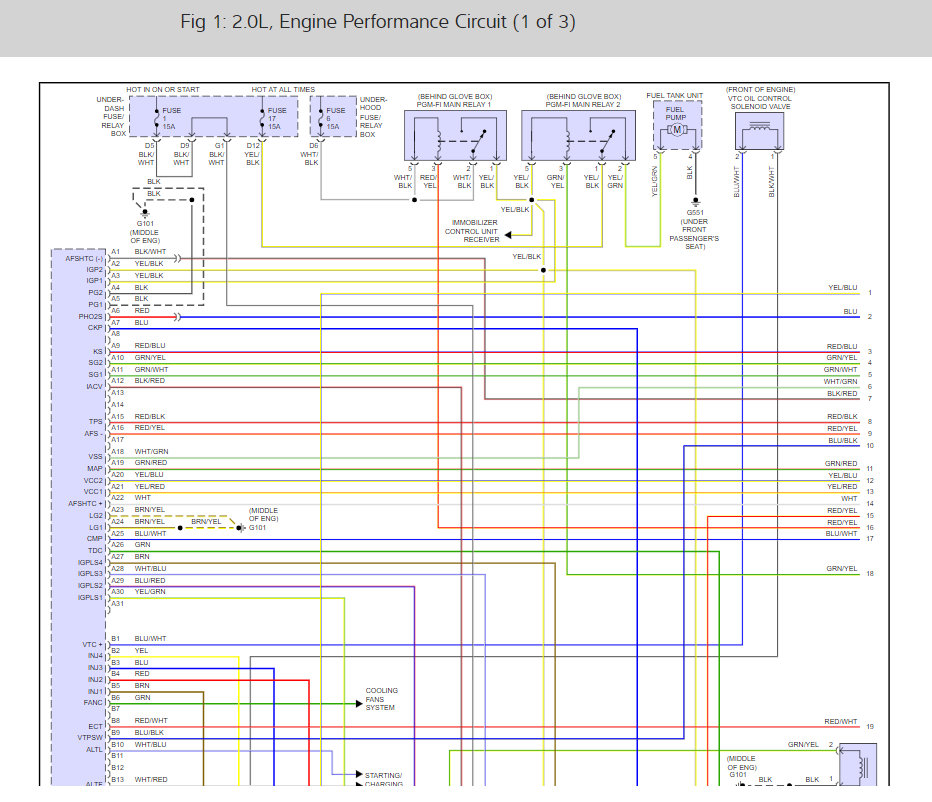

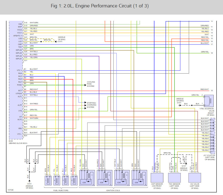

HBSB2CARPROS
  • 19 POSTS

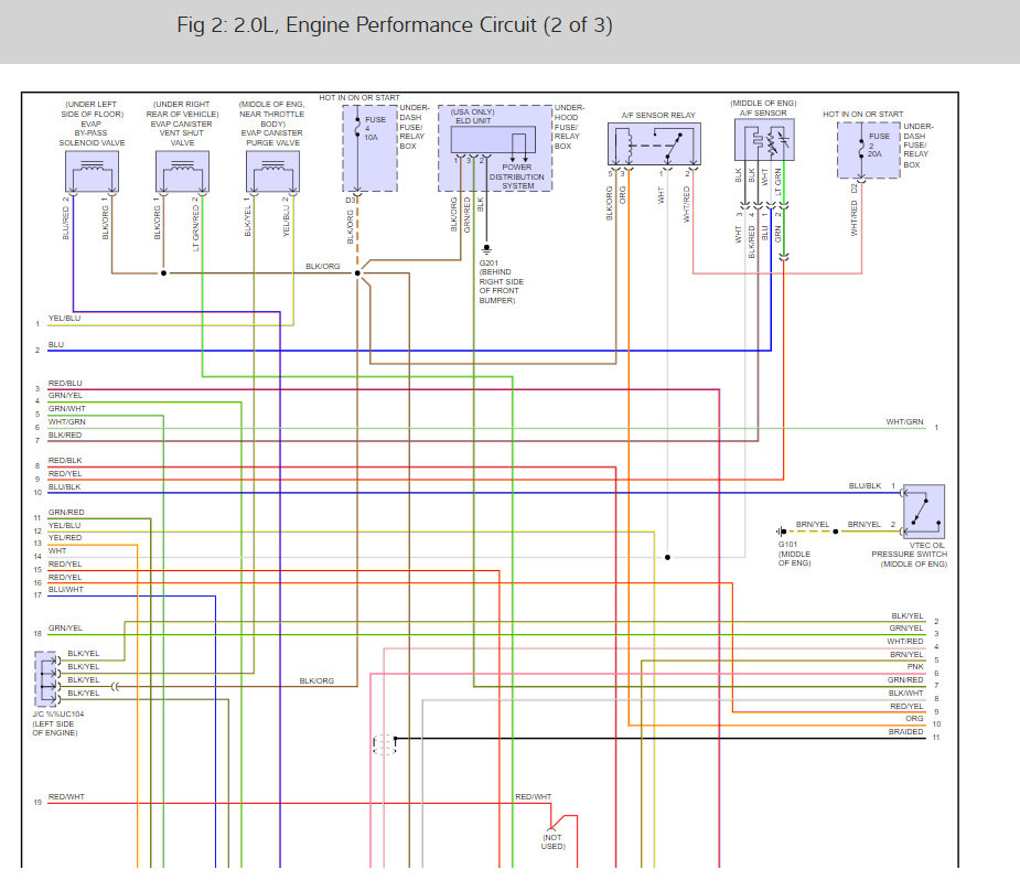

I did find the TPS voltage at the ECM would not measure any higher than ~1.7 volts. I get five volts at the TPS plug, and was able to measure 6k ohms of resistance on the TPS. I was also able to vary the throttle valve and notice the resistance vary on the TPS. I realize the TPS can still be non-linear and still be causing problems. I am having with this car.
Thanks for the accurate wire diagram, I could easily follow out the wires, their color etc. Found the bad ground and got is fixed the car runs great! I love this site.
