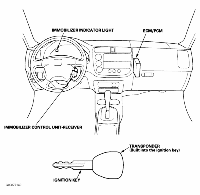

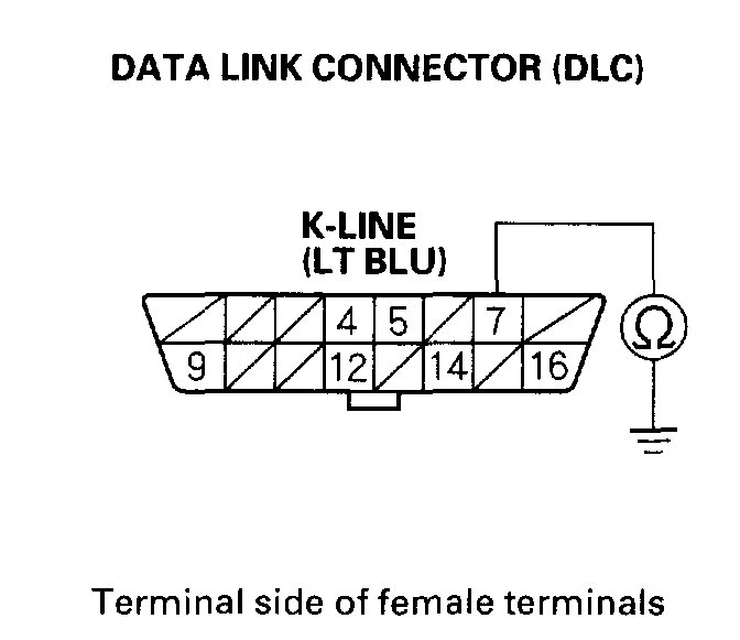

EBARGER
Driving about 45 to 50 mph when i noticed my tachometer dropping and the car losing acceleration. I also pulled over once i was pulled over i noticed my D light near my odometer to show what gear you're in would not appear either. I went through the other gears and it showed Park, Reverse, and Neutral but not drive. At this point i drove it home just another mile or so at a very slow rate of maybe 20 to 25 mph. I hooked up my OBD 2 scanner it repeatedly came with an error linkage message. Two days before the obd port was working because i pulled up a code for a check engine light which was an evap code. (did not replace part for evap leakage). I am stumped. Confused if it could be a bad grounding or if the ECU is done for. Can anyone help?
Tachometer shut off, temperature gauge shut off.
Aug 8, 2020 at 4:11 AM (Merged)

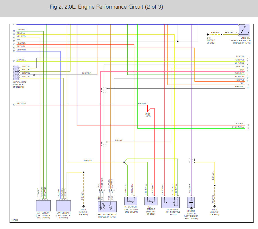

  • 110,244 POSTS
Welcome to 2CarPros.
There could be an issue at the data link connector. Since you are getting an error code, then I suggest checking the DLC for power and ground. I am going to attach a flow chart for checking all the terminals on the DLC. You will need to use a multi meter on some tests and a simple test light will work when checking for power. The attached pics correlate with the directions.
Before we get started, here are a few links you may find helpful:
______________________________________________
2002 Honda Civic DX Sedan L4-1668cc 1.7L SOHC MFI
DLC Circuit Troubleshooting
Vehicle Powertrain Management Computers and Control Systems Data Link Connector Testing and Inspection Component Tests and General Diagnostics DLC Circuit Troubleshooting
DLC CIRCUIT TROUBLESHOOTING
If the ECM/PCM does not communicate with the OBD II scan tool, Honda PGM Tester, or I/M test equipment, do this troubleshooting procedure.
pic 1

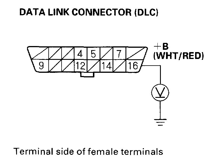

1. Measure voltage between DLC terminal No.16 and body ground.
Is there battery voltage?
YES - Go to step 2.
NO - Repair open in the wire between DLC terminal No.16 and the No.9 BACK UP (7.5A) fuse in the under-hood fuse/relay box.

2. Measure voltage between DLC terminals No.4 and No.16.
YES - Go to step 3.
NO - Repair open in the wire between DLC terminal No.4 and body ground.

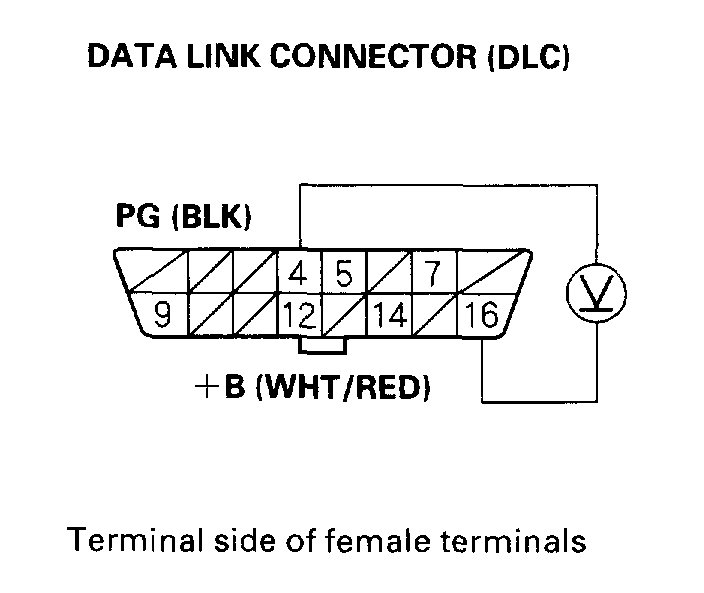

3. Measure voltage between DLC terminals No.5 and No.16.
YES - Go to step 4.
NO - Repair open in the wire between DLC terminal No.5 and ECM/PCM (E3).

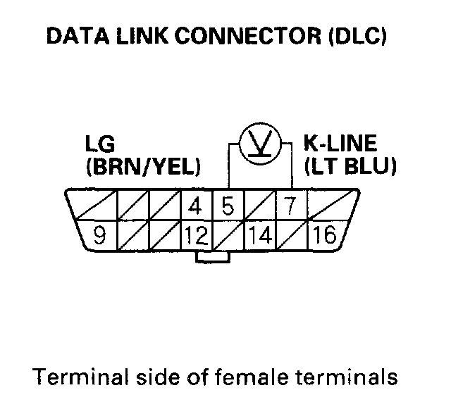

4. Turn the ignition switch ON (II).
pic 4
5. Measure voltage between DLC terminals No.5 and No.7.
Is there 8.5 V or more?
YES - Go to step 10.
NO - Go to step 6.

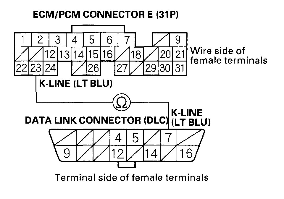

6. Turn the ignition switch OFF.
7. Disconnect ECM/PCM connector E (31P). Make sure the OBD II scan tool or Honda PGM Tester is disconnected from the DLC.
pic 5
8. Check for continuity between DLC terminal No.7 and body ground.
Is there continuity?
YES - Repair short to ground in the wire between DLC terminal No.7 and the ECM/PCM (E23). After repairing the wire, check the DTC with the OBD II scan tool/Honda PGM Tester and go to the DTC Troubleshooting index. See: A L L Diagnostic Trouble Codes ( DTC ) > Diagnostic Trouble Code Descriptions
NO - Go to step 9.

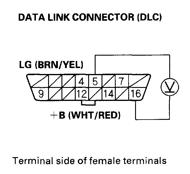

pic 6
9. Check for continuity between DLC terminal No.7 and ECM/PCM terminal E23.
YES - Update the ECM/PCM if it does not have the latest software, or substitute a known-good ECM/PCM, then recheck. If the symptom/indication goes away with a known-good ECM/PCM, replace the original ECM/PCM.
NO - Repair open in the wire between DLC terminal No.7 and the ECM/PCM (E23). After repairing the wire, check the DTC with the OBD II scan tool/Honda PGM Tester and go to the DTC Troubleshooting index. See: A L L Diagnostic Trouble Codes ( DTC ) > Diagnostic Trouble Code Descriptions

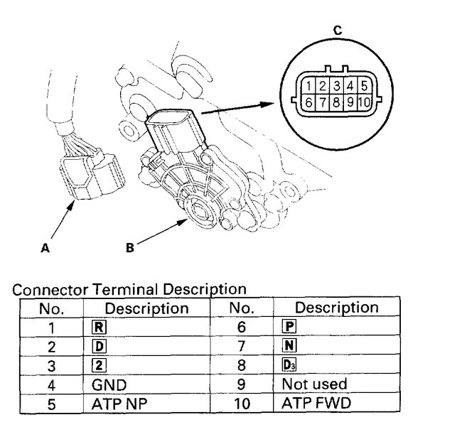

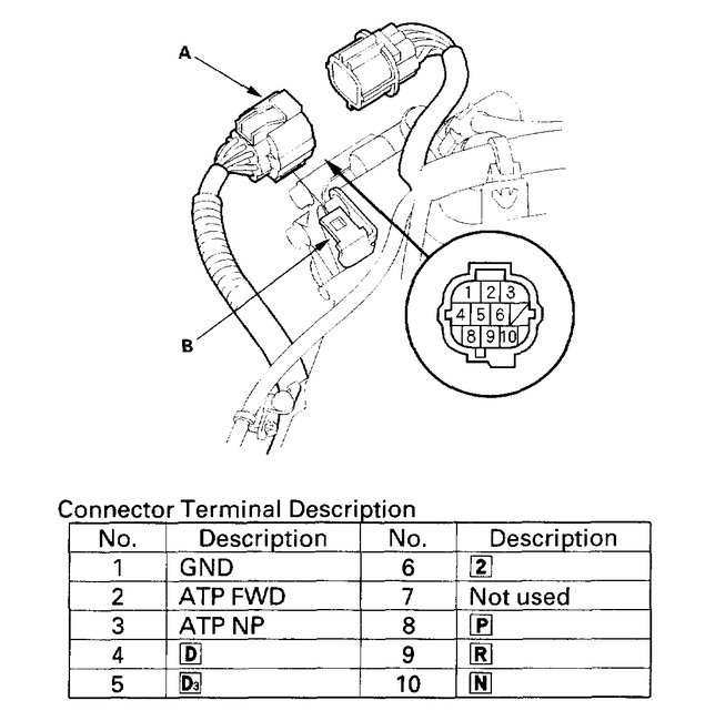

Next is the gear indicator not lighting up when it is in drive. The vehicle has what is called a transmission range sensor which identifies the selected gear. It may be going bad, have a damaged or loose connector, or corrosion may be an issue. Here are the directions for checking it. The last two pics correlate with this test.
Transmission Range Switch Test
Vehicle Powertrain Management Sensors and Switches - Powertrain Management Sensors and Switches - Computers and Control Systems Transmission Position Sensor/Switch Testing and Inspection Component Tests and General Diagnostics Transmission Range Switch Test
TRANSMISSION RANGE SWITCH TEST
Pic 8
1. Remove the transmission range switch harness connector (A) from the connector bracket (B), then disconnect the connector.
2. Check for continuity between terminals at the harness connector. There should be continuity between the terminals listed for each switch position.

pic 9
3. If there is no continuity between any terminal, remove the transmission range switch cover, and disconnect the connector (A) at the switch (B).
4. Check for continuity between terminals at the switch connector (c). There should be continuity between the terminals listed for each position.

EBARGER
replaced ECU along with immobilizer and a new key. Car runs normal again. All of my gauges on the dash are on and working.
  • 110,244 POSTS
Welcome back:
Wow. That's a lot. I was hoping the ECU wasn't the issue, but I'm glad to hear you got it working right again.
