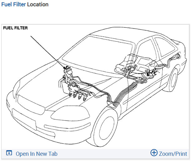

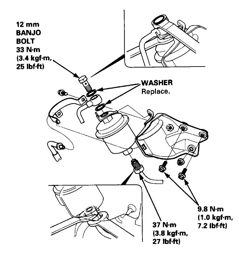

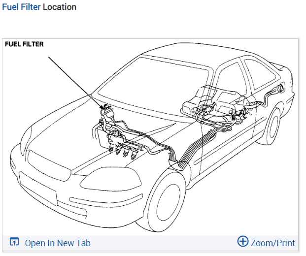

When going up the hill is the motor reving higher may be the trans is slipping if not sounds like its starving for fuel check fuel pressure and fuel filter
Sunday, December 9th, 2007 AT 7:14 AM
KEN L
  • MASTER CERTIFIED MECHANIC
  • 47,602 POSTS

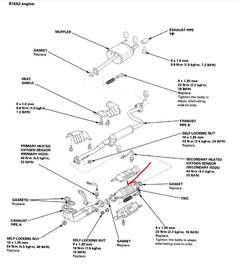

Yep, it would check the catalytic converter and replace the fuel filter if you have not done that lately. Here is a guide to help and the location of the fuel filter in the images below.
Check out the images (below). Please upload pictures or videos in your response of any problems so we can see what to help you with.
