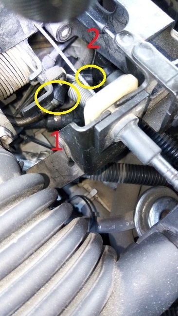

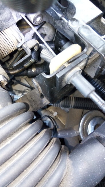

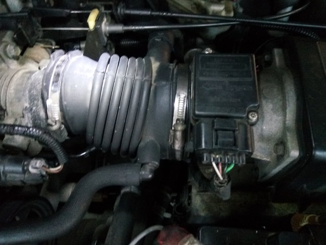

In the pictures below.
This looks like a small hose, a vacuum line maybe.
If it is hissing, it probably is a vacuum leak and needs to be reconnected! You may need to replace it if it is too short.
It would not be part of the oil leak problem.

I am going to buy some hose tomorrow after work. I will let you know if that stops the engine sputter.
Sunday, July 31st, 2016 AT 5:50 PM
TULPA
  • 53 POSTS
Replaced the hose and pcv valve seems to have fixed the sputter. While idleing anyway have not driven yet, still trying to find the oil leak

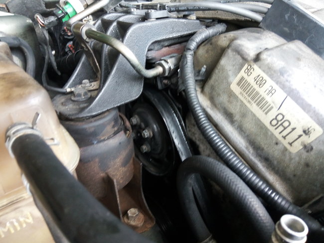

I believe the passenger side leak may be behind this pulley. It's the hugest one is that where a seal is?
Tuesday, August 2nd, 2016 AT 2:41 PM
TULPA
  • 53 POSTS
Edit. Not hugest (phone auto correct)
Highest
Tuesday, August 2nd, 2016 AT 5:31 PM
TULPA
  • 53 POSTS
I dont know what you call this but there is oil inside it
