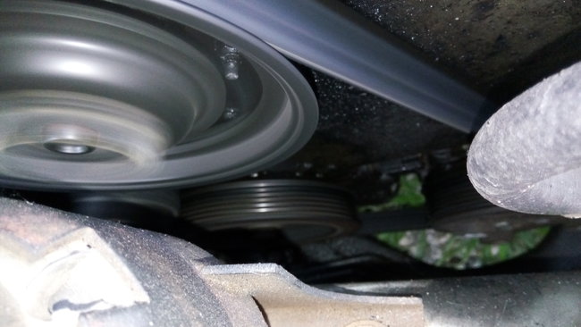

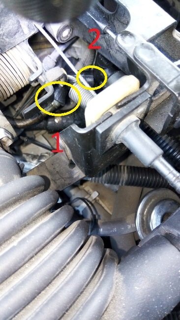

Okay, it seems I was incorrect, there is oil all over the bottom left and right. A few drops on the ground on the driver's side more on the passenger side. Could have more than one leak? Oil has been hitting the belt and it flung it everywhere. It appears to me it has been a problem for a while oil near the top is dryer than the bottom. I have not lifted the car just yet, it makes me nervous getting under one when lifted. I cleaned off what I could reach let it idle for ten to fifteen minutes I could not see where it was dripping from but did start smelling burnt oil.
The clicking continues even when oil level is full. Did it get driven without oil and caused another problem?

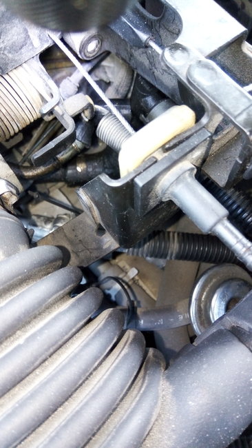

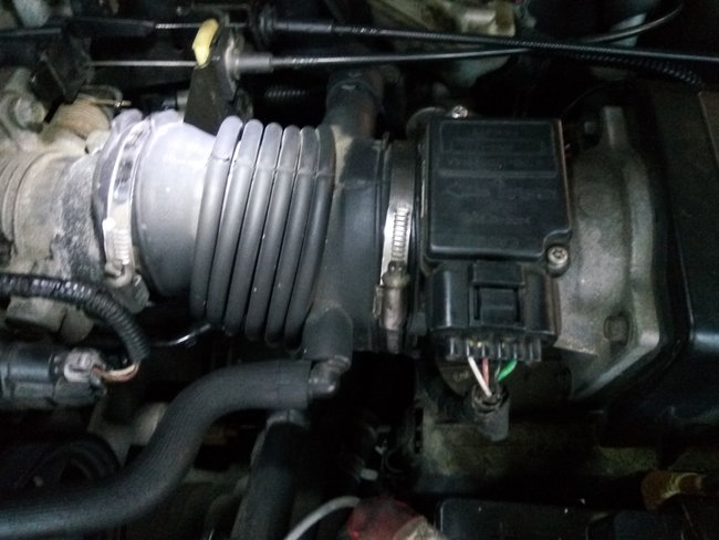

I think I found the source of the coolant leak I took a picture. I do not know if it is missing a clamp or what and the rubber is bent like it is being pushed out of place.

I do not know if you can see it or not but it is under that spring.

Finding oil leaks can be very tricky. If you are correct about the belt slinging it around, that would indicate one of the belt driven components, likely the power steering pump but you should have a very noticeable loss of power steering fluid from the reservoir.
Oil runs downhill and then spreads so when looking for leaks you are always looking for the highest point that you find oil. This is why it is rather important to get it all cleaned off first before looking. Sometimes you need to use mirrors to find the actual source of the leak.
When you do find a leak at a high point, that does not mean it was the only leak. This is why you start repairing from the top and continue leaning and watching for other leaks.

Power steering fluid is low, but bought the car yesterday and only drove it home. guess I will need to top it off.
Could you see what I was talking about from that picture? I can hear air coming out of it.

No, I could not see anything coolant related.

Not sure why I said coolant... I meant power steering. I do not know what it is called so it is hard for me to say what it is. Google and YouTube is the only training I have had. lol

I am seeing what looks like a 3/4" hose under the throttle return spring that should have a clamp. WT is correct about the leak detector dye, but it is the quickest and easiest way to track down a fluid leak.

So just replace the hose? What is the clamp called? Or does it matter.

In the pictures below.
This looks like a small hose, a vacuum line maybe.
If it is hissing, it probably is a vacuum leak and needs to be reconnected! You may need to replace it if it is too short.
It would not be part of the oil leak problem.

I am going to buy some hose tomorrow after work. I will let you know if that stops the engine sputter.

Replaced the hose and pcv valve seems to have fixed the sputter. While idleing anyway have not driven yet, still trying to find the oil leak

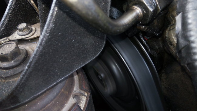

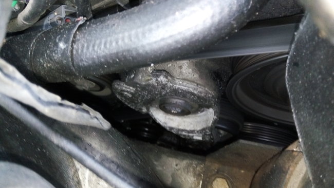

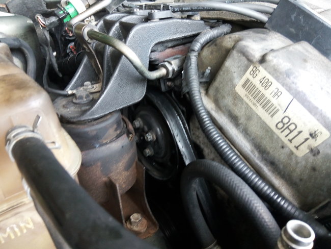

I believe the passenger side leak may be behind this pulley. It's the hugest one is that where a seal is?

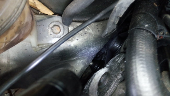

I dont know what you call this but there is oil inside it
