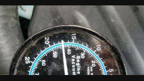

Doing pressure test with oil pan off, lost 1 pound in 35 minutes, saw a few drips. 15 to 14. Going to do it again, the drips were from all other. Very slow, 1 per minute maybe.
Apr 24, 2020 at 9:05 AM
PAUL KRAUSE2
  • 62 POSTS

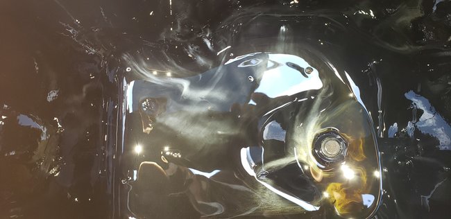

4 drops in 11 minutes. 2 sround 1 2 around 7, strangely i just seen three slow 1 second streams from oil pump screen. 1 second steam, stop 4 a few seconds and do it 2 more times. Gauge reading 14.5 lbs.
Apr 24, 2020 at 9:24 AM
Okay, then you have an internal leak in the motor itself.
You need a bright LED light and look up inside the motor and see where the source of the leak is located.
It could be a head gasket, intake manifold or a cracked block.
Apr 24, 2020 at 9:31 AM

40 minute, 14.5 lbs, wiped oil off bottom of pistons i could, 5,7 and a couple others. Stayed dry, i think the oil is coming from up above, dripping off cam. 1 place in back, 1 place in front. I'm wiped out, will it hurt if i leave oil pan off tonight? That oil pan is after 4 hours or so of idling.

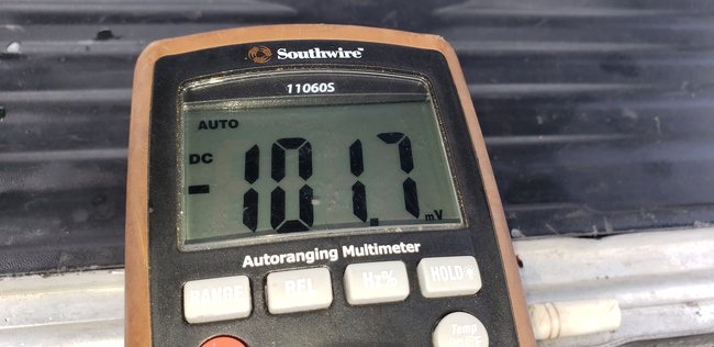

did anyone ever check the voltage in the coolant? Electrolysis will destroy a block if there is too much voltage in the coolant. The voltage comes from bad grounds.

No and I have never heard that. i adjusted voltage on fuel sync from .05v to 5v. where do i check coolant voltage?

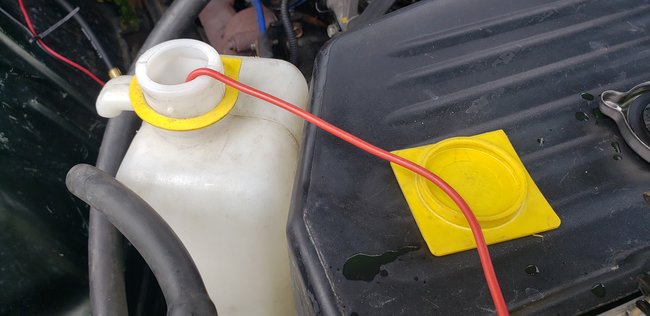

You put your voltmeter in the coolant. Red lead in the coolant and black to ground. anything over .2 volts is too much.
This is a common voltage drop test on any electrical system. It has been done for years.

Hi, for some reason i couldn't find latest message about pulling motor taking engine to a mechanic. I'm amazed i got this far. I have a condition that shuts my brain down and it's all over. Anyway last you told me the voltage in coolant should be no more than .2 v.
Apr 25, 2020 at 4:29 AM
PAUL KRAUSE2
  • 62 POSTS
Was over 120mv in tank.

How can this be be so high? Its mv does that matter?
Apr 25, 2020 at 4:32 AM
That is a good reading.
