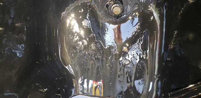

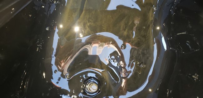

I have a cloudy condition in my oil. sent it to be analysed and it came back everything okay. I called them and sent pictures and he came up with a small amount of coolant getting into oil. The oil in the picture has 129 miles in it. Had the engine rebuilt 2,000 miles ago and changed the oil after break in and it looked the same as it does now. Have change oil 8 times since rebuild.

Good afternoon,
Can you repost the picture? It did not show on this thread.
This could be either a head gasket or a possible intake manifold gasket leaking.

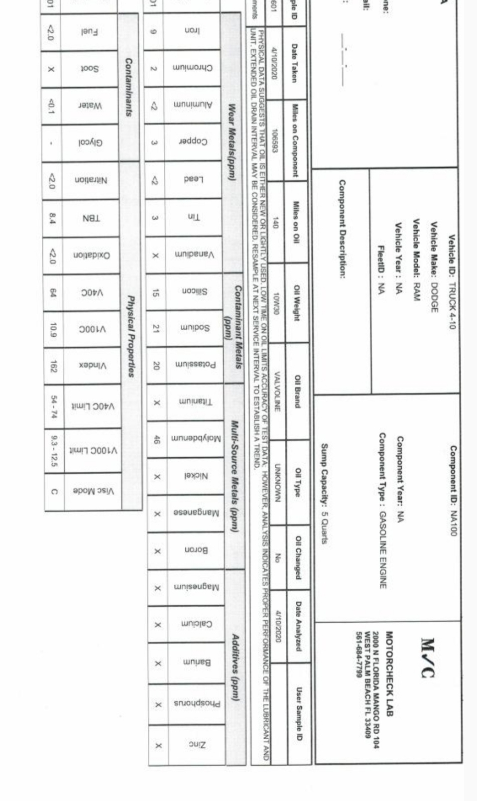

I am Thomas Jones, i have talked to you before about something getting into my oil. I have ordered the things to do the test you recommended. It's going to be a few days. I have the truck listed above with 2000 miles on rebuild. I'm sending you the oil analysis hoping it may help, also i was wondering how i would know if there was a crack between cylinders, cold compression test showed all between 165/175 lbs except 5/7 75/85 warm test all 165/175 lbs 5/7 cylinders 150 lbs.

I remember the picture you sent. It was a liquid in the oil and now I am wondering if it is fuel. The fact that they found fuel in the oil is concerning. It was not a lot but you should not have much at all and the fact that they found no Glycol (coolant) and basically no water, I would think that liquid in the oil may be fuel.
Did you smell the oil that you pulled out to see if it had any fuel smell to it?
If this is fuel then you have a possible injector issue washing down a cylinder. Let me know if the oil smells at all like fuel and we can go from there.

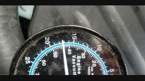

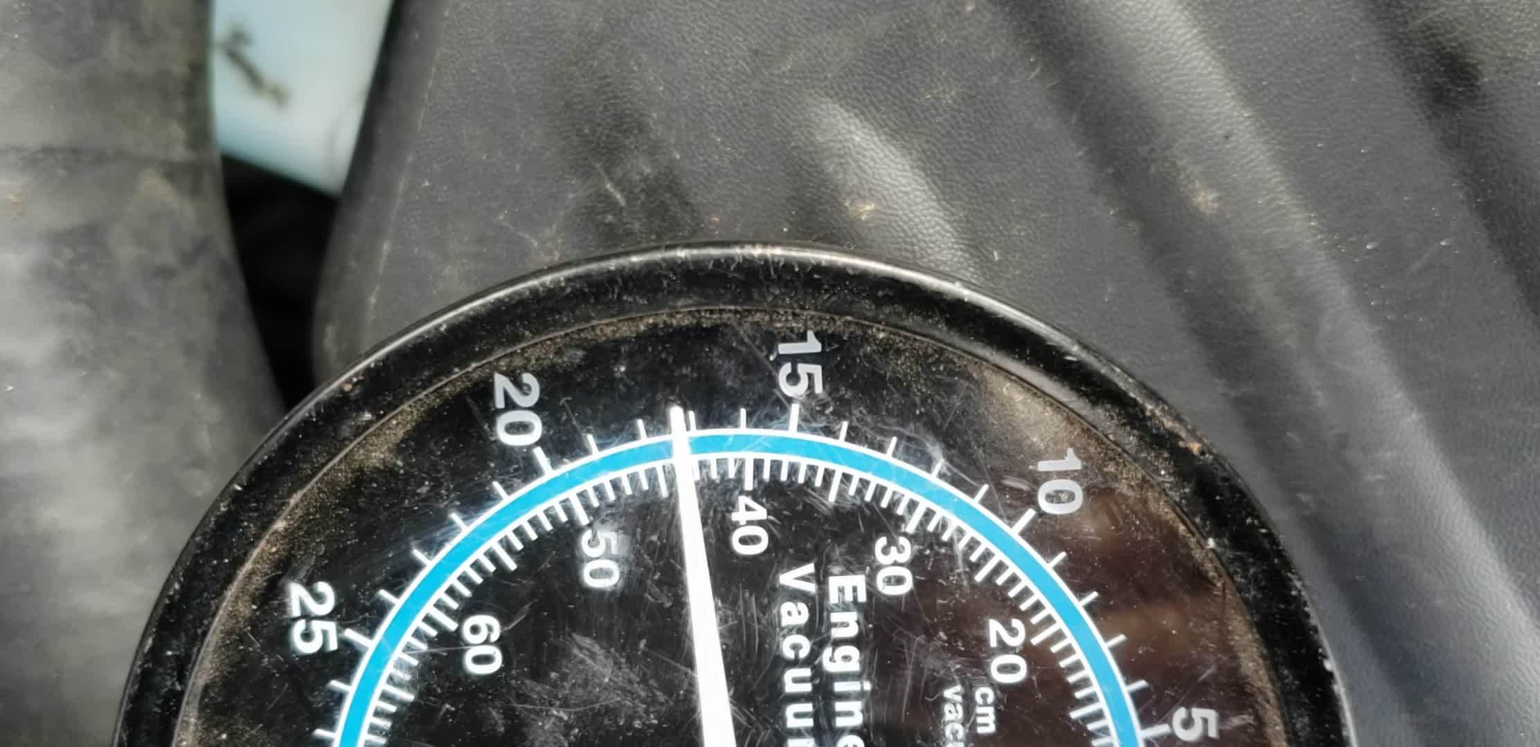

Not sure if this helps, but only 16 inches of vacuum with all inlets plugged off. could all this be connected?
Apr 15, 2020 at 8:06 AM
That is not good, too low. It should be 18-22 pounds. 20 is ideal.
When you checked the vacuum, did the needle jump around or was it steady?
Apr 15, 2020 at 8:09 AM
PAUL KRAUSE2
  • 62 POSTS
Yes. Started at 17. Then dropped to 16 and was steady at 16.
Apr 16, 2020 at 2:28 AM
Okay, does the needle jump around while it is running? Can you upload a video of the reading while it is running?
Apr 16, 2020 at 2:32 AM
PAUL KRAUSE2
  • 62 POSTS

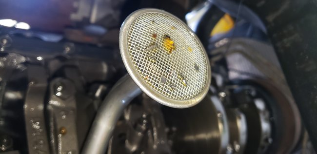

I'm getting ready to take oil pan off, want to see what it looks like. The needle holds steady. I will take a picture of needle when i finish. Maybe tomorrow. I will plug off all inlets.

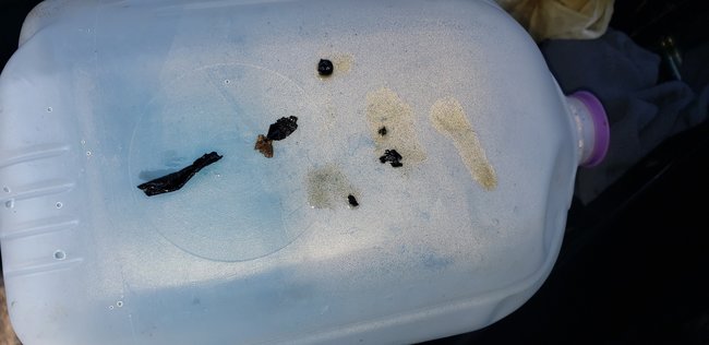

Well, i I finally got it back together and oil in. Now it's raining, wanted to show you some pictures, some of the rubber may have been RTV, but some was definitely not. Only used RTV in corners of manifold, could the other be from o-rings on injectors ? Also when i first took oil pan off i thought i smelled gas but later i wasn't sure. Hoping to do vacuum test but it's cold and raining. If and when it stops i will test vacuum, thank you. Thomas

RTV looks like skin over form one of the gaskets. It looks like the oil pan had RTV around it.
Still does not explain the coolant in the oil.
I would have pressure tested the cooling system while the pan was off to see if the intake manifold was leaking into the pan.

Vacuum just above 17.
Apr 18, 2020 at 6:14 AM
PAUL KRAUSE2
  • 62 POSTS
That's with everything connected, o the pressure test, wont have test kit until next week.
Apr 18, 2020 at 6:22 AM
PAUL KRAUSE2
  • 62 POSTS
Thats with everything connected, o the pressure test, wont have test kit until next week. Engine. Coolant is at 199, intake air should within 10° of engine temp. Intake air is reading 149. Thats according to snap on scanner
