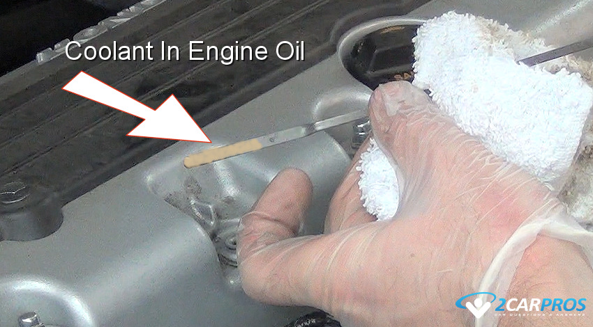

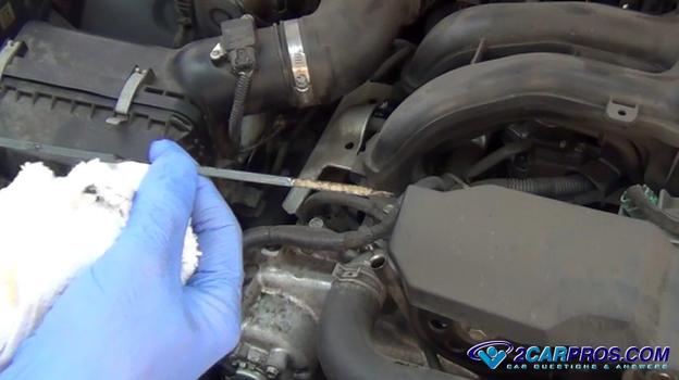

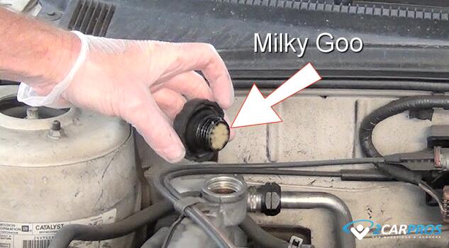

1. During routine maintenance, you might observe that the coolant level in the reservoir is low, even though there are no visible coolant leaks under your car. This can mean the cooling is leaking inside the engine, at this point you should remove the oil cap to check for milky goo, or chocolate milk as some call it which is a milky white, or yellow colored oil sludge. You can also use a flashlight to look inside the valve cover to further your inspection.
milky goo in engine oil fill cap

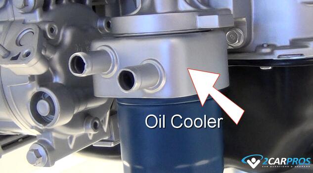

2. If there are no signs the head gasket is leaking, some exploratory surgery is necessary. I like to remove the oil cooler and leave the coolant lines connected, then pressurize the cooling system to see if coolant drips from the cooler which will warrant replacement.
automotive engine oil cooler
3. If the oil cooler is okay or your car's engine doesn't not use a cooler, it is time to start removing parts until the failed gasket or seal has been found. If the engine design uses a internal water pump, (timing chain driven) I would start there, and then move onto the timing chain cover and intake manifold gasket, (V6 and V8 engines only).

If your car is not used on a regular basis there could be a very slight amount of milky oil on the oil fill cap due to condensation which is normal, once the engine heats up the moisture will evaporate.
