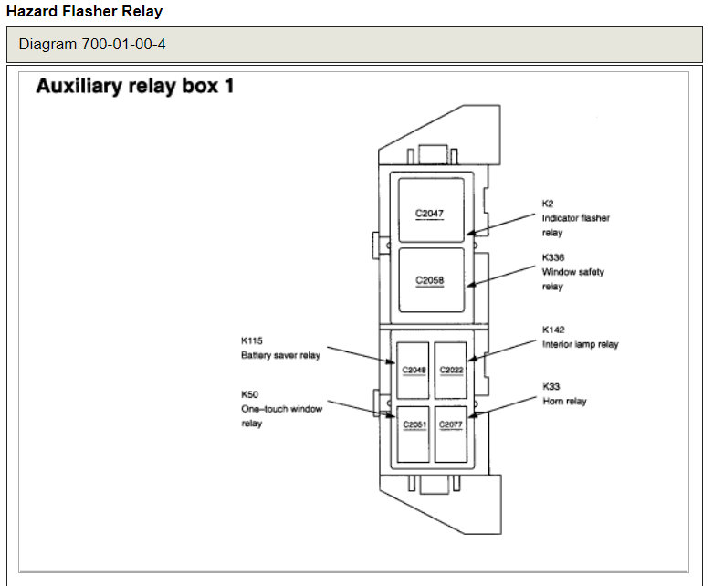

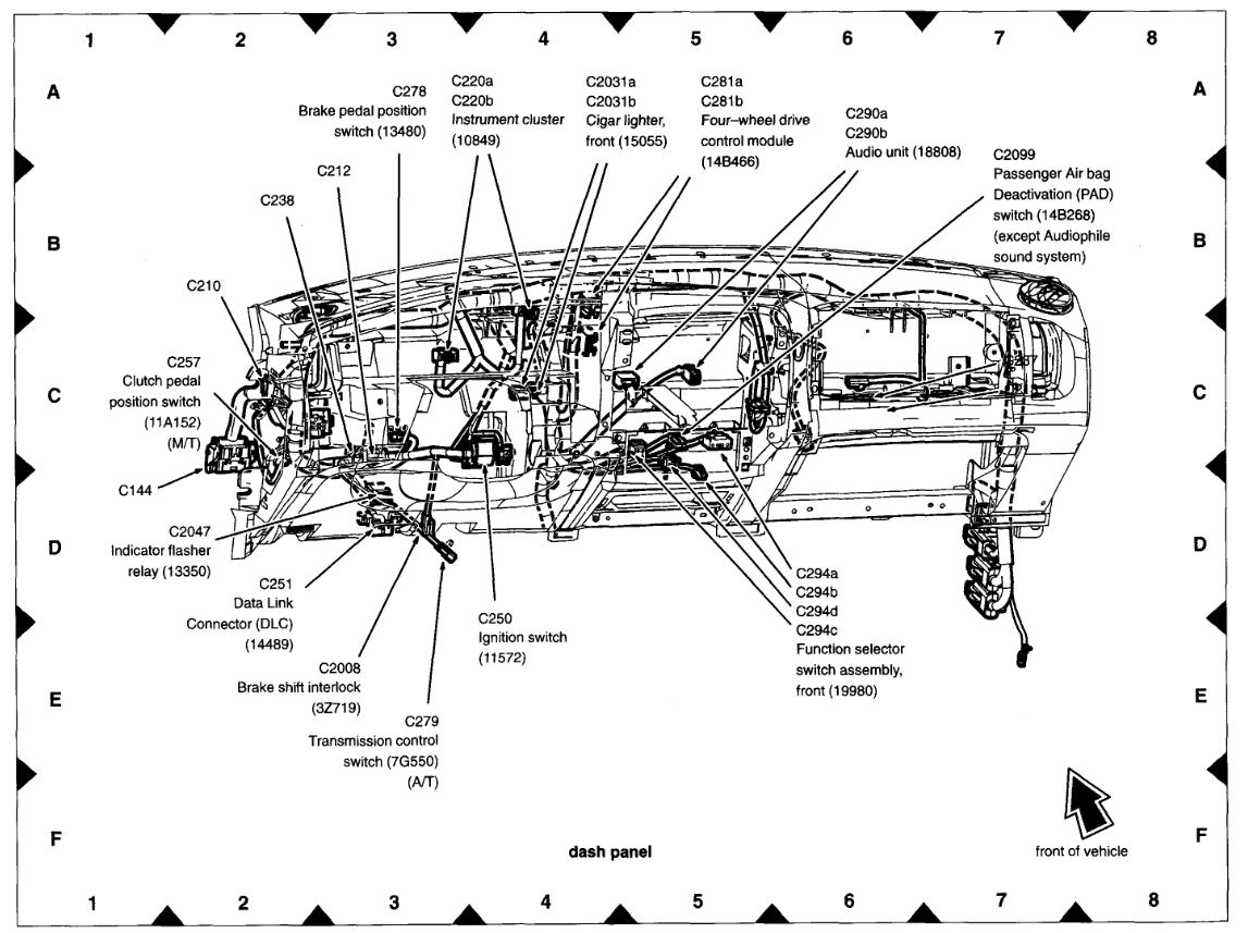

It sounds like you have a switch or flasher that has gone bad. Here is a guide that will help you get the problem fixed.
https://www.2carpros.com/articles/turn-signals-not-working-blinker
and
Here is the flasher relay location.
Check out the diagrams (Below). Please let us know what you find.

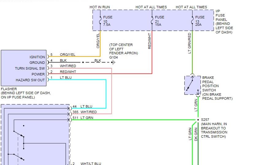

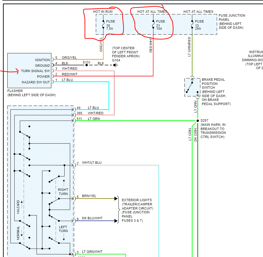

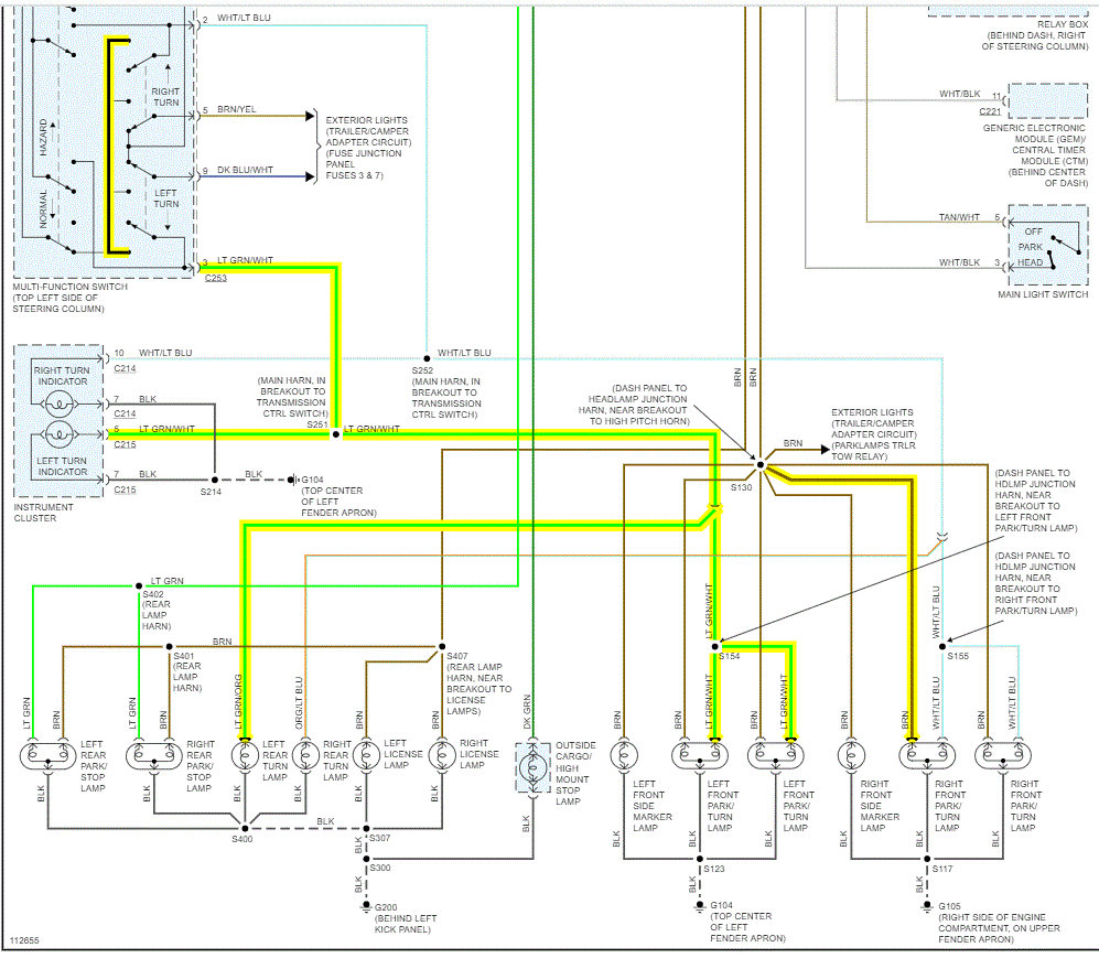

Replaced turn signal switch and flasher, nothing.
Wednesday, June 2nd, 2021 AT 2:02 PM (Merged)
  • 109,951 POSTS
Does anything work on the left side? For example, do the brake light work? Do any of the left side lights do anything including the indicator in the vehicle? I attached a pic from the wiring schematic and highlighted the left signal wiring. On the top left of the picture is the multi-function switch you replaced. Above that is the fuse that powers the lights. Since the right side works, the fuse isn't the problem.
Let me know if anything on the left works. Also, does it flash when the hazard lights are on.
-1
MICHAEL ERIC
Hey Joe, the left brake light works, but the hazard and turn signal do not; there is no indicator on the dash panel. What next?
  • 109,951 POSTS
Since the switch is new, we need to start at the beginning. I attached a portion of the wiring schematic below. Confirm that both fuses I circled are good and have power. Next, go to the flasher behind the dash. There will be a white wire with a red tracer coming from it. Confirm there is power to that wire when the key is in the run position. We need to determine where the power is lost. If there is power out from that wire to the switch, and I suspect there is, then you need to confirm power out from the light green wire with a white tracer at the switch. If there is, then the wire is broken before it gets to any of the lights.
Let me know what you find.

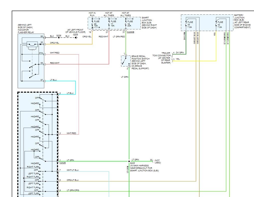

Need to inspect flasher unit. Flasher is similar to a relay and this is what controls the signal lights.
Read these guides first, they will help you
Wiring diagrams and flasher location attached below

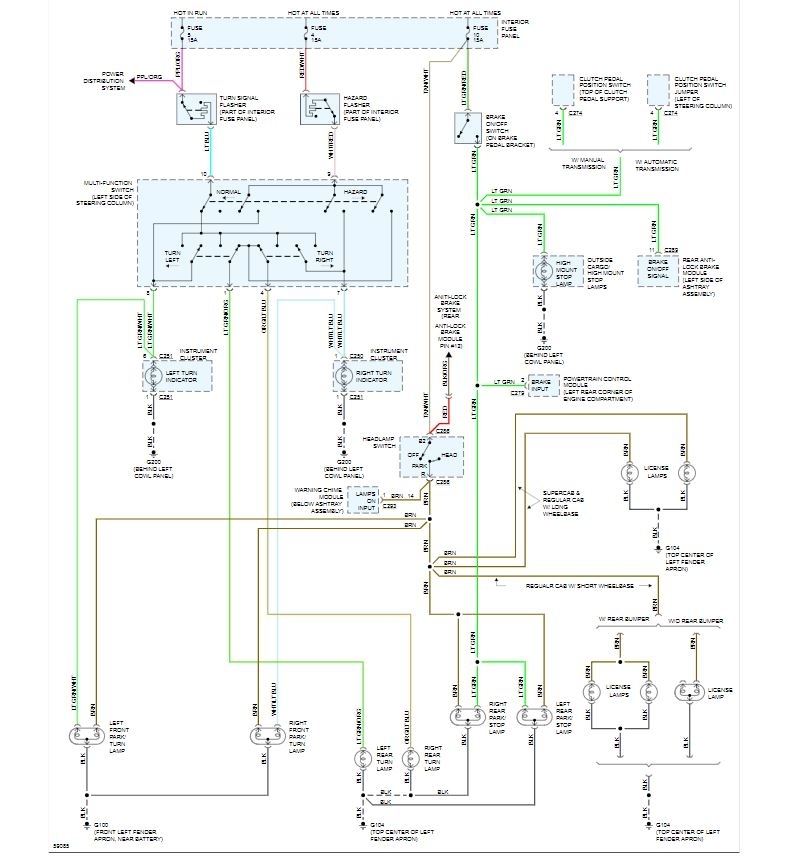

The issue is both the turn signals & hazard indicators are not working. The malfunction simply abruptly occurred. The turn signals came on sporadically thereafter but absolutely nothing now. The fuse is okay. Please advise to next steps. Appreciate your time & knowledge.
JDL
  • 16,098 POSTS
Usually the problem is the multifunction switch or the wiring in the steering column. Did you check for voltage at the applicable fuse/s? Even if the fuse is good, if no voltage, the circuit is still dead. Use a test light to check for voltage.
Give me a second and I'll post the wiring info. Here is diagram. The fuse for turn signals goes hot with the key on. The fuse for hazard lamps is hot all the time. Because neither work, check the flasher then the multifunction switch.
Did you check for voltage and ground at the applicable rear lamp, I was focused on the fuses. I don't believe it is a fuse problem.
