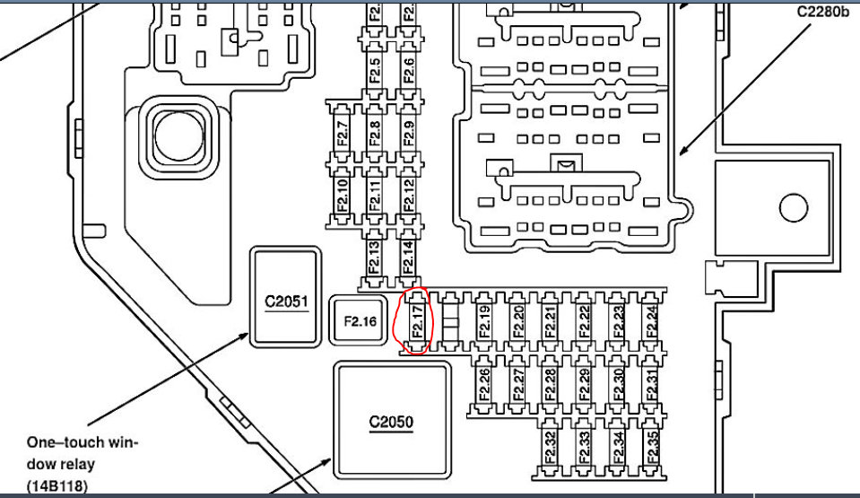

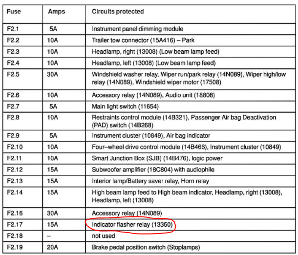

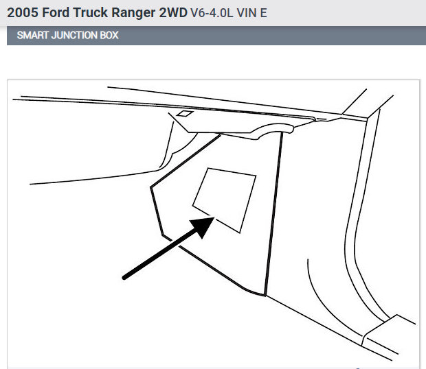

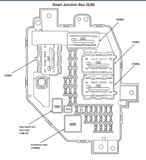

Here is the information you requested. The turn signal flasher is located in the smart junction box in the lower right hand kick panel under the dash board. I've attached pictures below of its location and also circled in red its location in the smart junction box. Hope this helps and thanks for using 2CarPros.

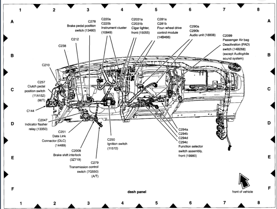

Trying to find the location of the turn signal flasher for a 2004 Ford Ranger. My turn signal works intermittently. Sometimes it blinks a few times and stops, sometimes it does not come on at all and less often it works fine and I can not find the location of the flasher. The owners manual does not mention the flasher's location under the fuses and relay diagrams. Thanks
Jun 2, 2021 at 6:28 AM (Merged)
  • 55,423 POSTS

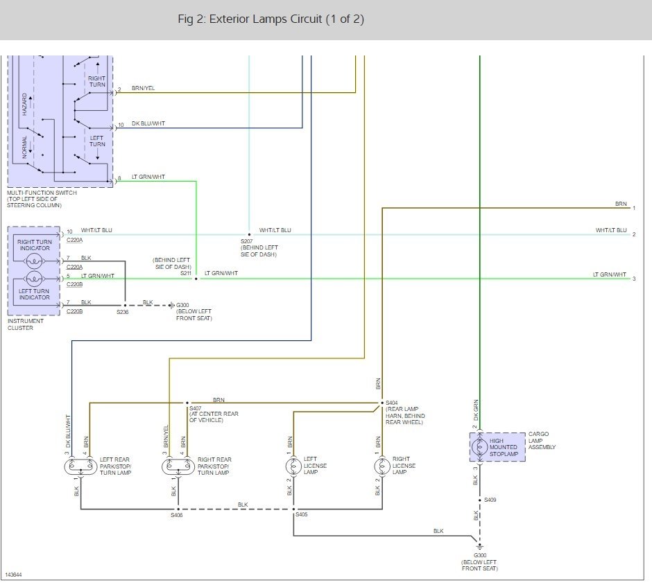

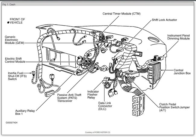

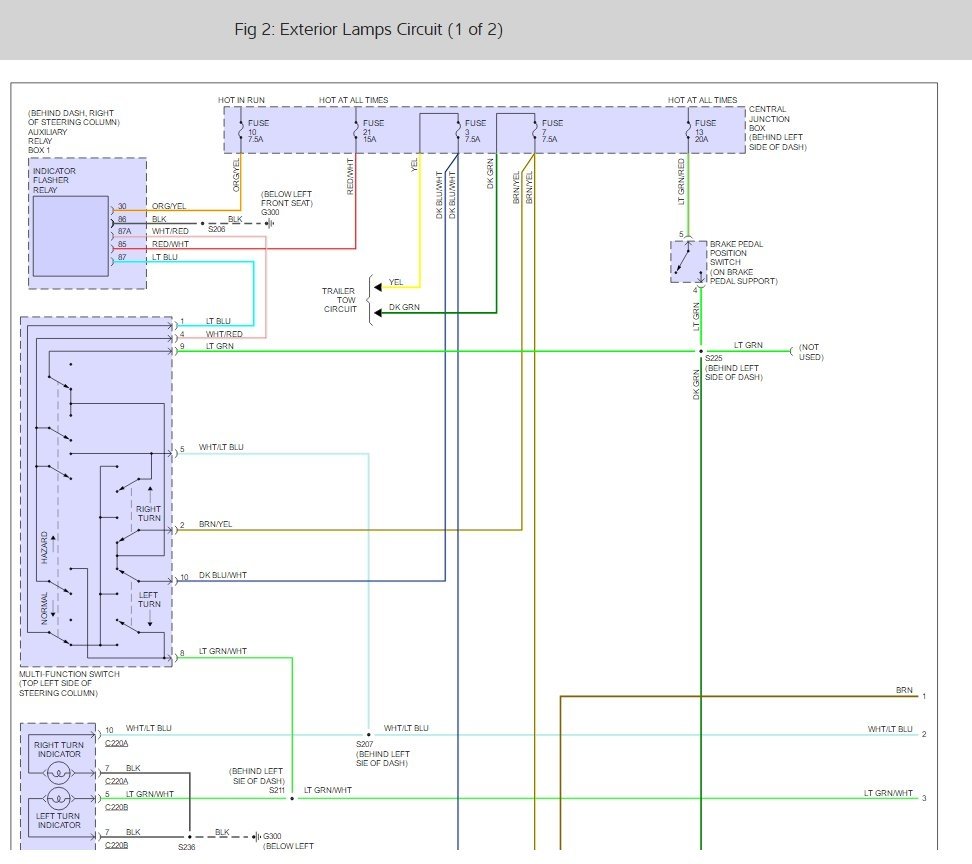

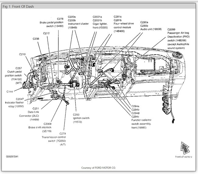

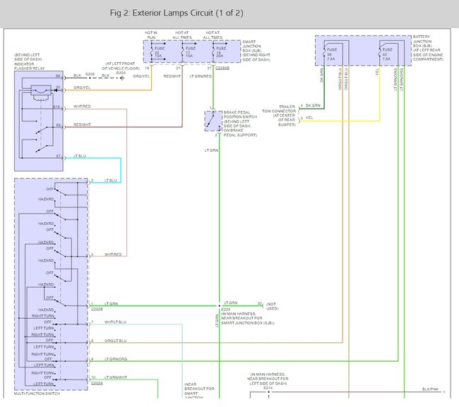

I found this diagram and location instructions for you, it looks like it is behind the driver's side dash by the brake pedal. I have a wiring diagram to to make sure you have the right flasher, sometime the emergency light flasher can look the same. Check out the diagrams (Below). Please let us know what happens.

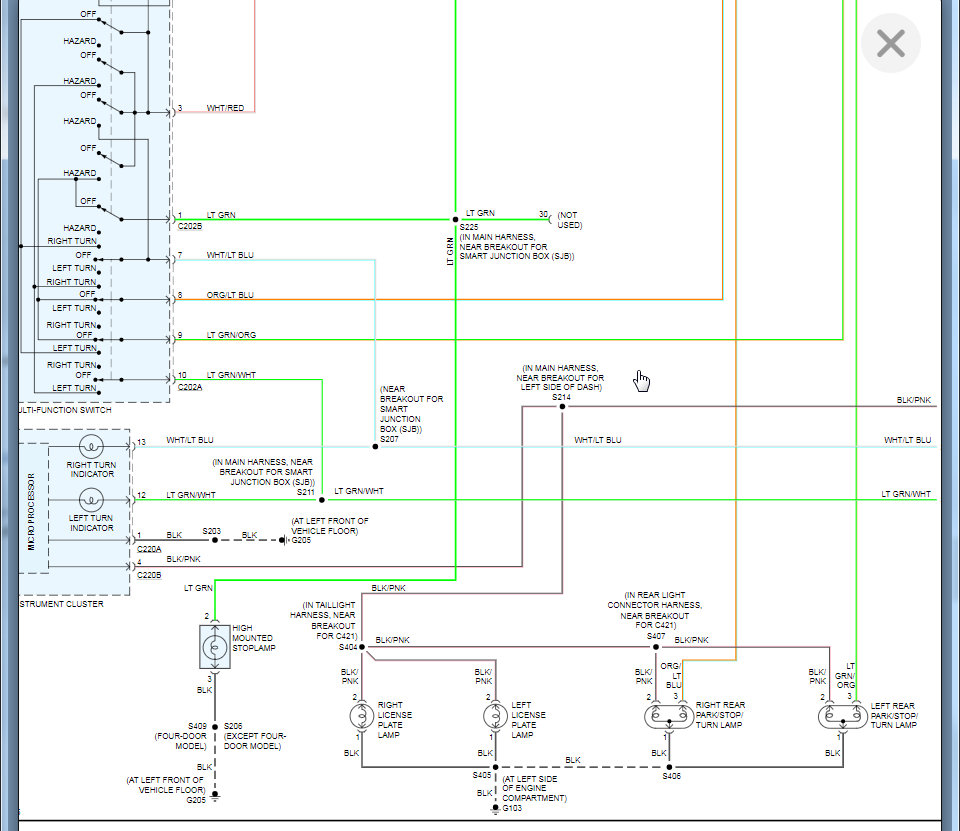

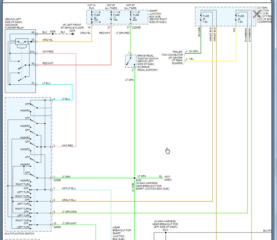

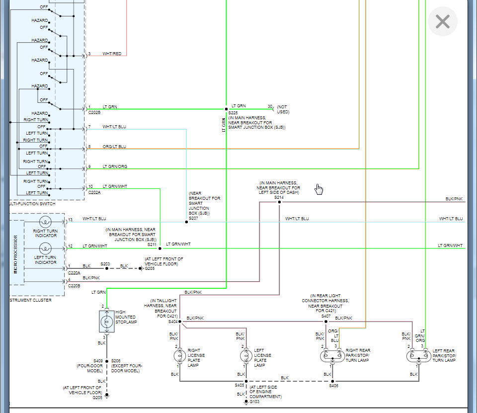

Assuming that this is related, I would suspect the flasher failed but I am not sure how it happened by just washing it so I assume there is more to the story. However, I would go to the flasher and test it and then move on. You have a traditional relay and not an actual flasher so I attached the location and wiring diagram so that we can test the switch output next.
Here is a guide that will help with this as well:
Let me know what you find or what questions you have.

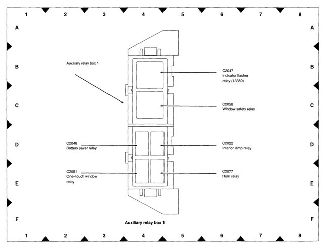

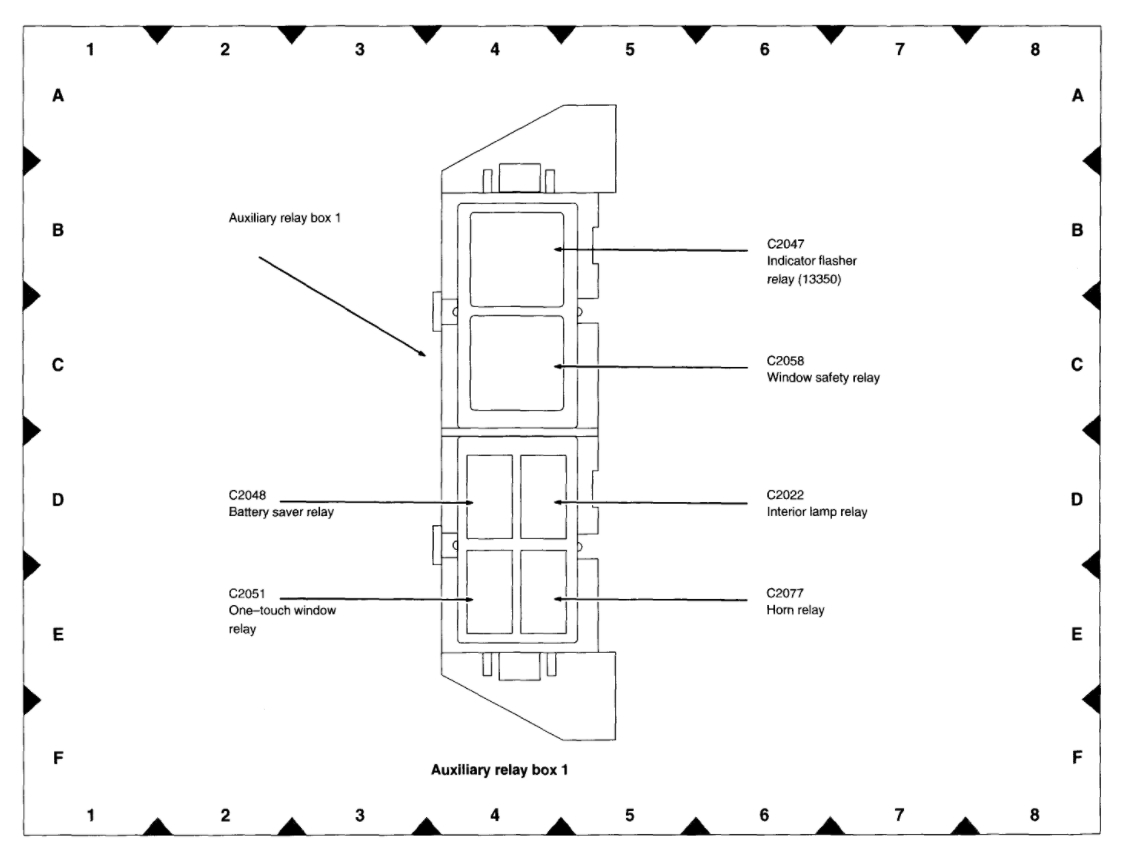

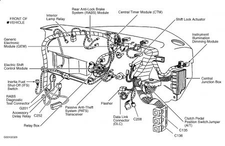

One relay works both the blinkers and emergency flashers. Here is a diagram (below) of its location along with some wiring diagrams and a guide so you can do some testing and get the problem fixed.
and
Please run some tests and get back to us so we can continue helping you.

Inspect flasher relay located behind left side of dash, pictured below..
