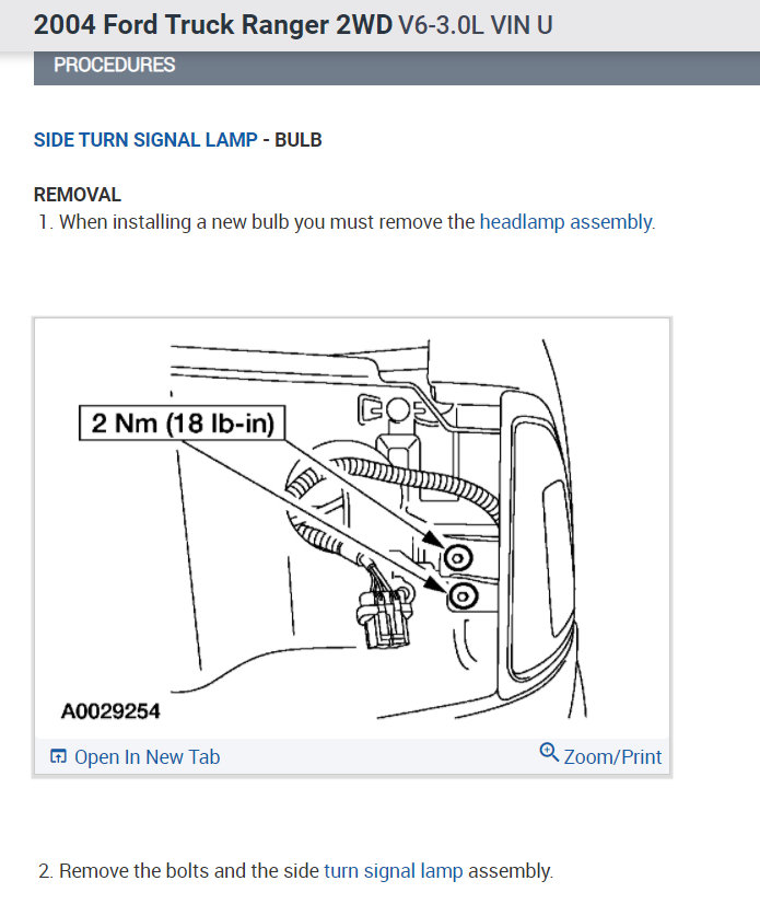

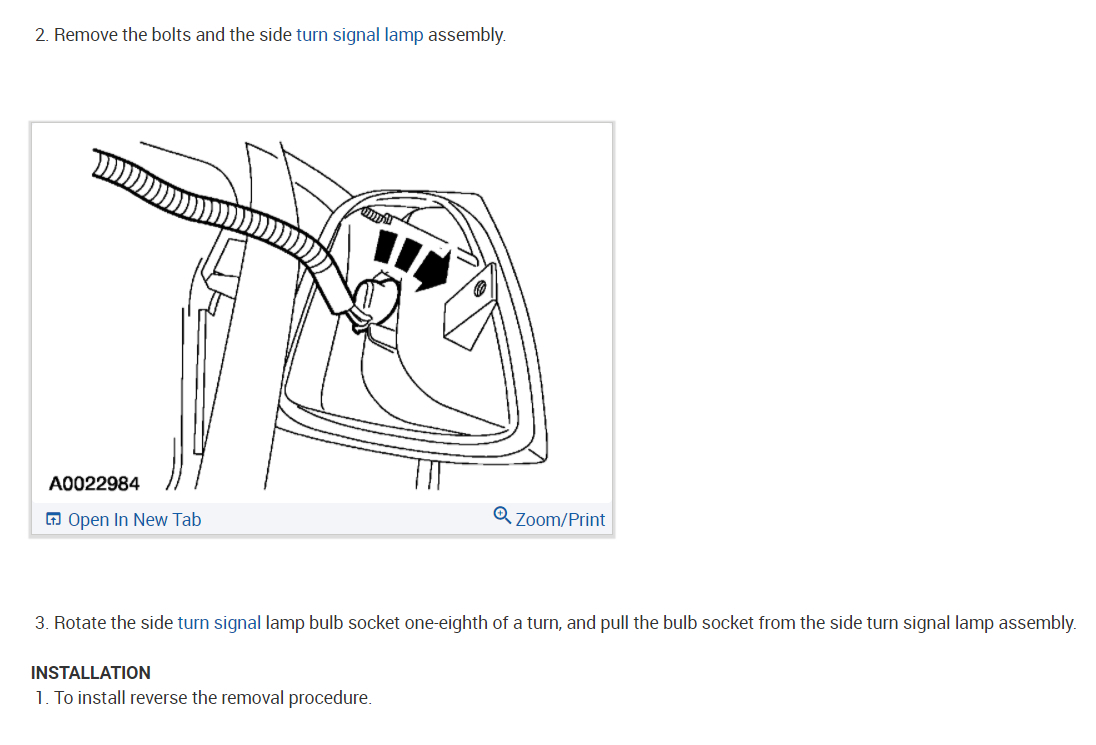

I need to replace the drivers front side marker light bulb, how to you do this?
Jan 28, 2008 at 8:43 PM
2CARPRO JACK
  • 11,533 POSTS
Looks like the headlight has to come out first. There are 2 pins on top of the light housing that you remove and pull the h-light assembly out. This will give you access to the 2 screws that hold the side lamp in. here is the instructions in the diagrams below. Check out the diagrams (Below). Please let us know if you need anything else to get the problem fixed.

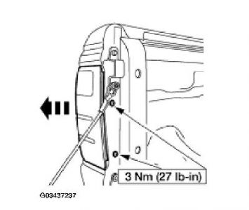

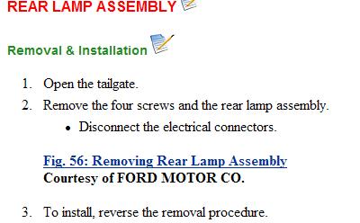

I would like to replace the tail light bulb. I've removed the two screws that hold the driver's side tail light in place. I noted that the tail light is fastened either with clips or posts on the inside. I'm not sure how much force is necessary to "pop" off the tail light. Is there a way to ensure I don't break anything when removing the tail light?
Jun 2, 2021 at 1:31 PM (Merged)
BLUELIGHTNIN6
  • 16,542 POSTS
Pull straight out. The clips are tough. You will not break anything as long as you pull straight and don't twist it, as twisting/turning will cause the clips to break. As you already know, there are two screws inside of tailgate. Four screws in total for both rear lamp assemblies.
