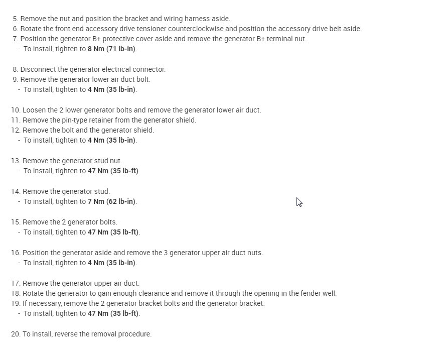

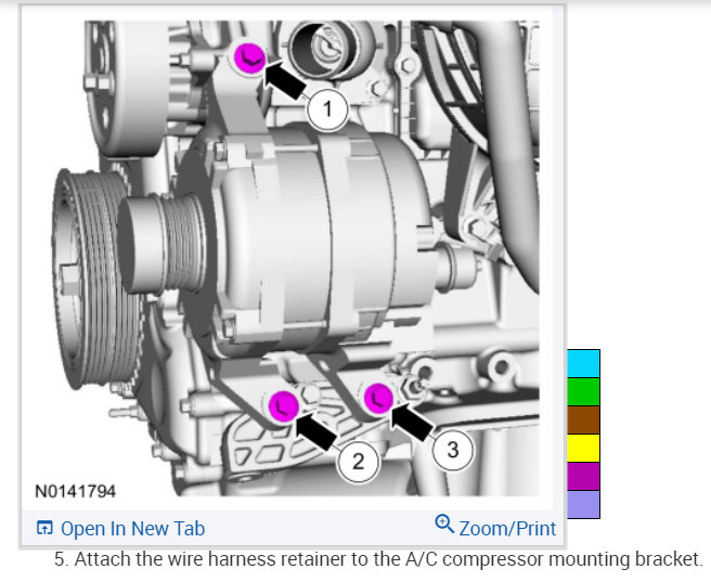

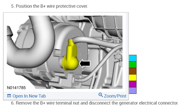

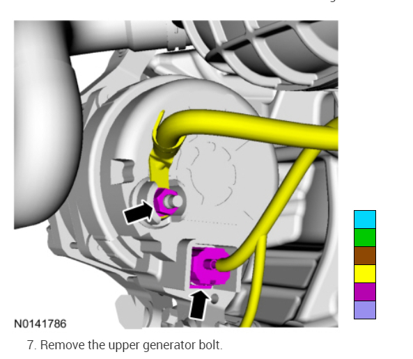

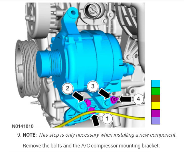

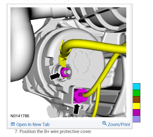

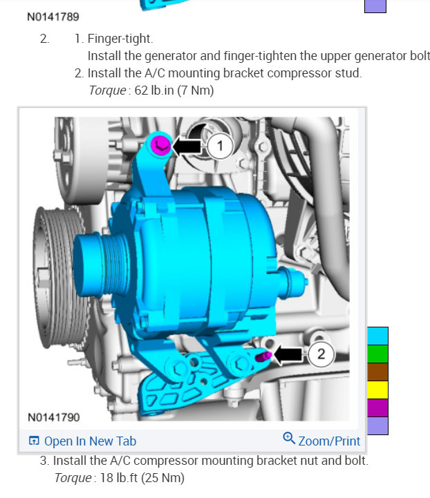

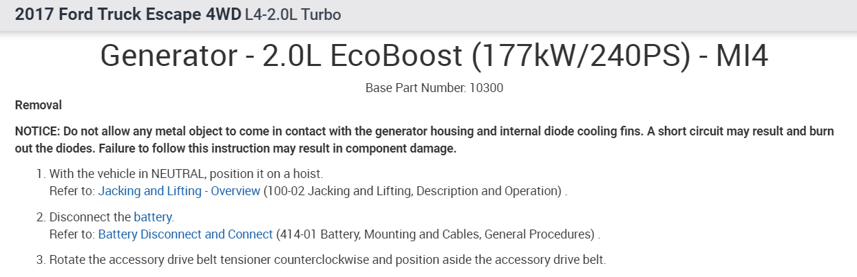

I replaced my alternator and now all my lights and electrical is going nuts. battery was dead, jumped battery to get it started and as long as I leave the charger boosting the battery my car runs fine, but when I disconnect the charger everything goes crazy. do I maybe need a new battery, did I do the job right can you help me make sure?
Jan 27, 2020 at 6:00 PM
Good evening,
You have a low voltage from the battery. I would start by charging the battery and see if it starts okay.
https://www.2carpros.com/articles/how-to-charge-your-car-battery
Chances are you will be replacing the battery.

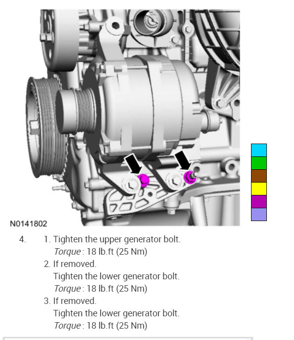

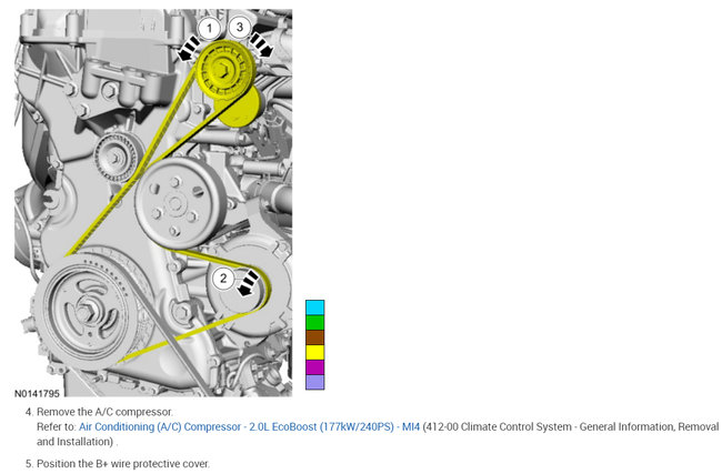

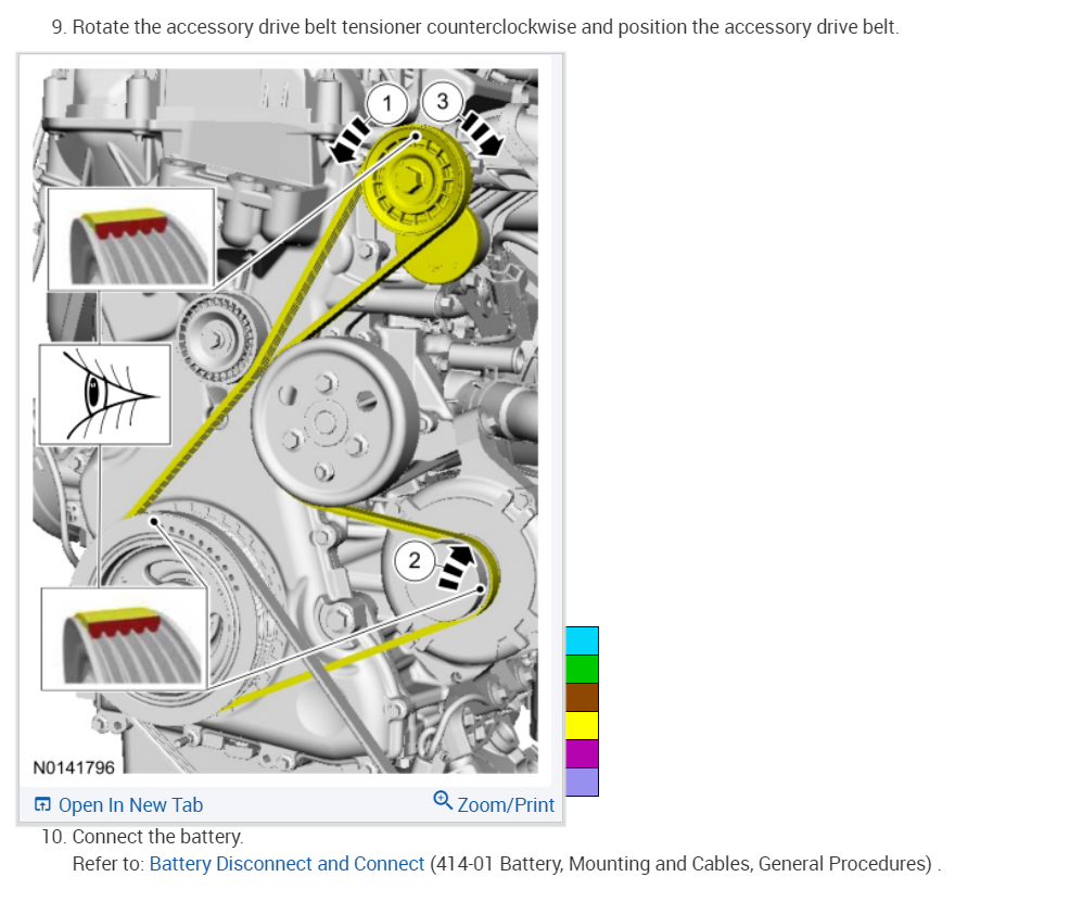

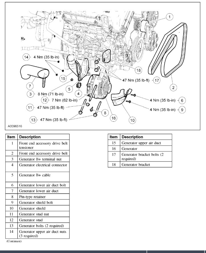

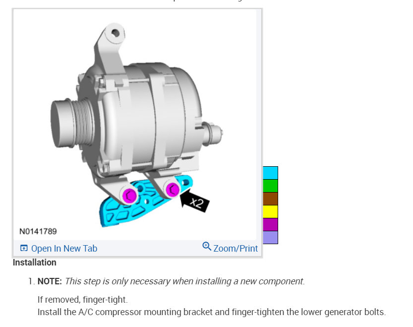

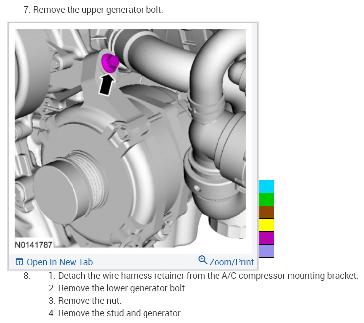

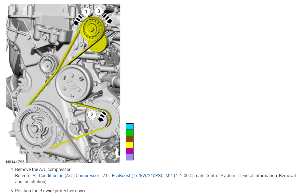

Here is how to change out the alternator correctly in the diagrams below. Check out the diagrams (Below). Please let us know what you find.
Jan 27, 2020 at 6:12 PM

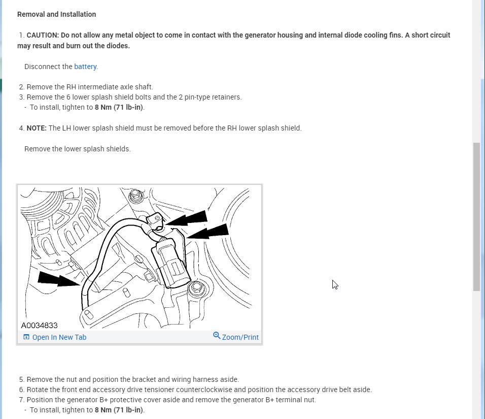

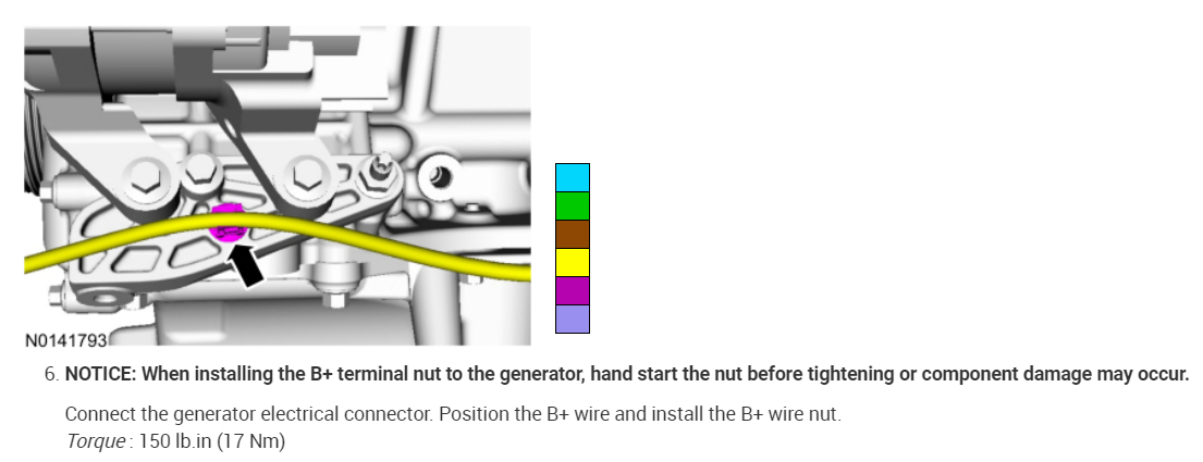

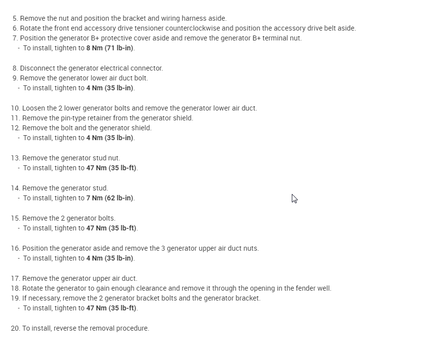

Hi there, I am Danny.
On a scale of 1-10 I would give it a 5. You will need a serpentine belt tool to remove and install belt and a basic set of metric tools. Disconnect battery cable first, then remove belt. The alternator is held on by a few bolts and electrical connections. Attached is a tutorial explaining the process. Hope this helps and feel free to ask any questions if you feel like tackling this!
Danny-
https://www.2carpros.com/articles/how-to-replace-an-alternator

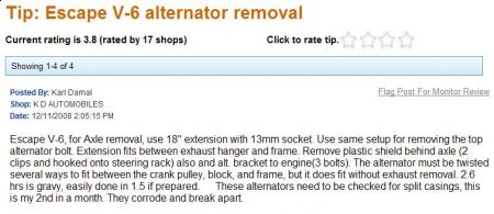

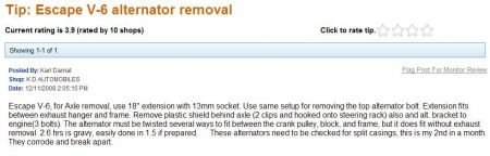

BLUELIGHTNIN6

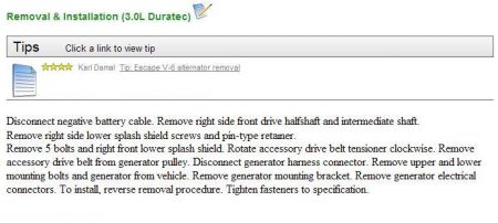

  • 16,542 POSTS
have to remove axle first..use 18" extension with 13 mm socket. use same setup for removing top alternator bolt. extension fits between exhaust hanger and frame. remove plastic shield behind axle (2 clips and hooked onto steering rack) and alternator bracket to engine (3 bolts). the alternator must be twisted a few ways to fit between the crank pulley, block and frame but it will fit without having to remove exhaust. will take around 2 hours for the job
Aug 11, 2020 at 5:34 PM (Merged)
STEVE SANCZEL
Alternator light comes for a few minutes when engine is cold then goes out. How do I remove the existing alternator?

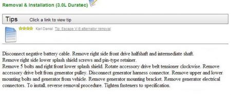

BMRFIXIT
  • 19,053 POSTS
check belt and belt tensioner
To remove the alternator
Disconnect negative battery cable.
Remove right side front drive halfshaft and intermediate shaft.
Remove right side lower splash shield screws and pin-type retainer. Remove 5 bolts and right front lower splash shield.
Rotate accessory drive belt tensioner clockwise.
Remove accessory drive belt from generator pulley.
Disconnect generator harness connector.
Remove upper and lower mounting bolts and generator from vehicle. Remove generator mounting bracket.
Remove generator electrical connectors.
To install, reverse removal procedure.
Tighten fasteners to specification

Disconnect negative battery cable. Remove right front wheel and tire. Remove 5 bolts and right front lower splash shield. Rotate accessory drive belt tensioner clockwise. Remove accessory drive belt from generator pulley. Disconnect generator electrical connectors to voltage regulator. Remove B+ terminal cover, nut and disconnect electrical connector. Remove lower generator bolts.
NOTE:Prior to installing generator, ensure upper bolt is placed in generator.
Loosen upper generator bolt from engine. DO NOT remove upper bolt from generator. Insufficient clearance does not allow bolt to be completely removed. Move generator to rear of vehicle. Remove generator. To install, reverse removal procedure. Tighten fasteners to specification. See TORQUE SPECIFICATIONS.
Removal & Installation (3.0L Duratec)
Disconnect negative battery cable. Remove right side front drive halfshaft and intermediate shaft. See AXLE SHAFTS article in DRIVE AXLES. Remove right side lower splash shield screws and pin-type retainer. Remove 5 bolts and right front lower splash shield. Rotate accessory drive belt tensioner clockwise. Remove accessory drive belt from generator pulley. Disconnect generator harness connector. Remove upper and lower mounting bolts and generator from vehicle. Remove generator mounting bracket. Remove generator electrical connectors. To install, reverse removal procedure. Tighten fasteners to specification. See TORQUE SPECIFICATIONS.

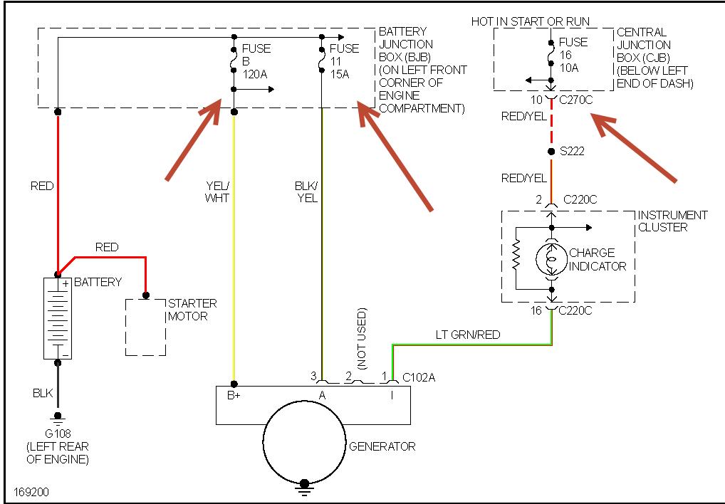

JENSFIXORREPAIRDAILY
My brand new battery (Motorcraft) died after having it in my car for all of 2 days. My husband removed the aternator, took it and the replacement alternator to a car part place to have them checked. The one he removed was bad and the other was good so he replaced it. Next day after making sure the battery was fully charged I drove the car. All the while the battery light was on. Another day later the batter has been drained to empty. Is there a possibility there is something else that is keeping the alternator from doing it's job?
Aug 11, 2020 at 5:35 PM (Merged)
  • 110,194 POSTS
I would try a different alt. Also, there is a fuseable link between the bat and the alt. That sounds like the problem to me but I'm not there to check. Have that checked. NOTE: If the alt is good, the fuseable link will cause this because regardless of the alt's ability to charge to battery, it can't get power to it.
