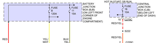

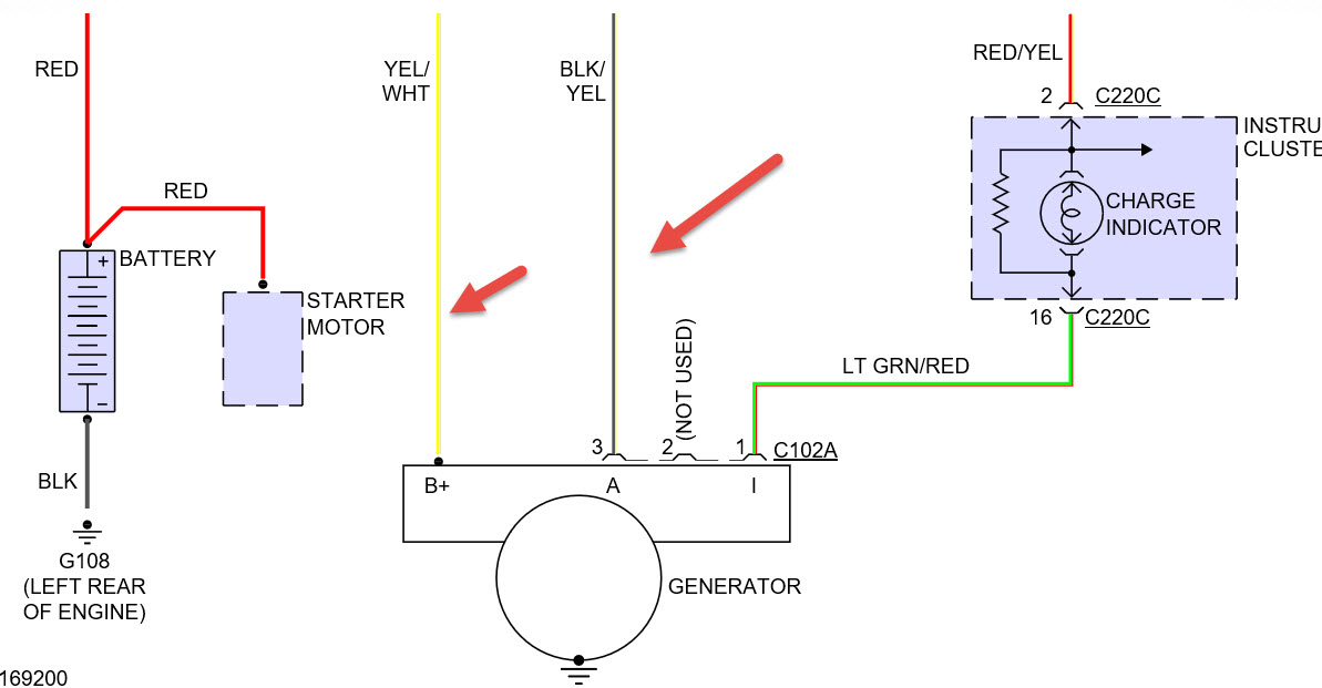

I replaced my alternator and battery but my car still won't charge the battery. Why?
Jan 28, 2016 at 1:02 AM
HMAC300
  • 48,601 POSTS
check items in pic this is for a 3.0L 2.0 l similar
Jan 28, 2016 at 1:17 AM
SEATONLEE1002
All fuses good I checked that already
Jan 28, 2016 at 1:25 AM
HMAC300
  • 48,601 POSTS
put a gauge on battery to make sure you are getting voltage then check the two wires for power marked in pic. if no power it may be a connection problem on either end , bad fuse box, also check ground battery to engine. and ground battery to body.
