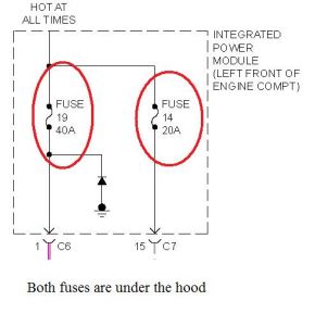

I have a 2005 Dodge Caravan. The power door locks/ opener won't work. The interior lights come on when I push the button on my key, but the locks won't open, also when the vehicle hits 18 m.P.H. The doors are supposed to lock and they don't. I and several friends have look for a fuse in the large box under the hood with no luck. I called the service dept. And they said there was another fuse panel under the dash, but we can't find it. I've also removed a side panel on the driver's side of the dashboard and there was nothing but a plug connection in there. I've been through the owner manual and it just runs you around, I'm sure they want you to bring it to the dealer so they can charge me an hour's labor to change a fuse. Could you please tell me where it is? Thanks, Charlie

https://www.2carpros.com/forum/automotive_pictures/55316_05caravanpdl_1.jpg
My source says both fuses are under the hood.
